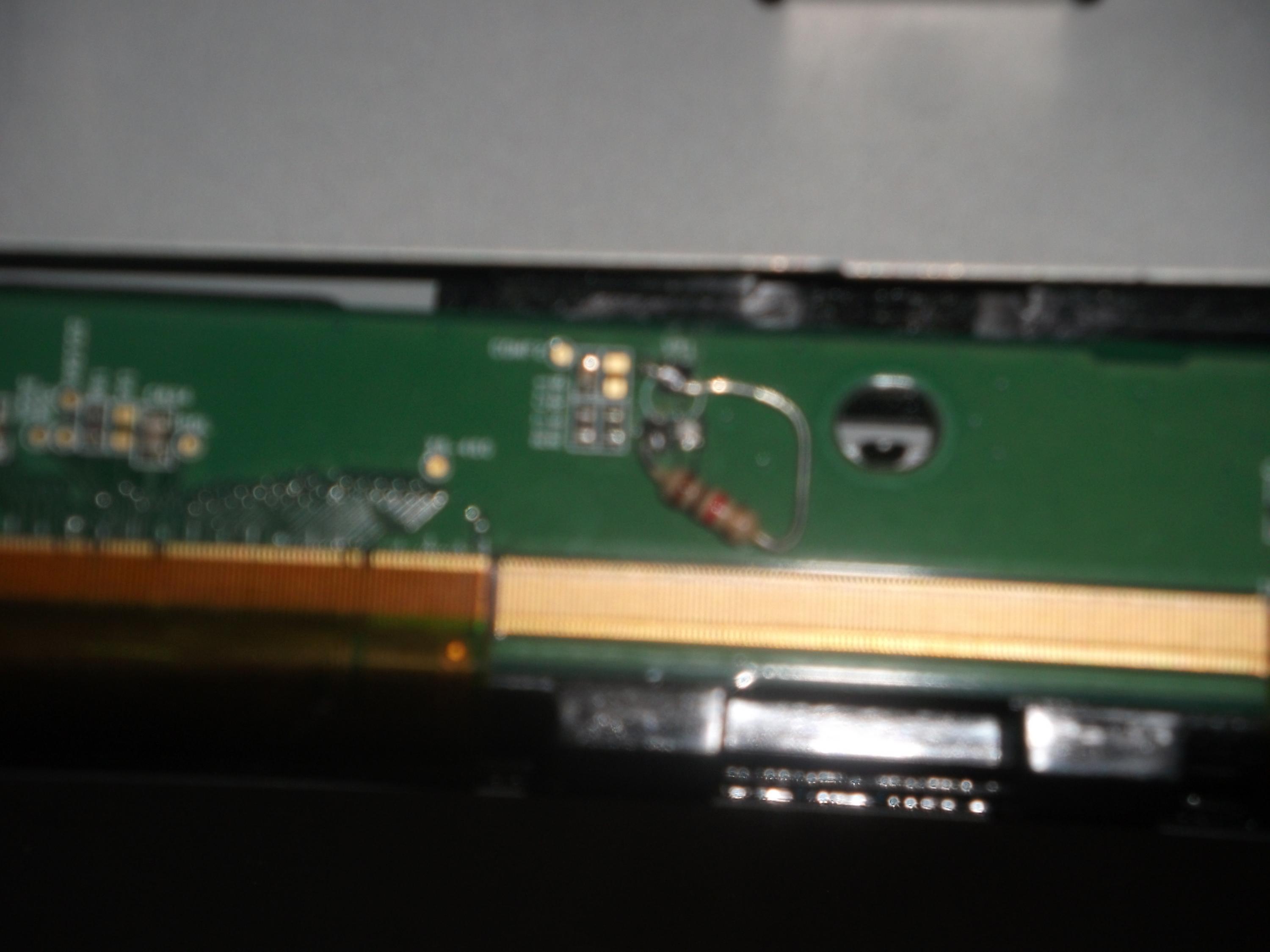

    I have another one of these with the same bad screen issue as the other one I had a while back.
    I don't know how you guys manage to fix these, but I can't fixed these.
    Initially it had a blue screen with those multicolored line bands and no image.
    I have messed with it a bit, by twisting the screen, changing the boards (from the old one).
    I guess the twisting probably brought back the image.
    After pushing the tabs around I have managed to change a lot the screen's image, but eventually it became white and it doesn't want to become blue anymore.
    I can still see the " No signal" on the screen with a lot of lagging, but I can't do anything with the screen.
    Where exactly is the problematic area? Ribbon and screen or ribbon and PCB?
    Any help would be appreciated.

    I made a mistake and I haven't noticed it, only today I have realized what I did.
    Somebody already "fixed" it with some 3M tape, but it seems that it didn't last to long the "fix".
    I have removed those tapes to start all over and while removing the tapes, I have removed the variable resistor with it. That's why I had white screen.
    I have found it luckily in the trash can and re-soldered it and now it has a pretty good image, with some thin lines, but no lag at the moment.
    Still need to play with that tab, to make those thin lines disappear(right edge of the screen).
    Second time, I have messed up again that variable resistor, while putting back the metal cover. It's way to close to the metal cover, I have just applied some kepton tape over it. It was actually touching the metal cover and the screen it became white again(probably it was shorting out).
    Now, if I manage to repair it, how can I sell it? Maybe while they transporting the TV, the lines will come back.
    Should I let them know what exactly is going on and sell it very cheap?

          If you lay down the TV with the back down/screen up with the top toward you, look at the top panel PCB and on the left board around the middle should be a square shape variable resistor(VR1 if I remember well).
          If do you see three pads in a triangular shape, you are missing that component.
          Don't waist any more money on this TV, it's not worth it. Send back the boards that you have purchased, if it's still possible.

              When I had the white screen with faint image, I caused it when I removed and re-installed the panel metal cover.
              Yes, I'm referring to those two top slim boards.

                  I ripped it off(sliced off) that component with the cover when I was putting it back. This caused a missing voltage.

                    You won't believe what happened, as soon as I got home from work, I looked at this panel driver board. With the TV standing up and facing you, this would be on the top right. I looked and looked, didnt find any potentiometer (variable resistor). But then I saw three terminals staring at me in a triangular shape, and wondered if a potentiometer existed there before. You would never guess this, unless you saw this thing fall off (thanks to tibimakai for telling me this). Sure enough the potentiometer had fallen off, so I took a 1K resistor and bridged the connection. The TV comes on and I played a movie for a good hour yesterday!. So excited I was able to fix it. I took a picture of the shunt solder I created that fixed this problem for anyone else who may benefit from this. Tags: Vizio, Vw46l, HDTV10a, whitescreen, no audio, faint image

                      That variable resistor sticks out way to much in my opinion.
                      There is a hole in the metal cover for it, to be able to adjust it from outside.
                      Not sure what it does, anybody knows? If I remember correctly, Tom66 said that it can brighten up the screen?!
                      I had to put some tape over it because it was shorting to the cover.
                      I still have to play with the left upper corner tab for the lines to disappear.
                      I will fix it as best as I can and put it up for sale for $100 and I will let people know about the risks of purchasing this TV.
                        Re: Vizio VW46LFHDTV10A stay away
                        It is probably one adjustment for a panel bias voltage, like VGH, VGL.
                        The panel documents say "DO NOT ADJUST POTENTIOMETER", so I guess that is factory set for appropriate performance.

                          I just got one of these models, the same thing happened with the variable resistor coming off causing the white screen. This TV is the PITA to setup with the tab bonds exposed without causing a short or the inverter connectors coming out. I actually blew the 12V fuse on the main board too.
                          I could not solder the VR back on because it ripped the leads out of it. I first put a resistor there but it kept coming off, I eventually just bridged the connection and it seems fine.
                          As for the tab bond, the bad one is the very top left bond, not the front side but on top that is the suspect. I put some foam in between and screwed it down. It worked for a while then started back with the dark spots. I twisted the panel slightly and it went away, then I snugged the screws down some more.
                          It's been going good for an hour or so we'll see. Such a shame this happens.
