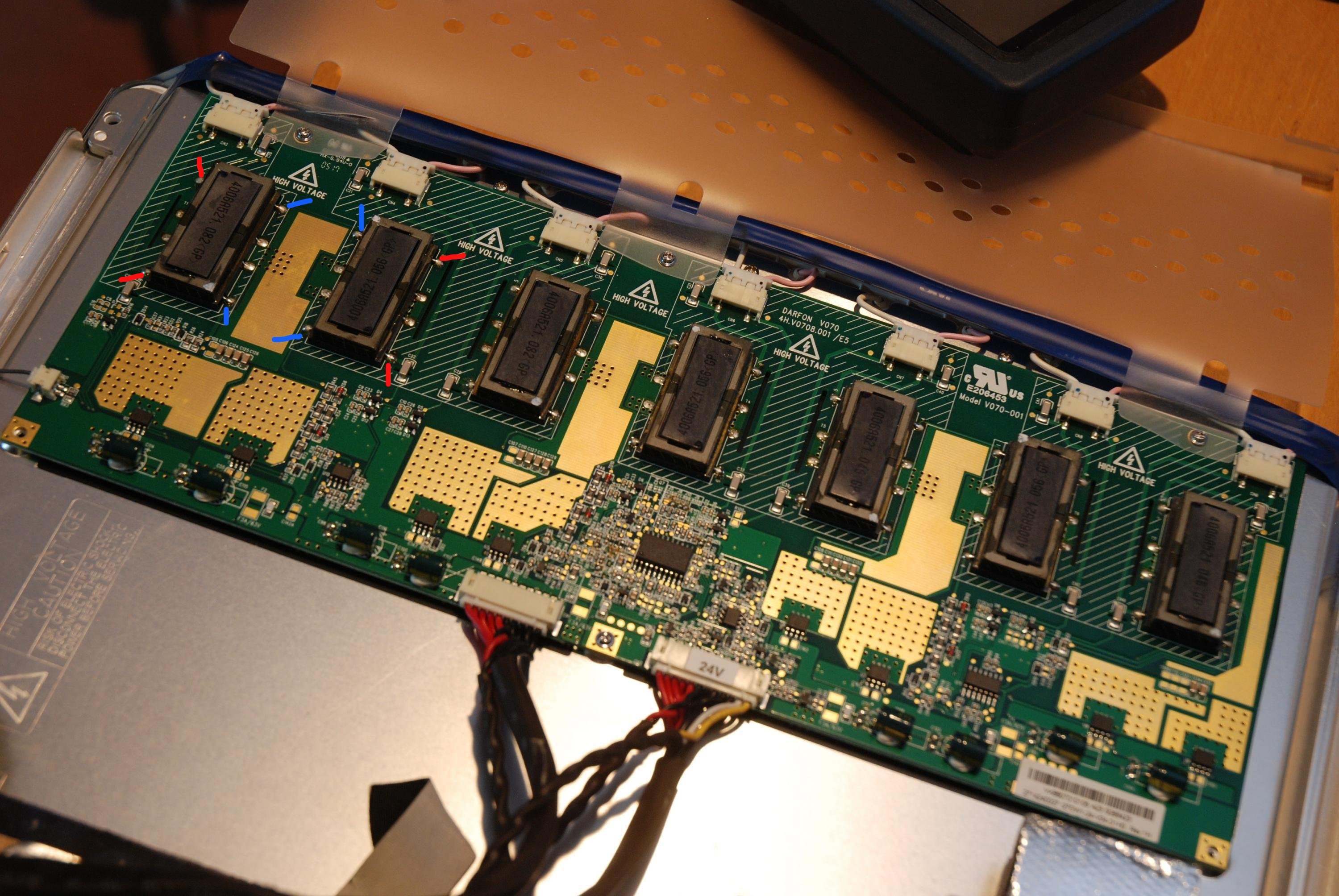

                      Re: Proview rx-276 2600
                      Here you go:

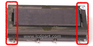

                        This is a Darfon inverter; the transformers are very common failures.
                        How to test:
                        1. Unplug the TV.
                        2. Test resistance between red marks using the 20k ohm range. Note this down.
                        3. Test resistance between blue marks using the 20k ohm range. Note this down.
                        4. Test each set of two transformers like this; note the red and blue alternate. For the last transformer, test it as just the first transformer of the group.
                        5. Report the readings in this thread.

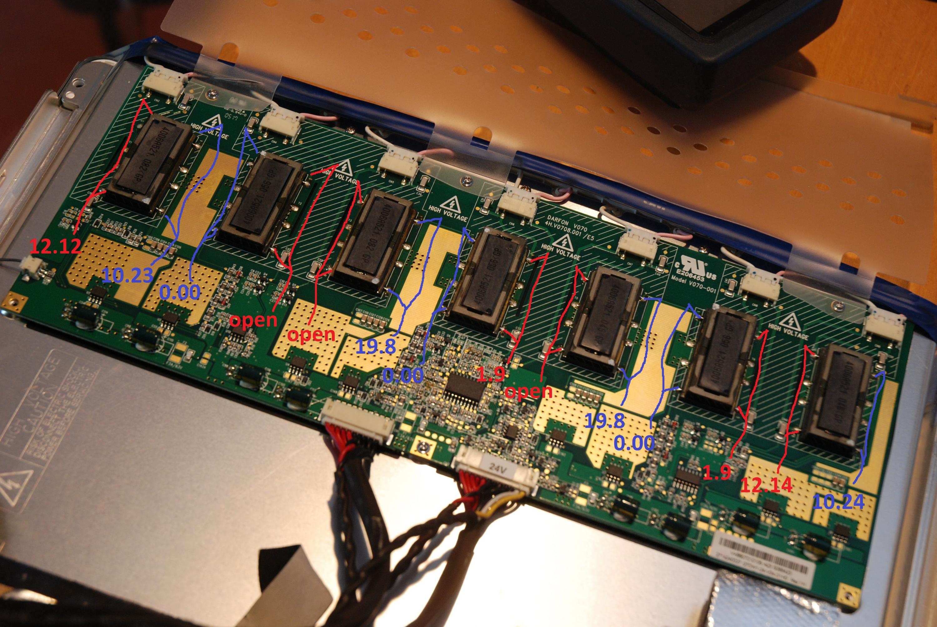

                          Here are the results. The ones that are open did show a number for a second, then went open. I'm not sure if it's my meter or what.
                          Thanks for the help
                            Something's not right here. Did you use the 20k ohm range? All but one winding should measure virtually the same. The failed winding is the one which significantly differs. Also make sure the value on your meter settles before reading it off.

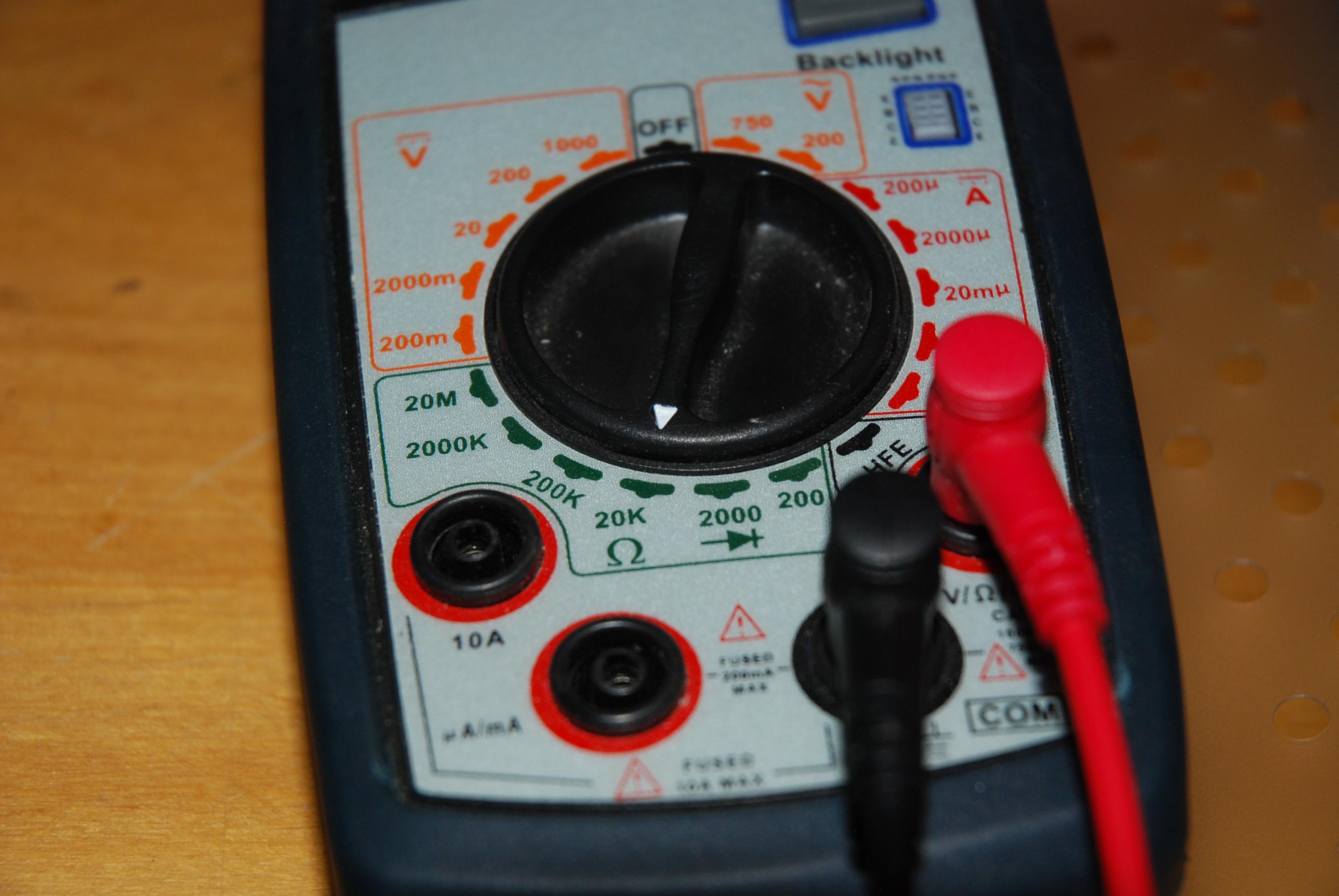

                                Can you show which range your meter was set on by taking a photo of it in that setting.
                                Also touch the probes, does the meter read nearly or exactly zero?
                                    Here you go...
                                    and yes it shows .0.. when leads are together
                                      Hmm maybe I'm not understanding how this board works, it happens. Try testing across red and blue for each to see if the results are more consistent. So red and then opposite blue, for the top and then for the bottom, for each transformer.
                                      • Snype32
                                        • Jun 2011
                                        • 76
                                        so on these leads? If so, all except 1 are .95. One of them is open
