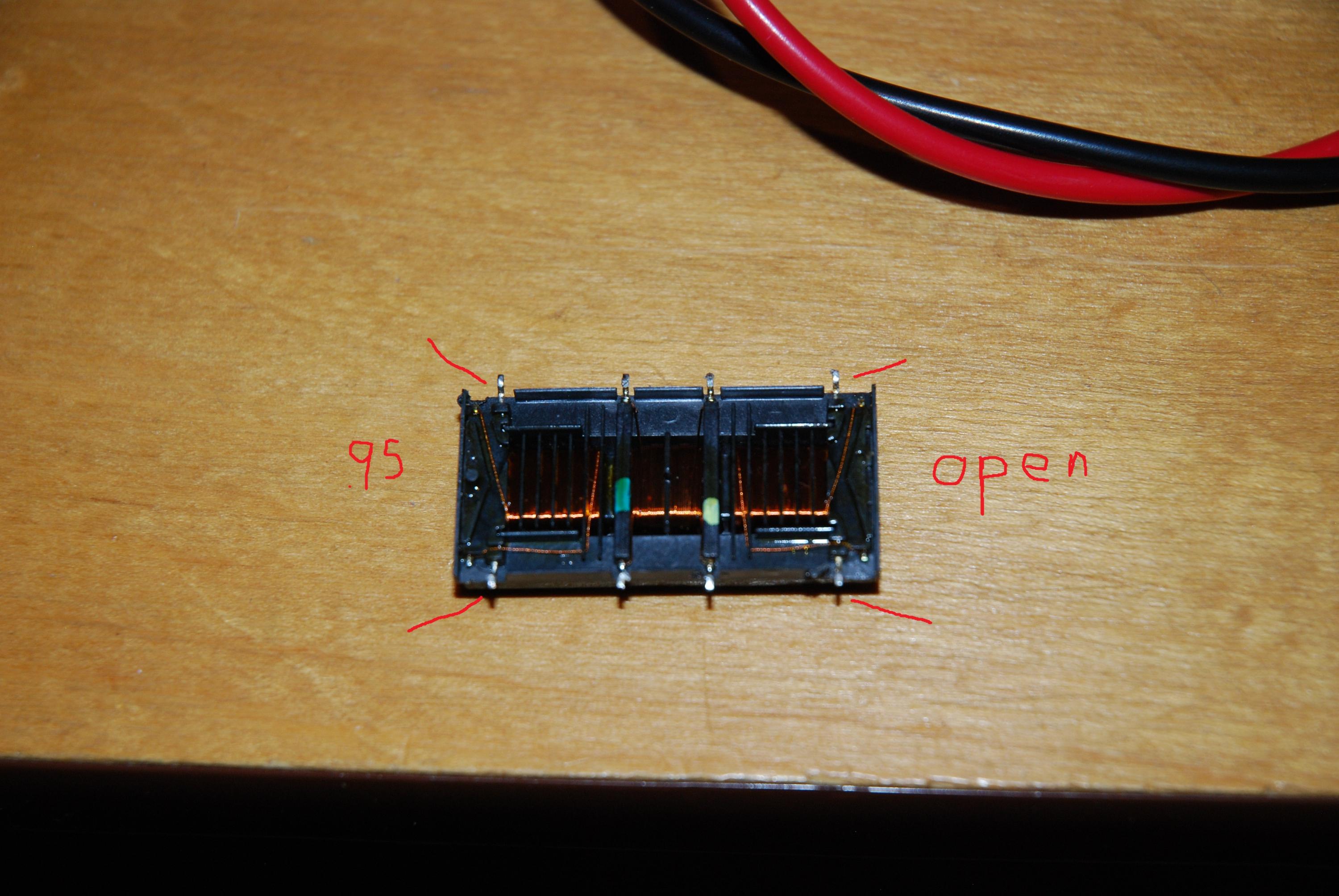

    OK, that looks more reasonable, I would suspect the transformer which has an open winding.

      Nice! I guess I will try that. Thanks for all the help. Is there any way I can test the rest of the bulbs without that bad transformer? Can I disconnect the set that is connected to it? I would like to make sure the rest of the screen is good before dumping any money into it.
        Re: Proview rx-276 2600
        Not really practical, the best you can do is unplug all the bulb connectors except one, plug the TV in, and watch for a flash from each bulb. Repeat for each bulb. But it's really rare to have a failed transformer and bulb at the same time, and failed bulbs nowadays are very rare -- only much older LCD TVs are having issues with them.

          ok good to know. I got the transformer in question off and here are the results:
            It's dead, Jim.
            If you look carefully, you can sometimes see a burn mark on one set of windings.
              lol...ya I looked but can see nothing out of the ordinary. I didn't know that if one is down, none of them will go.
                With an inverter it's either all the bulbs working or none working.
                  Good to know. Well thanks for all the help...it's been great. I'll post back when I get a new transformer.
                    Well I finally got the transformer in...Works perfect! Thanks for all the help!
