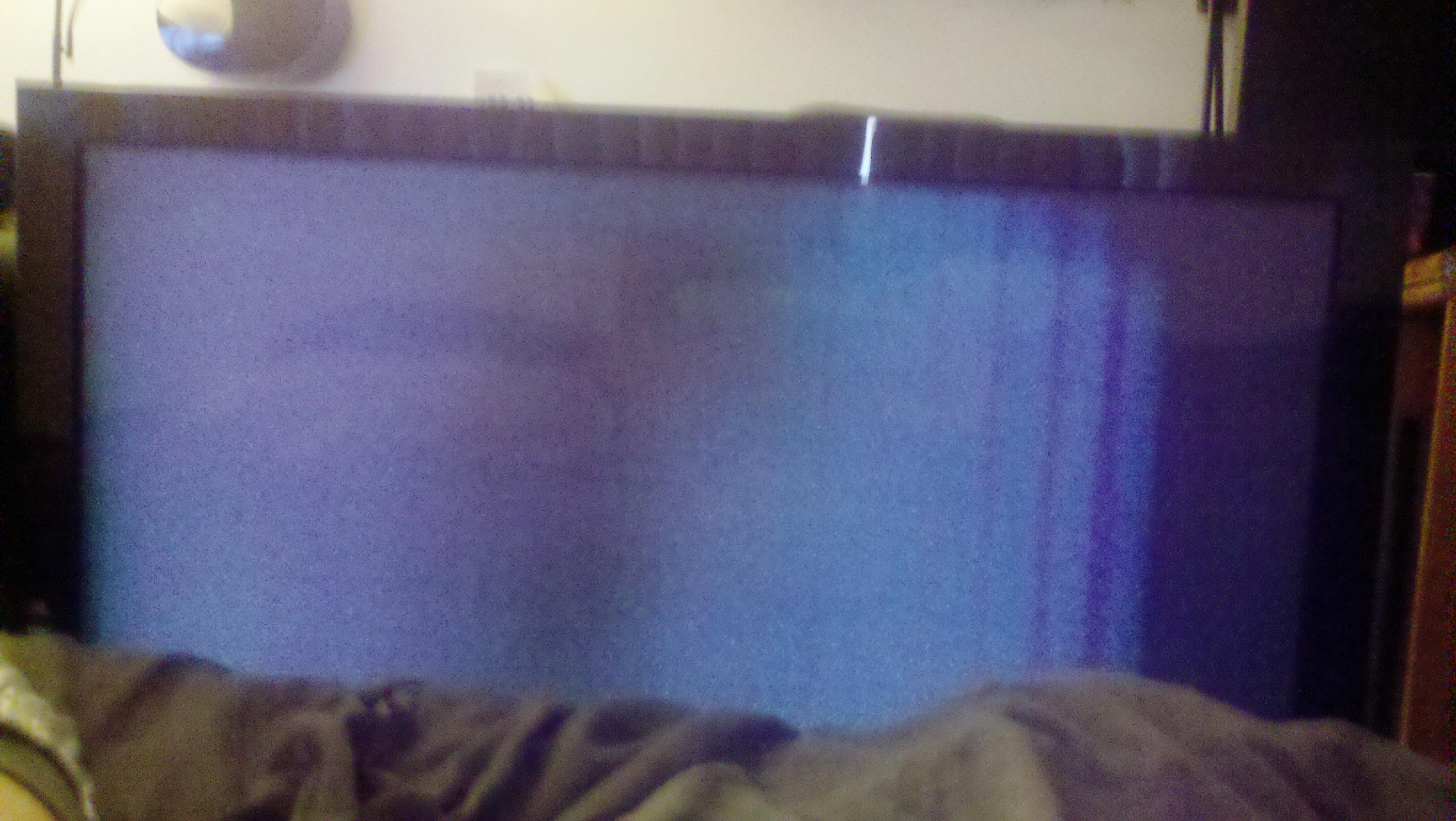

              Didn't work.... Ughh now 1/4 of the right side of the screen is all black. Rest is the same. Few vertical lines and all static. How can I find exactly what board is at fault? Will a volt meter be able to tell me?
                Re: 55" Samsung No Display
                To fully diagnose it you need an oscilloscope. Does the original board do something different?

                      Oh no I just put the old one back in. same thing. Check the picture out. Thanks again sir. I appreciate it

                          I have never seen this symptom before so I'm pretty lost now . I'm pretty sure the main board is OK. I just don't know if it's the Y-main or control board, or even possibly the buffers. I'm leaning more towards the control board but the unevenness in the fault is making me think it's a Y-main fault. Since you have absolutely no image, but the screen is still lit up, I suspect the control board even more. But that's usually not a cheap part. Will Shopjimmy allow you to return the new X-main?

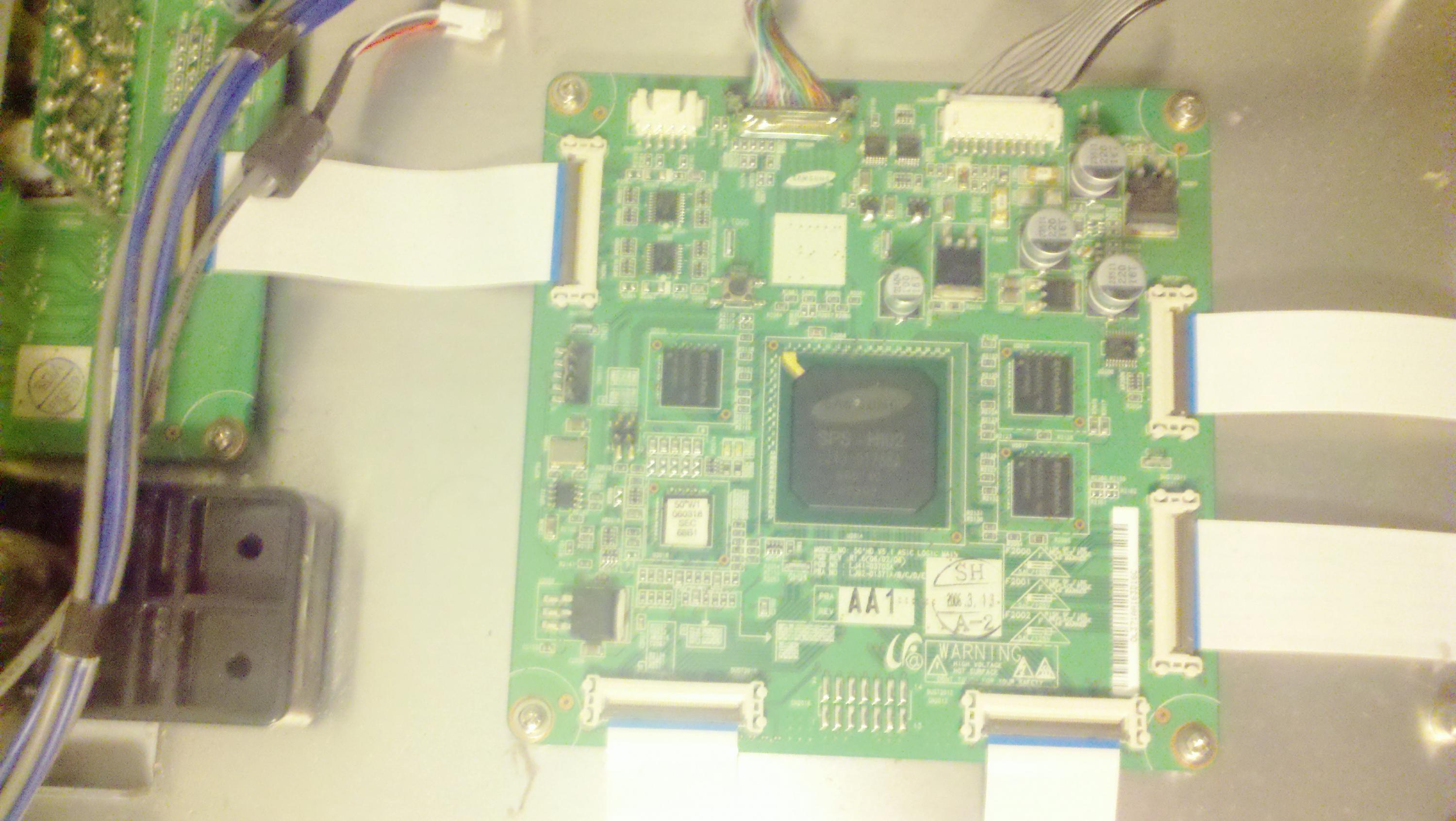

                                    There's a cable goin to the tcon board. This one? Thanks
                                      #38
                                      Yeah, the board on the right is your t-con/control board.
                                      I was talking about the main board (which has the video inputs on it.) The multi-stranded cable goes to the t-con from it; I was wrong about it being flat flex, as this uses a different design.
                                      Unfortunately, looks like the whole main board needs to come out to get access to it.

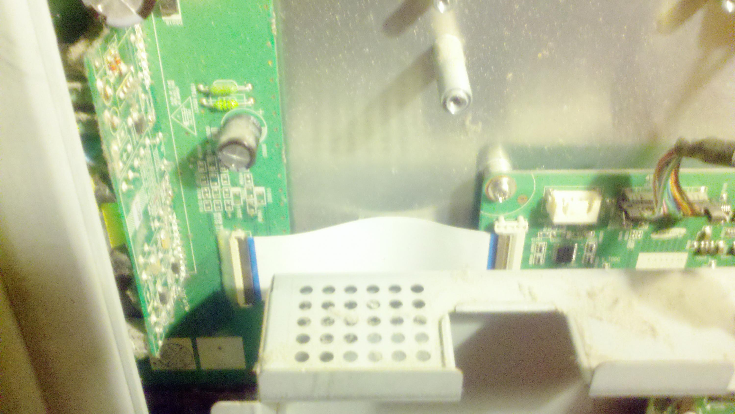

                                          OK, with the main board removed from the chassis, does the set still power on with the weird screen? If not, you will need to find a 100 ohm resistor to control the PS-ON. I see the jumper is present on this board which could be useful.
