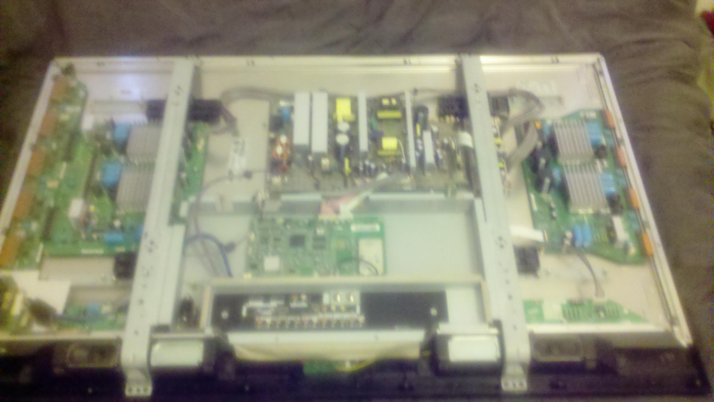

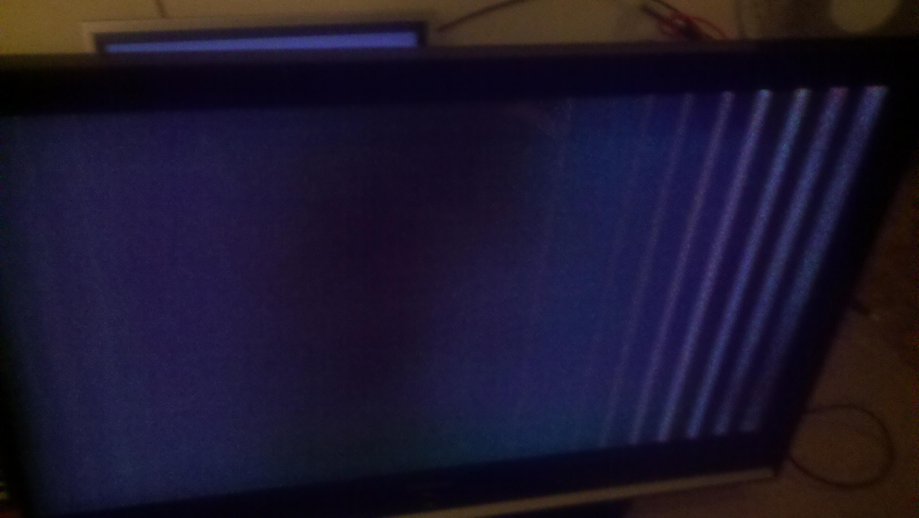

    Hey Im in the beginning stage of fixing plasma tvs. I have a 55" Samsung model hp-S5053. I got it and it was your typical black screen of death. After i opened it up i noticed 3 bad capacitors that i've just replaced. This time when i plugged it in and it powered up it made the start up sound but the screen was static/snow with a few vertical lines going up and down the entire screen mainly on the right side. Also i have no display at all. No menu. No Input. Not even a hint that the buttons are even doing anything for that matter. Ive read into it but nobody seems to have this problem exactly. Ive check all the plugs, caps, and ribbons making sure they are all secure and perfectly placed. Would a new power-supply board fix it? Or T-Con board? Ive attached a photo to hopefully give you a better understanding. The darker areas on the screen are (black) static and the vertical lines are (light grey) static Thanks in advance for your help. Any advice would be greatly appreciated.

                      None were actually "popped" but bulged upwards. And one leaked on the backside a lil. I cleaned the black residue thoroughly before I soldered the new one in. Its just wierd because now the screen does turn on but just no display whatsoever but that awful gray static . Do you know any ways to trace the problem? I won't get to try anything till late tonight but im all ears. Please help! Thx

                        I have had a vaguely similar problem with a Samsung plasma -- it turned out to be the X-main:
                        https://www.youtube.com/watch?v=Bmu12mCOKcU
                        I didn't mention it in the video, but I too had some faded bars and dim light across the panel when viewed in a dark room. And the no signal appeared only after about five minutes. Only certain parts of the display registered any light output.
                        Luckily, the X-main (same as Z-sustain) was very cheap -- I believe less than £15. I got the TV for £50, so I was quite pleased that it was that simple (and later, it sold for £225.)
                        The X-main is the rightmost large board looking from the rear, connected to the panel via ribbons.

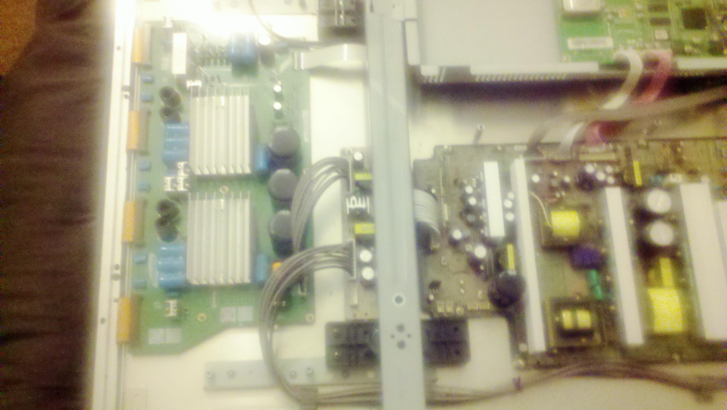

                          Mine doesn't get any image at all but ill look into that. Now just to make sure were talking about the same board I took some pictures. This is the correct one right?
                            Re: 55" Samsung No Display
                            Mine doesn't get any image at all but ill look into that. Now just to make sure were talking about the same board I took some pictures. This is the correct one right? Also a pic of everything for reference.
                              Yep, that's the X-main. (BTW -- Z-sustain is LG terminology, it's X-main on a Samsung.)
                              There's some fuses on it, near the connector going to the PSU.

                                  Alright thanks. Now just curious why that side and not the other?
                                  It might not look like it from the outset but the boards are entirely different parts.
                                  The Y assembly (including the Y-buffer boards and Y-main) on the left is responsible for the Scan electrodes -- essentially it addresses each line in the plasma panel one after another to "write" data to it through the bottom buffers. Then, it works with the X-main to make this stored image appear. It's also responsible for clearing the image so it doesn't get stuck on subsequent frames. (Failures are common with this part.) Bad Y-main = 90% of cases, no picture at all.
                                  The X-main is a single board (no buffers usually) and it is responsible for providing the alternate sustain voltage on the Sustain electrodes. It's also responsible for making the picture light up fully, though you usually see some picture with a bad X-main, it's just very dim or fuzzy. Bad X-main = 50% of cases, you still get a dodgy picture.
