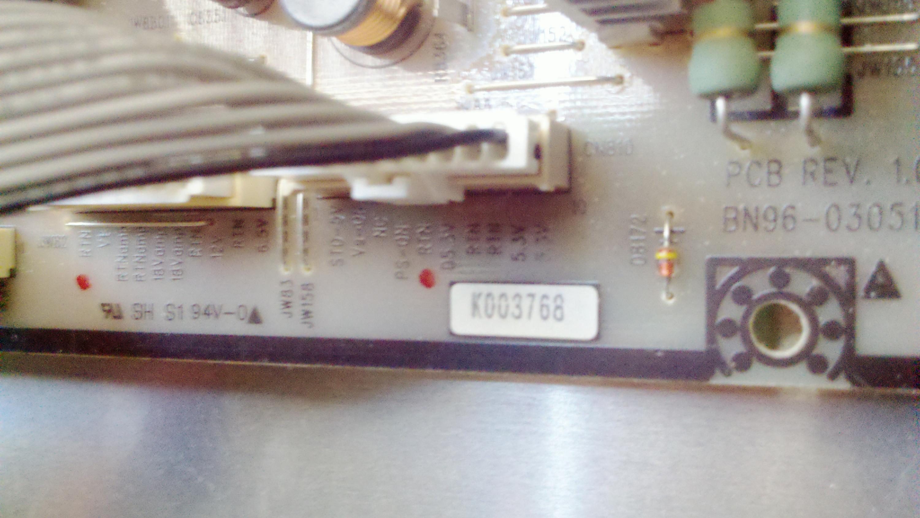

        #43
        Re: 55" Samsung No Display
        OK, the set does not power on, I half expected this, but some Samsung sets will still power on without the main board connected.
        You need to find the pin marked PSON and connect it to the Ground (previously I said 5V standby; this was incorrect) with the 100 ohm resistor to limit the current.
        Here's a thread where someone diagnosed a Samsung plasma with no picture -- including setting up the PSU:
        https://www.badcaps.net/forum/showthread.php?t=21740
        Then, you see that four pin connector on the control board? I believe pins 4 and 3 enable test mode... they must be connected together e.g. using a hard disk jumper or temporarily with a screwdriver or piece of wire.

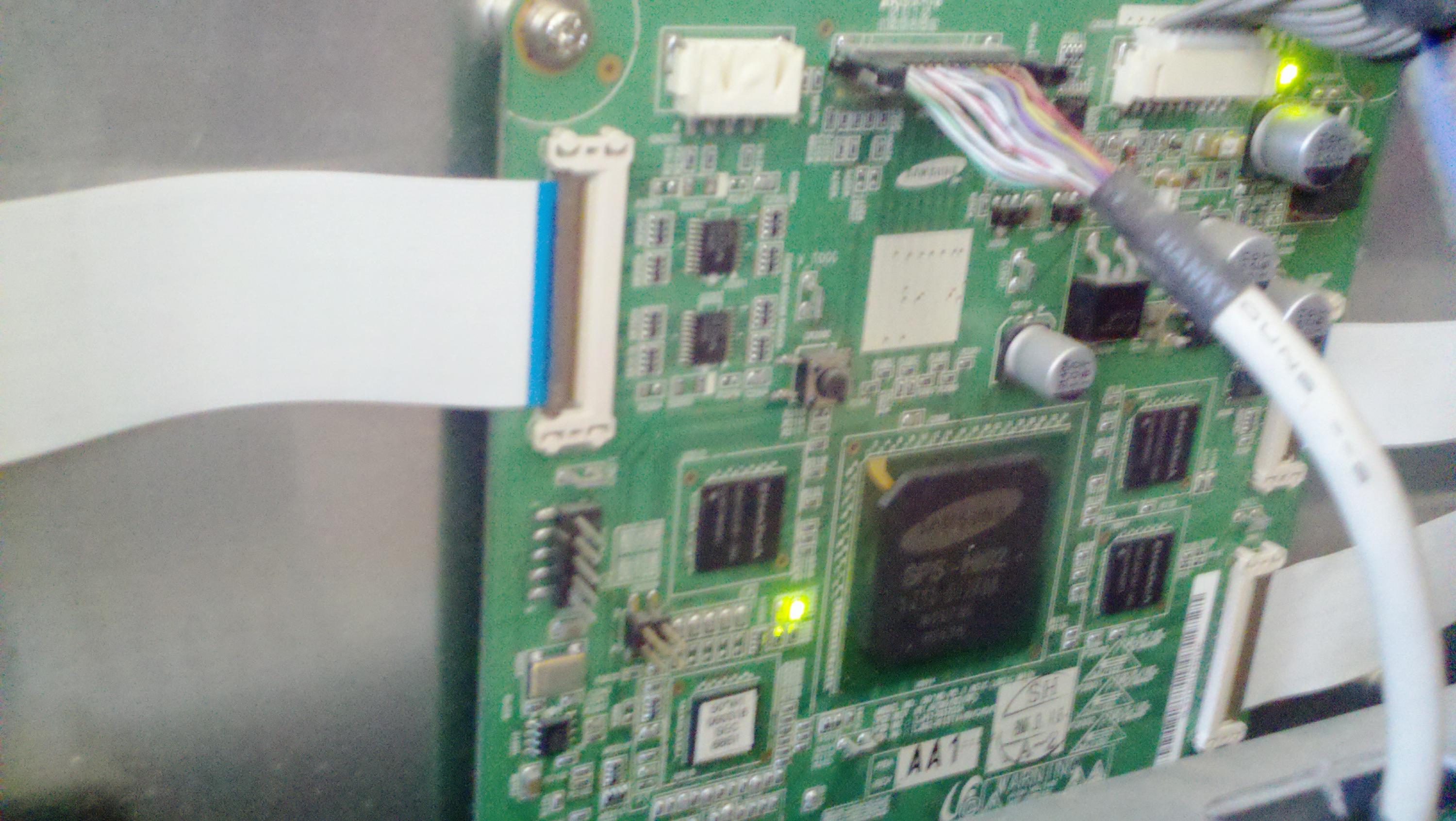

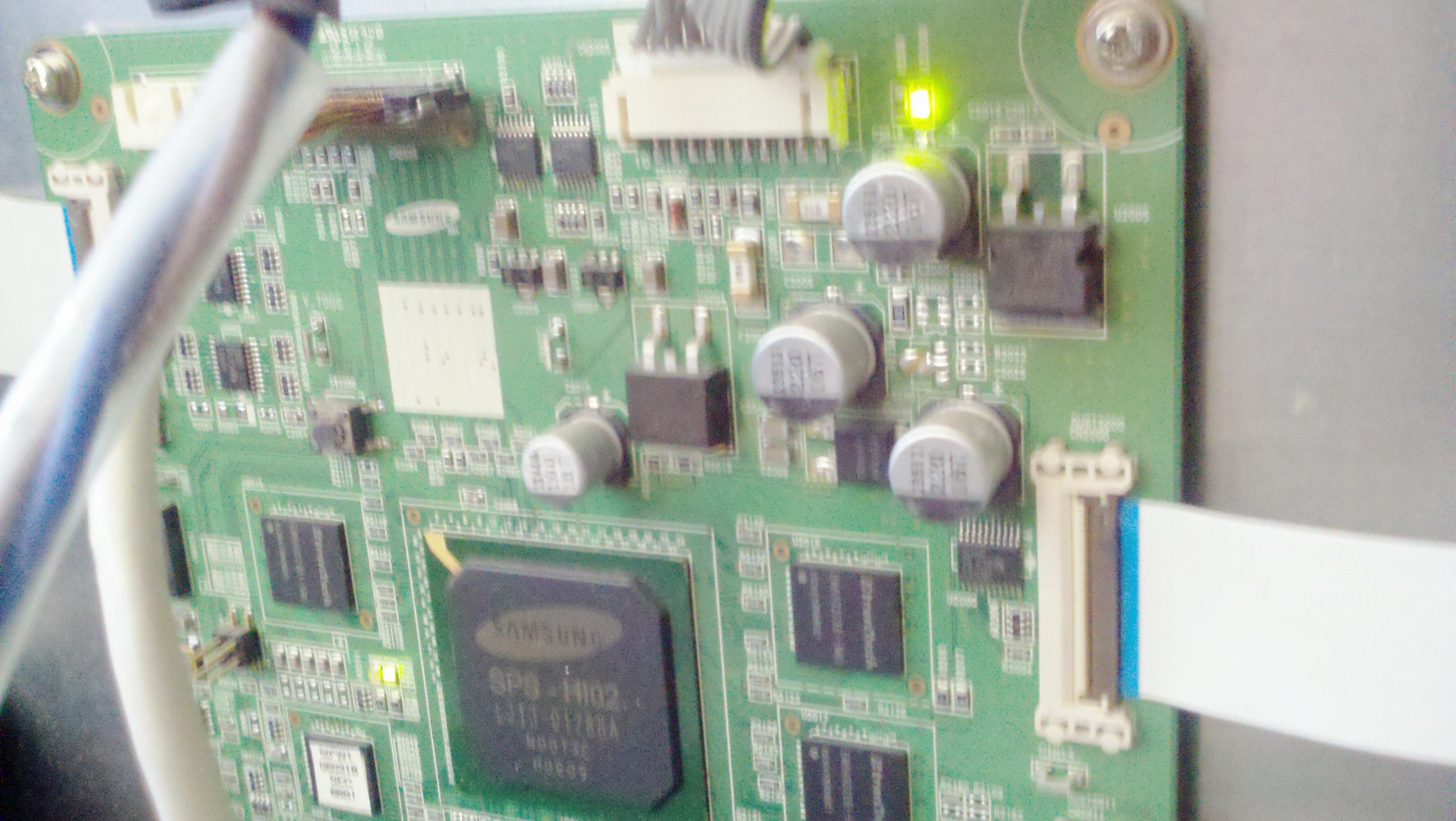

          #44
          so I think I found it I tested the 1 on the power supply board reading ps-on and it read 2.22 v. Standby read 5v. I cannot find the 4 pins on the main board. May need some help findin them. Thanks as always here's a pic of where im at.

                          #52
                          Huh; that makes me suspect the control board, because you -should- see something. Here is what one user reported:
                          Jumpered 4-2: Backlight (or plasma equivelant) would fire on for about 4 seconds then go off.
                          Jumpered 3-1: Backlight (or plasma equivelant) would fire on for about 4 seconds then go off.
                          Jumpered 2-1: Display would power on, show all gray for about 4 seconds, then go off.
                          Jumpered 4-3: This was the good stuff! Showed all types of test patters and then would loop itself indefinitely.

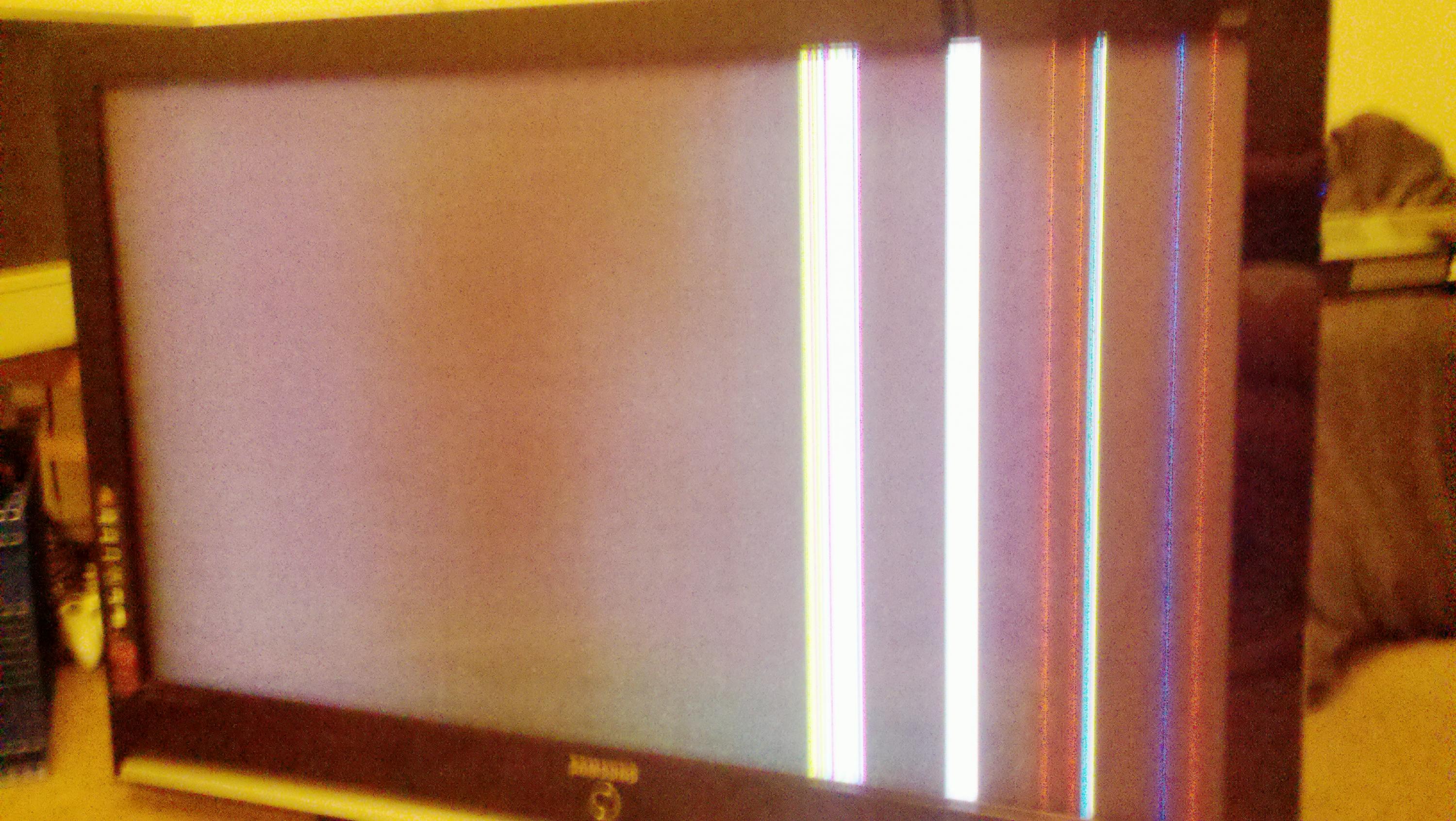

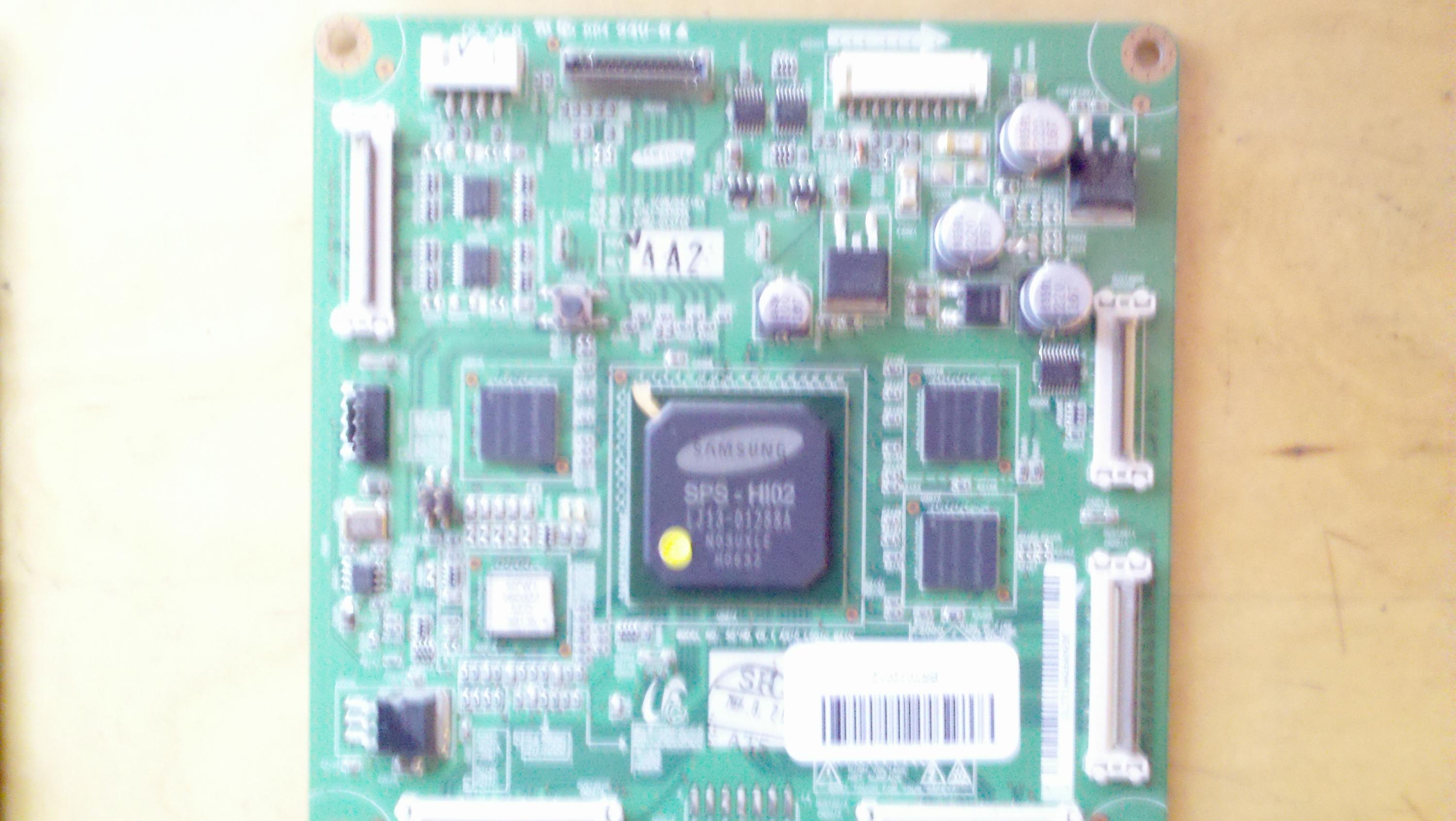

                              #54
                              So I ordered the new tcon board. installed it and fired it up. Now I get this picture. Am I getting closer to the problem? Still gray static with multicolor lines on right side.
                                #55
                                Have you got no picture at all? I am half suspecting the plasma panel is bad with those bright lines :/. It could be a Y-buffer problem but I can't be sure.

                                  #56
                                  Yeah its the exact same as before. No display no picture. Just static and now the vertical lines. Is there a way to diagnose the boards?
                                    #57
                                    Only with an oscilloscope.
                                    Since you have bright light at least the Y-main, X-main and power supply are 99% guaranteed to be working (these only affect the picture - it's either there, or dim, or not at all.)
                                    Since you have a bootup sound, the main board is probably (>90%) OK.
                                    My suspects:
                                    - Y-buffers (60%)
                                    - Control (30%)
                                    - Panel (10%)
                                    You replaced the control board, and the light is brighter. Is the model on the control board exactly the same?

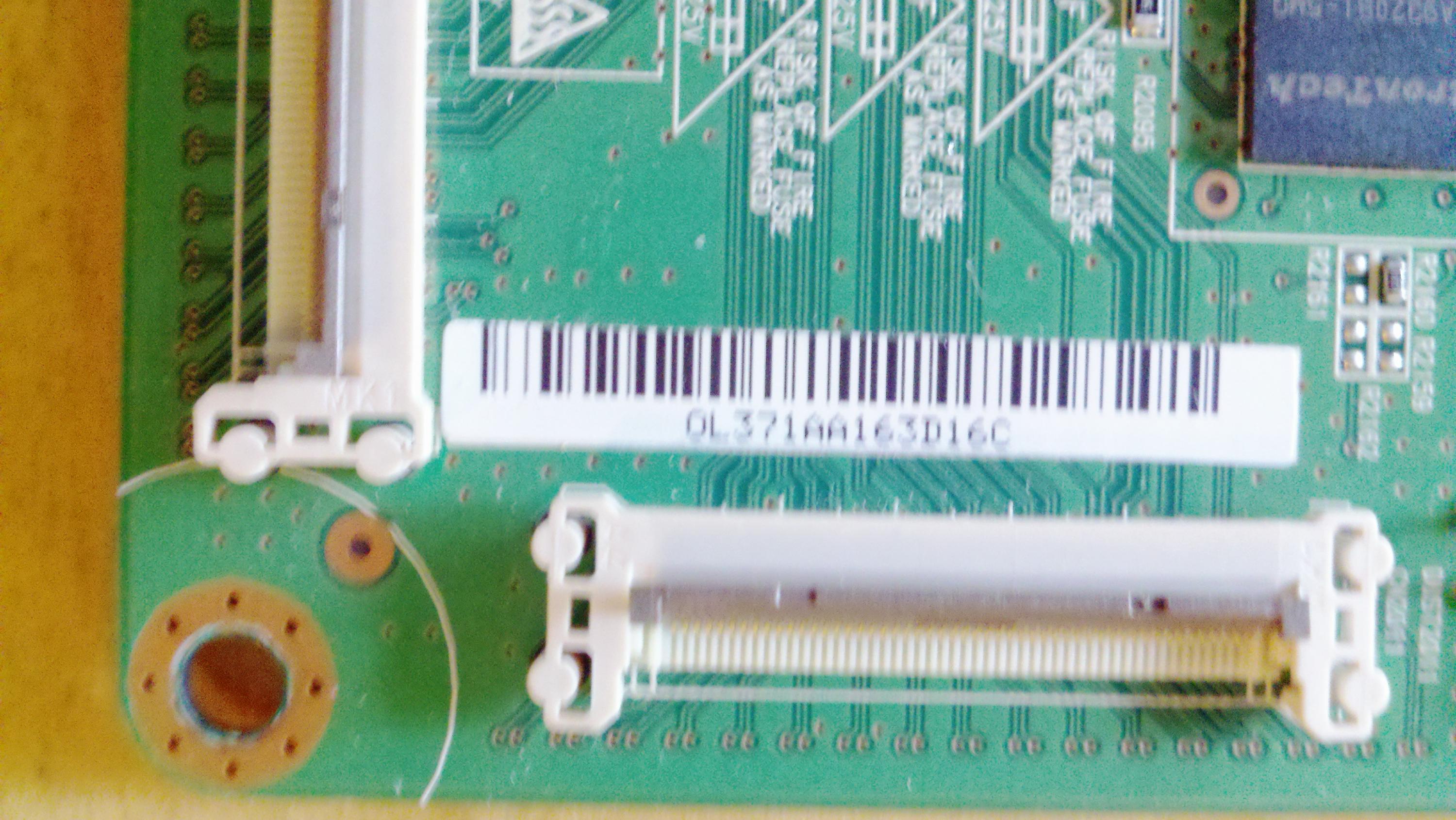

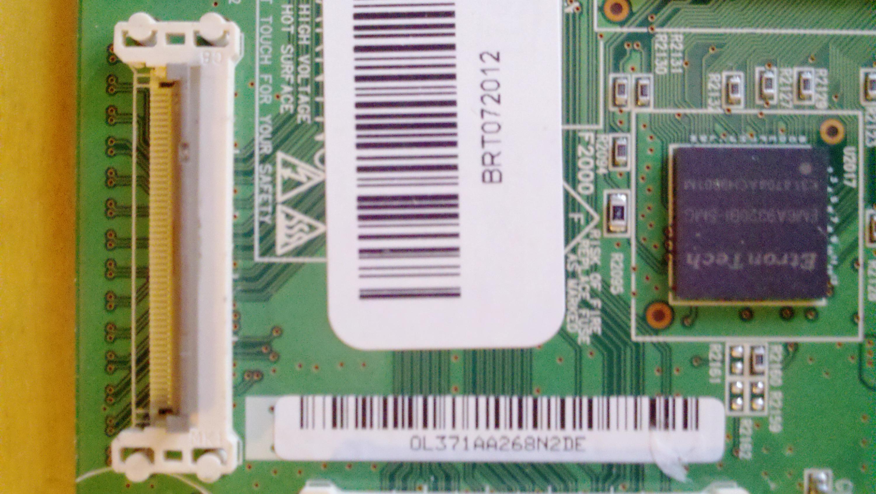

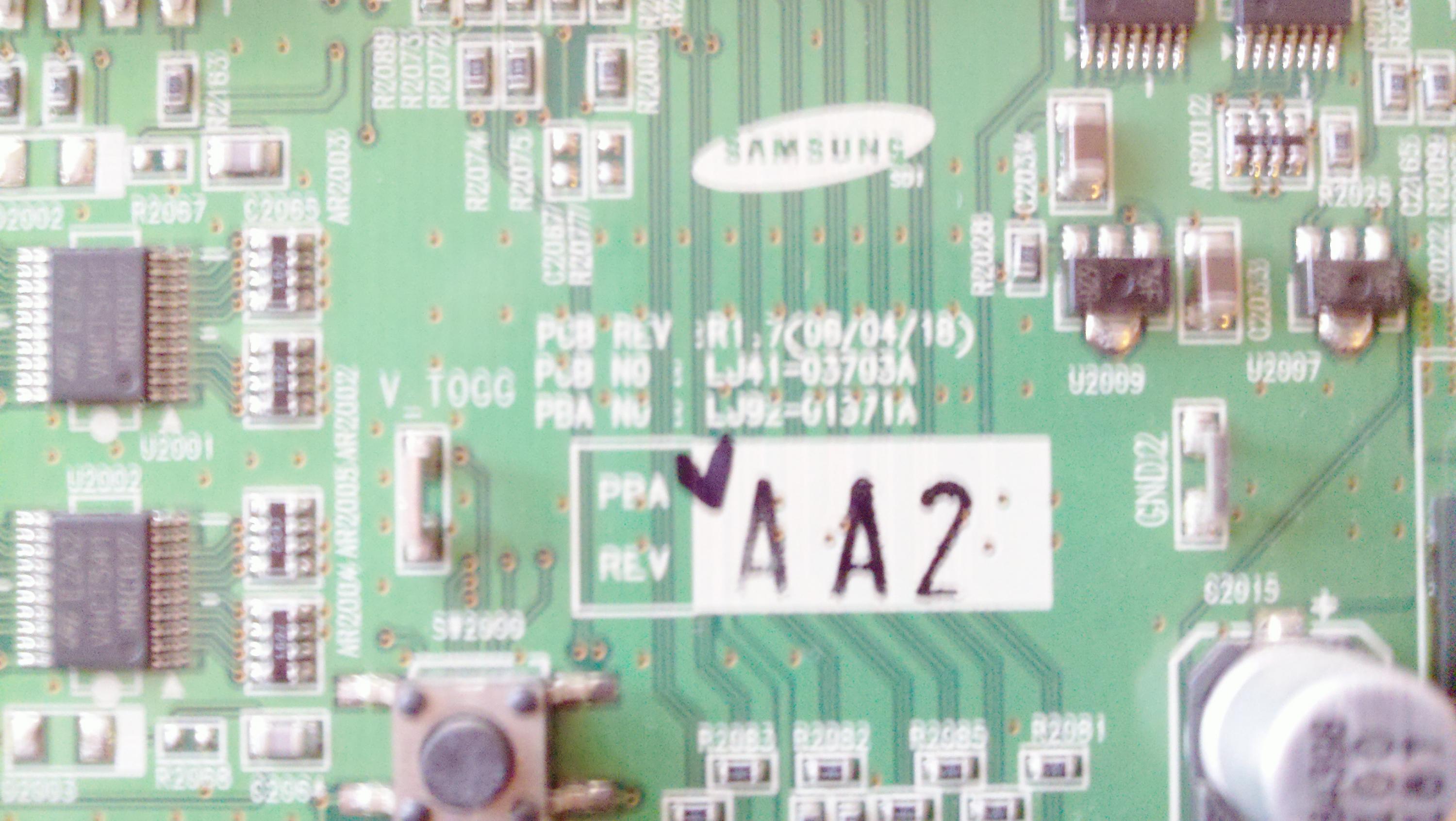

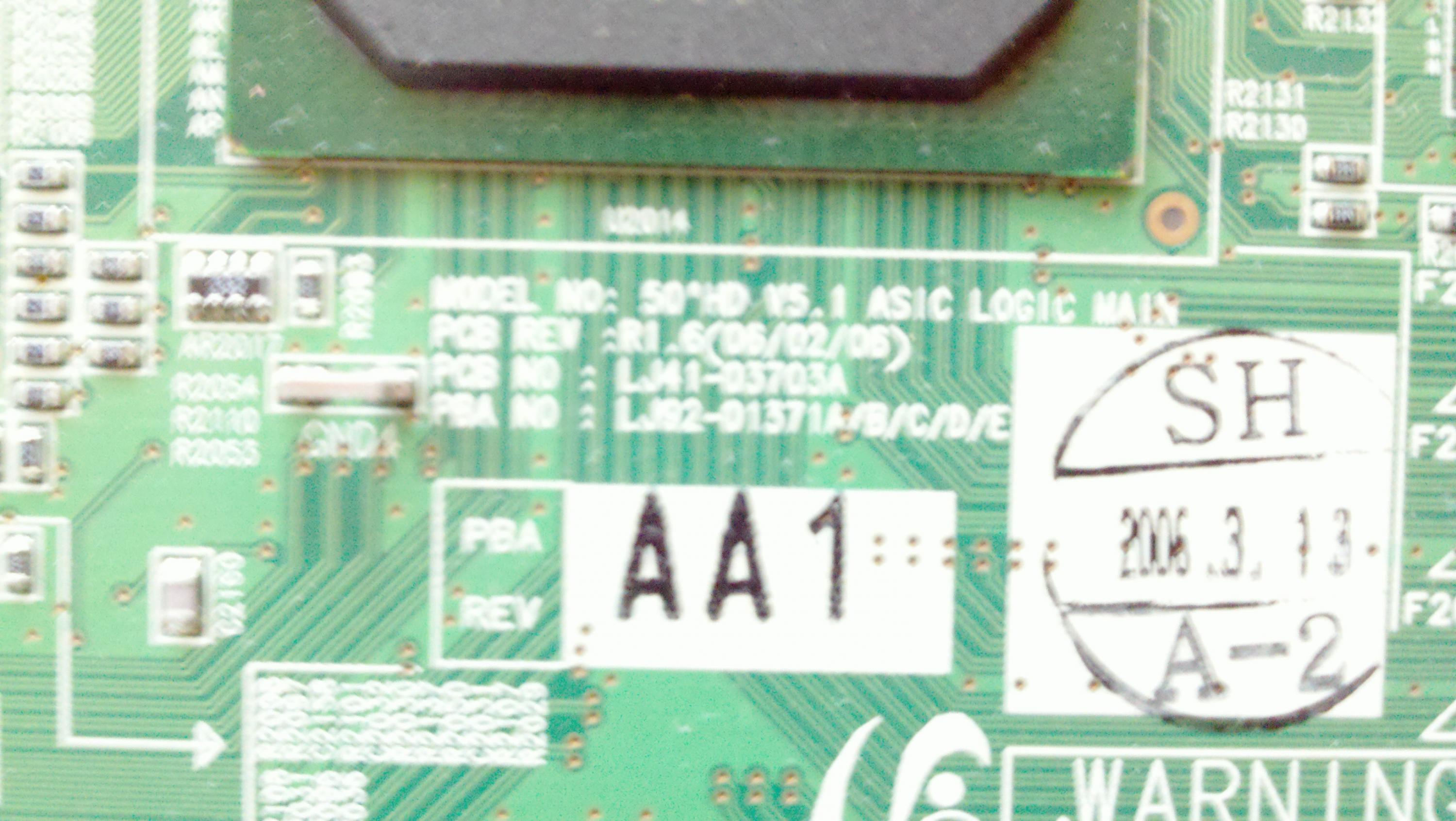

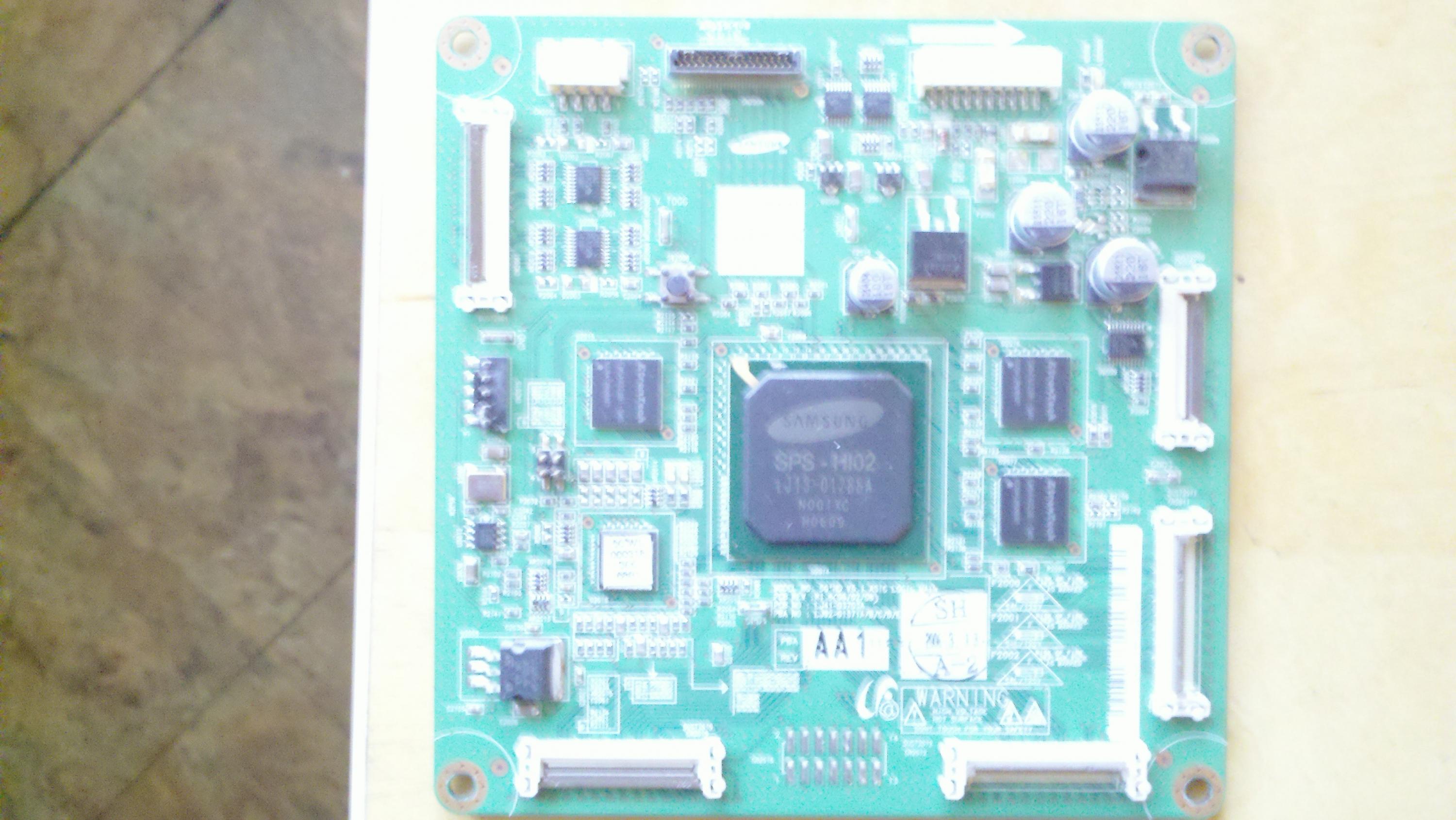

                                      #58
                                      Sorry yesterday I was so busy. Now after looking I did notice some differences in the control boards. 1. On the orignal there is AA1 and the new one reads AA2. The pba # is the exact same on both. The pcb # is the same too. Only difference I can find is the AA#'s. I attached 3 pics of each board. Hope this helps. Thanks again tom.
                                        #59
                                        That could be important, as I have heard that Samsung plasmas are very sensitive to revision numbers. I am well out of my depth here though, I've only done two Samsung plasmas... I mostly do LG chassis. Have you asked the seller if they can supply an AA1 to be sure?
