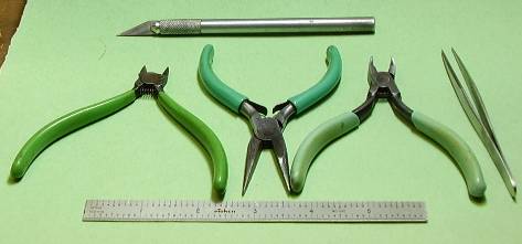

                  Re: 42" VIZO Television Will Not Power On
                  Originally posted by Cubone222
                  OK budm. I will try and replace U2. I will replace U8 even though it is within tolarance. It seems to be getting bad although it is still OK. I hope that an 80W iron will be suffient. I have zero sodering skills. But youtube has got me somewhat prepaired. I will post back after I do said repair. You are very helpful. Thanks.
                  I use a 25 watt pencil soldering iron, also solder wick. you can try the heat/add solder and slide method but be very careful of surrounding components, like the little resistors, don't let the iron near them if possible. the solder wick or solder sucker method is ok but then the legs/pins of the regulator want to stick to the trace and when lifting it off you can pull up a trace with it. I hope all goes well for you.
                          I cut the two legs off, no need to try to remove bad part as a whole.
                                I can't cut the three pins; I can't wick the solder. It's a nightmare!
                                    Do you have soldering paste? if so put some of it on the end of the wick you are about to use, lay the wick on the leg of the regulator, then put the soldering iron tip on top of the wick, it will draw only some of the solder out, cutting the pins or legs would be best but you need very small side cutters or dikes, then you could heat the tab last and grab the plastic body of the regulator with needle nose pliers or pry upward with a flat blad screwdriver while heating the part. be careful not to have the trace circuit stick and lift up with the part.
                                    OR Actually this may be the best method.... Flux or Soldering paste is as must, use a lot and apply to all 3 pins and the tab of the regulator, heat all 3 pins and the tab keeping them hot and apply more solder to all of them keeping the solder melted, then slide the part away from where it's mounted. (Don't slide towards the small resistors, go the other way), you should then be able to remove it, then the last step is to clean the pads where the part was soldered on the circuit board with the wick, then solder in the new part by adding solder to one pad and one pin of the part, lay the part in place, heat only that one pin melting the solder, let it cool then solder each pin and the tab individually.
