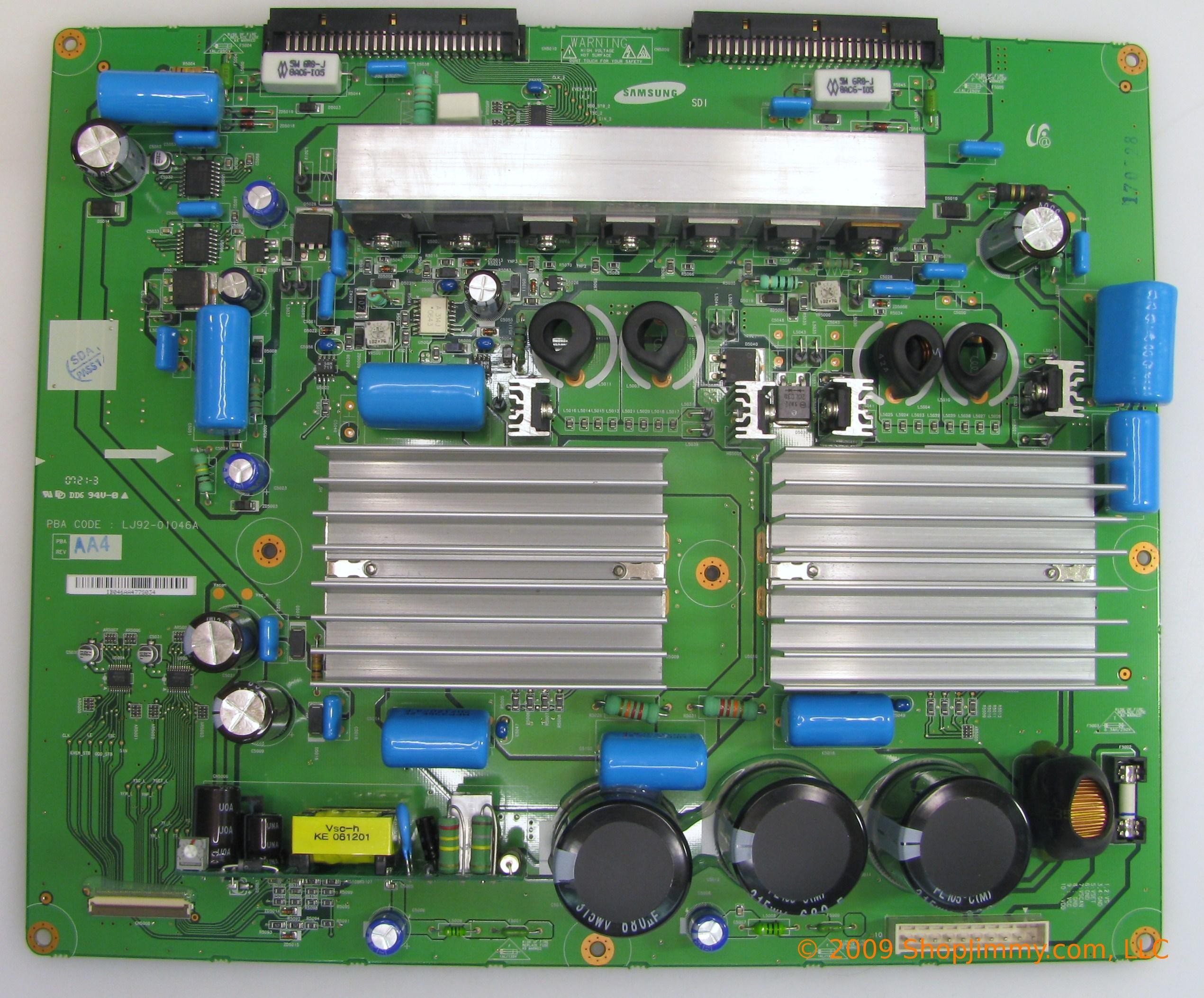

            I think this is your problem then, can you post a picture of the Y-sustain?

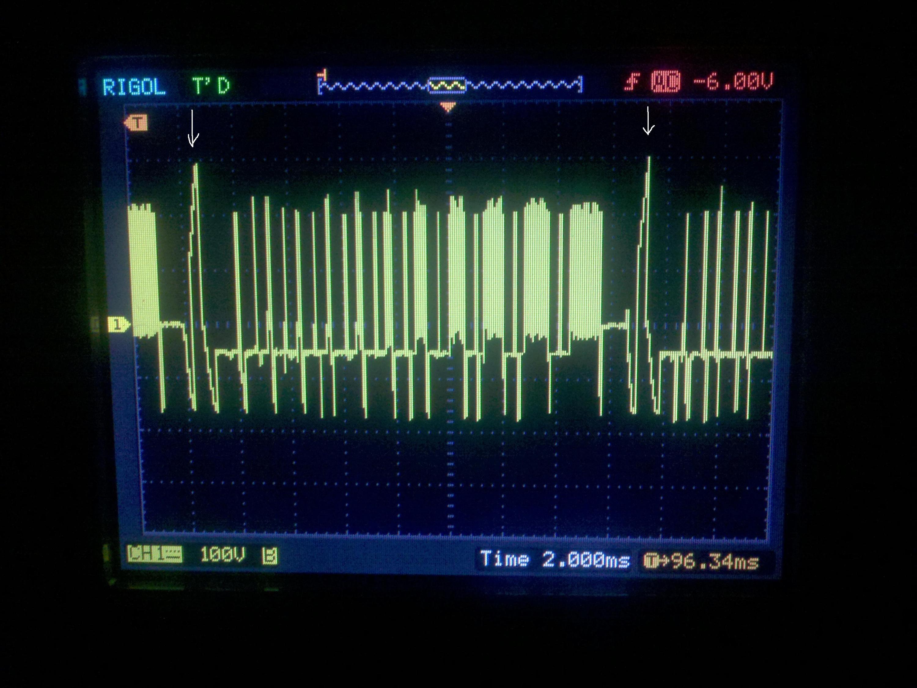

                  I couldn't get a good shot of the actual board in the tv, but here is a shot of the exact same board along with a screenshot of the waveform.
                    Re: Vsetup voltage in a Plasma Question
                    Ah, nice Rigol - I've got one of those.
                    You can actually set up a slope trigger in the trigger menu; set the two thresholds and then set the "greater than" and "ramp negative" modes. This will trigger on the negative ramp, which makes plasma diagnosis so much easier.
                    Also, go into the Acquire menu and turn long memory on if you haven't already. Then, if you press RUN/STOP, you will be able to zoom into the individual subfields to inspect them individually.

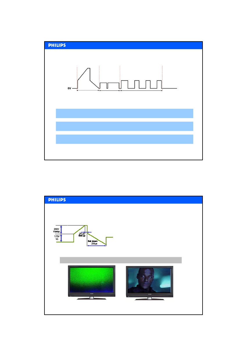

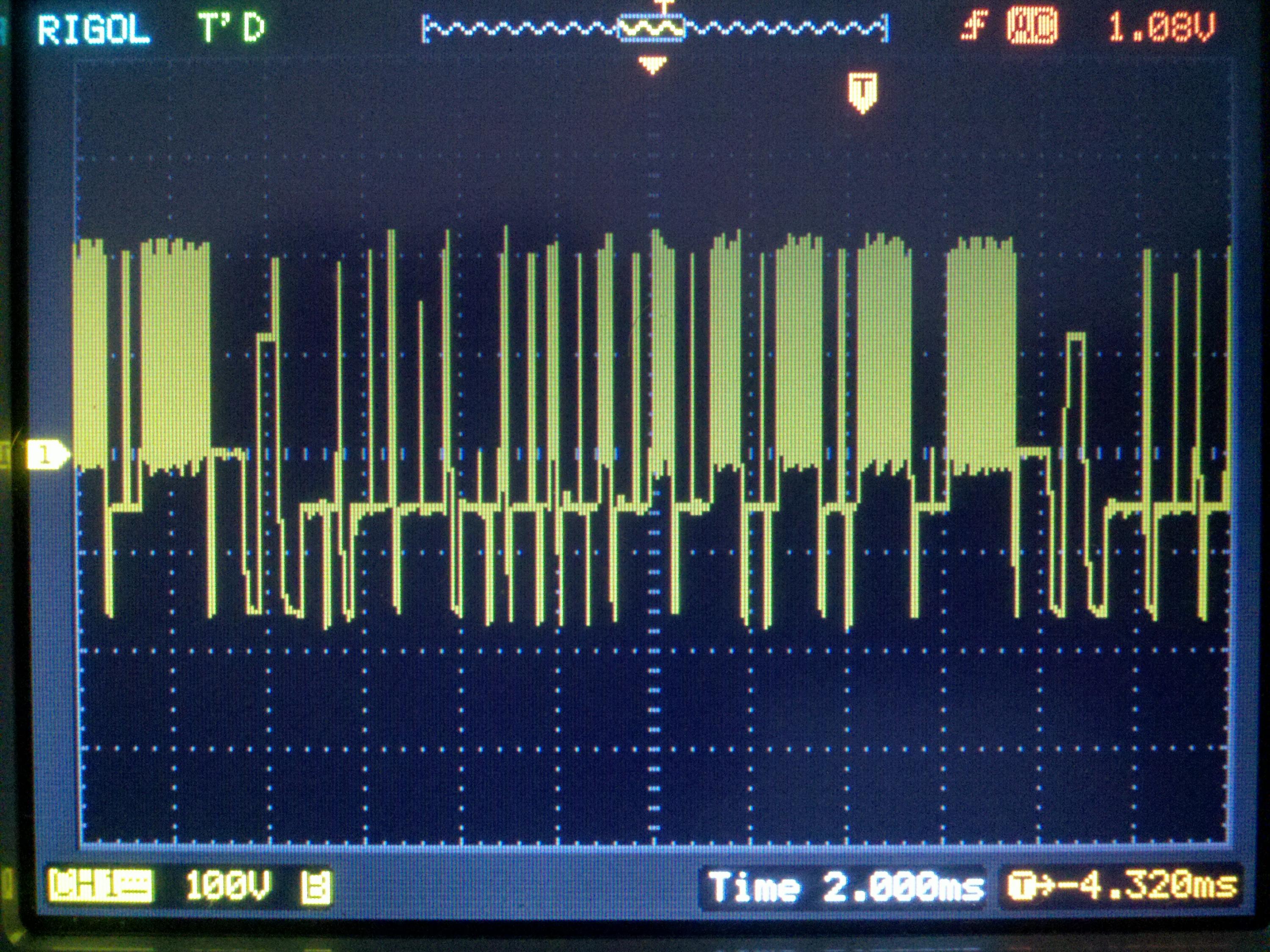

                          UPDATE: For those who might come upon this thread in a future search, the Vsetup (Vrr) voltage was indeed missing. The first pic shows the original waveform with the Vsetup missing and the second pic shows the proper waveform. According to the Philips training manual on plasmas, if the Vsetup voltage is weak or missing, image retention will occur which is the problem I was having. Now, the 195V Vsetup was present at the Y sustain board, however, the drive signal was missing from the logic board. An smd resistor array on the logic board had one open resistor preventing the drive signal from making it to the Y sustain board. In addition, there was an smd zener diode across the gate-source junction of the Vsetup output MOSFET that was shorted. I'm happy to report that this 7 year old plasma is working normal again.
