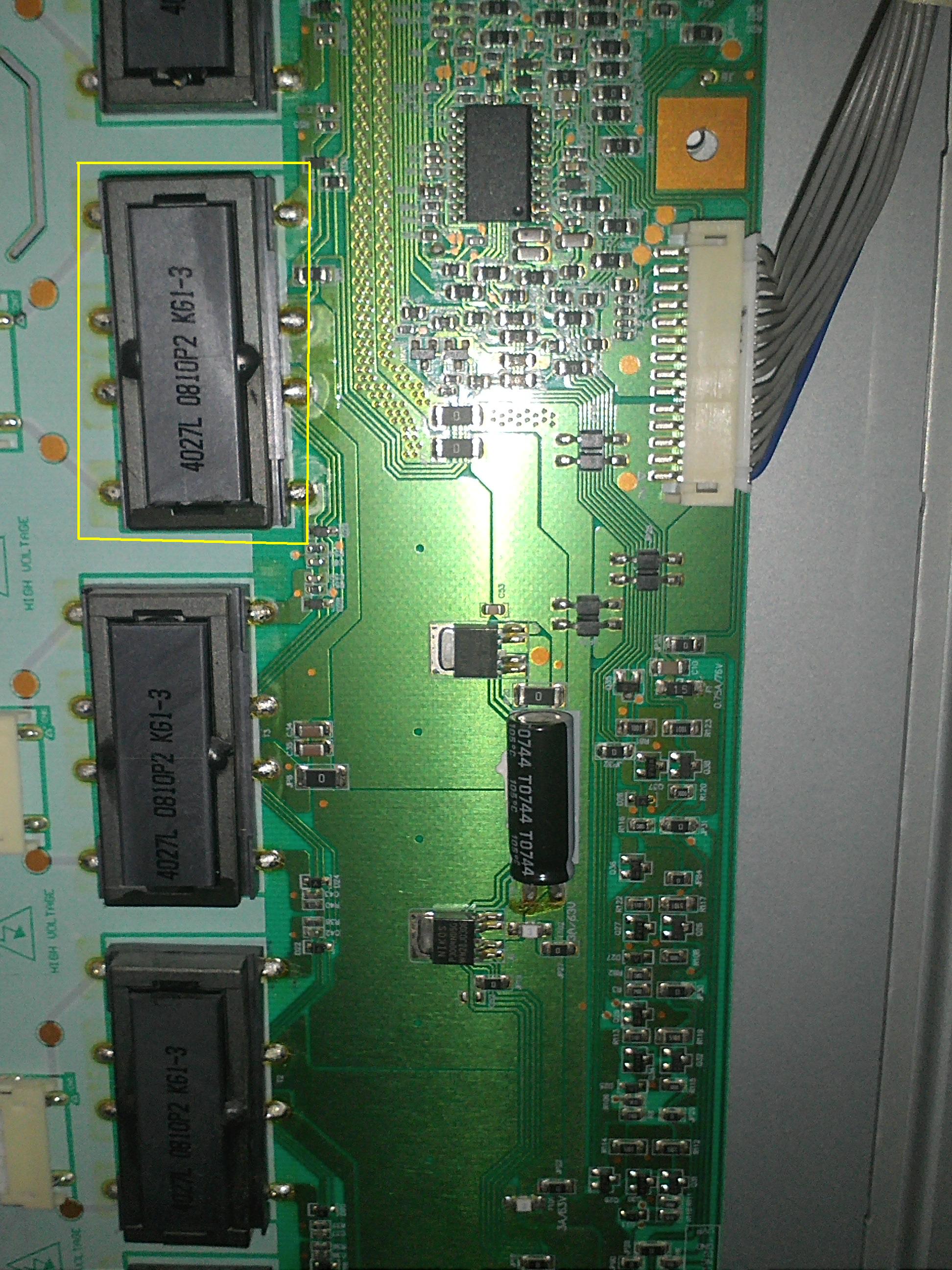

      what about the other spots i highlighted they look burnt too?? Should i just order a new board?

          Re: 42" LG no backlights
          the one spot is not where a jumper is. i circled where it is on the pic. That part also makes a strange noise when i plug in the television. It is the first one on the top of the board. not the one pictured

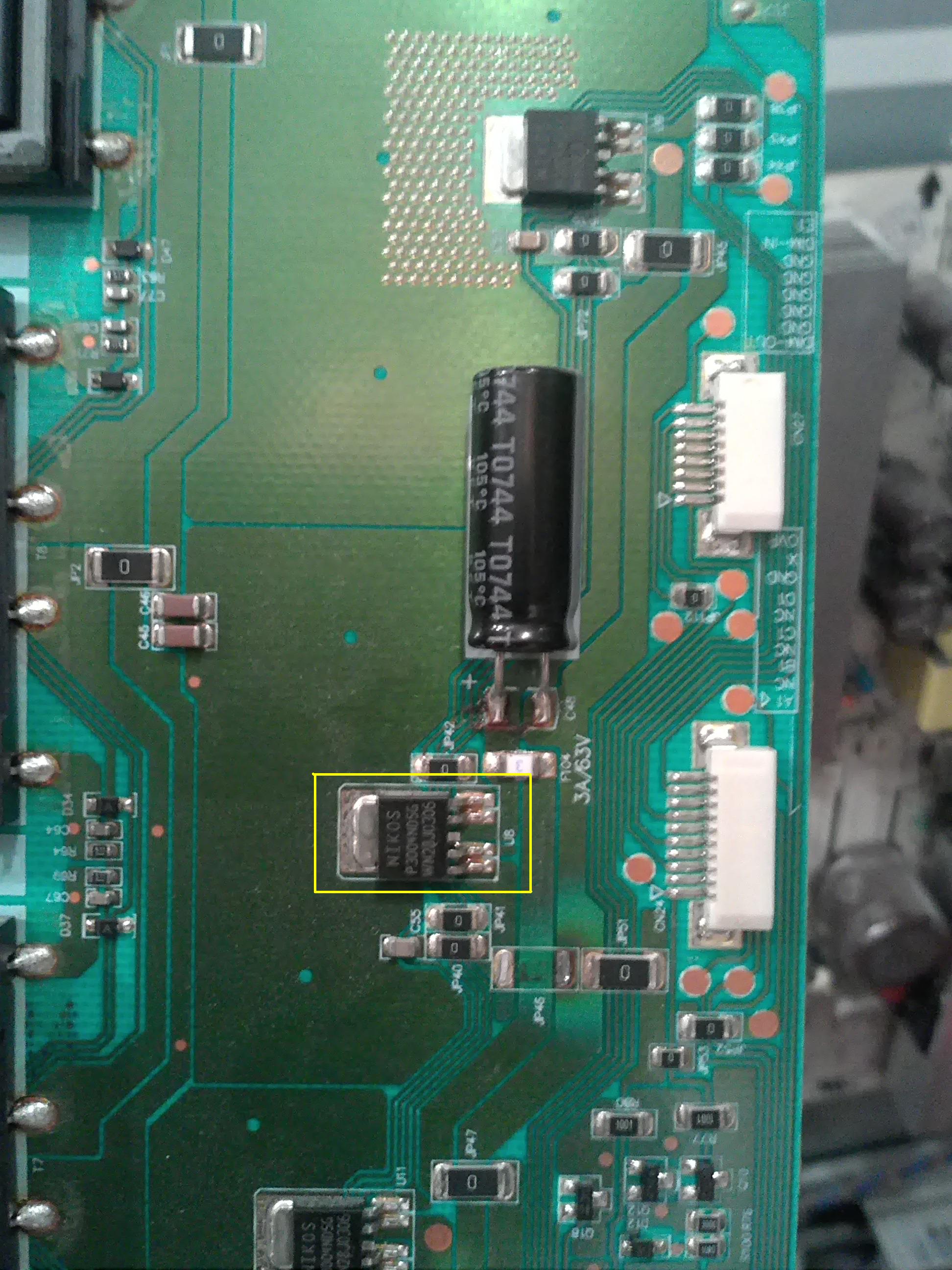

              That burnt jumper supplies the power to U8. That part has 5 pins, so take the resistance reading between all the pins, with the big tab on top, make the left pin as pin 1, then take the reading between pin
              1&2
              1&3
              1&4
              1&5
              2&3
              2&4
              2&5
              3&4
              3&5
              4&5
              The transformer you have circle, you will have to do the same resistance checking between all the pins and compare the readings to the one next to it. I did not find the pinout of the transformer yet.
                              You can see it in your picture in post 18, it is a 5-pins MOSFETs. it has that burnt jumper copnnected to one of its leg.

                                  #36
                                  this one right
                                    #37
                                    That is it. Test it per post 26.

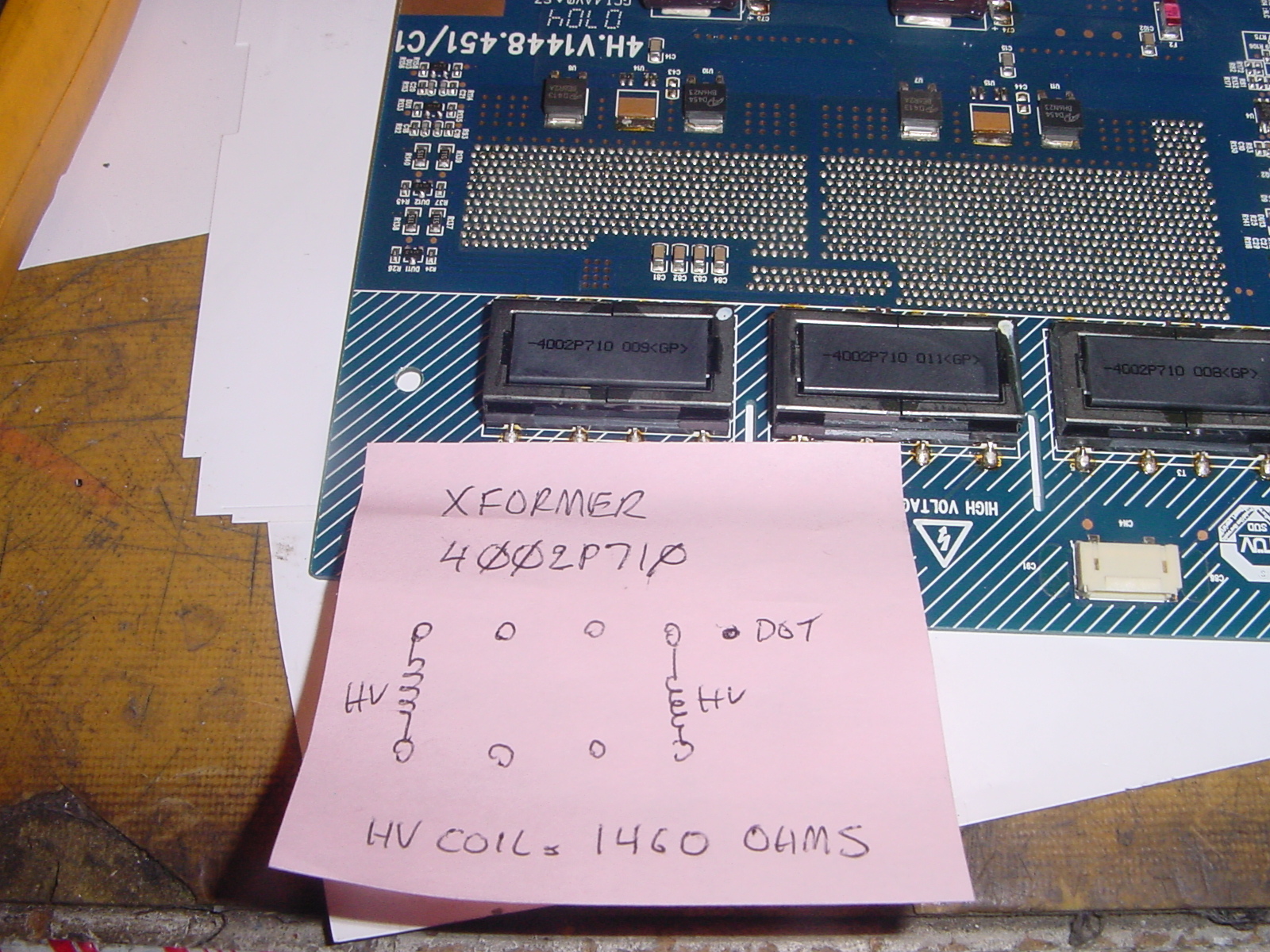

                                    Your transformer pinout may be like this for the high voltage windings:
                                    http://s807.photobucket.com/albums/y...t=DSC01034.jpg
