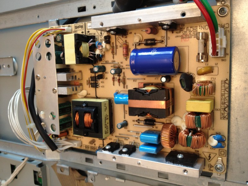

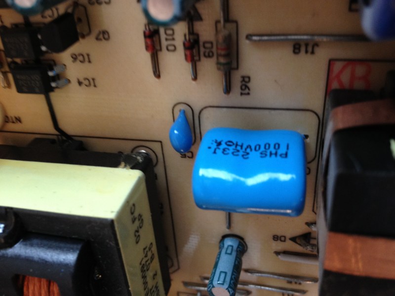

    I'm suspecting an inverter problem(HPC-1655E), but also wondered if this cap(see photo) should look this way(Is it a capacitor?)that is on the PSU(FSP204-2F04)-Seems a bit bulgy?

    I think that cap is OK.
    Check if you have 24V going to the inverter(s) on the display panel.
    It looks like an FSP PSU board and the caps look like Lelon. They could still be failed.

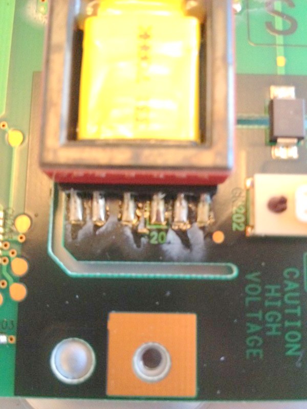

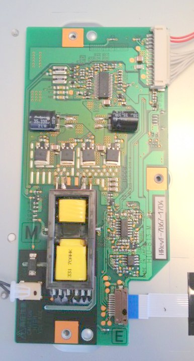

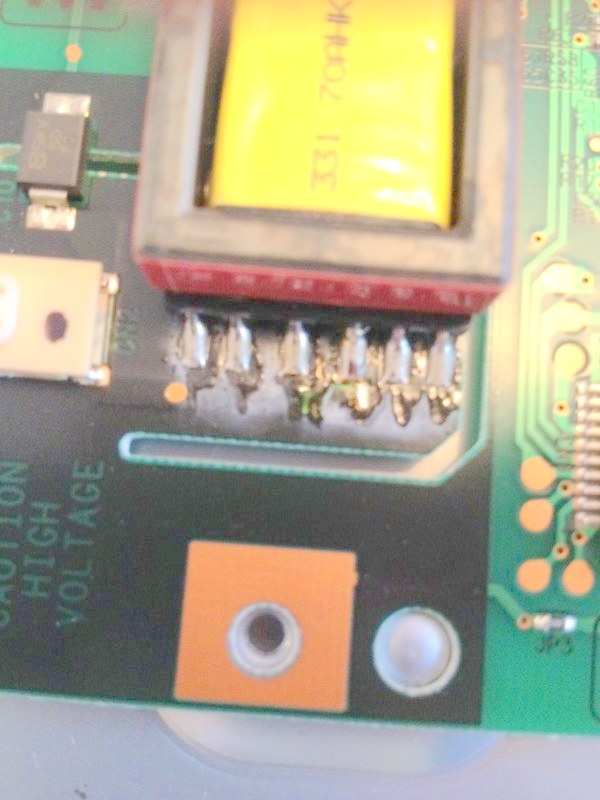

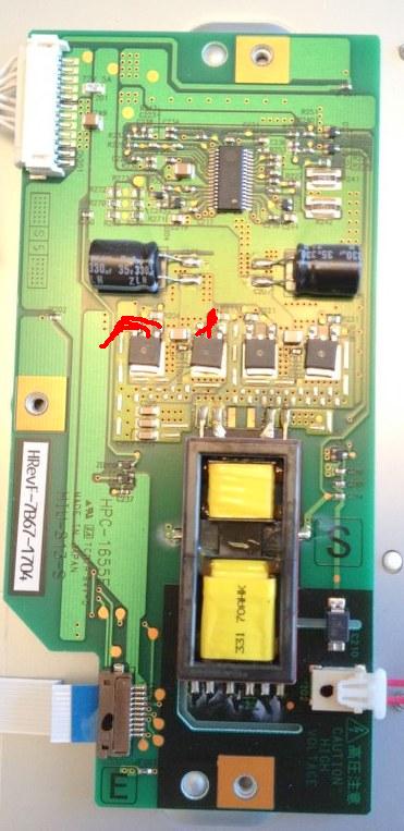

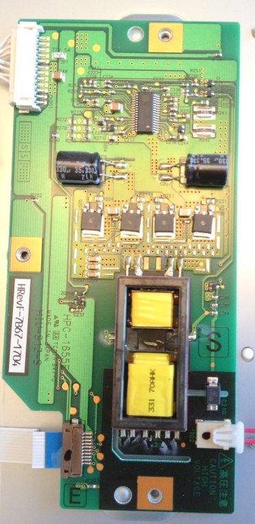

              Here is a photo of the master, then slave inverter, and also a close up on the pins of the transistor.Is this scorching normal?
              I can't see anything obviously wrong, and although I have a multimeter, I havent prodded it anywhere yet(Wouldnt know where too, but eager to learn)

                  Any help guys? The are HIU-813-m and -s inverters.

                    Have you tested the FETs for shorts? Just test between the three combination of pins. You're expecting infinite or near (hah) for most of them.

                      Matt I literally just got done replacing same inverter boards in a Toshiba 32AV500U. Here is another thread on it:
                      https://www.badcaps.net/forum/showth...light=32AV500U
                      The quick story:
                      -I had no backlight when I first got the TV.
                      -Shined a light in saw the pic..
                      -2 Mosfets were shorted on slave board aswell as fuse.
                      -Seems to be a common issue that mosfets and inverter IC fail. They sell them on ebay as a kit, 4 mosfets and the IC. Ordered and replaced parts.
                      -Intitially it didn't fix it, I reflowed the solder on the IC and had to leave, when I came back TV lit up and worked for about 2 hours then backlight went out again. Fuse was still good and mosfets did not show shorted.
                      Ordered 2 new inverter boards for $28, just got them today and installed about 20 mins ago, so far so good.
                      Assume some other nearby component was damaged on the slave board and shutdown circuit seems to be very sensitive. I just chose to replace the boards which in hind sight would have been more practical but I wanted to give it a shot..

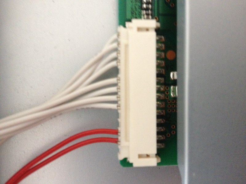

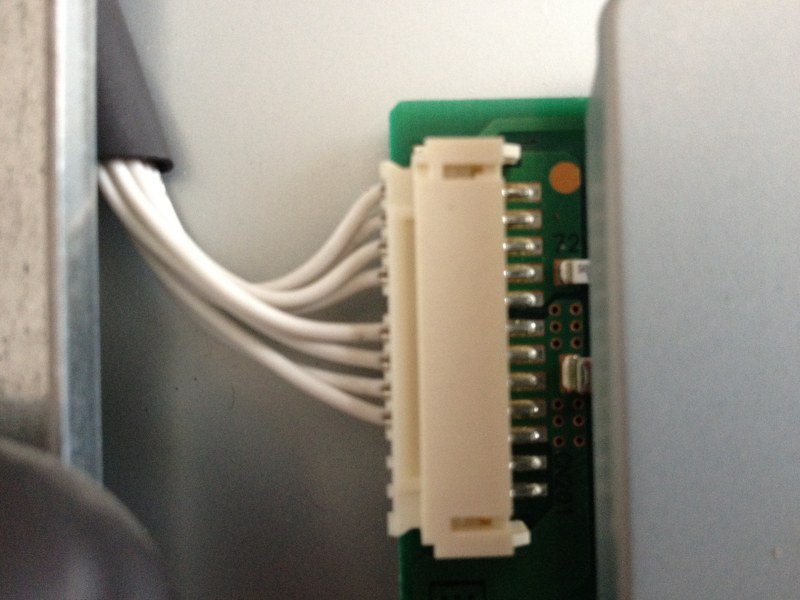

                        Can we get good closed up pictures of the multi pin white connector of both Master and Slave inverter boards?
                          Re: Bush LCD32TV07HD no picture
                          Ok, here are the photos as requested.Master is the one with 2 red wires.

                                    Matt with the back off the slave inverter is on the right side. Set your meter to ohms and check between these pins (I believe it is left and center pin) and see what you have. If it's shorted it will be close to 0 ohms.. Check the Master if not. The IC is 32 pins you will probably want to repalce the whole board if one is shorted.. BTW this is a common failure on these inverter boards..

                                      Hi Kevin,
                                      Many thanks mate, you are spot on!
                                      Do I just need to replace the slave board, or both?
                                      What would the reason for the short be? Could the next board blow if I don't check something further up the line or is it just a case of bad/worn components on the inverter?
