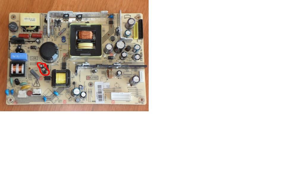

    Repaired this set for a friend..its fault was stuck in standby with front led flashing orange..the psu is a vestel 17PW26-4 & the start up caps were at fault..a quick n easy fix with new caps fitted..just thought id share this for others who may have this psu with similar fault..thx
    Re: Alba LCD32880HDF stuck in standby
    Nice fix! Oddly I've never had a bad electrolytic cap on a Vestel... everything else goes before the caps do!
