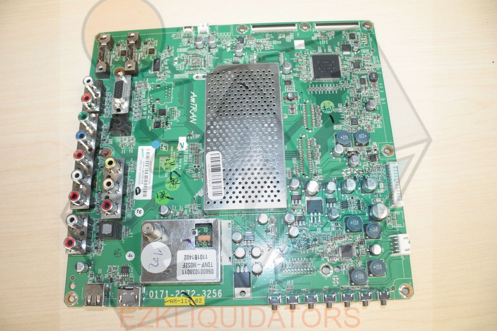

              Re: Vizio E470VL Dead
              Sorry no pics yet, But the board looks just like this one.
              http://i.ebayimg.com/t/Vizio-47-E470...e+g~~60_57.JPG
              No burn/cracks anywhere on the board but it does have that faint electrical smell. I havent tested anything else yet due to alot hours at work.
