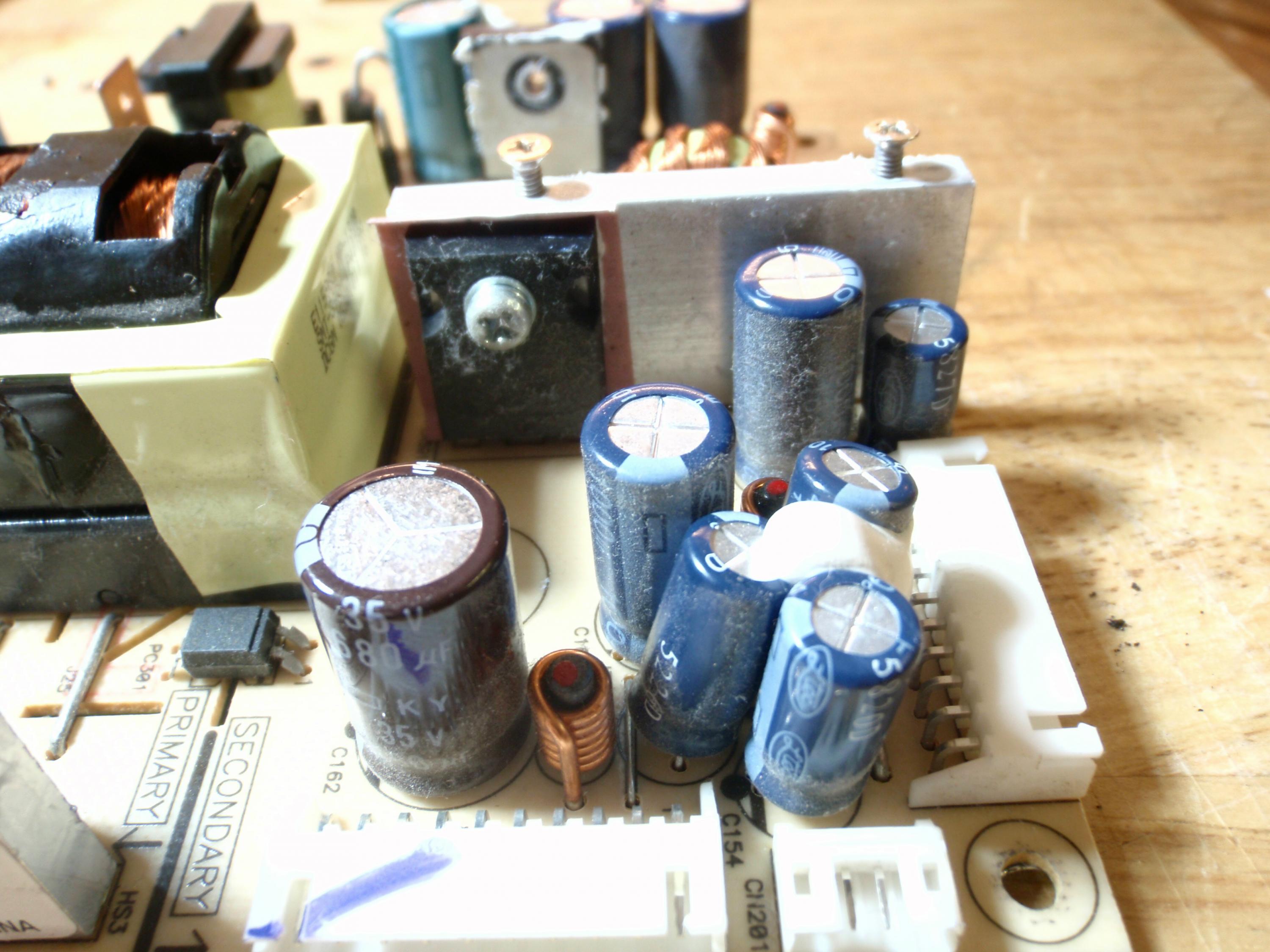

    Actual Symptoms-
    won't turn on,
    blue and and yellow LED on at same time (looks white)
    no noise. clicks, flicker when plugged in

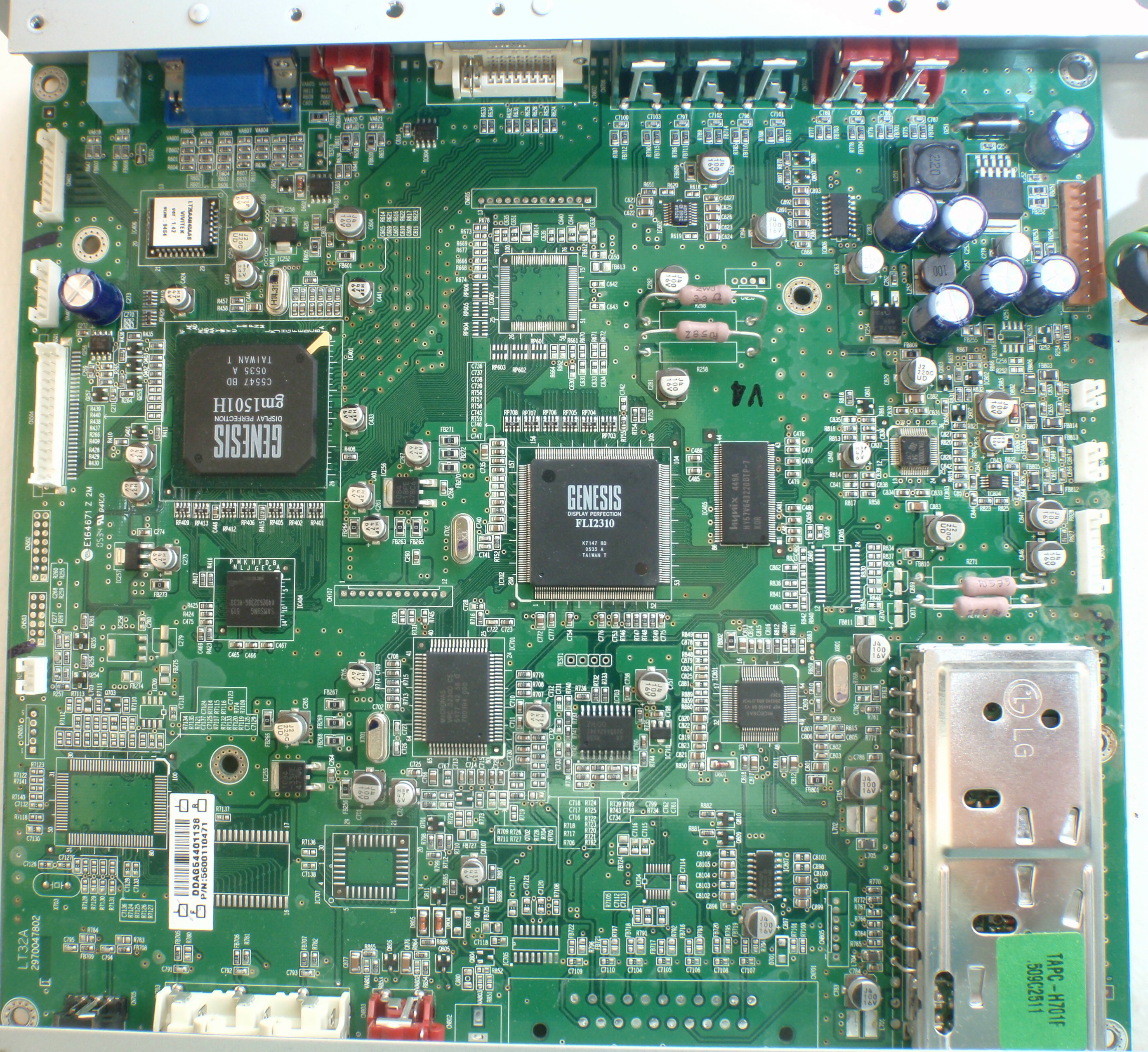

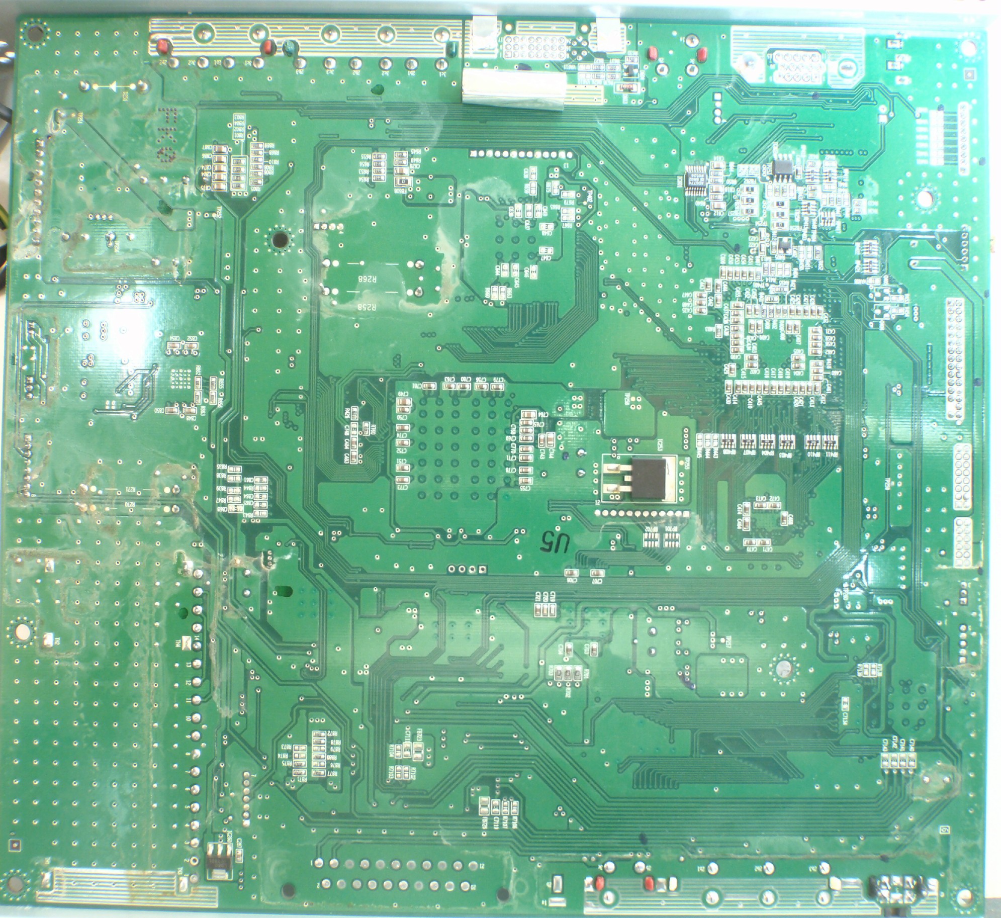

    main board shows some signs of liquid at some point.

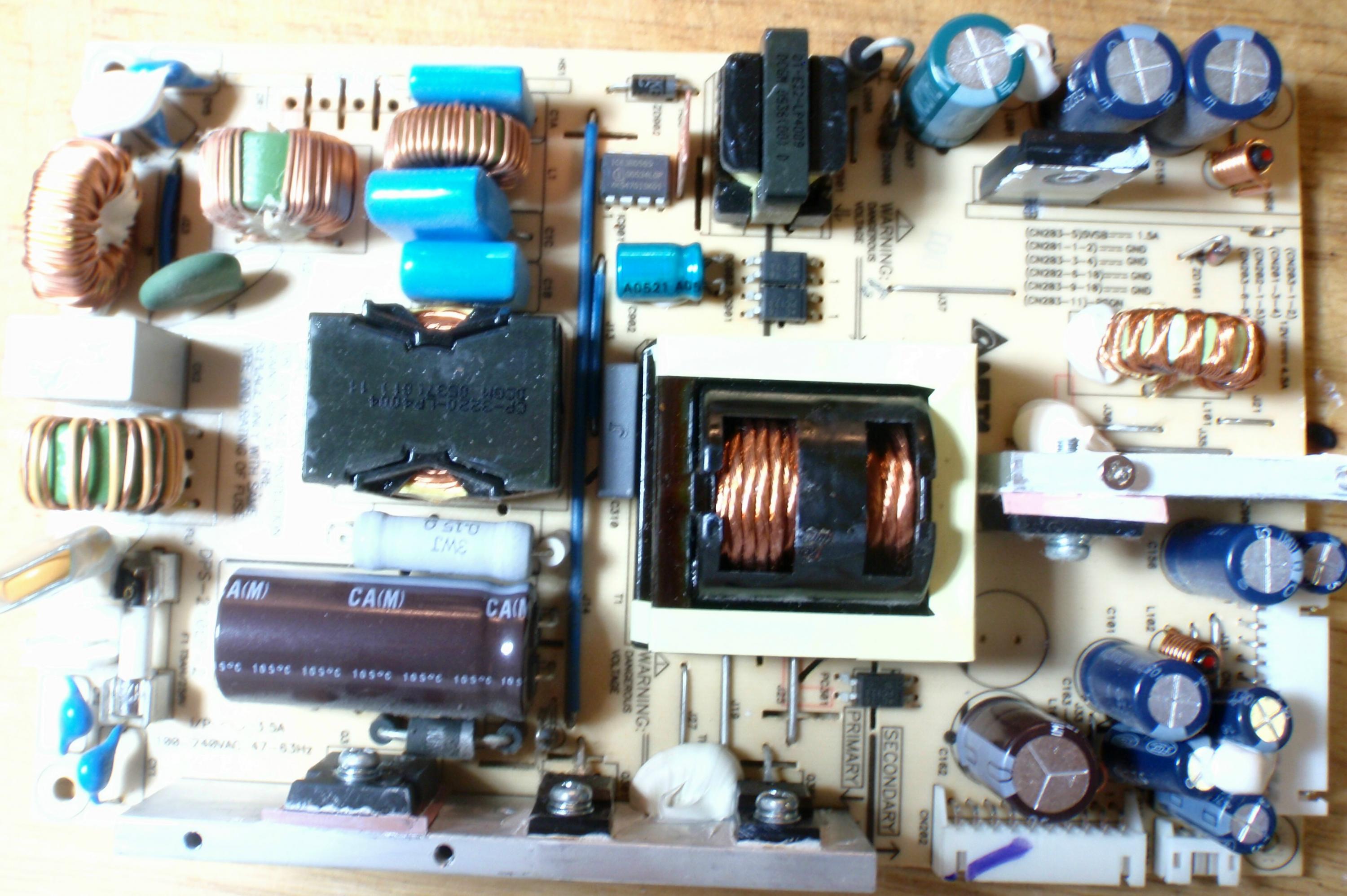

    Power caps look good to me
    solder joints all looked good- but re-soldered anyway.
    Tried:
    adding source (tv s-video and xbox)
    leaving plugged in for more than a week
    leaving unplugged for more than week
    researching ideas (this website and others)
    removed and re-installed all connectors on main board and power module
    re-soldered all larger contacts on power module (including T1 transformer and C210) (not including small ones similar to fuses)
    tested all fuses (marked with an "o")- appear good - no resistance
    tested for voltage at 12 5 and 5vds contacts (at connector) against ground.
    voltage only at 5vds (standby power). Since it won't turn on that may be why there is no voltage at 5v and 12v connector.
    HELP!
    Not sure what to try next- please direct to a descriptive trouble shooting guide or give suggestions to what to try (and how)

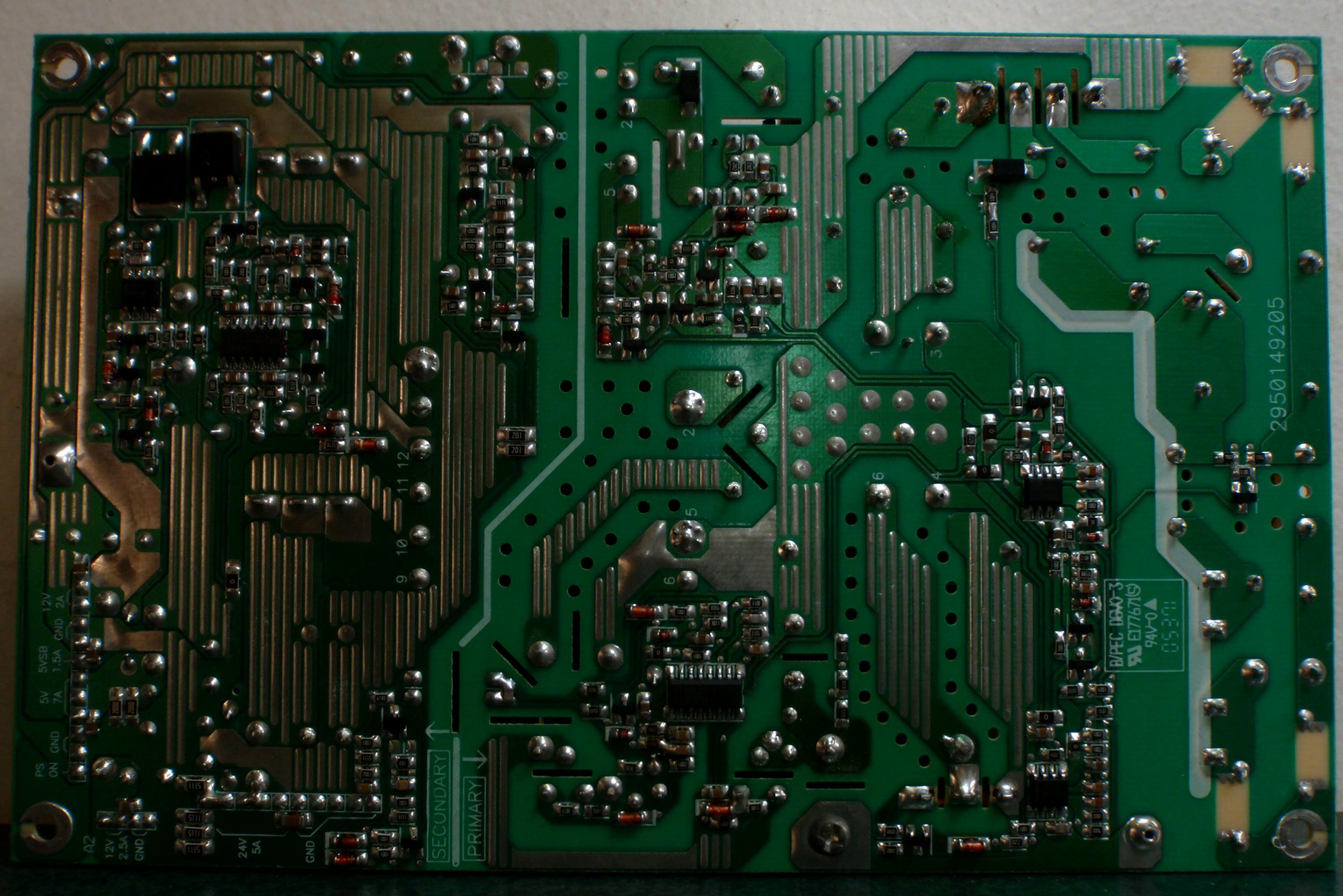

    Did some one work on this power supply board before? Picture #3 top right, the big MOSFET has heat sink compound on it but missing the heat sink.
    Check the Voltage on that large big black DC filter cap in the hot side (deadly voltage, so do not touch anything with your hands) when the TV is plugged in but do not turn it on it should have about 165VDC on the legs, then hit the power switch and see if the voltage will go up to around 390~400vdc.
    The PS_ON signal is generated from the main board, that signal will present when you hit the power switch, this control signal will turn on the PFC Voltage booster, 12V, and 24V power supply circuits.

      I took off the heat sinks to get a better look at the caps.
