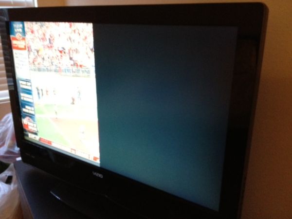

    Half screen question
    I have seen this problem on a Vizio, this is T-con issue?
    Re: Half screen question
    Most likely a loose ribbon for one side or a bad t-con.
