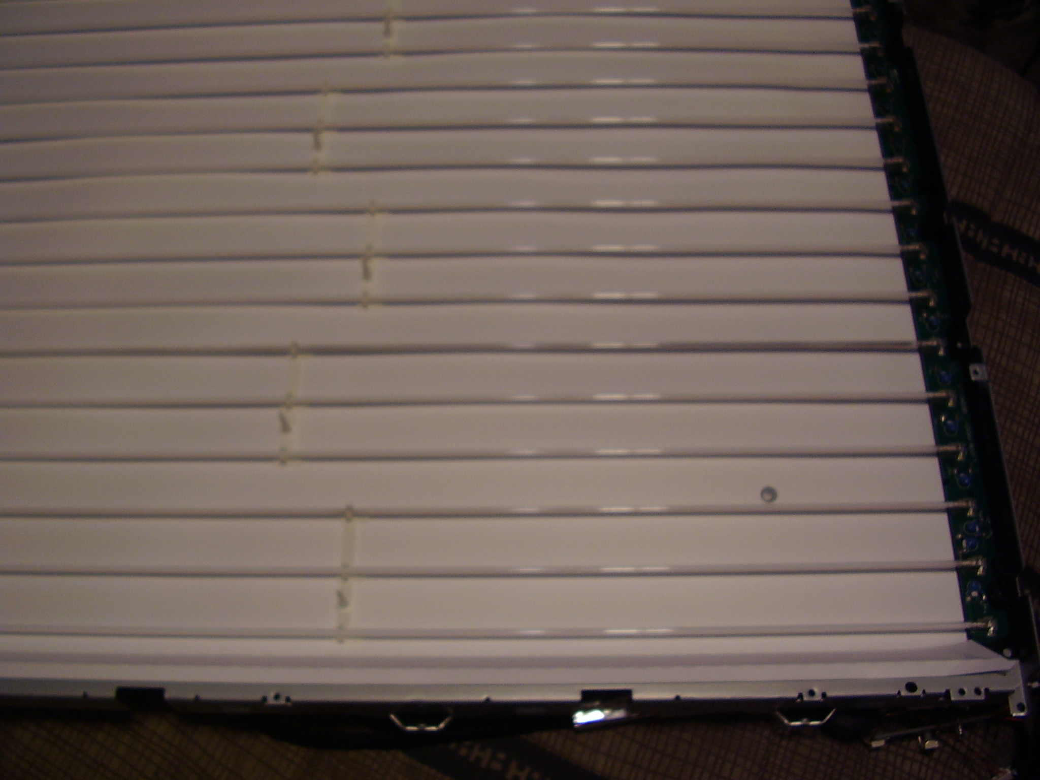

        Its confirmed now, 3 dead lamps. Does anyone know if the lcd panel can be used in other tv's?

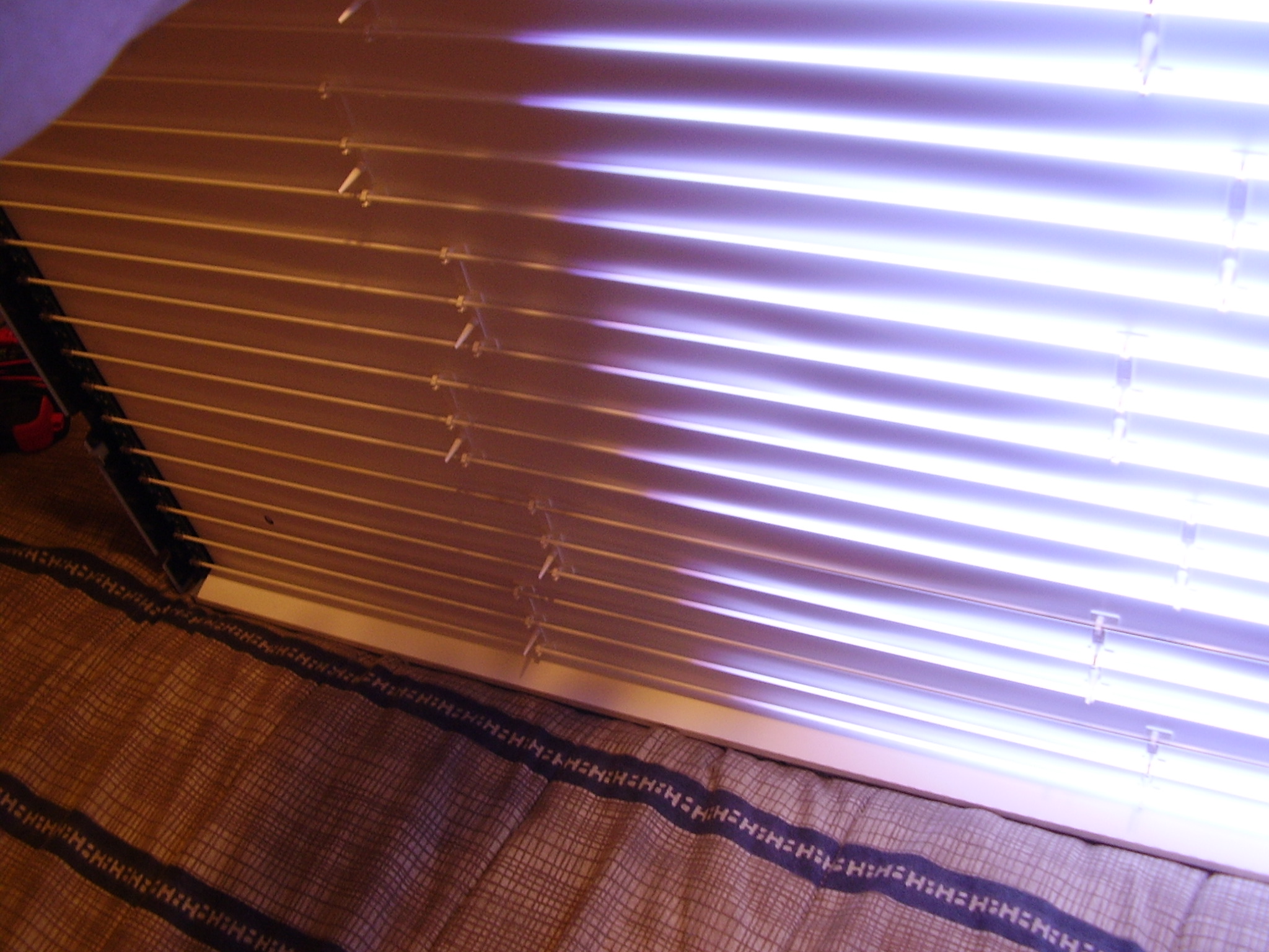

            No i didnt, sorry. now i plugged in and got a burning smell and only right side comes on. smoke came from the left board that the bulbs plug into and the plastic behind the board caught fire. i removed the top lamp,the 3rd from the bottom is out but not dark like the 6th from the bottom. The right side will stay on alot longer(approx. 5 minutes) now but after a while they will shut off.
            • eagle00799
              • May 2012
              • 322
              Re: Polaroid tlx 04244b sound but no picture
              Notice the discoloration(yellowish) of the trim piece that covers the board that burnt up, that would be the slave inverter side. Must of had a heat issue on that side. The bulb i took out is next to it, Tryed putting in a bulb from a vizio of the same size but it was noticably dimmer.

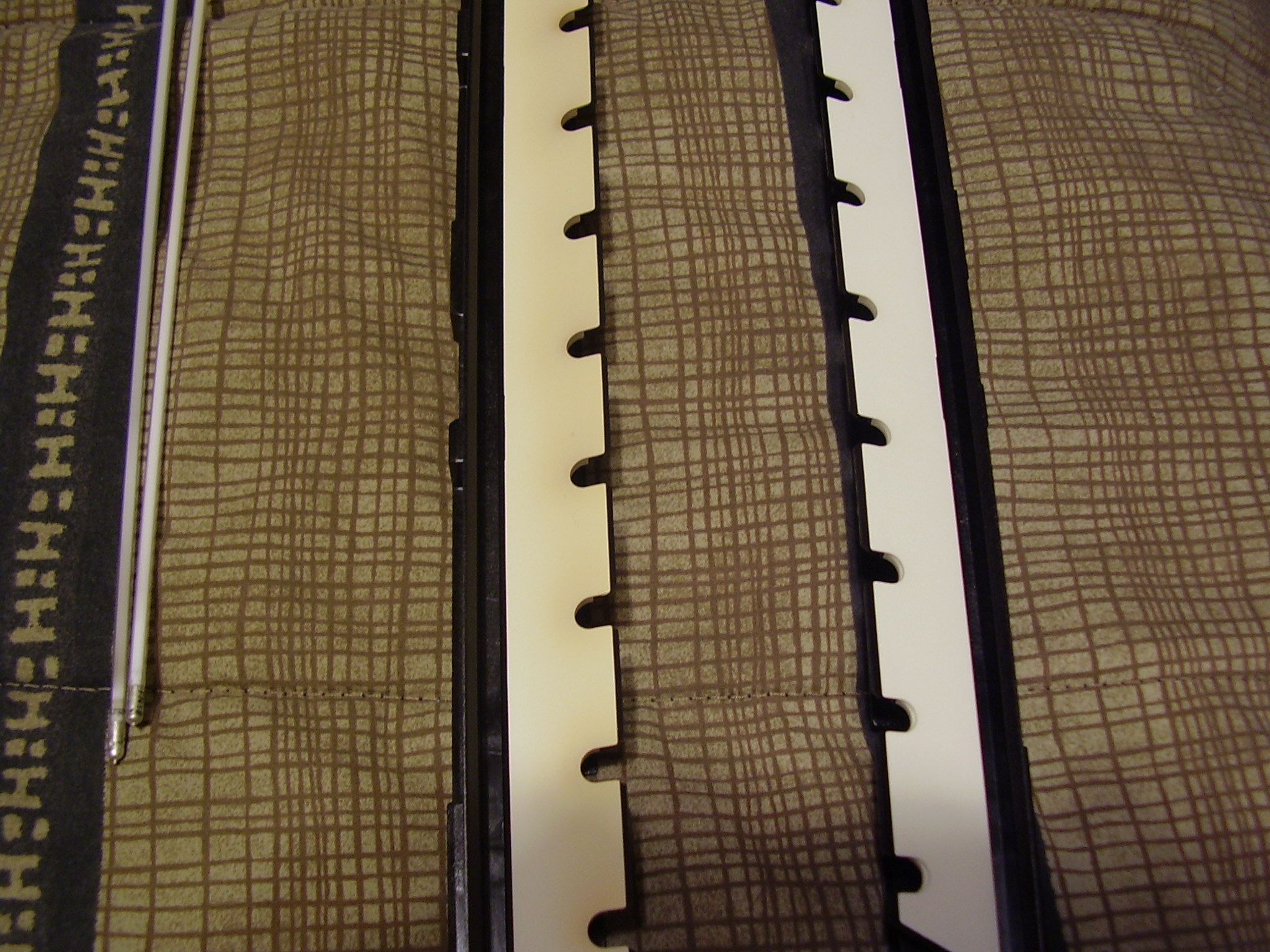

                So the lamps are socketed in place? Are there any blue high voltage ballast caps on the board? Was the LCD panel easy to lift off, I afraid my arms are not long enough the really hold up the LCD panel up without having it sag down and crack it.
                • eagle00799
                  • May 2012
                  • 322
                  The lamps are pushed into place but the plastic clips the hold the center of the lamps are brittle plastic that breaks very easily and yes there are 18 blue ballast caps on the board and the lcd wasnt hard to get off.
