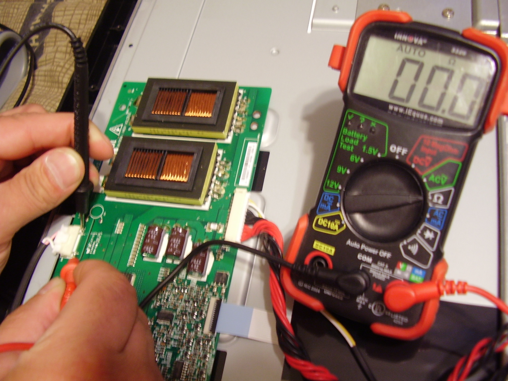

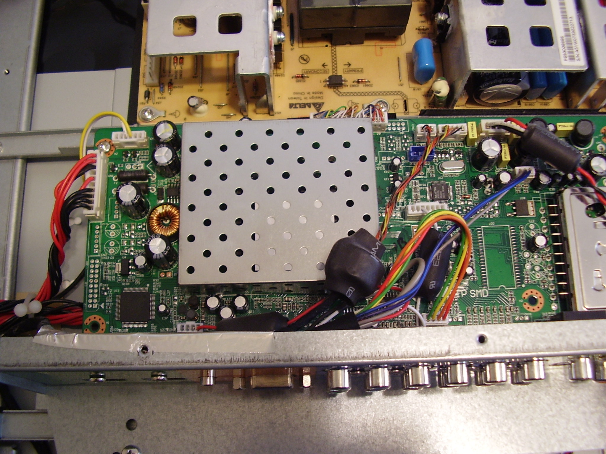

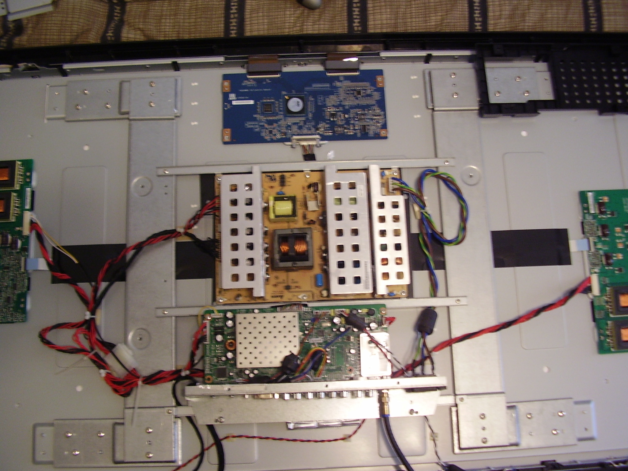

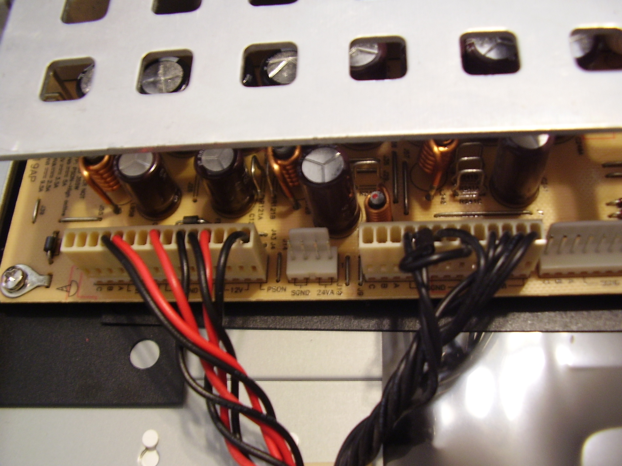

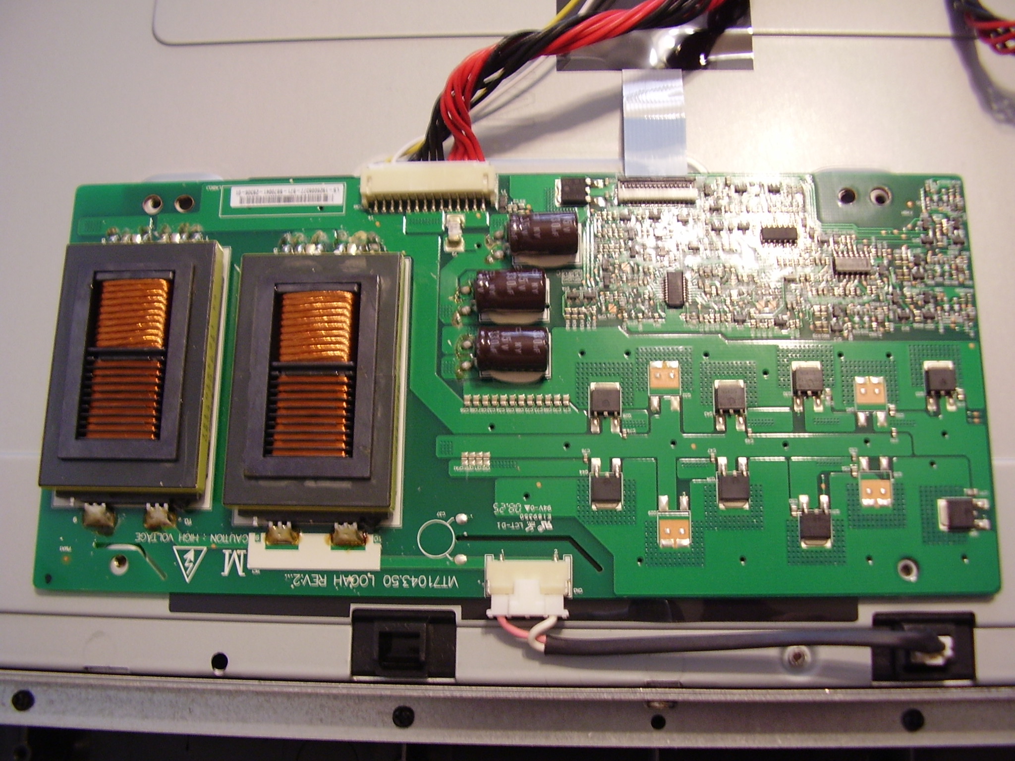

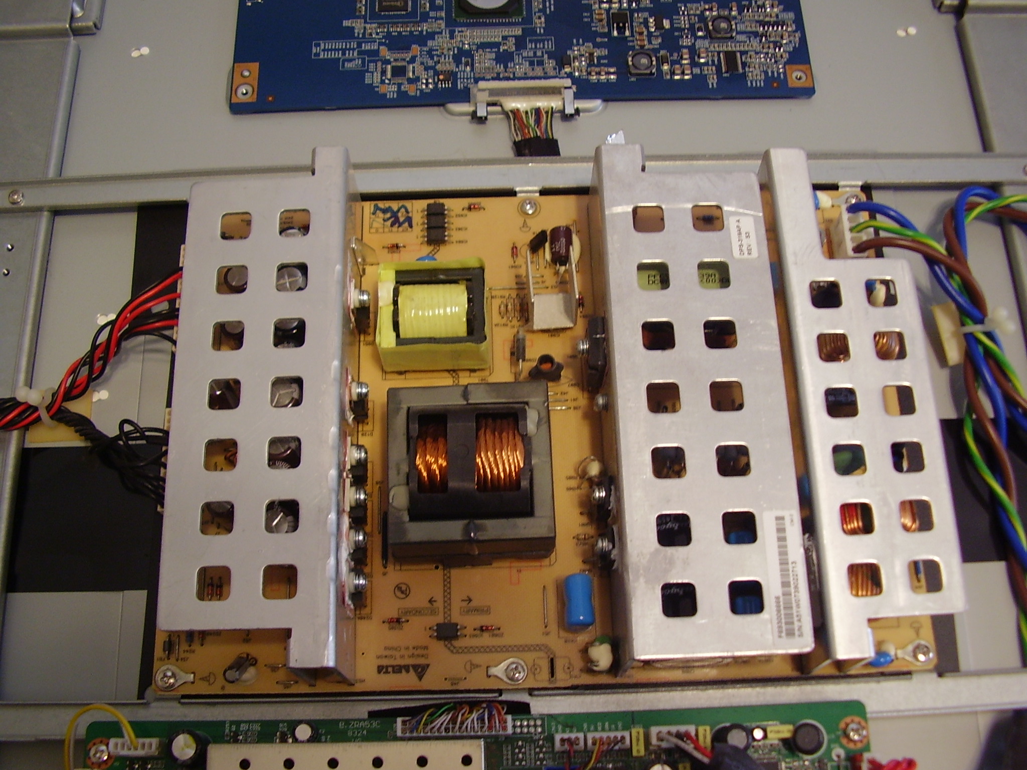

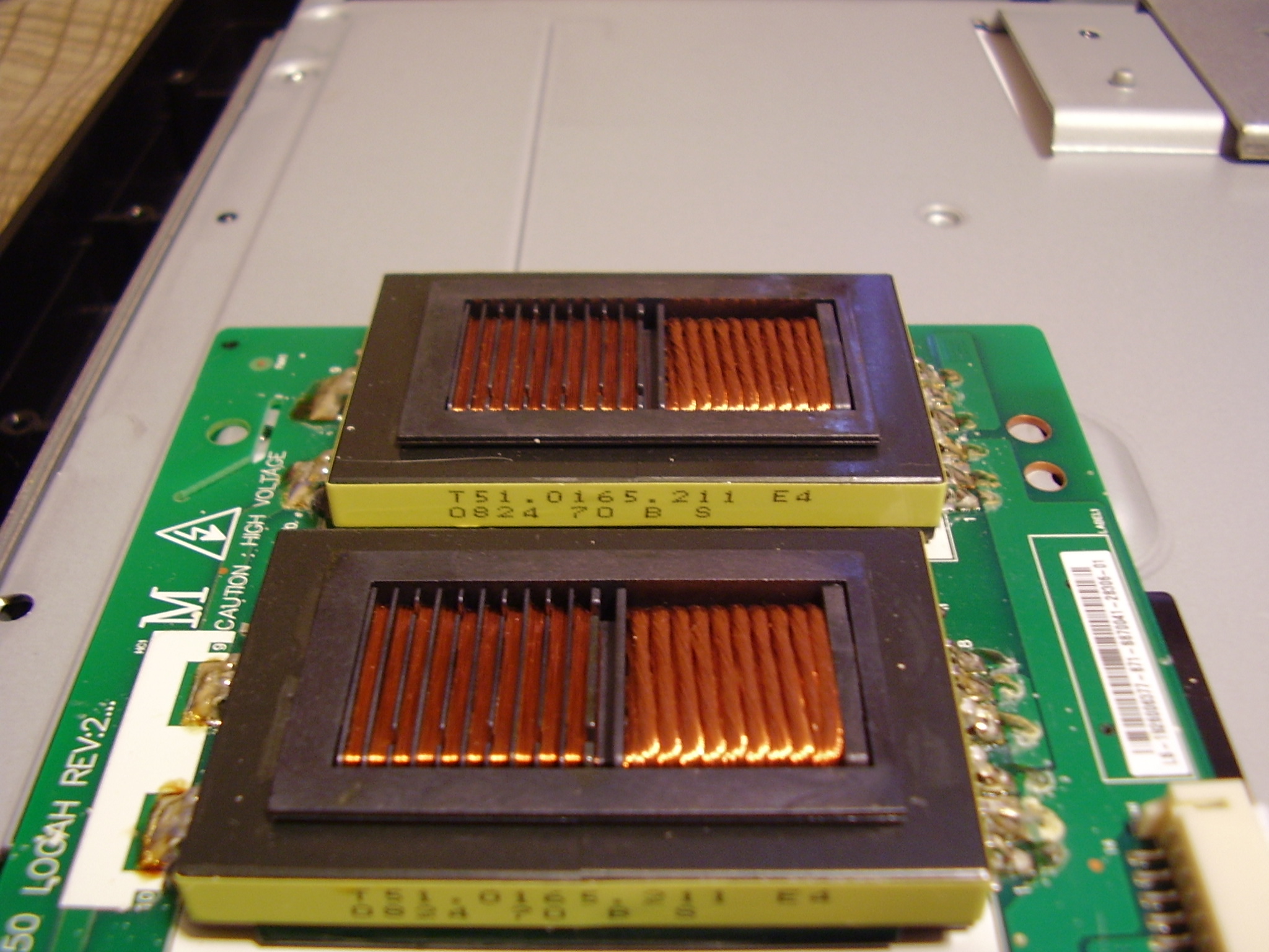

Hello everyone, I have a tlx 04244b that when turned on the polaroid logo will appear then the backlights shut off, i can see a picture if i shine a light at the screen and the volume works.
I have taken the back off and cant see any bulged caps, I have 5 volts standby and when i turn it on i get the 24 volts to the inverters but i notice the 12 volts will read 12.84 at first but then will drop to 11.89 when the backlights go off. Any suggestions?
