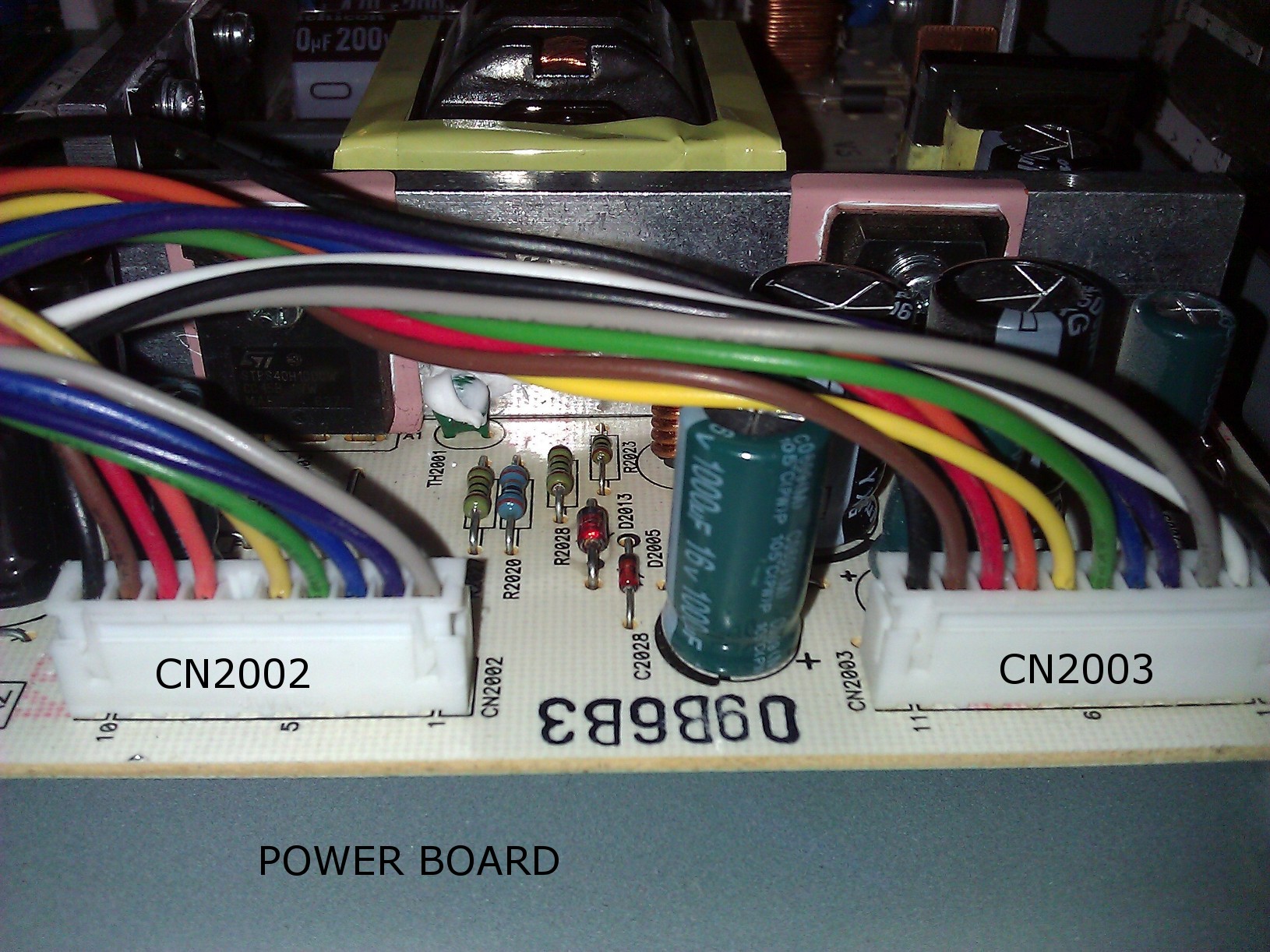

    Grab this at E-waste the other day.. Its a Ltv-32w4 .. Powers up and stays powered up.. Screen glows dark blue/black, has sound but no picture. Here are the following readings I have taken with AC power connected
    CN2003
    Black 4.2 mV
    White 0
    Grey 0
    Purple 16.5 mV
    Blue 16.5 mV
    Green 16.5 mV
    Yellow 5.02 V
    Orange 0
    Red 0
    Brown 16.5 mV
    Black 16.4 mV
    CN2002
    All zeros

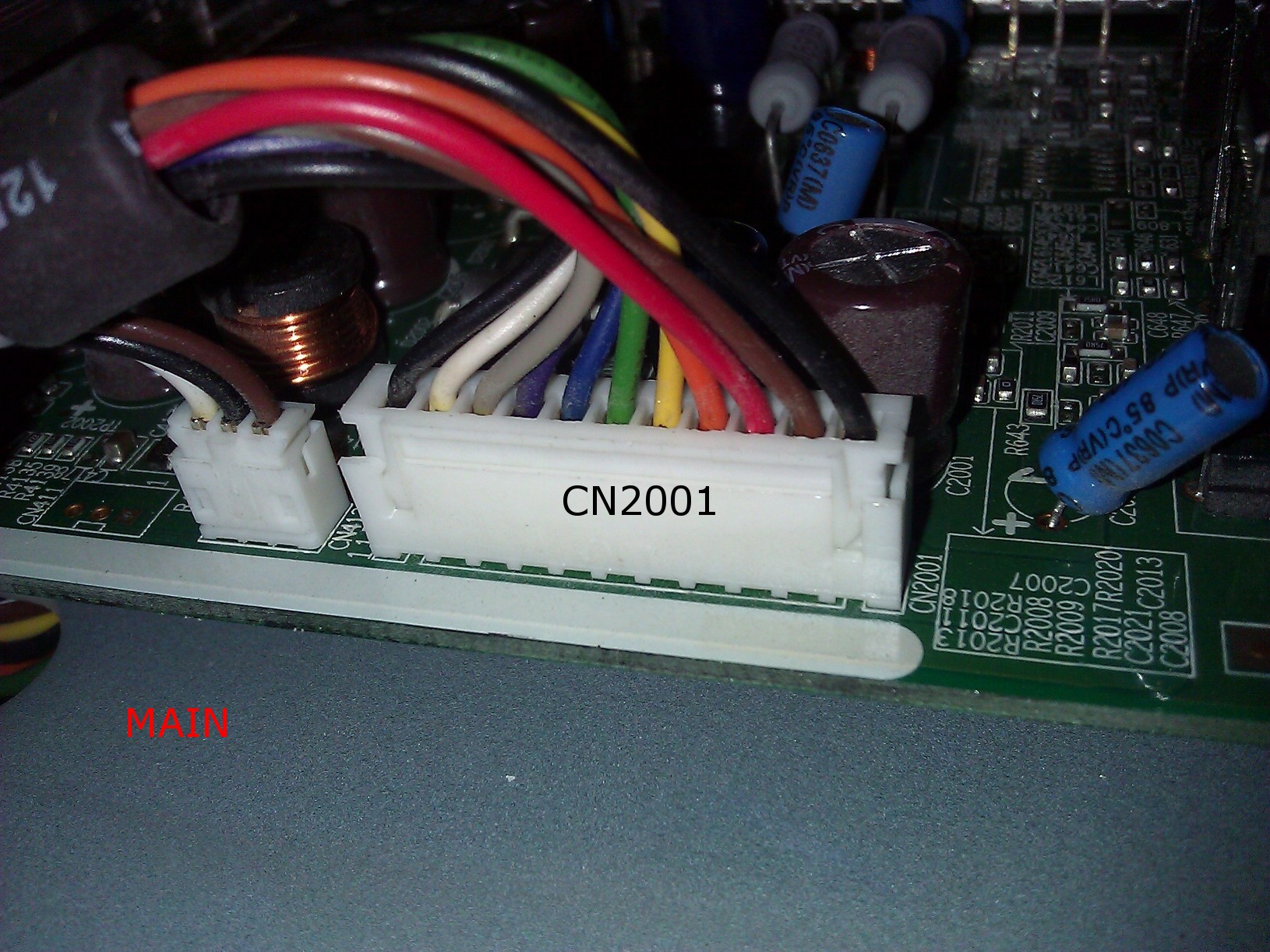

    CN2001
    Black 15.7 mV
    Brown 15.7 mV
    Red 1.8 mV
    Orange 1.9 mV
    Yellow 5.0V
    Green 15.6 mV
    Blue 15.5 mV
    Purple 15.6 mV
    Grey 1.6 mV
    White 1.7 mV
    Black 3.8 mV
    Whats your thoughts on which board is the problem

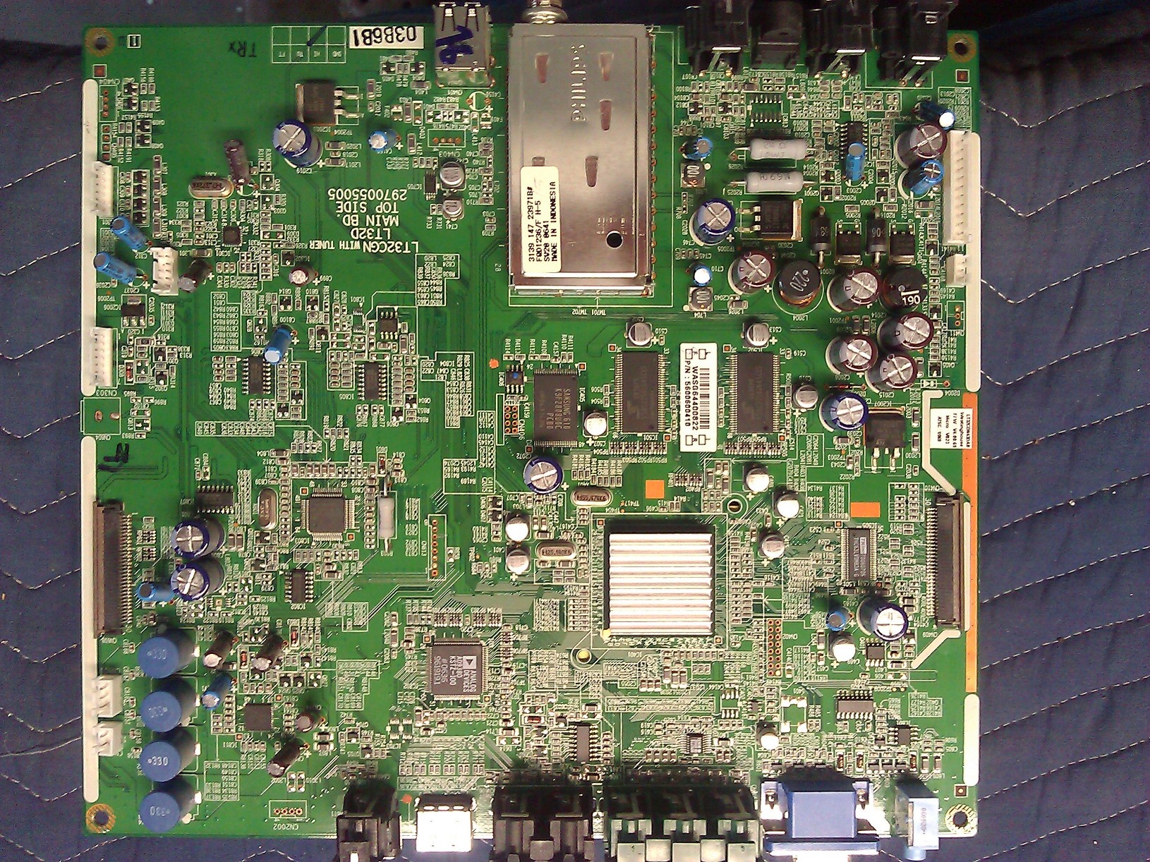

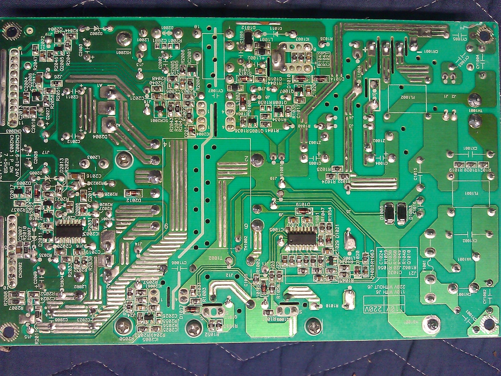

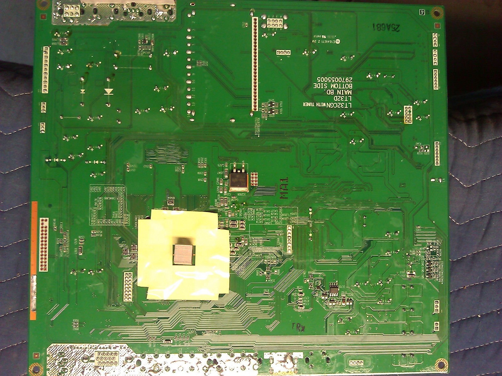

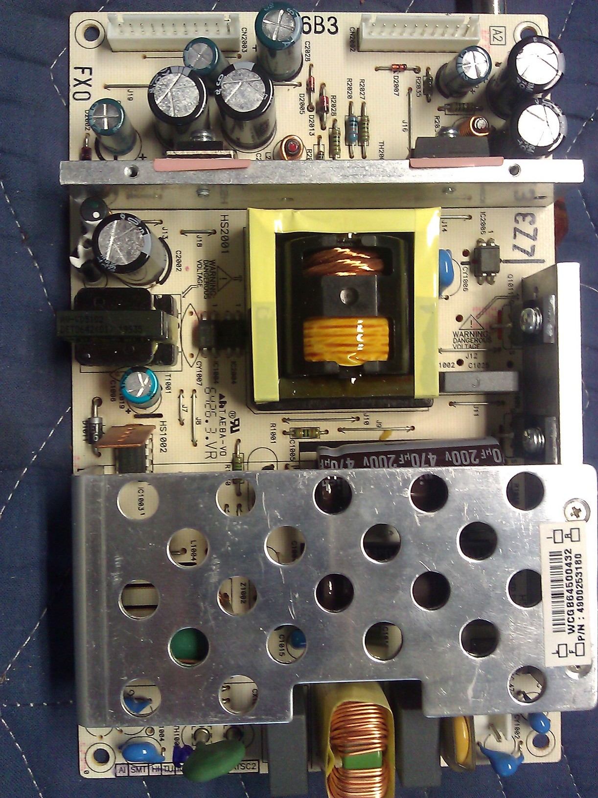

              Can we see the whole picture of the board as shown in post1, both sides of the board? The picture
              The voltage readings do not look right.

                Re: Ltv-32w6 Backlights no picture
                Power board..
                  Main Board

                          If you look at the bottom side of the power supply board, you will see the voltage labeling showing:
                          CN2002 PIN6~10 should have 24VDC when PS_ON is received.
                          CN2003 Pin1 is PS_ON, you should have 3VDC or more on this pin. Pin7 is 5V Standby that should always be there when the TV is plugged in.
                          So please look and see you do have PS_ON signal or not.
                          Are you sure you have backlights, the reading on post 1 does not show any 24V reading.
