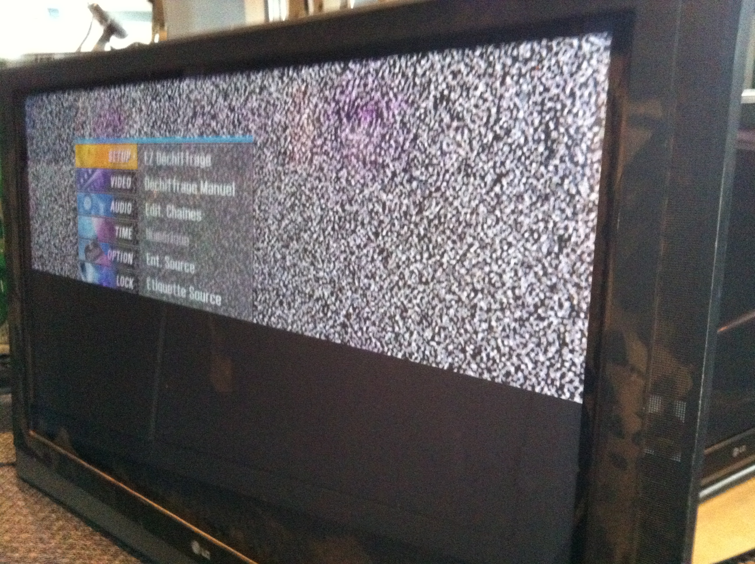

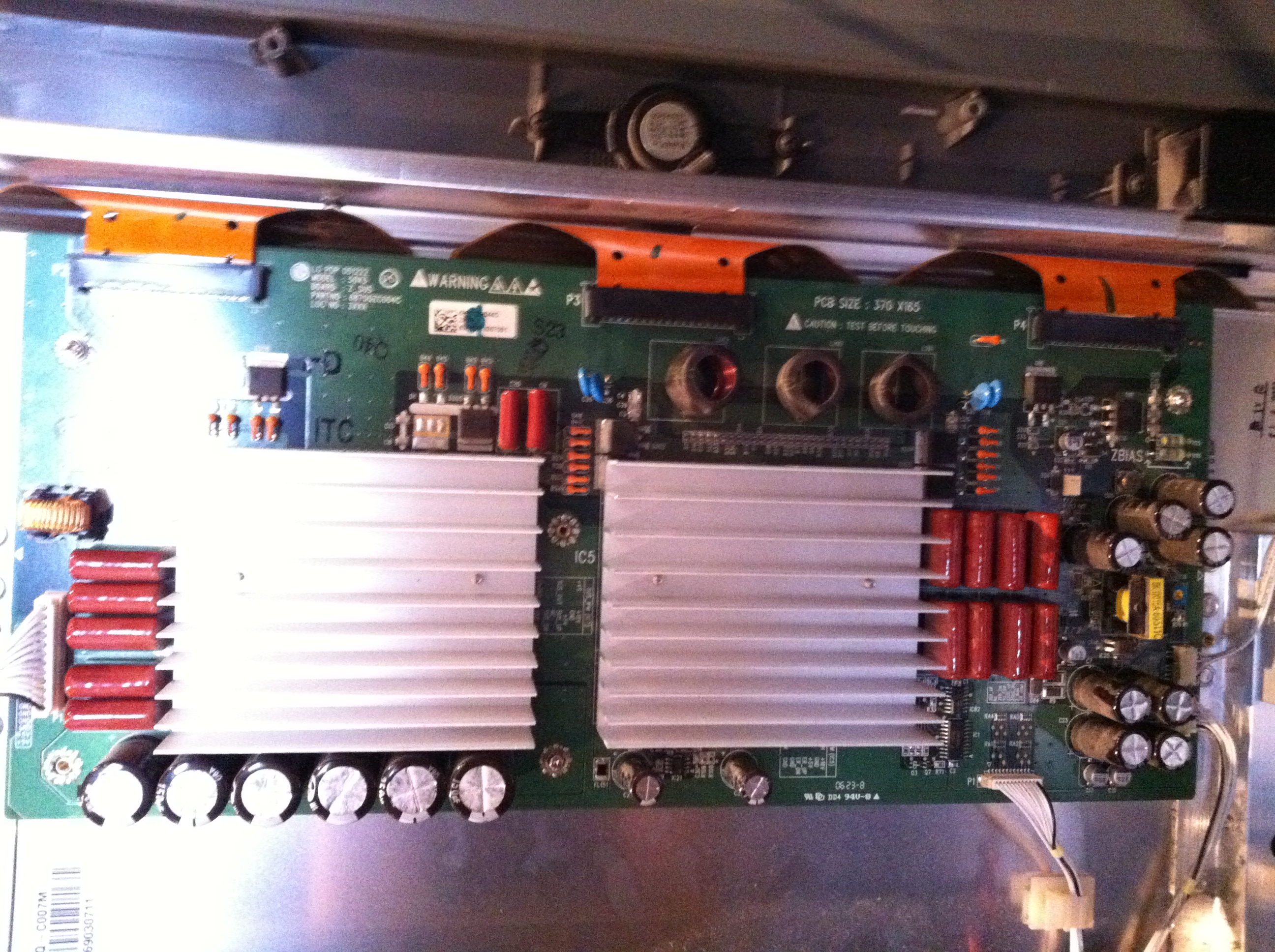

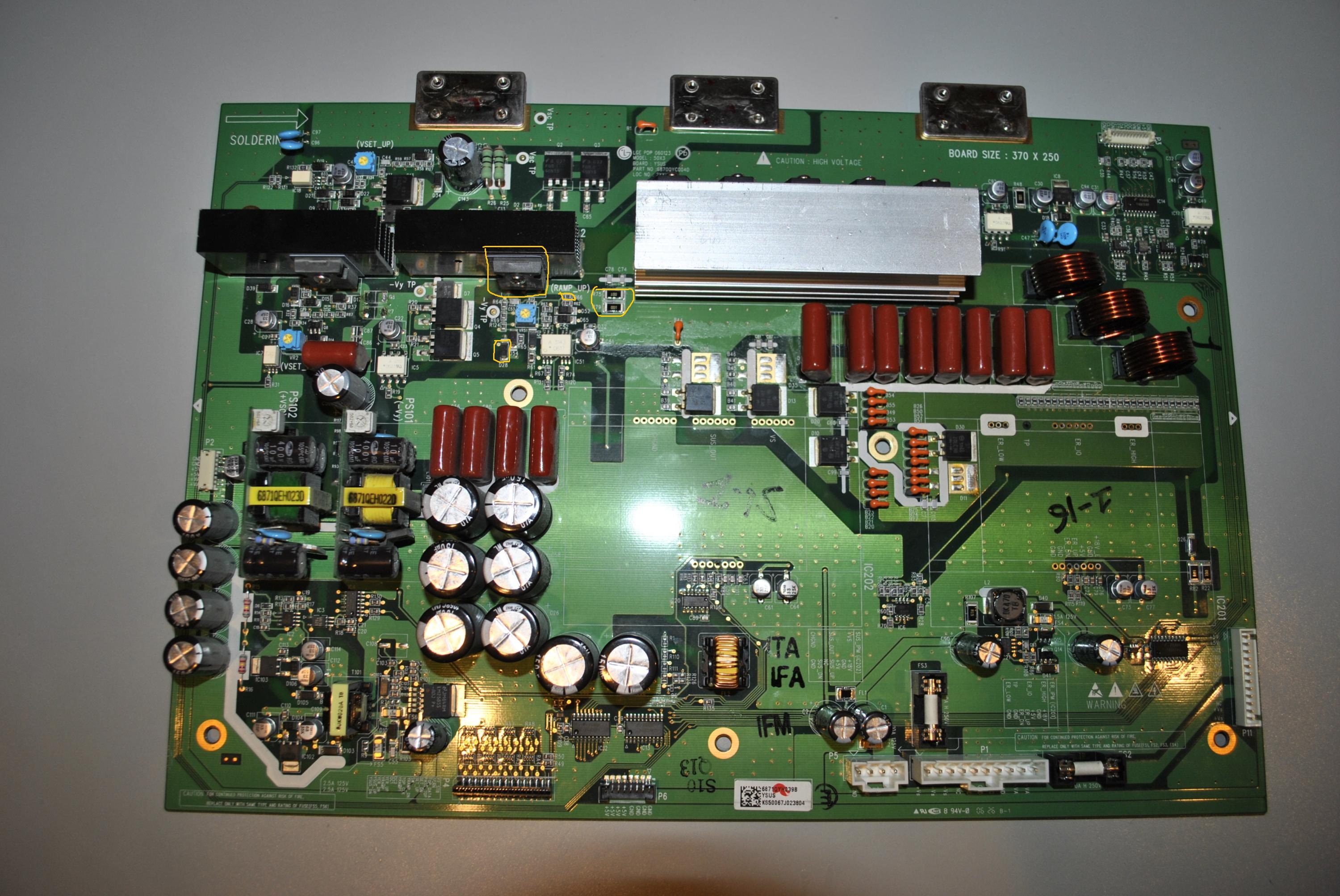

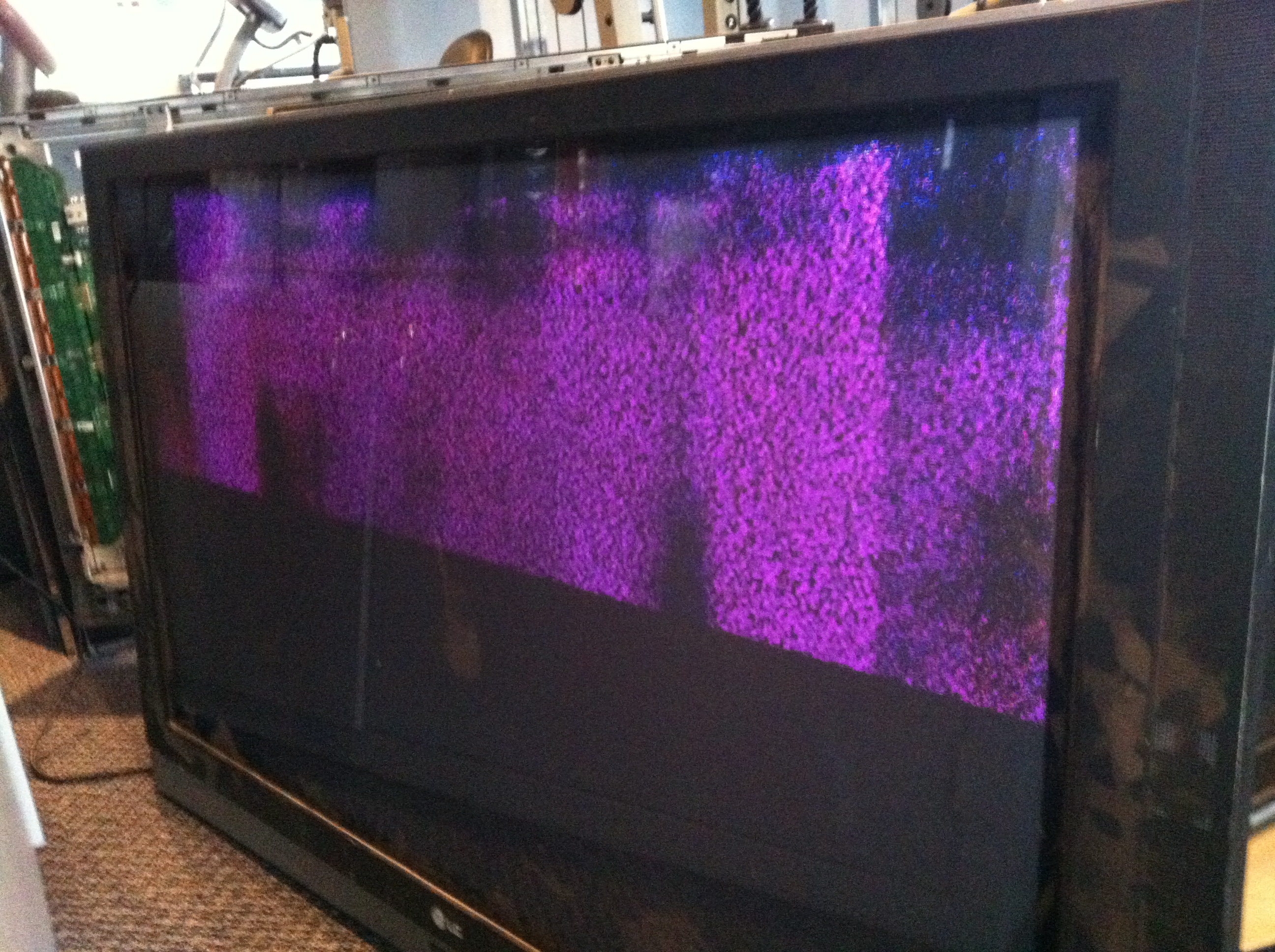

LG Plasma 50PC1DR- Y-SUS Issues
  • cheebster
    replied
    Re: LG Plasma 50PC1DR- Y-SUS Issues
    I've used m4 10mm screws from the top of the ipm (just drilled the plastic holes in ipm + heatsink a bit bigger) and screwed from the top. perfect !
    just one thing im wondering, those ipm's run quite hot do they ? even to hot to touch.. should i add some (maybe 80mm) fans to those units ? is really the heat the cause of their failure ?
    i was thinking of adding at least 1 fan on each side of the plasma on the ER IPM.. the one that runs hotter
    still one y-sus to fix on that 3-plasma project found a few burnt resistors near the fet that always shorts.. maybe it was just those smd resistors that ive missed that got that thing shorted every time.
    Leave a comment:
    replied
    Re: LG Plasma 50PC1DR- Y-SUS Issues
    I really have no idea, as I have never replaced an IPM, and plan to avoid it! If you are using any kind of glue, make sure it has good thermal conductivity. Most are very good insulators, making the heatsink less effective... and those IPMs run very hot.
    Leave a comment:
  • cheebster
    replied
    Re: LG Plasma 50PC1DR- Y-SUS Issues
    im having issues with some ipm i fighted with earlier. its got missing traces and its nearly impossible to do a proper job with the heatsink installed.
    if im using thermal paste and cyanoacrylate on the black plastic tabs, would you think the ipm heatsink will stay there without falling down ?
    crazy glue is pretty strong so on both sides.. maybe even adding a tab of sillicone on 4 sides after it's dried up, on the 4 sides of the heatsink between the heatsink and the pcb... sounds weirdo, or could be ok ?
    Leave a comment:
    replied
    Re: LG Plasma 50PC1DR- Y-SUS Issues
    Possibly. You could do a comparative volt meter with your working boards. Check the gate pin of the mosfet.
    Leave a comment:
  • cheebster
    replied
    Re: LG Plasma 50PC1DR- Y-SUS Issues
    so im probably missing something bad around that area on the board..
    Leave a comment:
    replied
    Re: LG Plasma 50PC1DR- Y-SUS Issues
    Yes. I think it gives it a ramp signal on the gate, which generates the RAMP_UP drive. If it's stuck high, maybe the FET is stuck ON, leading to failure.
    Leave a comment:
  • cheebster
    replied
    Re: LG Plasma 50PC1DR- Y-SUS Issues
    um. the gate drive.. that's the circuit around the fet itself ?
    Leave a comment:
    replied
    Re: LG Plasma 50PC1DR- Y-SUS Issues
    Here's where a scope would be handy. I'll bet SUS_OUT is doing something it shouldn't. If SUS_OUT remains high for too long, then the 5 ohm resistance will be shorted to ground by that FET. High current ~40A will flow, frying the FET and resistors. Perhaps somehow the gate drive to the FET is faulty or perhaps the IPM is at fault.
    Leave a comment:
  • cheebster
    replied
    Re: LG Plasma 50PC1DR- Y-SUS Issues
    its the w9nk70z that blows, with the 2 10 ohms smd resistors and another resistor. see picture attached !
    well had many issues.. but all were somehow different
    Leave a comment:
    replied
    Re: LG Plasma 50PC1DR- Y-SUS Issues
    Which chip is it that blows? Didn't you have the same problem with TV #2, and it was a bad IPM that killed it?
    Leave a comment:
  • cheebster
    replied
    Re: LG Plasma 50PC1DR- Y-SUS Issues
    i didnt swap any ipm on the zsus. it seems the ysus is more prone to failure ?
    do you have a clue can be causing that w9nk70z chip to blow ? they take away a resistor (smd) and the 2 bigger smd resistor. i've replaced the chip 2 times now from chips from a spare z-sus, but it blows everytime. batch code isnt the same but it seems that it's the good chip..
    it seems to be the 'ramp_up' circuit, and it blows right away on tv startup. the ramp_up pot is not working since the circuit is broken, and i have no control on it
    i wish i could understand why is that thing blowing !!
    Leave a comment:
    replied
    Re: LG Plasma 50PC1DR- Y-SUS Issues
    Poor design, you swapped IPM on that one? IPM must kill them every time.
    Leave a comment:
  • cheebster
    replied
    Re: LG Plasma 50PC1DR- Y-SUS Issues
    here's a pic of the z-sus // edit : i see the testpoints didnt search much.. but its still my ysus at fault. i need to understand why it burns again in that section.. the buffer ?
    or something else on the board ive missed
    Leave a comment:
  • cheebster
    replied
    Re: LG Plasma 50PC1DR- Y-SUS Issues
    oh, got it. i swapped a board from a perfect set (zsus) and issue is still there. i noticed the ramp_up can not be adjusted on my ysus, not normal. gonna have to dig more..
    checking and again the ramp_up big transistor on right black heatsink is shorted, the 2 10ohms big resistors burned, r66 burned, d28 shorted.
    i really dont understand what's burning these things again and again :/
    Leave a comment:
    replied
    Re: LG Plasma 50PC1DR- Y-SUS Issues
    Can you post a pic of your Z-sustain?
    Leave a comment:
  • cheebster
    replied
    Re: LG Plasma 50PC1DR- Y-SUS Issues
    vzbias ? how do i check this one ?
    Leave a comment:
    replied
    Re: LG Plasma 50PC1DR- Y-SUS Issues
    Looks a lot like Zsus. Check Vzbias, should be around 90V.
    Leave a comment:
  • cheebster
    replied
    Re: LG Plasma 50PC1DR- Y-SUS Issues
    oh well. got this one working as well.. replaced same parts again, dont know what happened, but im having another issue.
    what can give this kind of pinkish image ? if i push -yv to -228v or so, i get something better.. but its not in the panel's specs at all
    could it be a zsus issue or one of the ipms?
    Leave a comment:
  • cheebster
    replied
    Re: LG Plasma 50PC1DR- Y-SUS Issues
    LOL !! I 'tried' to fix the 3rd one with those parts from digikey. It bang'ed so hard my ear still hurts.. from the ysus board. But there was a picture !! lol. some stuff looks burned, gonna look it up.. but picture was working. hehe
    Leave a comment:
    replied
    Re: LG Plasma 50PC1DR- Y-SUS Issues
    I want to have a recycler who will sell those kinds of things.
    Here it's £25 for a 32", and one every 3 months maximum.
    Leave a comment:
  • gretti
    MSI Z370-A Pro, works but does not power off or reboot and USB issues
    by gretti
    I have a MSI Z370-A Pro. The board does not reboot or shut down from the Windows recovery console. USB communications stop and the status light on USB 1 stays on and does not blink. I have programmed a new BIOS with a CH341A programmer already, swapped RAM, PSU, CPU. The board will power off when the power button is held and resets when the reset switch is pressed, but it will not react to the reset switch if already told by software to shut down or restart. The board will reboot from BIOS after a save and exit command.
    The MSI BIOS included the ME firmware for the board. The size...
    10-16-2025, 02:14 AM
  • PlasMatt
    LG 60PV450 Possible Bad YSUS Need help confirming Diagnosis
    by PlasMatt
    I have an LG plasma that after reading through a bunch of posts and doing some testing I believe has a bad YSUS board. The problem is that that doesn't make sense to me for some of the symptoms. The problem started yesterday. While watching a movie the TV just shut down like I pressed power. I have it hooked to a PC and use RS232 to turn it off and on so I thought maybe something had glitched there. I turned it back on and finished the movie with no problems. The same thing happened today so I checked logs to see if something in the control glitched and sent an off command but it didn't, After...
    09-20-2025, 06:50 PM
  • Burglicious
    Samsung PN59D6500 Plasma TV issues
    by Burglicious
    Hey all, i have a Samsung PN59D6500 that I rescued from the dumpster and I'm trying to fix it. So the issue I am having is that the TV isnt turning on at all. I have VS,VA,VSC,VE at all the appropriate voltages. I have 3.3V at the PS-On, and 5V also. Whats happening is when i press the power button on the remote the TV has has the relays click, some pixels flash on the screen and then it seems to turn off. It repeats this until the TV is unplugged. I know that the Mainboard has a problematic EEPROM but this seems kinda like a power regulation issue. Anyone have any ideas?
    12-09-2021, 09:03 PM
  • pixelcap
    Pioneer Kuro Pro 111FD 8 red blink error
    by pixelcap
    Pioneer Kuro Pro 111FD 8 blink red LED.
    I have been trying to solve the power-down 8-blink red LED problem with my Pioneer.
    So far I have replaced the power supply board, and the digital assembly board, I have reconnected the ribbons to all boards, ensuring the connections are good. Even though the problem is the 8 red light error and not the more common 8 blue light error code, I had Kcrownie,
    based in North Carolina replace the chips that cause the 8 blue LED problem (the main board and audio board) the plasma is still powering...
    10-06-2024, 11:26 PM
  • SoulFreeze
    Audio Issues - Realtek ALC3306 - Lenovo Slim Pro 7 14ARP8 - Type 83AX
    by SoulFreeze
    Hi, trying to troubleshoot some problems with this laptop I just finished repairing which had power issues (Burnt Buck converter - SY8883DFC shorted to ground).
    After repairing the above issue, I realized the following remaining problem,
    Sound only comes from bottom speakers, top palmrest speakers don't work. Neither does the headphone jack (static/buzzing).
    The computer recognizes headphones are connected and displays a popup in windows
    Sometimes, the computer will boot up and the sound will be working fine. However, if I run intensive programs and the computer...
    06-21-2025, 09:53 AM
