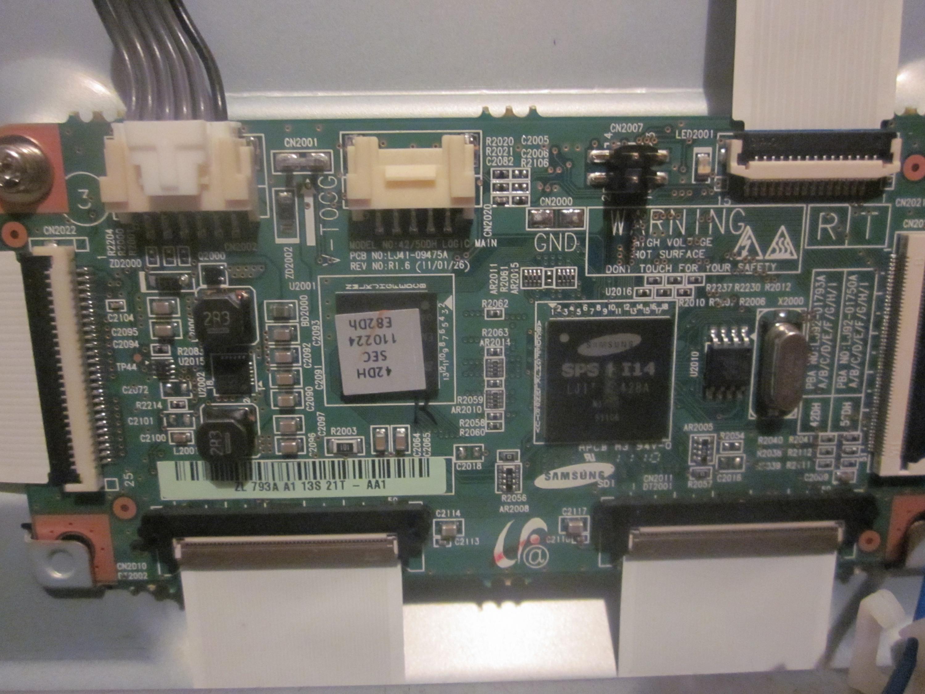

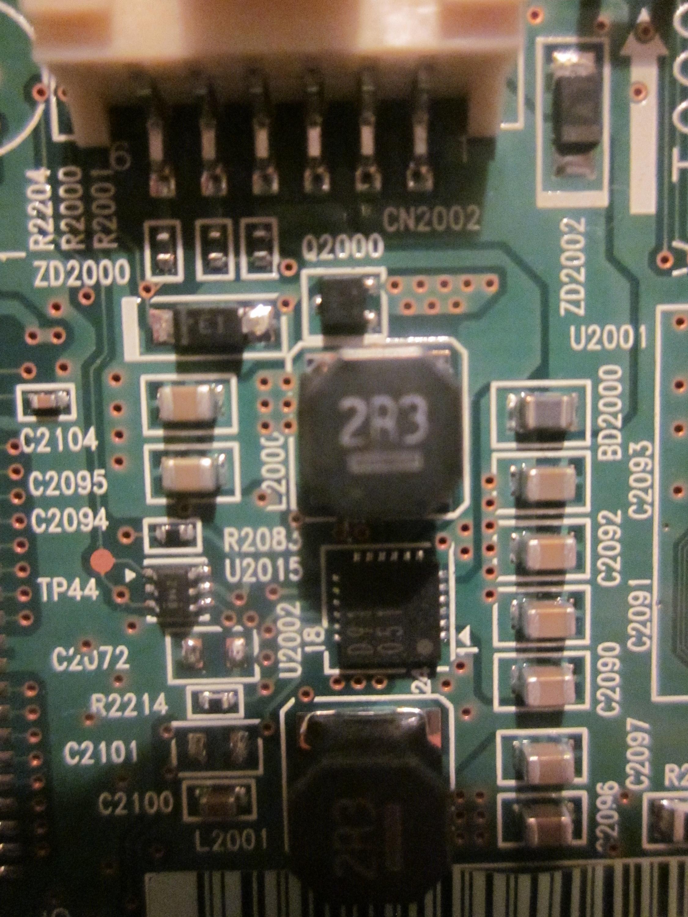

Mananged to get my hand on this TV... has a minor crack on the front but i dont think its deep enough to have broken the panel... hopefully!
The main issue is - there is no picture. Off the person I got it off (on ebay) it apparently had sound but no picture
But in my testing i have had no sound or picture - the red led does come on however...
When I plug power into the back there is a click, and an led flashes on the smaller LVDS board, then there is about half a second of buzz from the X-sustain... a couple of white-noise like flickers on the panel... then nothing?
When measuring the Vs and Va - Vs=~200, Va=~80 - but they RAPIDLY decline to 10V for Vs... and Va = ~0.2 - which im very convinced is either a fault of part of the story.
Off memory, will check later, Vscan was around 120v or something high, and the pins to the mainboard were at their measured levels (15v, 12v, etc)
I can't see any bulging caps on the psu - but due to the fact the voltage declines that quickly even with both sustains disconnected - im going to go ahead and replace most of them.
Any further advice on to what to do next etc would be a great help
