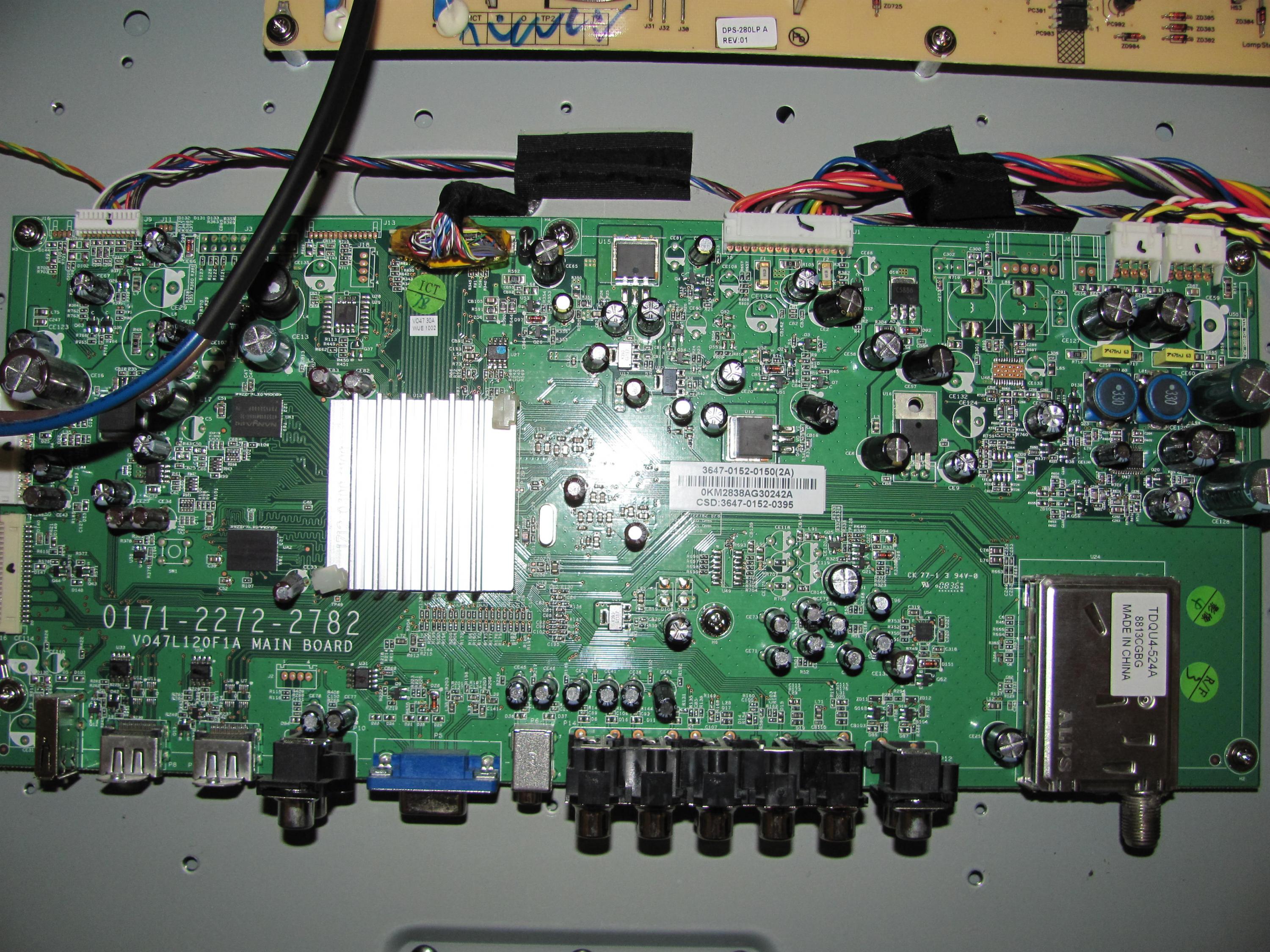

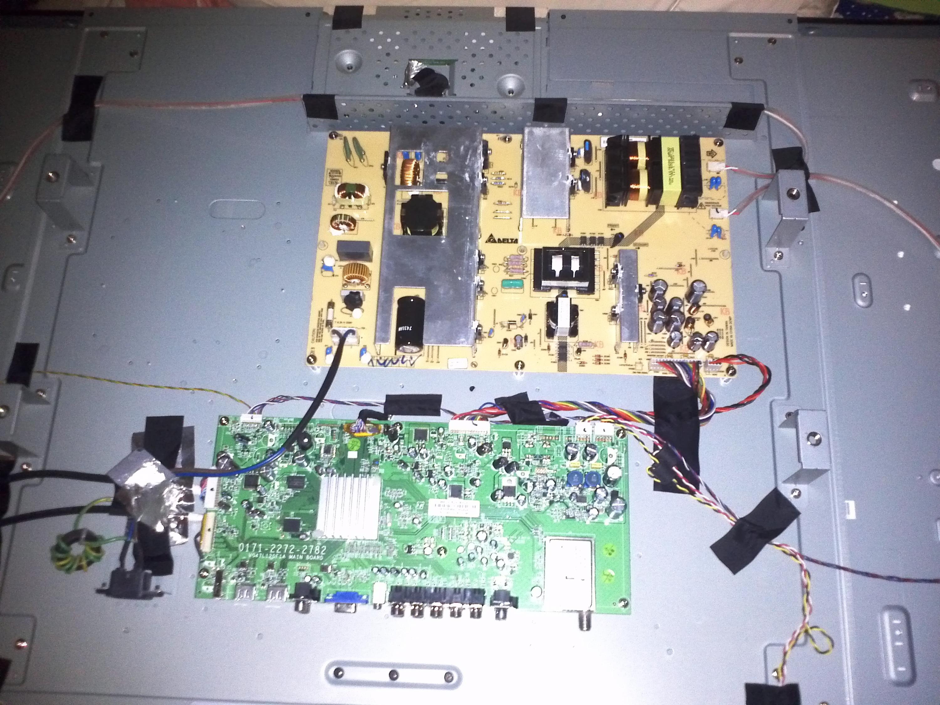

    I am a long time lurker, first time poster and I have a Vizio V047L-FHDTV30A that has no backlight, sound, or picture. The Vizio logo at the bottom turns from orange to white and then nothing. It will stay like that for as long as you let it sit. There are no bulging caps or obvious defects. It will power on/off from the side button but the remote does not work.
    I have searched and searched and it is hard to find information on this exact model. I found a few people that had similar issues with the FHDTV20A and FHDTV10A's but it seems those models are a little different on the inside.
    I have a multimeter and know how to use it but without a manual I am just measuring stuff with no progress.
    Any ideas?
    I have attached a picture of the board layout. The T-con is above the power board under the metal plate. I can take more high-res pics if needed.
    Thanks in advance.

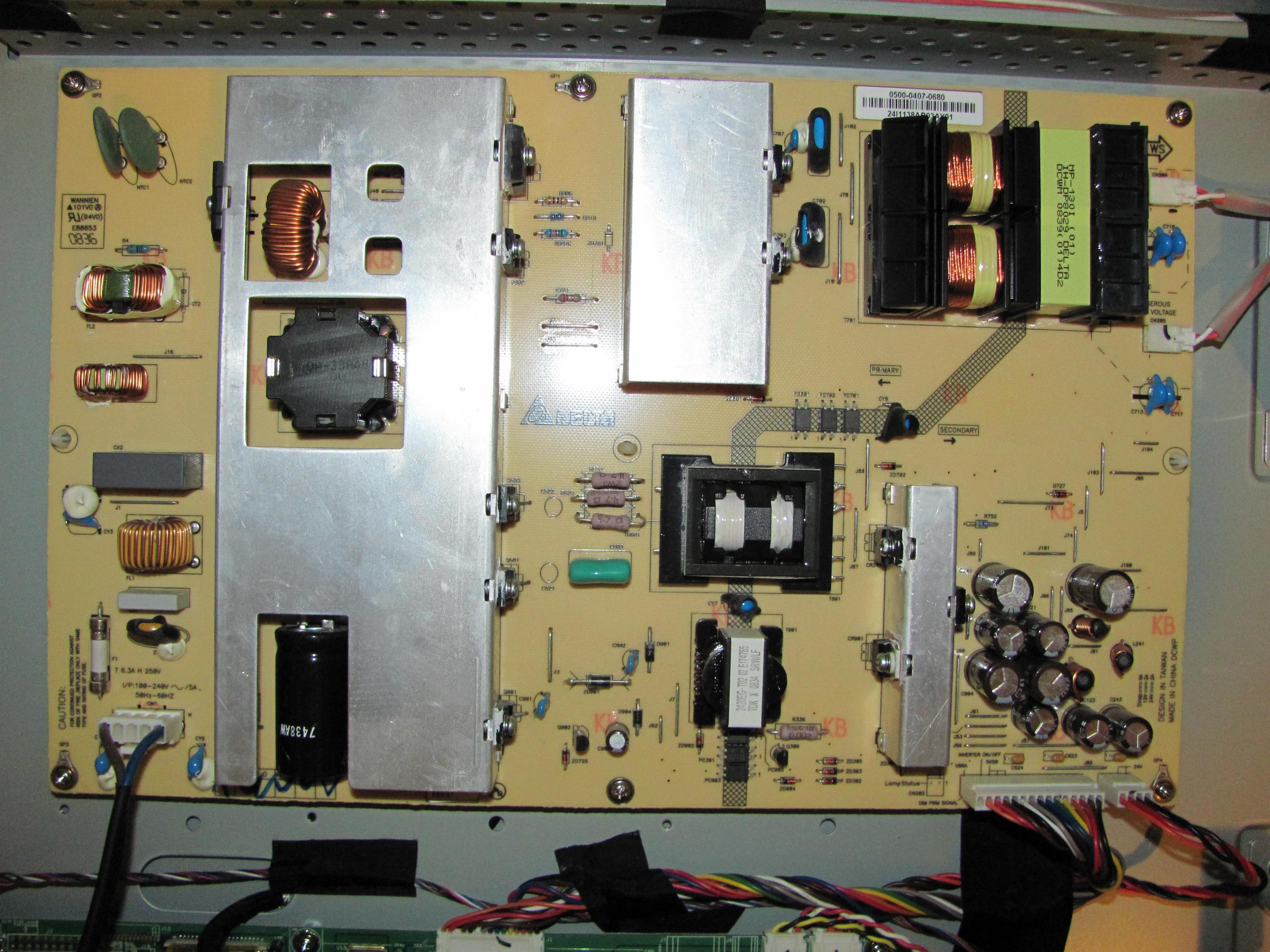

    Re: Vizio V047L-FHDTV30A - No Backlight, sound, or picture

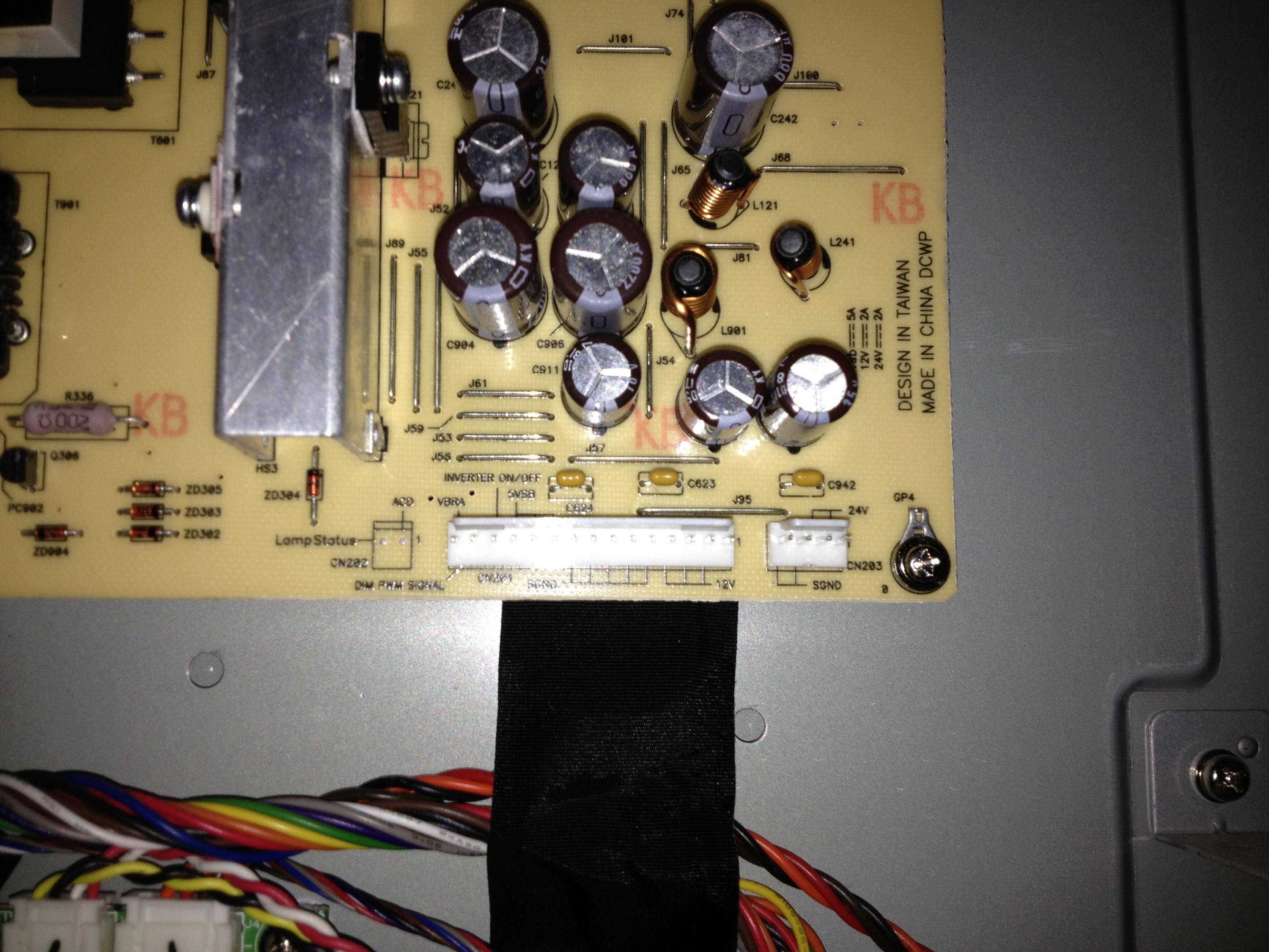

    You have power supply/backlights inverter combo board. On the bottom right of that board, there are two connectors, we need good clear pictures of those connectors so we can see what the pins are labeled with some kind of voltage/name of the pins. Right now the standby power supply is working.
      budm,
      Thanks for the quick reply. Here is the picture you requested.
      I had to take it on my work iPhone as it seems to take better pictures than my personal Android. I AM NOT a fan of Apple products though. That is a rant for another day.
      I can take some 12mp pics with a real camera if need be ;-)
      Regards,
      beuford318
        OK, Pin 3 of CN201 is the signal receiving pin that turn the backlights inverter circuits ON/OFF, the signal is generated by the Main board, it should be >3VDC or more for ON, .5VDC or less for OFF. Don't know what the VBRA is, see if it changes state when TV is OFF and when TV is ON. I do not see PS_ON signal pin, it is used to turn on the Main 12/24VDC power supply ON.

            I got .09v at pin 3 on standby and 2.91 - 3v at power on. vbra does not have a wire from the mainboard.
            Thanks,
            Beuford318
              3V should be enough to turn on the Inverter. Do you get 24VDC on the small connector next to the large connector?
                  Budm,
                  No, I can't get any voltage at all on that set.

                    There is a large cap laying side way between the heatsink, it is in the primary side which is DEADLY, you need to get DC meter and read the voltage on its two legs when the TV is plugged in but NOT TURN ON, the reading should be about 165~170VDC, when the power switch is activated, the voltage should go up to around 390~400VDC. You will have to find the way to measure that voltage safely, I would highly suggest you to plug the TV into GFI outlet to protect yourself, do not touch any heatsink or any parts in the Primary side with your hands or any part of your body.

                          If you do not have the 400VDC on that cap and the board does get the INVERTER on signal OK, that means the power supply board is not working, the Inverter circuits need the 400VDC to run, same for the 24VDC output.
