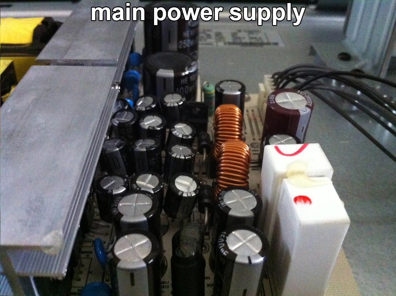

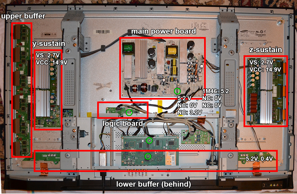

    Hi!
    Recently after a thunderstorm my Philips plasma television has stopped working. When I plug in the TV, there is no red standby light and no standby mode it seems. When I turn on the TV, a blue light appears in the front, along with sound, but no picture! It's also worth noting that there are 4 visible green lights inside the panel. (attached)
    I replaced the capacitors for this TV over two years ago, so I opened up the panel and tried testing out the voltages for every board. I did not notice any burnt capacitors, although I can provide more pictures if needed. Attached is a photo of the TV along with the voltages I tried to test.
    Searching this forum, some other users had the same problem, but solved it by replacing burnt capacitors. Would replacing the power supply board fix the problem? Also, I'm afraid the problem isn't the capacitors but one of the main boards and I might resort to trashing the television for parts if it costs more than $200 to repair.
    Thank you!

    Re: 50" Philips 50PFP5332D/37 Plasma No Picture, Has Sound?
    The main power supply sounds good but meter all the voltages out to check (voltages look to be above the p/s on the right hand side). The main (input) board would be the one controlling standby and "on" but also could be due to a stuck relay. Does it click when you plug it in?
    Since you did say you checked voltages, I would check fuses especially in the y section of the tv (but also check the x). I can't see if there are any or know particularly about this tv, but check for the smd and most likely ceramic type.
    Oh, and where were the capacitors that you replaced?

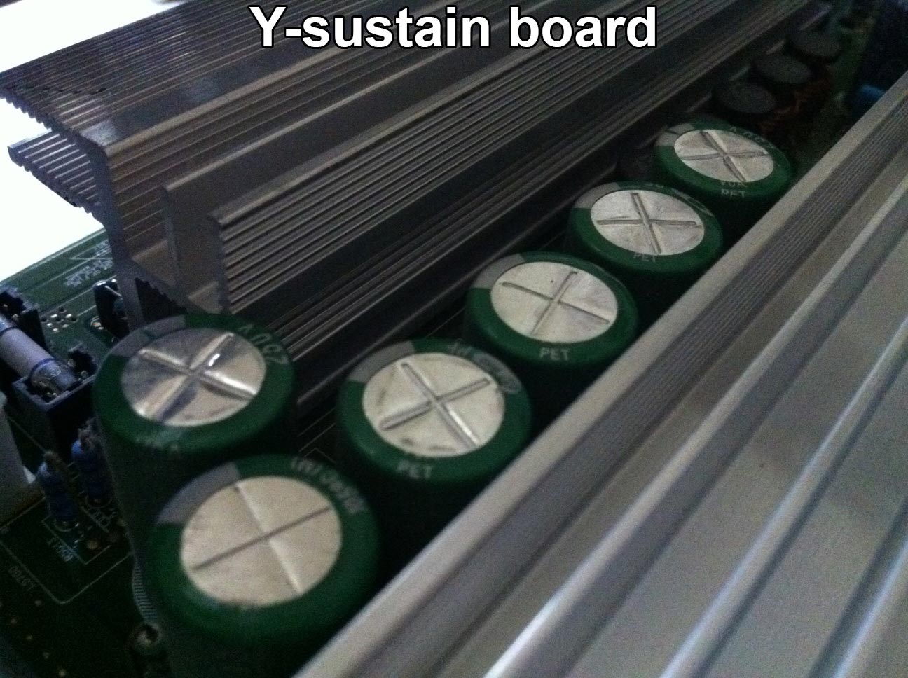

      Thanks for the the response! I'm not sure how to read the voltage chart (attached) but I don't think I'm getting the correct voltage readings. When I plug in the TV, it clicks once and the green indicator lights turn on.
      All the fuses seem to be normal and don't appear to be burnt out. Although, I found some capacitors that MAY appear to be abnormal (attached). The capacitors that were replaced 2 years ago were on the main power supply (also attached).

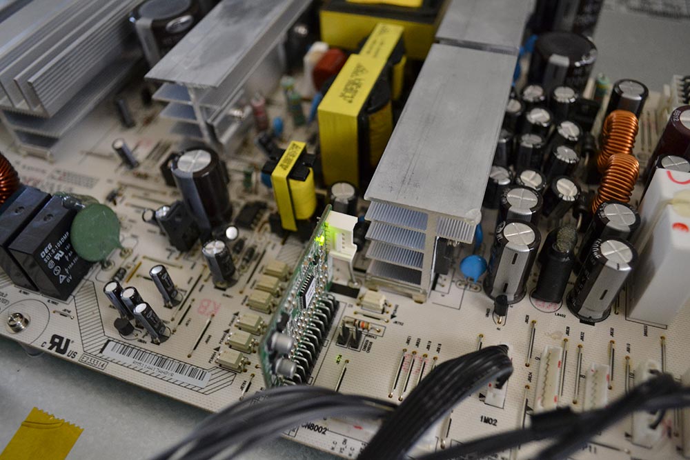

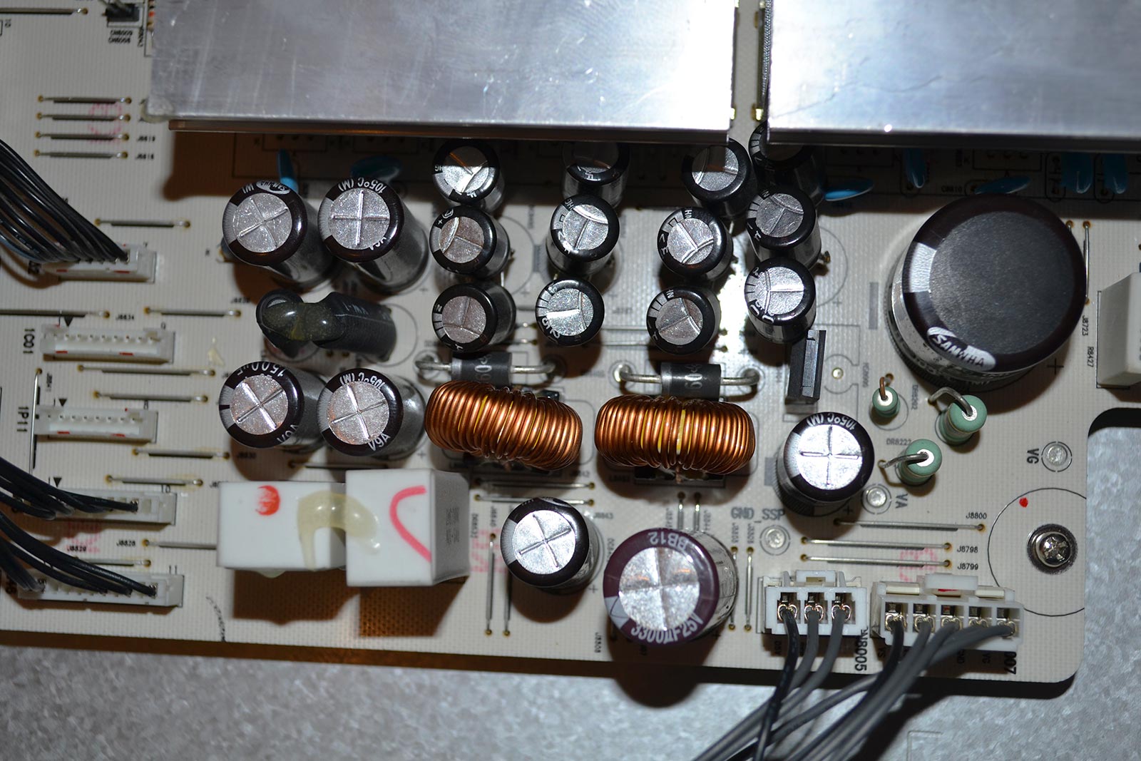

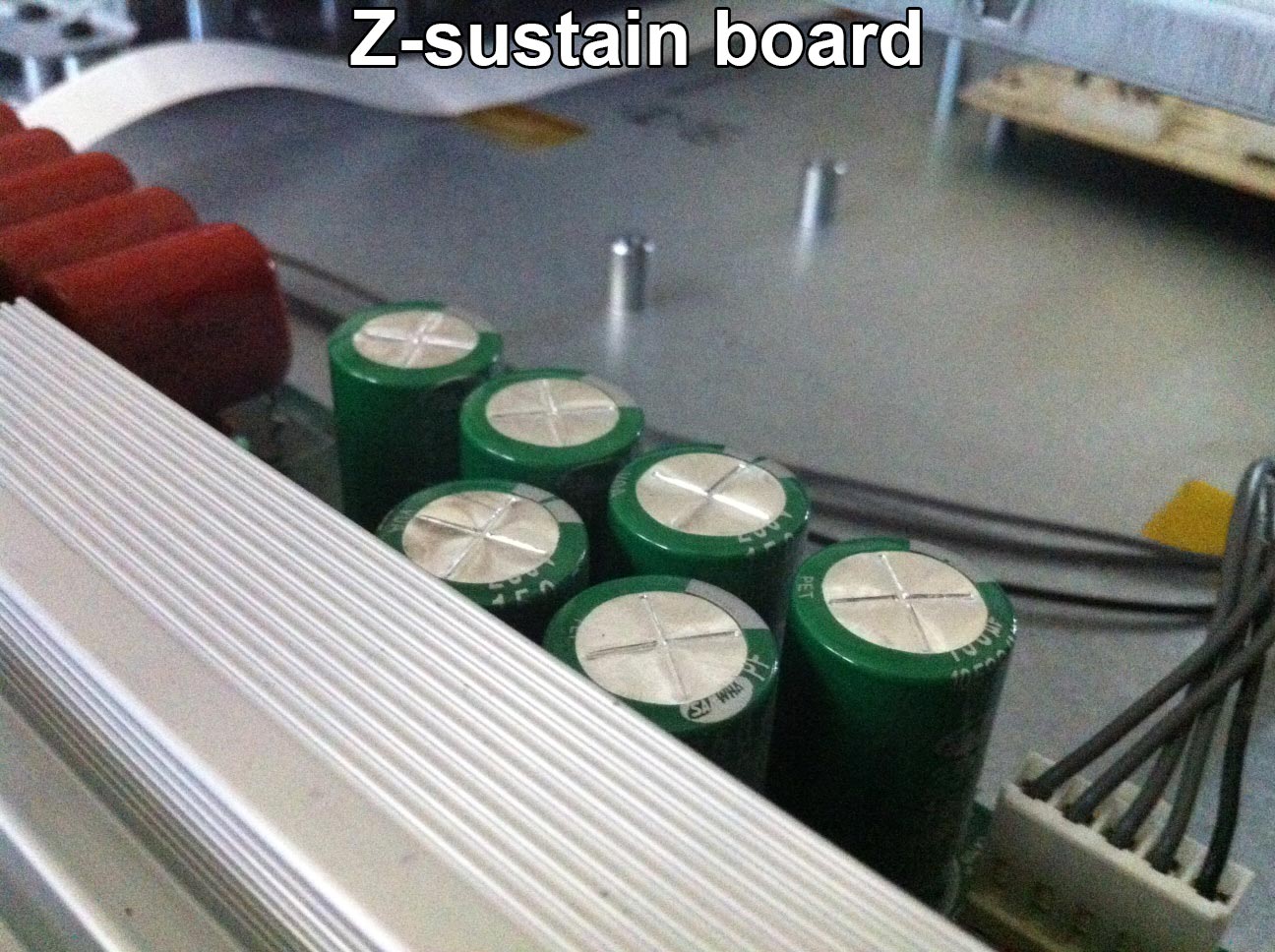

        can you post a top down picture of the caps on the power supply?
        **EDIT**
        The green caps on the sustains "appear" normal looking.
          Sure thing.
          Would it be worth it to replace each capacitor on the power supply board to see if it fixes the problem?
            The replaced caps are Panasonic, which is good, but they are NHG series - unsuited for a power supply application. Who replaced them? They could fail, but they would normally bulge (for a good brand.)

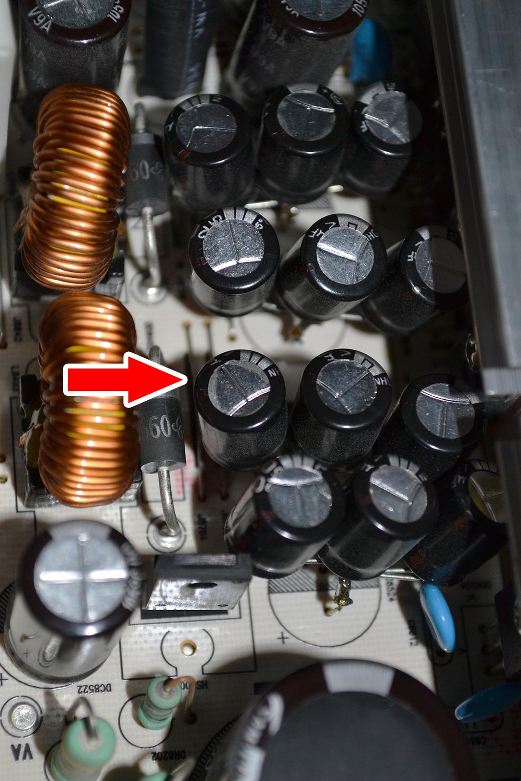

              They were replaced by a local TV repair shop a while back (I lost their number) however I found the same capacitors online for $15 total to replace.
              I think this may be the culprit of a failed capacitor (tell me if I'm wrong), but there is not much/if any visible bulging. Also, the 2 capacitors in the top right also seem abnormal.

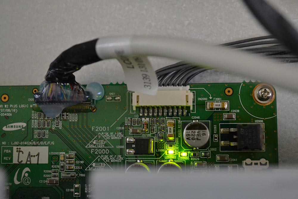

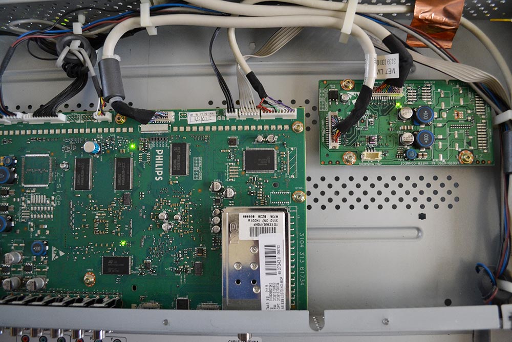

                Those caps look normal but it's hard to tell without the board being in front of me. What is the panel model? The 4 green led's you mentioned in post #1, do all 4 stay lit up when you turn the tv on?
                  There are 6 actual LEDs that light up as soon as the TV is plugged in. When I turn off the TV via power button, all the LEDs turn off except for the one on the power supply board.
                  When I plug in the TV it clicks once and turns on, instead of initiating standby mode. It seems the standby mode isn't working as the front indicator light on the TV always stays blue.
                  The panel is a Samsung PDP Module (Model: 50HW-YB02)
                  I tried using this troubleshooting guide but couldn't really follow it: http://www.scribd.com/doc/94596083/S...2hd-Mustang-Sm (page 41)
                    I -really- don't like how those caps are done; it looks like instead of sourcing the right caps, they have bodged several together. Consider removing the power supply and checking their solder quality.

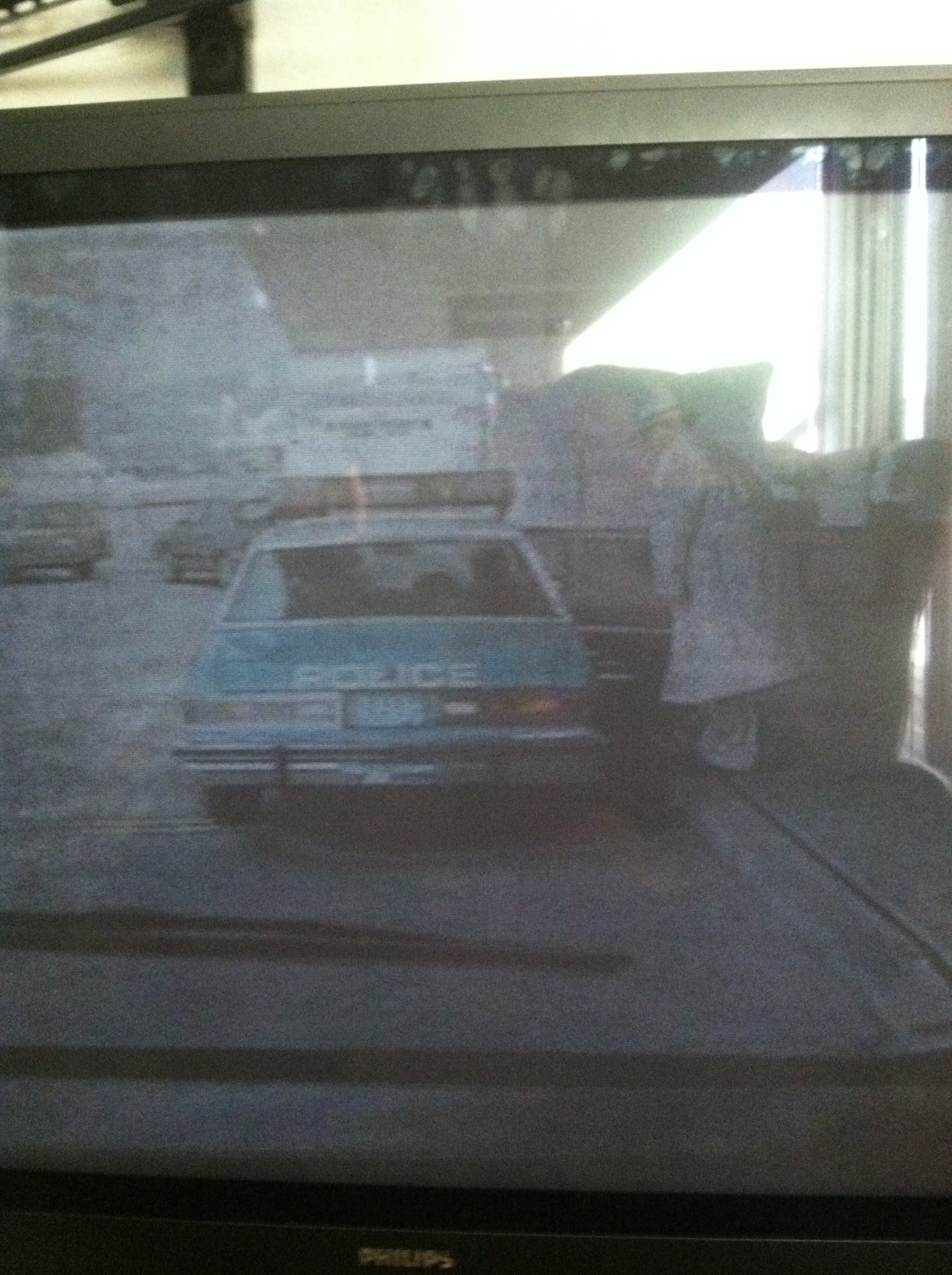

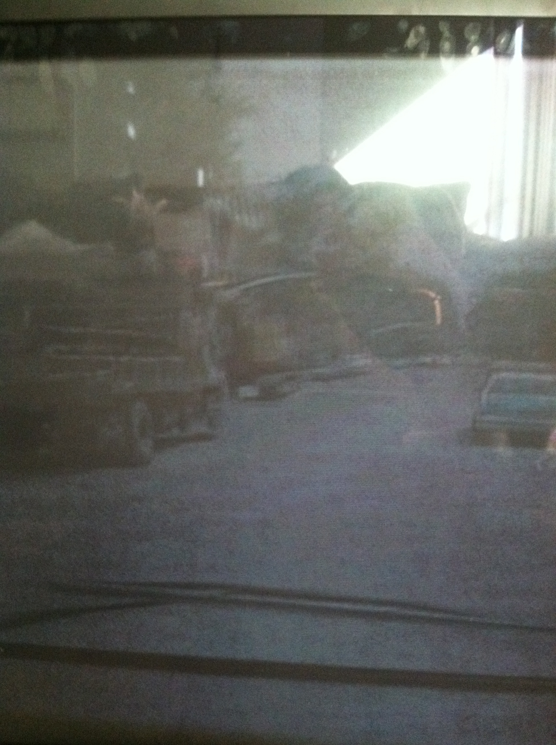

                        I have a few questions about this same model TV. I picked it up "broken" for $30.....Owner said it was getting some blink code...I didn't even check it for that....I just took it apart....It was obviously from a smoking home...smelled and was just filthy inside.
                        So I used air compressor to clean out and I took off the power board first...and checked all the caps with my 88a. All looked ok. Checked the 4 or 5 fuses on all the boards....and one came back dead....the first time I checked it...but when I decided to check one more time my meter beeped an all is well.....
                        So I decided to put it all back together...and check the blink code.
                        When I did...It fired right up.
                        Its been running for 2 days now....and about 4 movies worth.
                        Could it have simply been overheating due to the crude covering its insides? Should I check anything else or just be happy with it and forget the problems it was having?
                        and what do you think the selling price point for this set should be at this time?
                          Steelhack, my guess is that the crude coverings were not per se the actual issue but because of it, you had A LOT of dust right? Which may have made a connection unintended (seen it (well with computers not with a tv yet)). The fact that it would not come on (assuming) afterwards kinda makes me disagree with the heat thing (unless the heat affected something but it's working so.... lol) .....but resale would be in my opinion between $3-400. But keep checking to be sure
