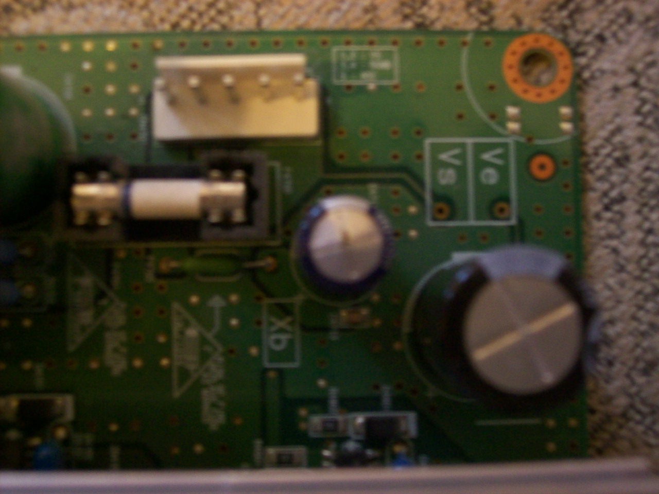

    I think I found the problem. On the z sus I found what looks like a bad capacitor. Here's a pic. Tell me what you think.
    Thanks!
    p.s. its the smaller capacitor. Thanks!

      Yep, that is definitely bad!

        I had a 42" Samsung plasma with no picture, and it turned out to be a bad cap on the Y-sus, and a bad X-main (though you could still get a faint picture without the X-main.)
