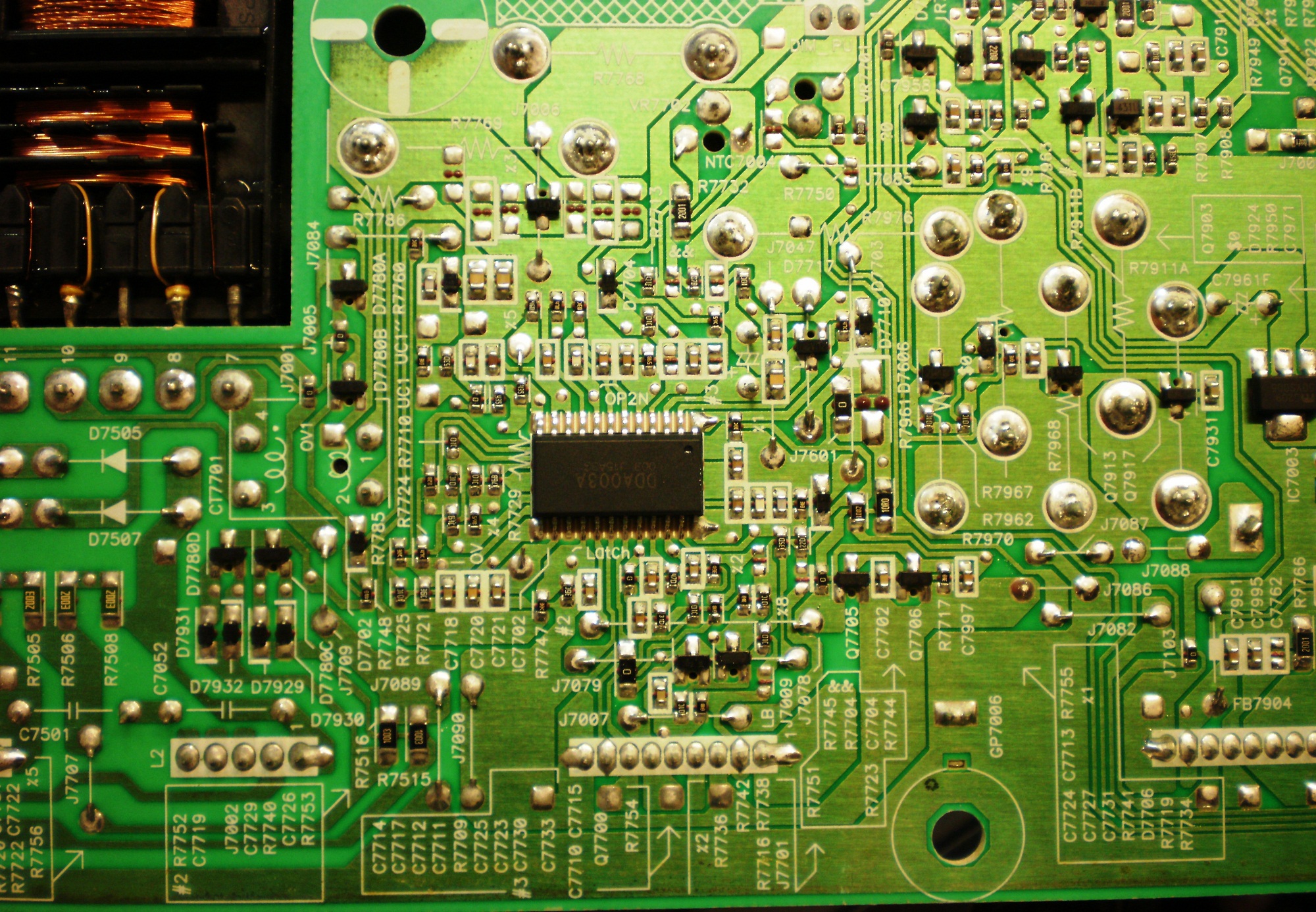

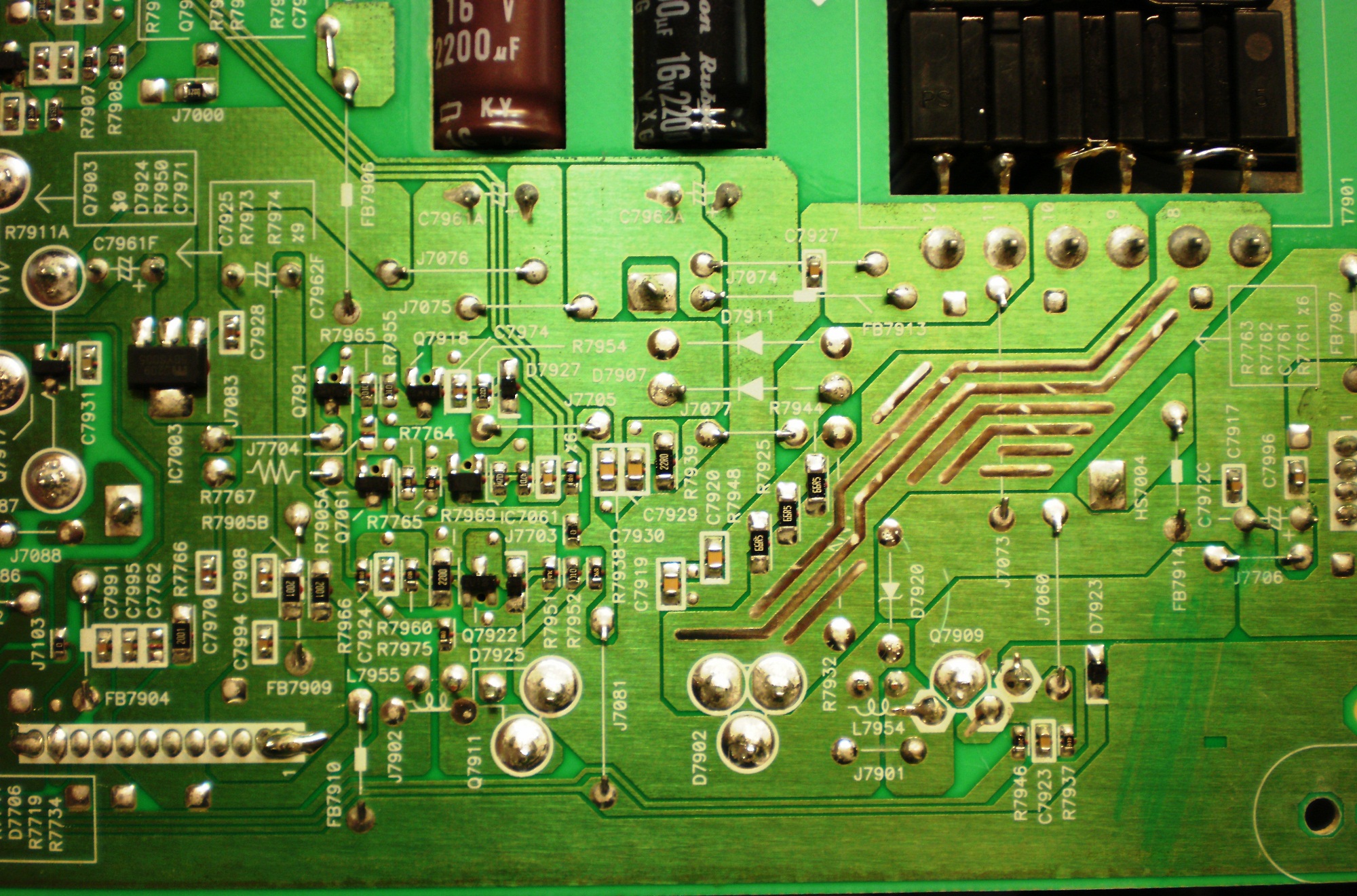

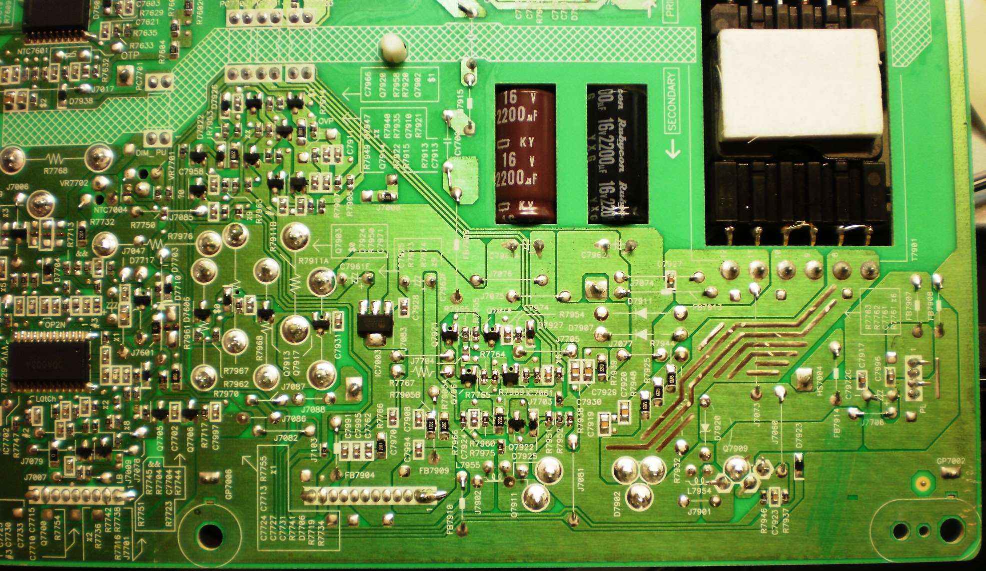

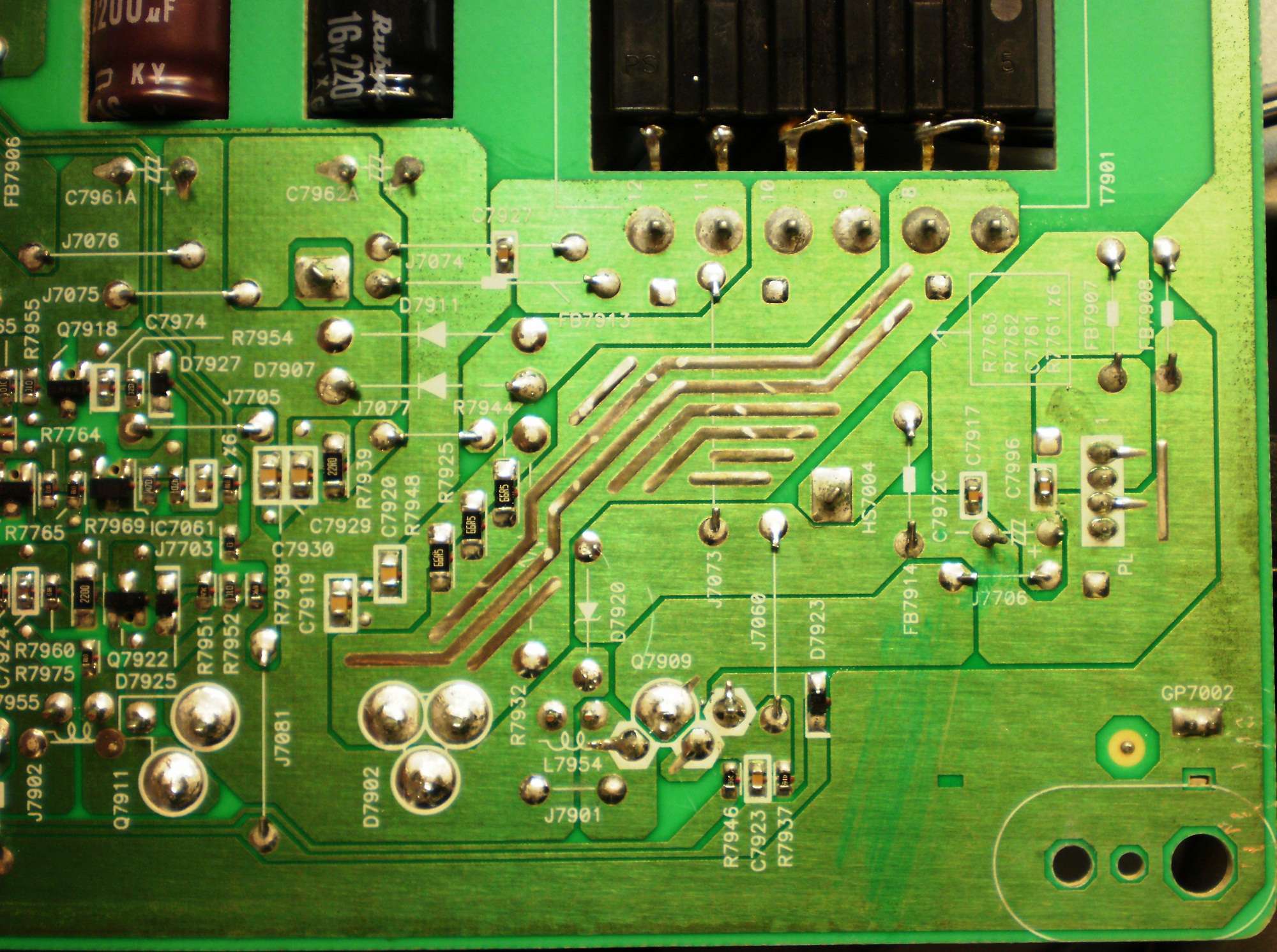

      OK, T-con is not receiving anything.
      Point
      #1= 5.555V
      #2= 13.04V
      #3= 13.04V
      #4= after like 10 sec. becomes 12.17V for a second and then drops toward 0V.
      #5= 0V(alternates between + and -)
      Here are the pictures:
