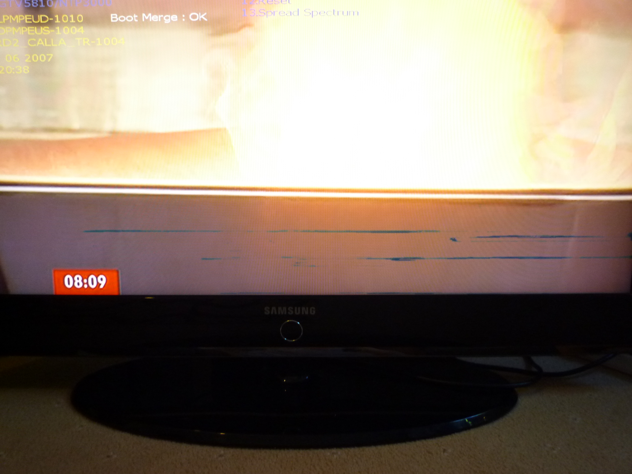

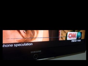

    Hi all, my Sammy LE40M87BDX has some fixed diagonal lines across the lower half of the screen which is similar to the securityman thread. Number 12 on the service menu says 'reset' which I presume is the factory reset? Should I try this first? The lines do not move, I've not taken a look inside yet.
    Re: Samsung LE40M87BDX - Diagonal lines across lower half of screen
    If the lines do not move, I would presume LCD failure.
    RESET may be the best option.

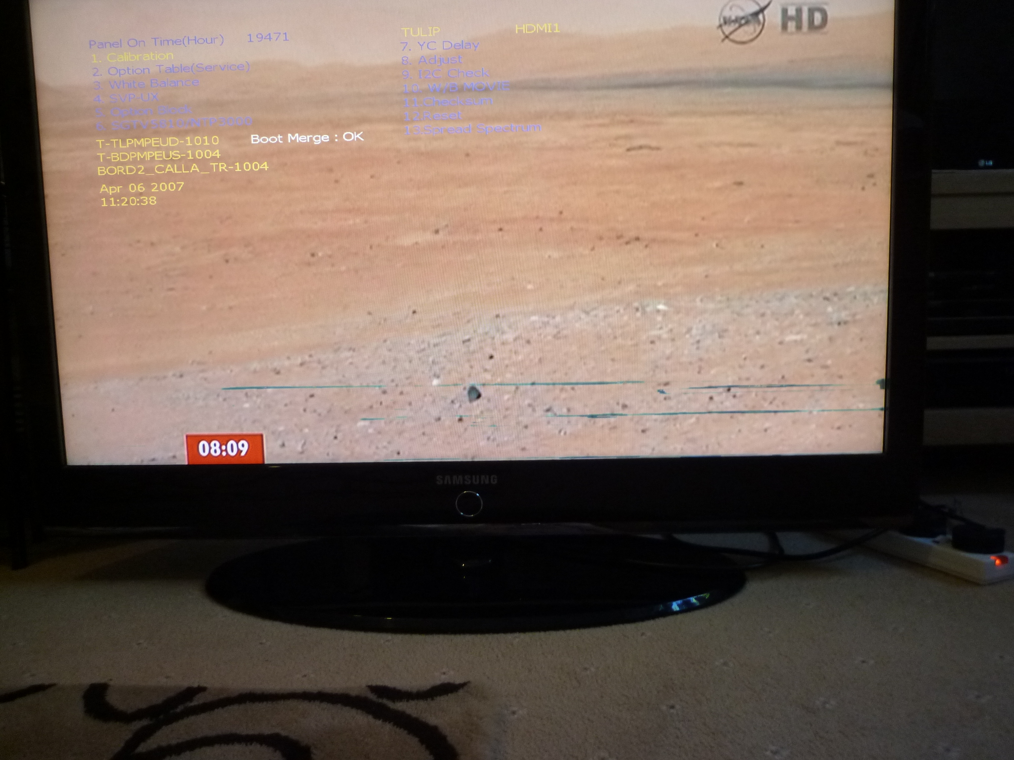

      Just performed two resets but, the lines are still there. If it's LCD failure then, do I presume the panels bad? Don't suppose PixelProtector DVD will fix it, maybe I'll give it a go?
        It looks like the screen has been laid down on something or something put on it when flat. I have seen it on a smaller scale and tried a pixel repairer but it did not work. It was less obtrusive on mine and kids had it in their bedroom.
        I think it is permanent damage to the panel.

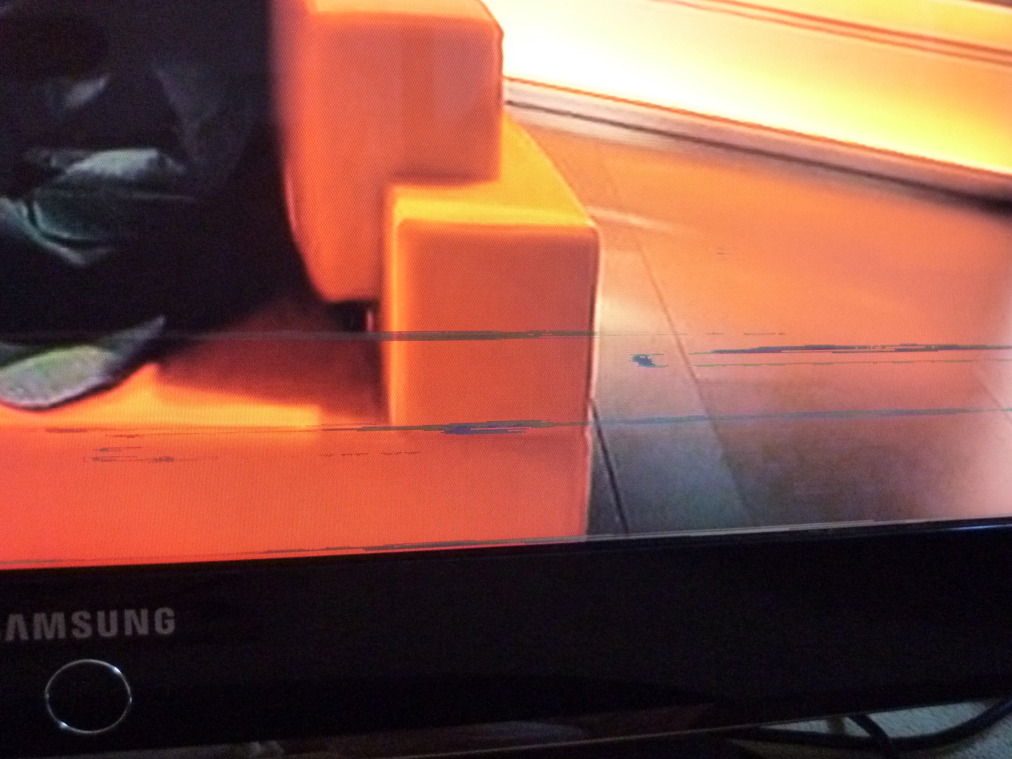

            Bump! Don't want to hijack this thread but my TV (same model) seems to have the same problem and I have some interesting details.
            TV first showed short coloured area over multiple lines approx. 5cm wide and less than a centimter high, consistent with an impact (because children reported that a toy was thrown at the screen)
            The area widened very slowly over several months. And at the same time sporadically the TV started the Samsung typical on/off-switching sometimes longer, sometimes shorter periods but always stopped after minutes (or hours ) Also the intervals appeared to be arbitrary in length.
            After moving house I initially didn't notice when we saw that the problem was completely gone, the picture clear as when new (bought about April 1997 for 1299 pounds w/ a DVD recorder) However, the onf/off-switching intensified in an unpredictable manner.
            Only after several weeks the "impact" spot re-appeared and over the next week widened slowly but steadily into the fixed lines you can see on the attached photo.
