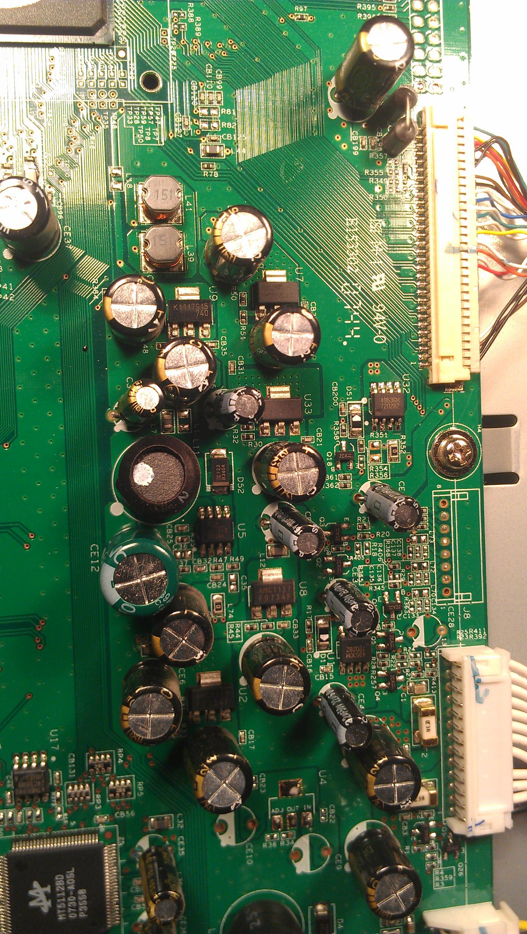

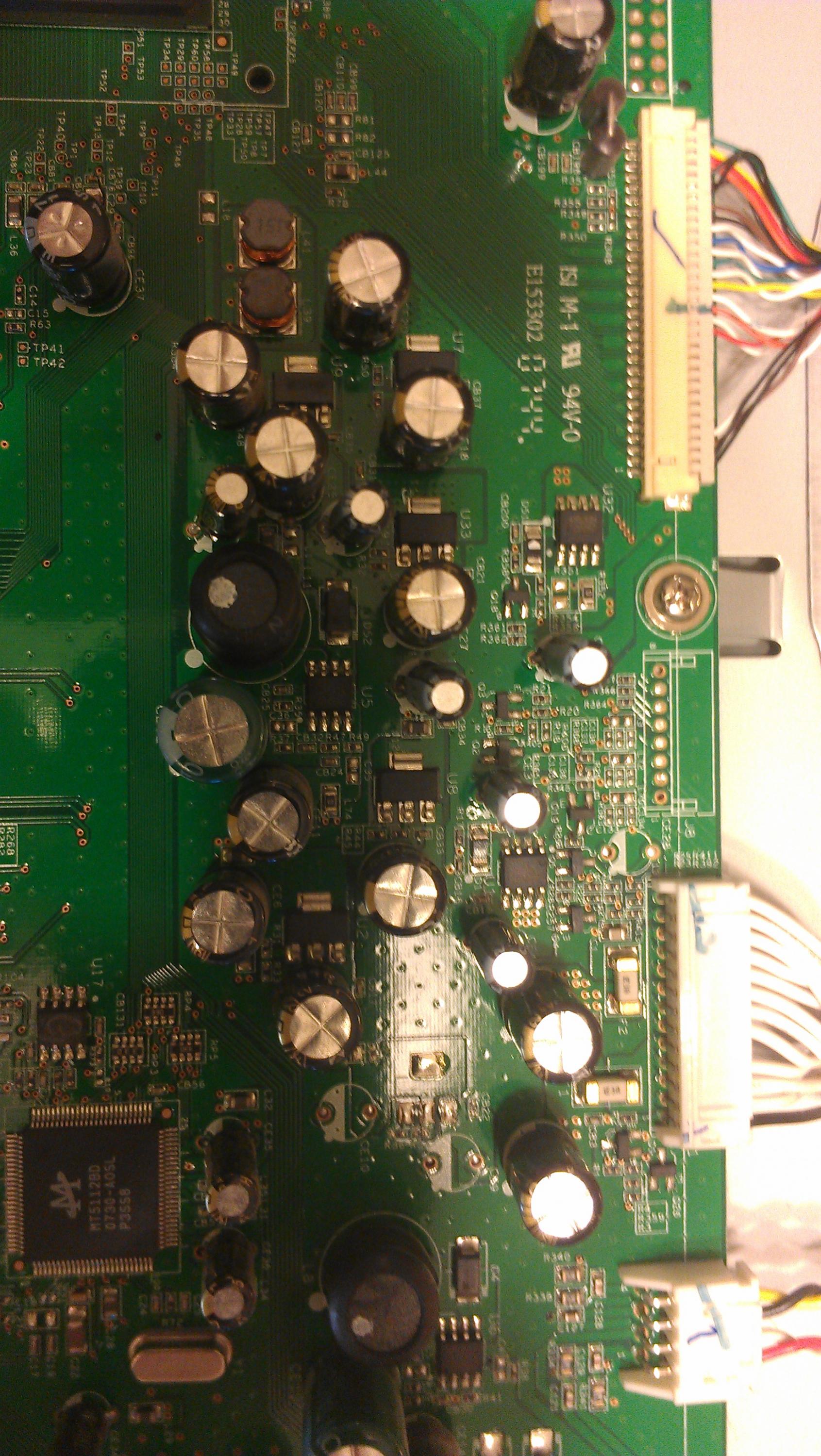

    I have been pouring over the TV repair threads for weeks now, and watching YouTube videos about these Vizio TV's and am stumped.
    First off I have little to no background in electronics, but am very familiar with using DMM's and soldering equipment and the like. I am an A&P Mechanic so I know how to follow directions and look for discontinuities
    My symptoms are similar to everyone else's in that the TV will turn on (Logo from orange to white) but that is the only response I get, and the set must be unplugged to reset (or press the reset button on the main PCB). I have checked the fuses and voltages on the main board and get 5.23v Standby, and a full 12.12 for power. LDO Regulators are as follows:
    Ident - Vin - Vout - Vreg
    U2 - 5.19 - 2.37 - 1.47 AMC1117
    U8 - 5.21 - 3.33 - 2.07 AMC1117
    U33 - 5.19 - 3.35 - 2.08 AMC1117
    U7 - 3.35 - 1.3 - 29mV AMC1117
    U9 - 3.35 - 1.54 - 1mV K1117515 ?? Fixed v. Adjustable?
    Besides U9 I found the rest of the voltages to be in range, but what do I know!
    PSW_ON Voltage is at 3.15

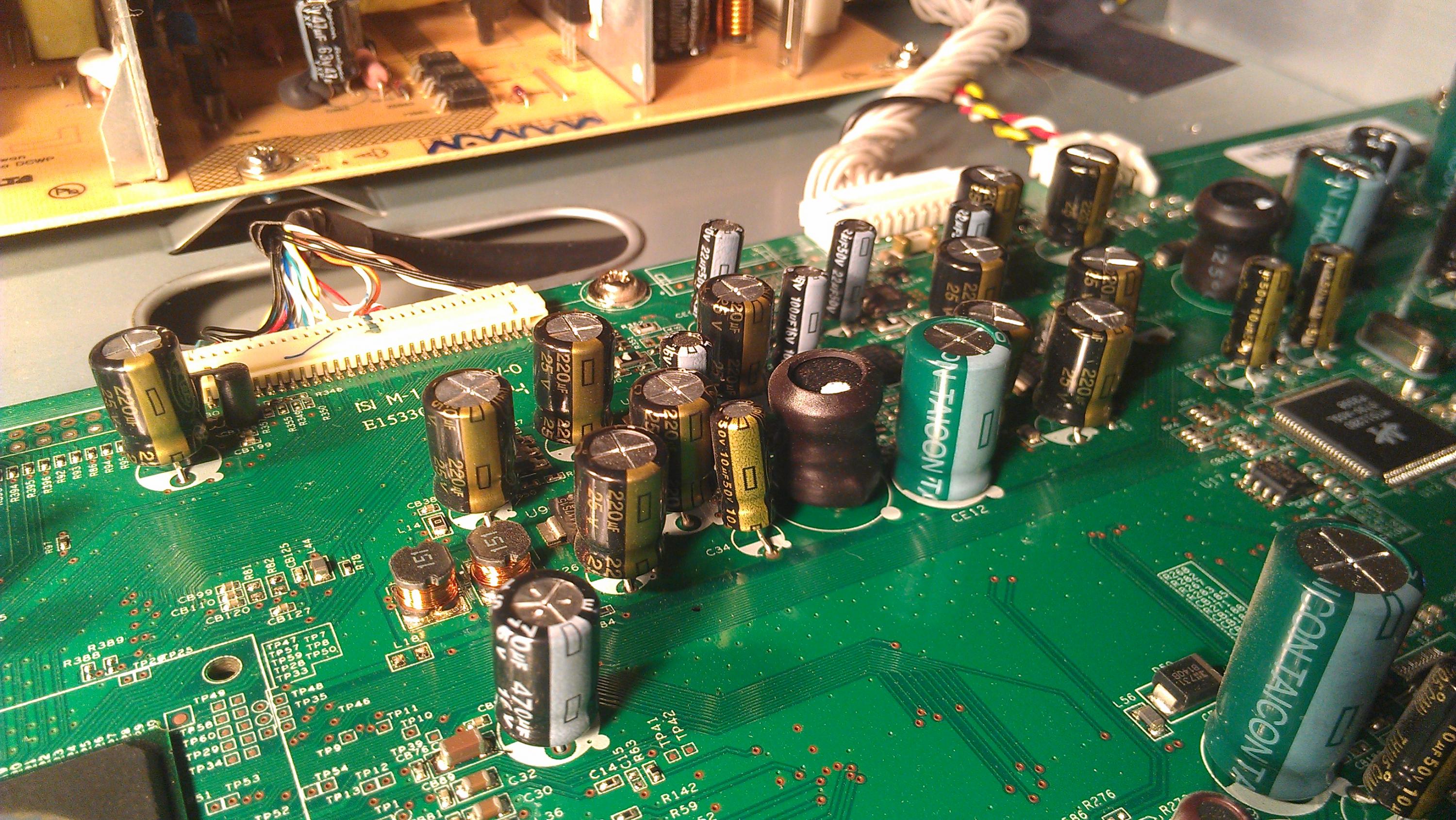

    I see no evidence of bad caps (no leaks, buldges, etc) and besides visual cues have no way to test said caps.
    All of the voltages going to the ccfl ballast board are on target and the two fuses on said board test ok as well. When power button is pressed you can hear the faint click of the relay to power the ballast board, but no action. BUT when I unplugged the center harness from the power supply (both the center and right/colored wire harnesses feed the ccfl ballast) to test voltages at the supply, the ccfls illuminated!
    Same problems exist with the TV but with that harness unplugged the backlight will come on.
    Has anyone had any success with a problem such as this?!? The TV was free and I don't really have money to dump into buying new control boards, chasing unknown problems (I'm just an A&P Mechanic, memmer?) but I am willing to troubleshoot, and even learn a bit along the way if someone has knowledge to share!
    Attached are (crappy) pictures of the guts of the tv for your viewing pleasure, but know I'm about as good at taking photos as I am with diagnosing TV faults.
    Any help would be greatly appreciated!

          The LDO if it is adjustable type, the Voltage between Vadj and the Vout should always be 1.25V (this is from internal precision 1.25Vref circuits), the typical tolerance is between 1~2% (depends on the manufacturers). Vout = 1.25V + Vadjust. I.E. Vadj to ground = 1.25V, then the Vout should be 2.5V.
          U2 voltage does not look right.
          Please check the Vadj/Vout pin to see if they are correct when you add up the numbers.

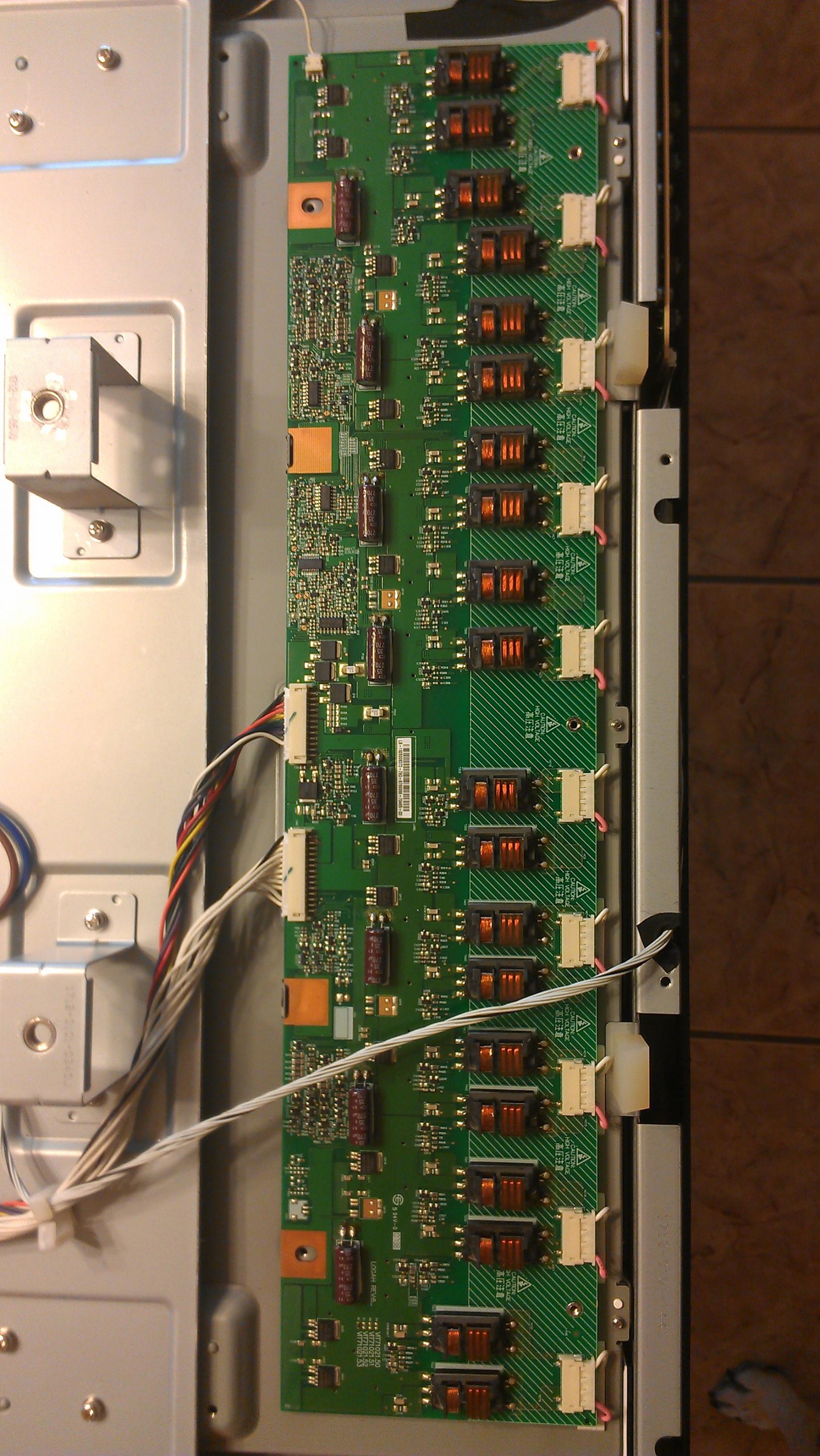

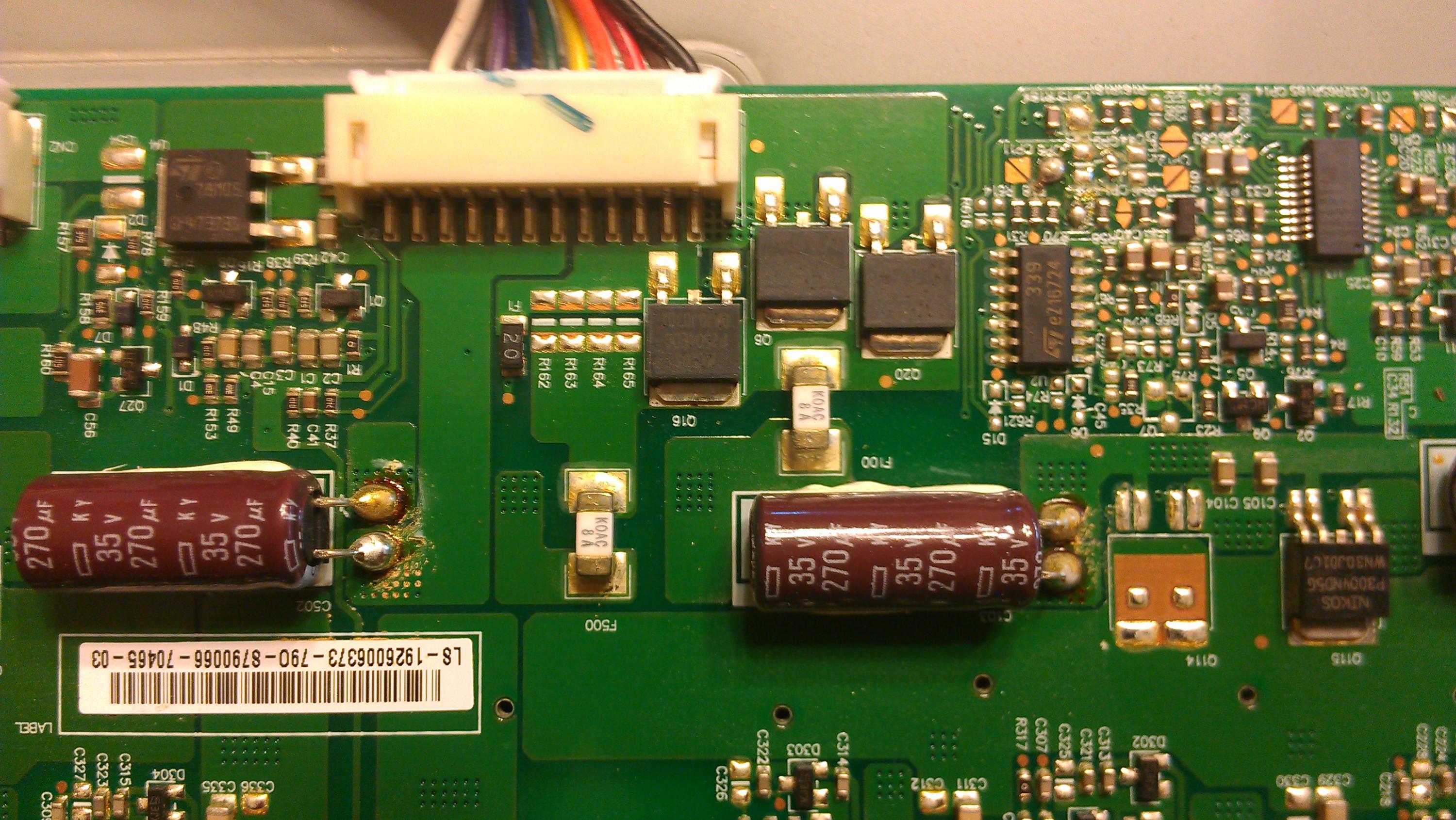

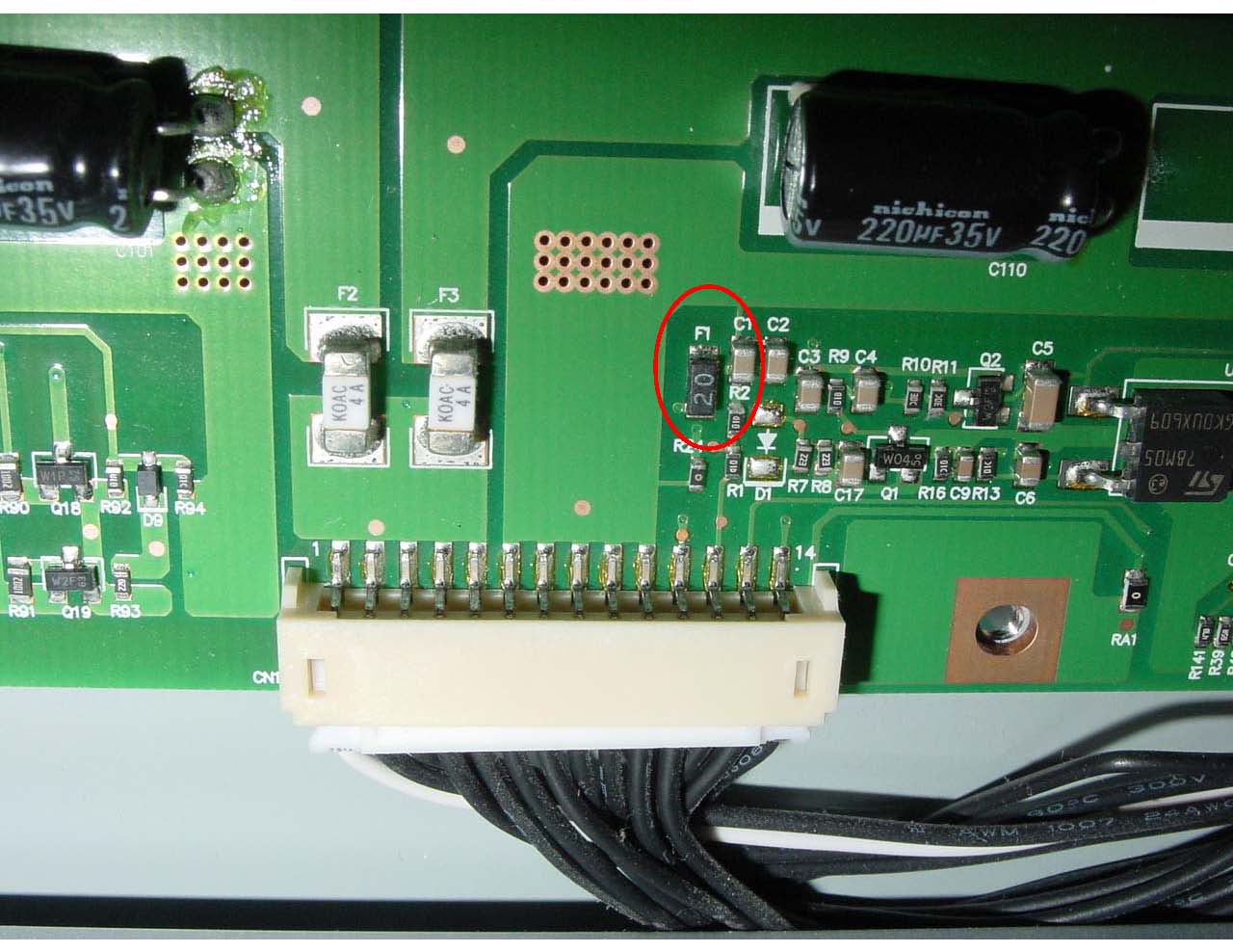

          Do you get BL_ON at the inverter connector?
          There should be another very small black fuse for this CHI-MEI (CMO) inverter board, see the picture for example.
          Please post closed up pictures of the inverter board.

              Yes, the inverter board has that fuse, as well as the 2 white SM fuses. Continuity test said they were good (not open), <1ohm resistance

                How about BL_ON signal?
                  Re: Vizio VX42L Progress?
                  Yes, here is a picture of the inverter board. All three fuses are good. Getting 24.6V at all 3.

                            You weren't the first and won't be the last to make the above mistake. I see a lot of message that state "all the regulators check out", but people never post the actual readings so now I ask.
                            There is also a chance the regulator is good, but the cap feeding pin 1 is bad.
