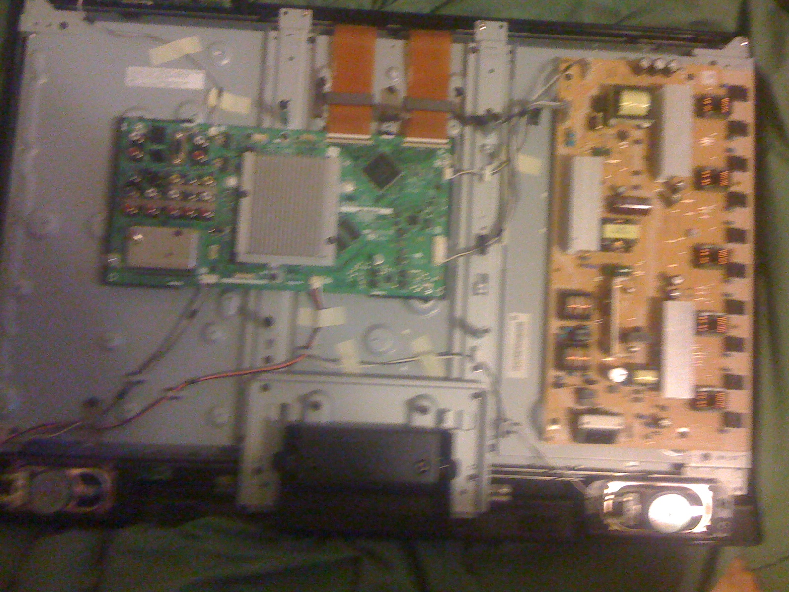

    sharp lc-c3234u
    first when i plug in the tv the green light blinks then when i hold the power button for 15 seconds then the power light turns solid red and when i press it again it turns yellow and the lcd comes on for 5 seconds then evey thing goes black and 5 seconds after that you can hear the relay on the power board click and then the green light blings again. all the caps look good but i have found one bad diode but i can not find a schematic for this power board. (runtka397wjqz) i will add pics soon. thank you for any help in avance

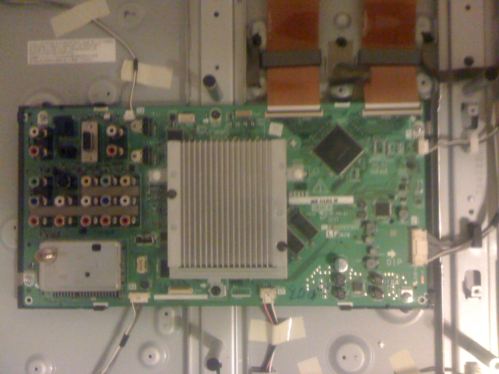

    Re: sharp lc-c3234u
    here is the pics

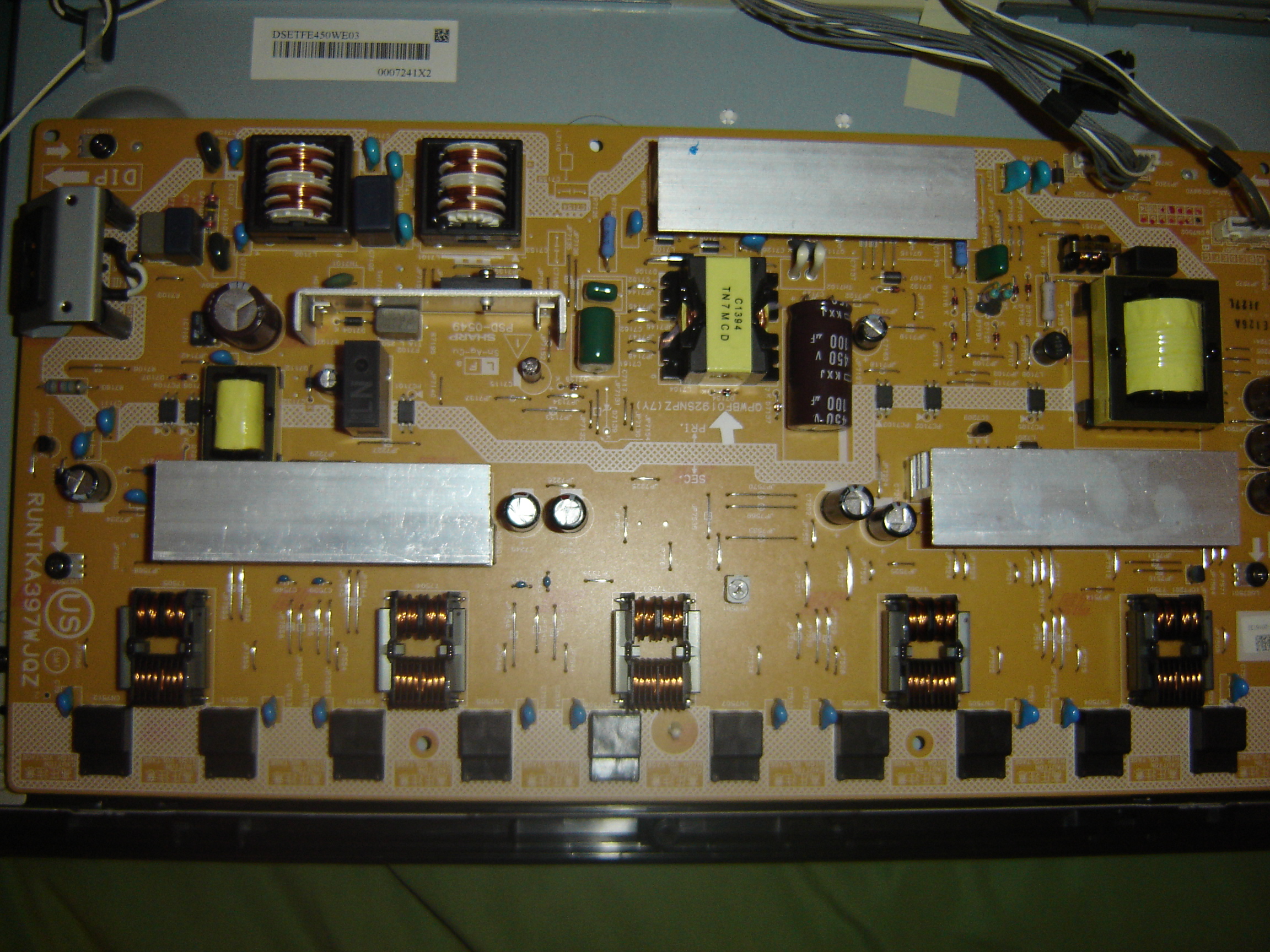

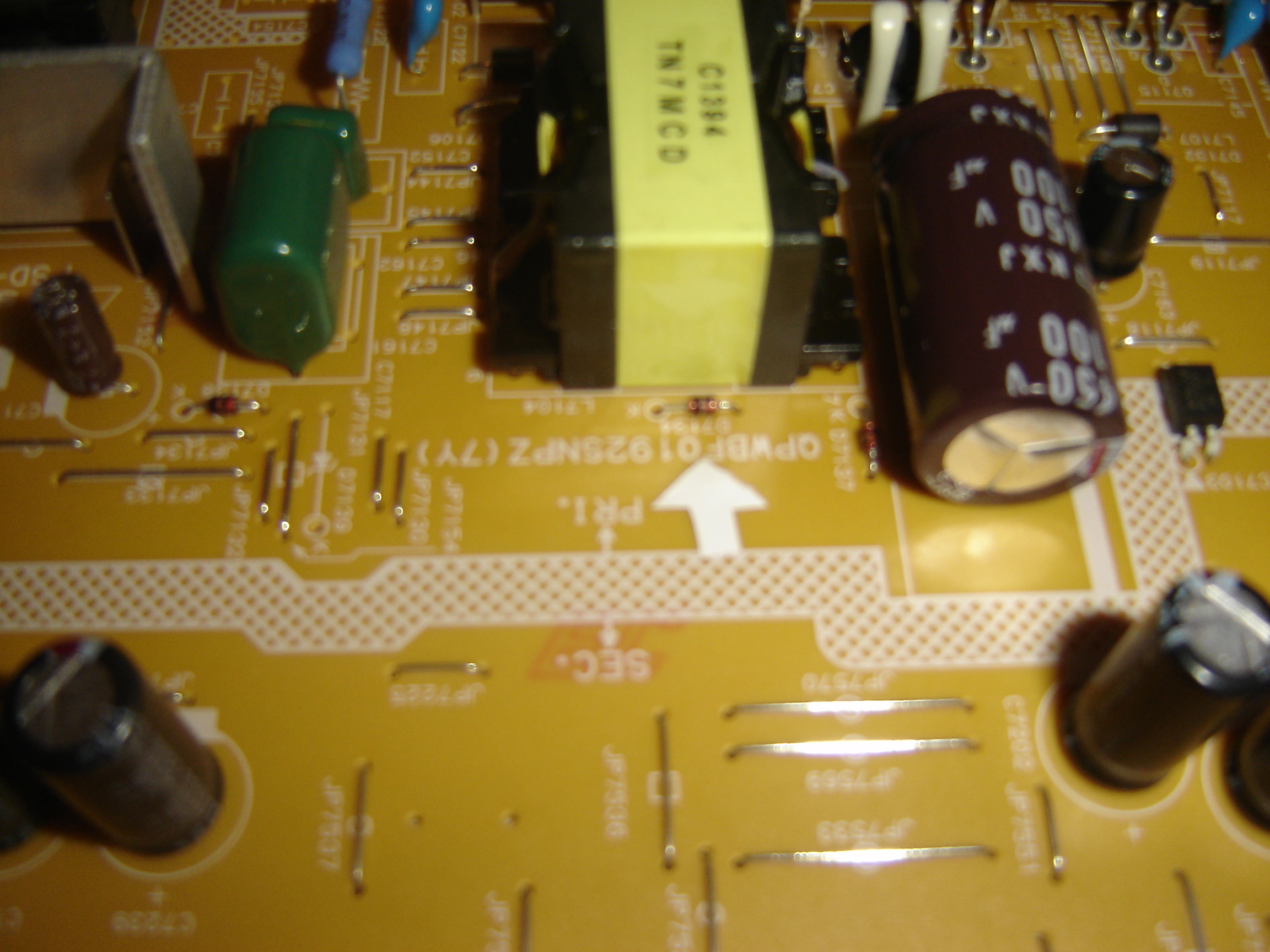

      Re: sharp lc-c3234u
      The bad diode i found has d7134 next to it but this code is useless with out the part list or schematic right or is there a nother way?
        Re: sharp lc-c3234u
        The picture is too blurr to see that bad diode, can we get good clear pictures so may be we can figure out the function of the diode is?

          Re: sharp lc-c3234u
          i put white arrow pointing to it this time

            Re: sharp lc-c3234u
            Does it show shorted when you measure it with one leg lifted off the board? Not sure the function of this diode, it is small so it will not be for power.

              Re: sharp lc-c3234u
              the diode was good

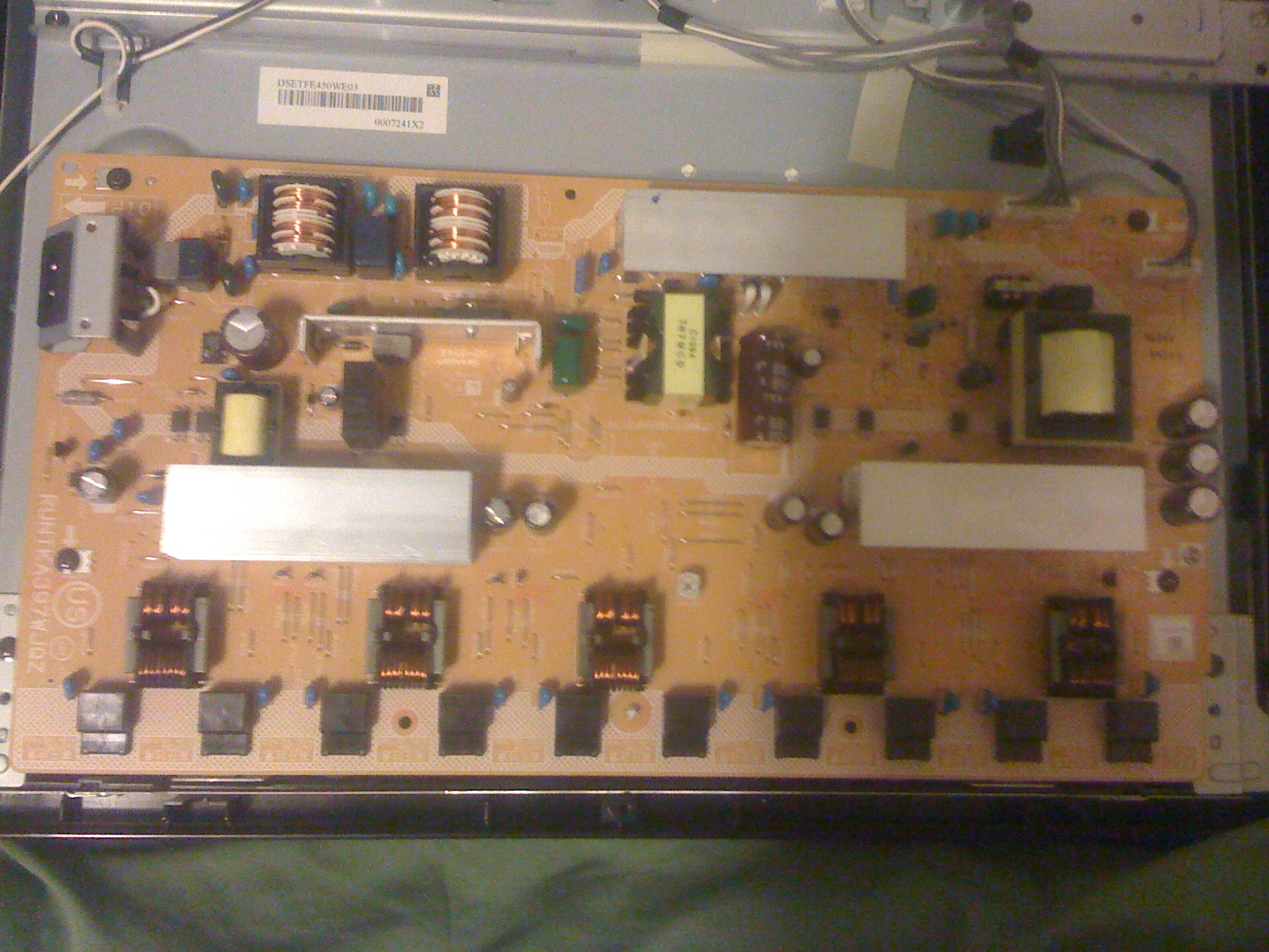

                  Re: sharp lc-c3234u
                  The board you are working right now is a power supply/backlights inverter board combination.
                  There are many things to test on this board, such as the secondary windings resistance of the inverter transformers (you have five of them on your board), fuses, burnt component, shorted/open transistors, MOSFET's, Diodes, bad traces/connections.
                  To test the lamp, you will need working backlights inverter board to drive the lamps.
                  Can you tel us the blinking pattern of the power light, may be we can look up the error codes for it.

                              Re: sharp lc-c3234u
                              i put the board back in. now it has been on for 30 minutes and all the back lights are good. but what could of caused this?
                                Re: sharp lc-c3234u
                                So are you getting pictures on the screen? Some Sharp TV uses the lamps with metal caps at the ends and then snapped into the lamp sockets, may be some came loose?
                                Some of them may have wires solder to the ends of the lamps and they do have wire burnt out problem, this happen a lot in the monitor: http://s807.photobucket.com/albums/y...klight%20lamp/
