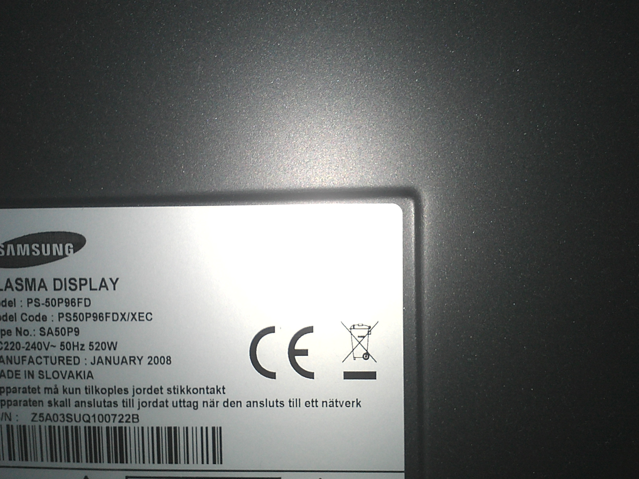

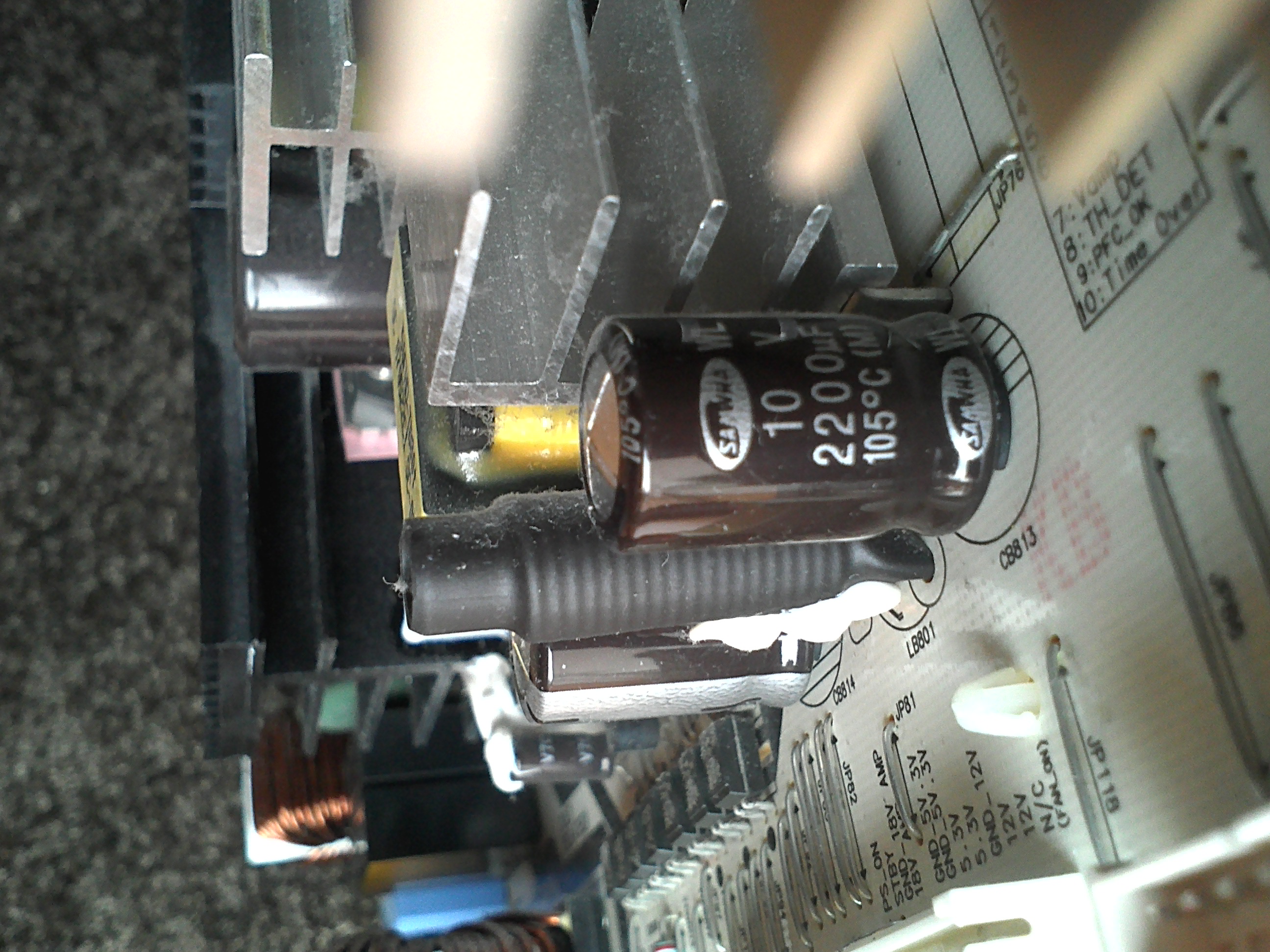

I've got RED blinking LED on front panel when pluging in AC cable? Is that faulty power supply?
Ps-50p96fd
Re: Ps-50p96fd
how long is a piece of string?need more info,what have you tested,what do you have to test with?looks like a plasma by the model code,i dont do plasmas,some on here do,put up a bit more information first.fixed so far...376 lg lcd tv's,24 onn tv;s,24 panasonic lcd,16 jvc lcd,12 marshall jcm800 amps,refurb of various disco equipment lighting,old style disco decks ,and a flymo!

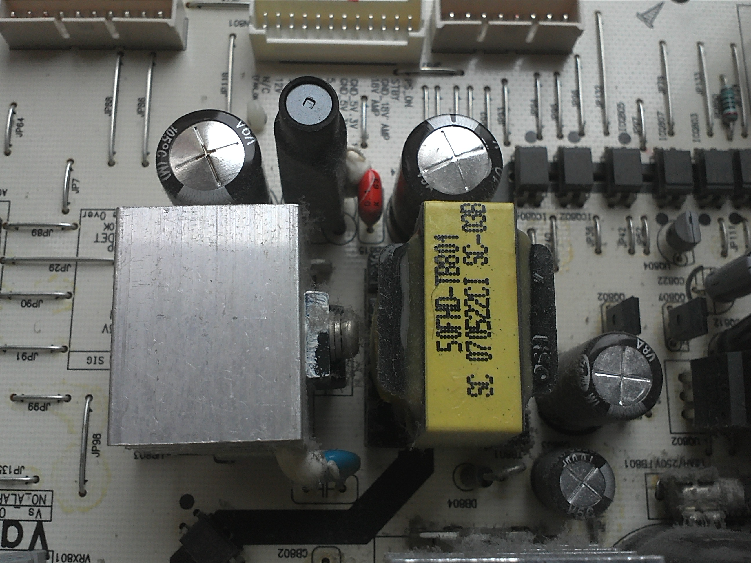

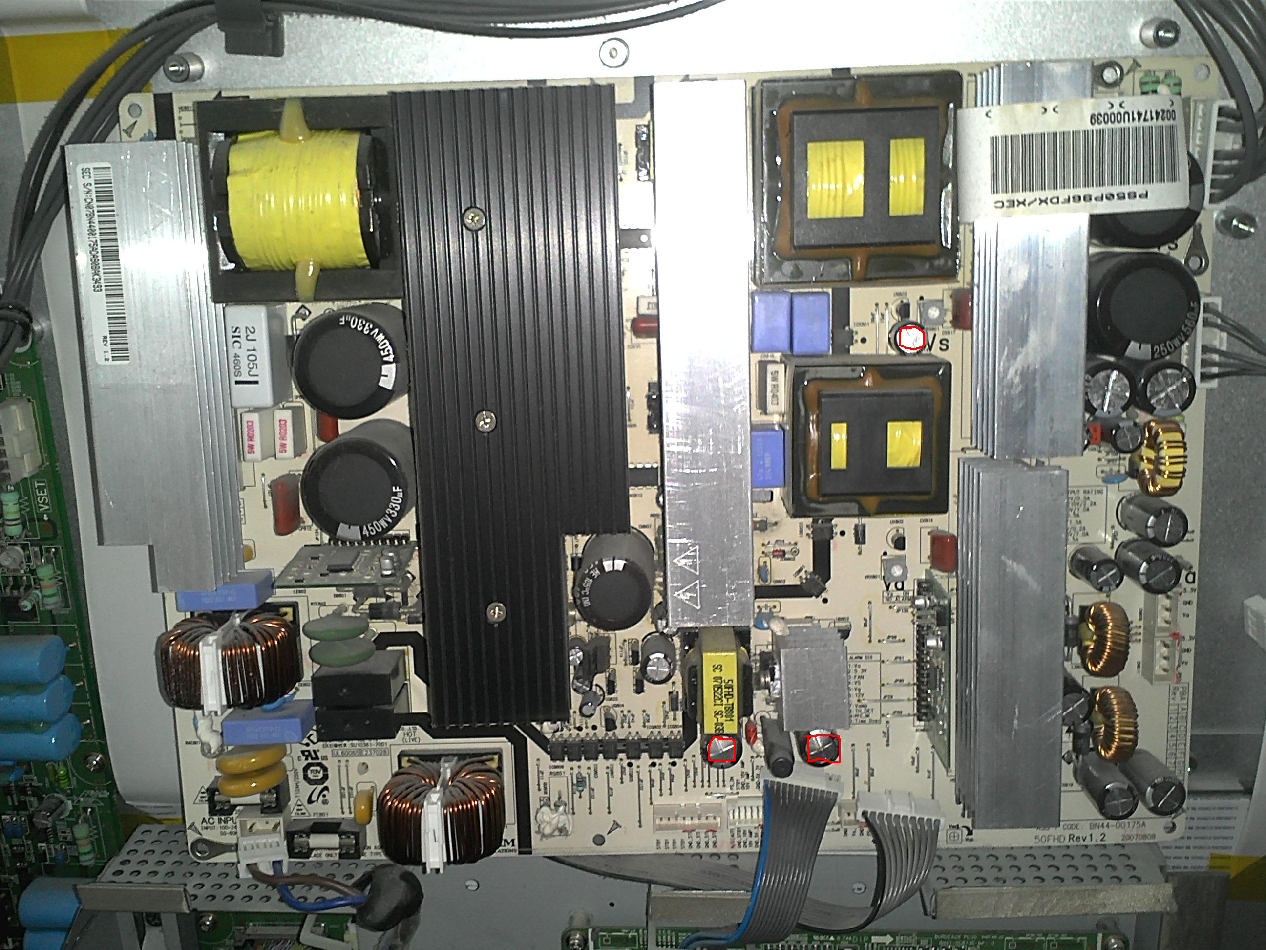

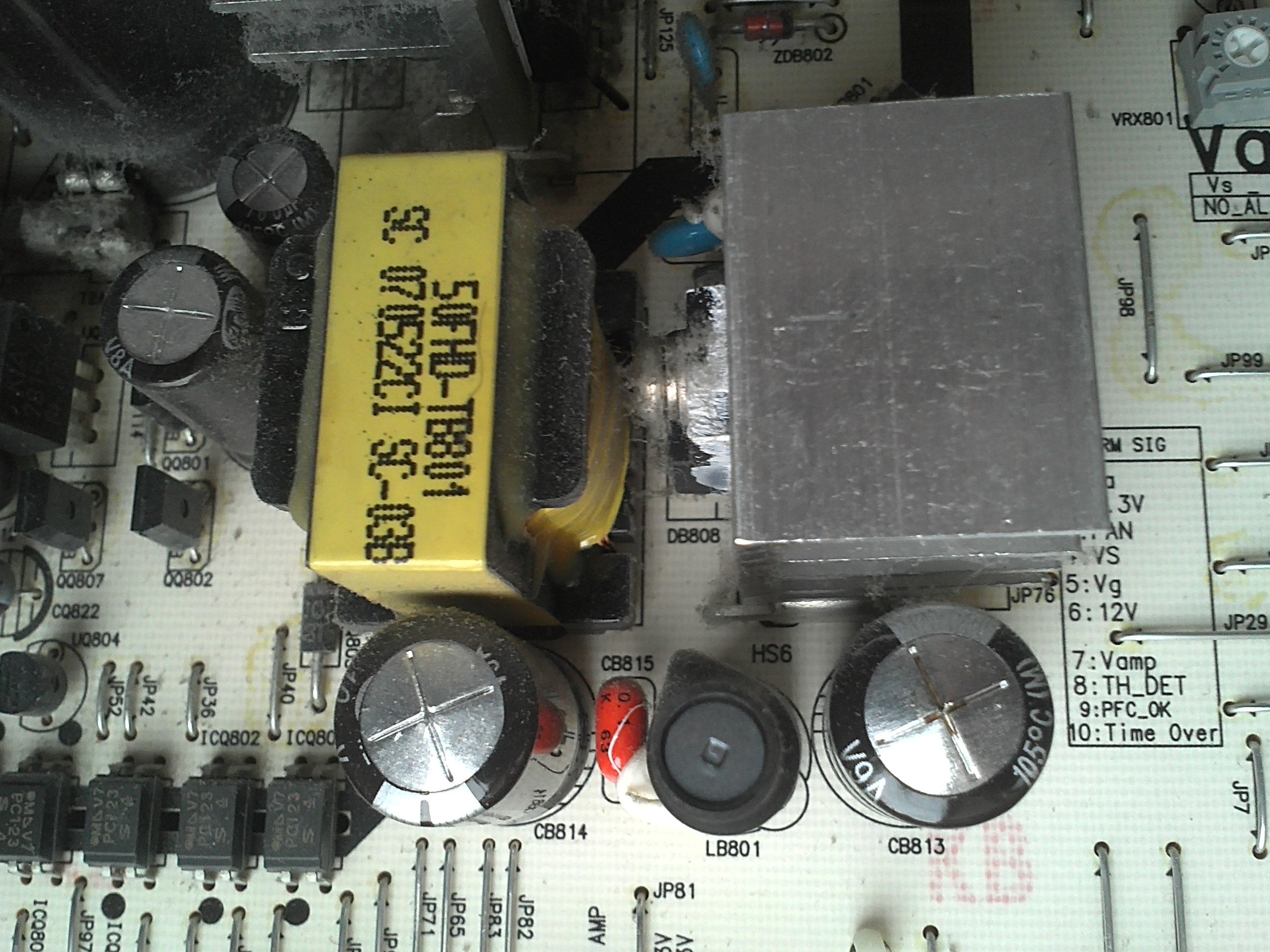

Ok pictures are quite good but are off-site I and some other members would prefer if you could upload them
Welcome to the forum-

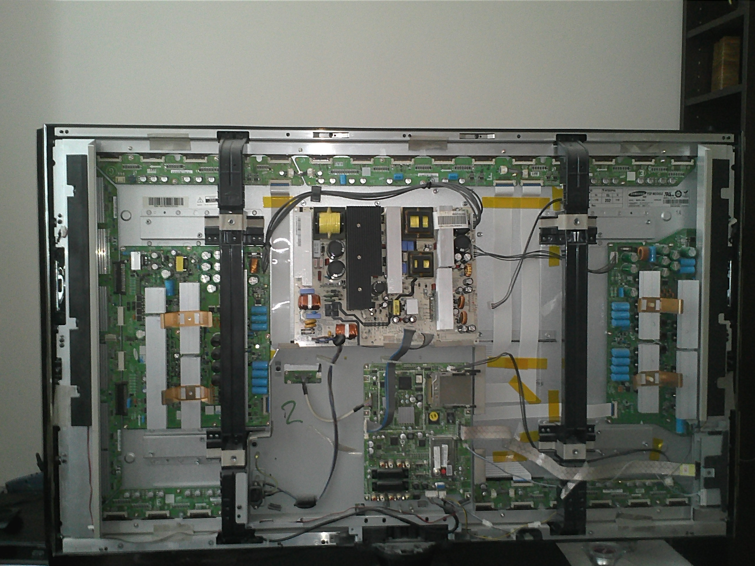

We can help a lot more if you please post good clear pictures of the whole chassis, and then pictures of each board, front and back and close up of connectors, (max resolution 2000x2000 and 2MB) using the manage attachments button, which is found by clicking "go advanced" under quick reply.
It will be useful if you can say what the supposed fault was and a bit about yourself - skills tools etc. Do you have a multimeter and soldering equipment.

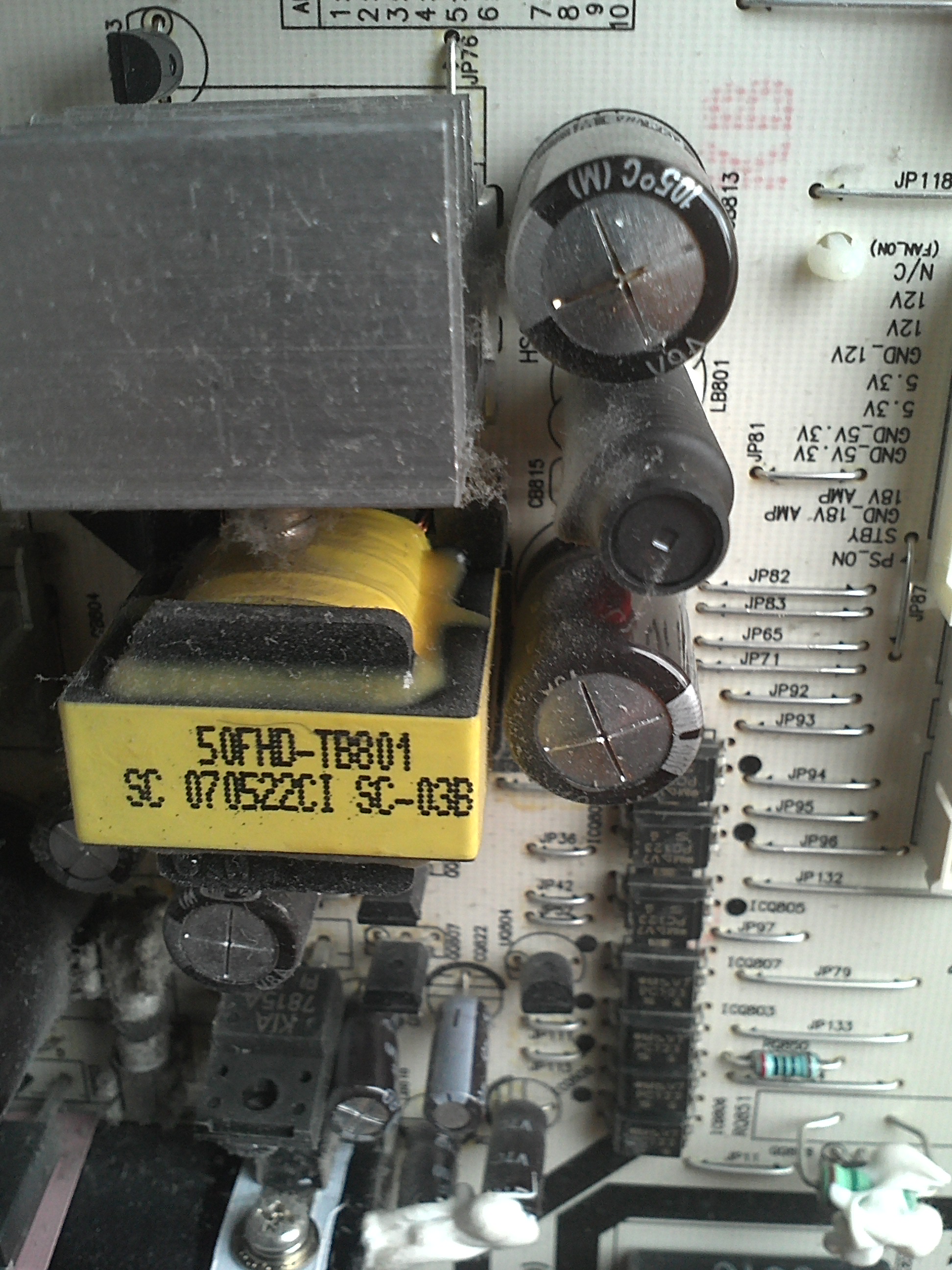

The two small caps at the bottom look bulged to me and one at the top looks odd but the flash has washed it out so cant tellPlease upload pictures using attachment function when ask for help on the repair
http://www.badcaps.net/forum/showthread.php?t=39740Comment
Re: Ps-50p96fd

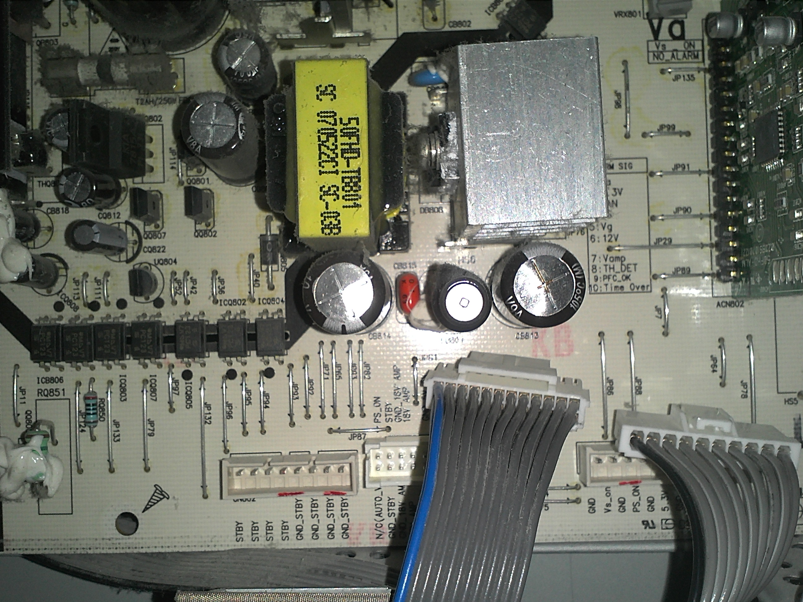

The 2 caps bellow are on IMG117.jpg and also looks bad to me. Uploaded 4 more pics of these caps. One is definitely leaking other one looks close to it.
I've got good soldering skills and i can borrow multimeter. How can I really find out if these caps are bad or OK?Last edited by sekino; 08-11-2012, 06:09 AM.Comment
Re: Ps-50p96fd
Those are definitely bad. They look like Samwha caps - a bad manufacturer, I've replaced too many of those. I think the count is 23 now over two LCDs and two plasmas (both LG or Samsung - the only companies that seem to use these crappy caps.)
You should replace them with caps such as Panasonic FC/FM/FR, Rubycon ZLJ/ZLH, Nichicon HD... do NOT use general purpose caps.Please do not PM me with questions! Questions via PM will not be answered. Post on the forums instead!

Ok Samwha caps are not very good - closely check others on the board we would normally recommend changing any of the same make and series.
How is it in Slovakia for getting replacements - general purpose caps are not really suitable for this application and you should try and get some with low esr (obviously same voltage and capacitance.) At a minimum get some with 105 degree temperature marking.Please upload pictures using attachment function when ask for help on the repair

hi guys, MISSION COMPLETE
I've bought 2 new caps from local store http://thorn.inshop.sk/inshop/elektr...200uf-10v.html put it all together and it's again UP AND RUNNINGComment
