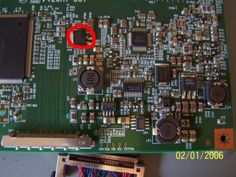

                      Re: JVC lt-47x579 backlight comes on but nothing else
                      11.58V is quite low but probably high enough.
                      There is a voltage regulator on the T-con. If this fails it could cause issues. I've highlighted it in the picture attached.
                      To test it:
                      - Set meter to volts DC
                      - Place black probe in a spare screw hole in the metal frame of the TV
                      - Place red probe on each pin: pin 1, the tab pin at the top of the regulator, and pin 3. Note the voltage on each of the pins. Be careful not to short any pins together.
                      - Also note down the part number on the regulator for example LM1117-33.
                      When TV is on, can you turn it off using the remote control, or do you have to unplug it?
                      And, if you connect a source to, say, the composite video input and audio input, and flick through the inputs using the INPUT or SOURCE button, do you eventually hear any sound?
                        Darn it I always forget the attachment! Gmail and Thunderbird remind me, vBulletin doesn't...
                        • JC1979
                          • Jul 2012
                          • 17
                          • canada
                          I don't see the attached picture, however I did just hook the tv up to my cable box with a hdmi cable. tried it in input 1,2, and 3. no sound. I verified that the box was on a channel with sound by hooking it up to another 32" lcd. And I can turn the tv on and off with the remote and the button on the side of the tv.
                          , ah, theres the picture. Will go test now.
                          • JC1979
                            • Jul 2012
                            • 17
                            • canada
                            the readings i get are.
                            the tab pin o.oo4v
                            the top pin 2.478v
                            the bottom pin 3.276v
                            I wasn't sure which was pin 1 or 3 so top is the upper most one in the picture you posted and bottom the lower pin. and the tab on the left.
                            this is with all the plugs connected and the set powered on..
                            the number on the reg is
                            AME8815
                            AECS250
                            0747

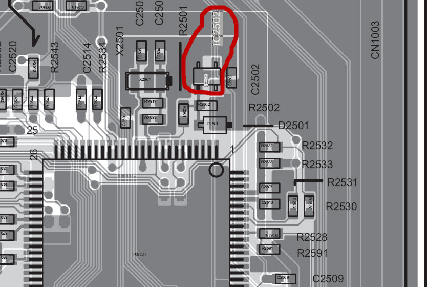

                              Symptom:
                              After the TV is powered ON, no video appears and the blue power LED remains lit. If the
                              Signal PWB of the TV is heated prior to AC application to TV Power Supply, the TV set
                              powers ON and operation is restored upon AC application and TV Power ON.
                              Cause:
                              The Reset IC (IC2502) on the Signal PWB does not reset. There is not enough margin
                              between the Setting Voltage (3.1V) of IC2502 and the VCC (3.3V) of IC2502.
                              Solution:
                              Replace IC2502 (3.1V) on the Signal PWB with a (2.8V Reset IC type)
                              new part number for IC2502 is IC-PST8228U-W or S-80828CNNB-G-W
                              Ron Driver,BSEE,CET,ISCET,NESDA
                                Hi RON_CET?
                                Thanks for the reply. However, if im being honest i really didn't understand all of what you said. I did understand that i should repace IC2502. first question, what and where is this? (i am aware that it was actually 2 questions.) next question, is there a way to test this or are you pretty sure thats the problem?
                                Im pretty handy with most tools, can read a meter pretty well. But i honestly dont have the experience with flat panel televisions to know what im doing without a little help.
                                Thanks.
                                • RON_CET
                                  • Jun 2012
                                  • 217
                                  the ic2502 will be on your main cba which would be board with tuner / and your av inputs,this is actually a confirmed fix via JVC service bullentin
                                  see attached ic2502 circled in red
                                    Thanks for the info. I did a google search to try and find that part, but everywhere i have looked it comes up out of stock. Do you perhaps have any idea of a source for this part where it would be stocked?
                                      For testing you may remove the RESET IC. It is only to make sure the TV powers down nicely if power is suddenly interrupted (so it does not corrupt things like user settings.) It should be fine going to standby..
                                      This issue has been seen on a few other TVs too.
