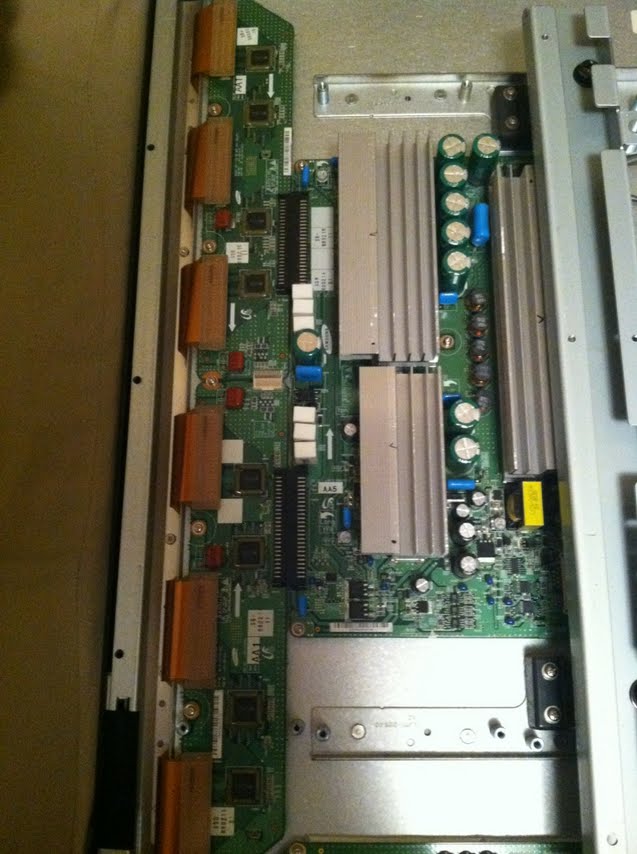

    Noob to the site, this is my first post. I have read a few threads but haven't found anything for my exact problem. I have a 50" vizio plasma tv and here are my problems: No Sound, No Picture, When plugged in it has an orange standby light lit on the front and if I push the power button the light will turn to green and click but thats it. I took the back of the tv off and noticed I had a blown cap on the Z sus board. I have replaced that blown cap with a new one, and tv still wont work. I'm open to any suggestions on the next step. Thanks!

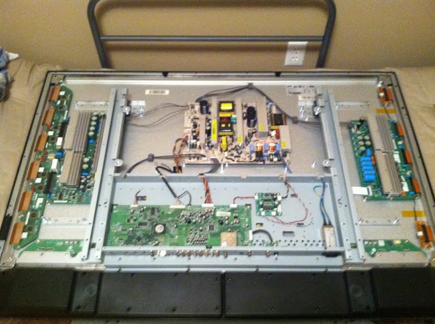

          Start by taking a few pictures of the boards in your TV; if possible, use the Manage Attachments feature of this forum to upload them instead of an external site.

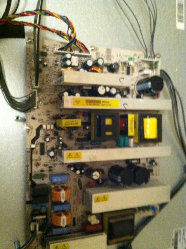

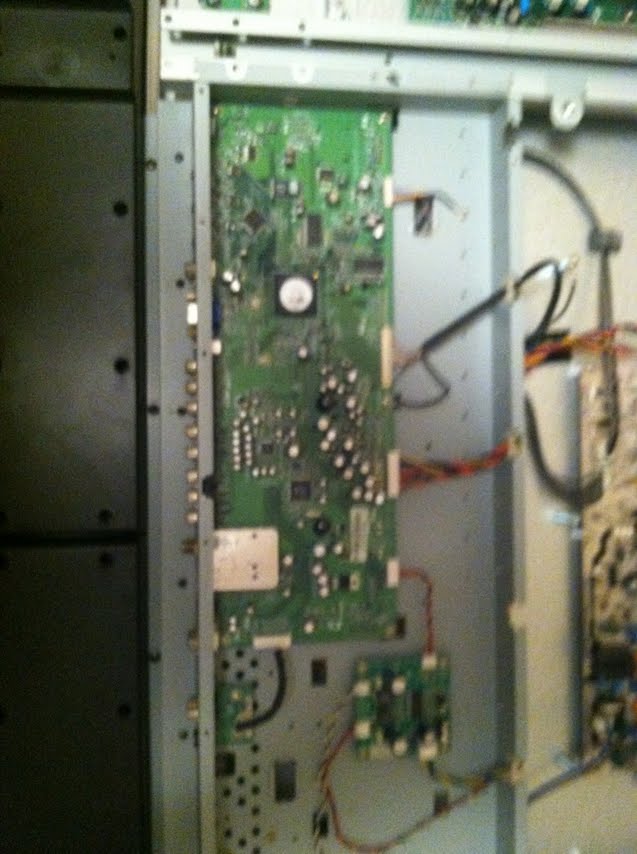

              Here are a few pics of the boards. On the X board the arrow shows what cap i replaced as it was blown. I must confess this was my first ever cap replacement, so is it possible to fry the board if i soldered it wrong. The square is around the only heat shield that was warm once the tv was plugged in for 10 minutes than turned off.

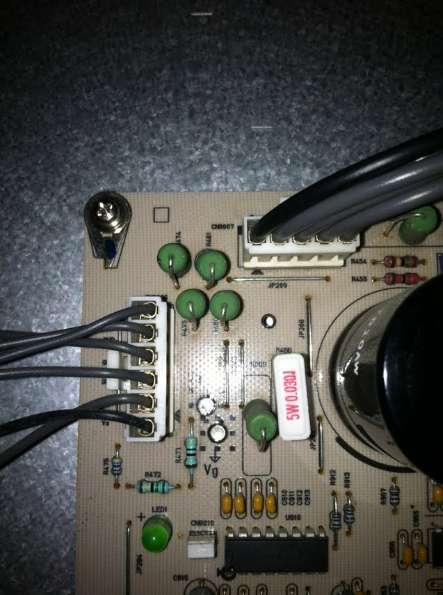

                Can you post some closer pictures of the power connector on one sustain board? The photos are a bit fuzzy and difficult to troubleshoot with so if possible can you borrow a better camera.

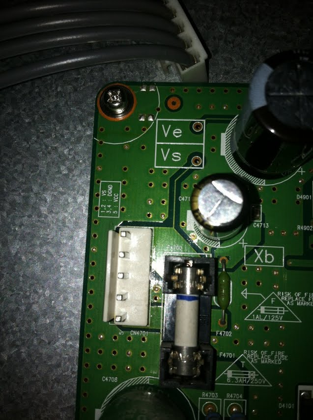

                      Here is a pic of the connection on the power board and the connection on the X sus from the power board. What kind of labels are you talking about that you would like to know, the part number or is it something else?

                          Okay top two pins on X sus are your Vs voltage.
                          1. Unplug TV and wait 30 seconds.
                          2. Plug X sus power in.
                          3. With multimeter, stick black probe in metal frame (spare screw hole etc)
                          4. Place red probe in the X sus connector (press it so it touches the metal with the wire in there.)
                          5. Set meter to 600V or 1000V DC, or if it has it, autoranging volts DC.
                          6. Plug in TV and power on TV as you normally would.
                          7. Note down the voltage. Does it peak and fall, or does it never rise, or does it stay high? For Vs you are looking for somewhere between 170V and 210V.
