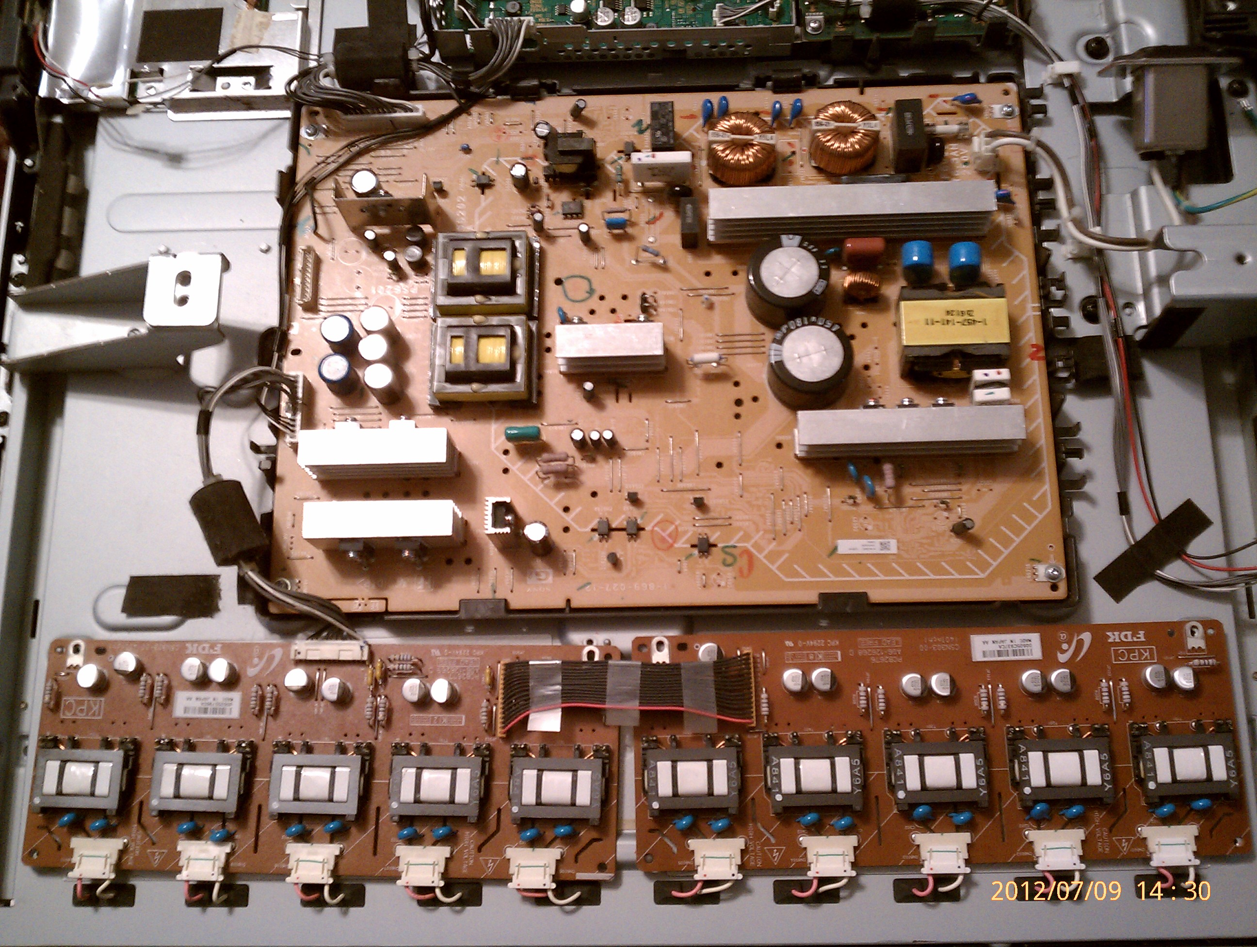

Re: Sony KDL-40S2000 Chassis 40WAX2

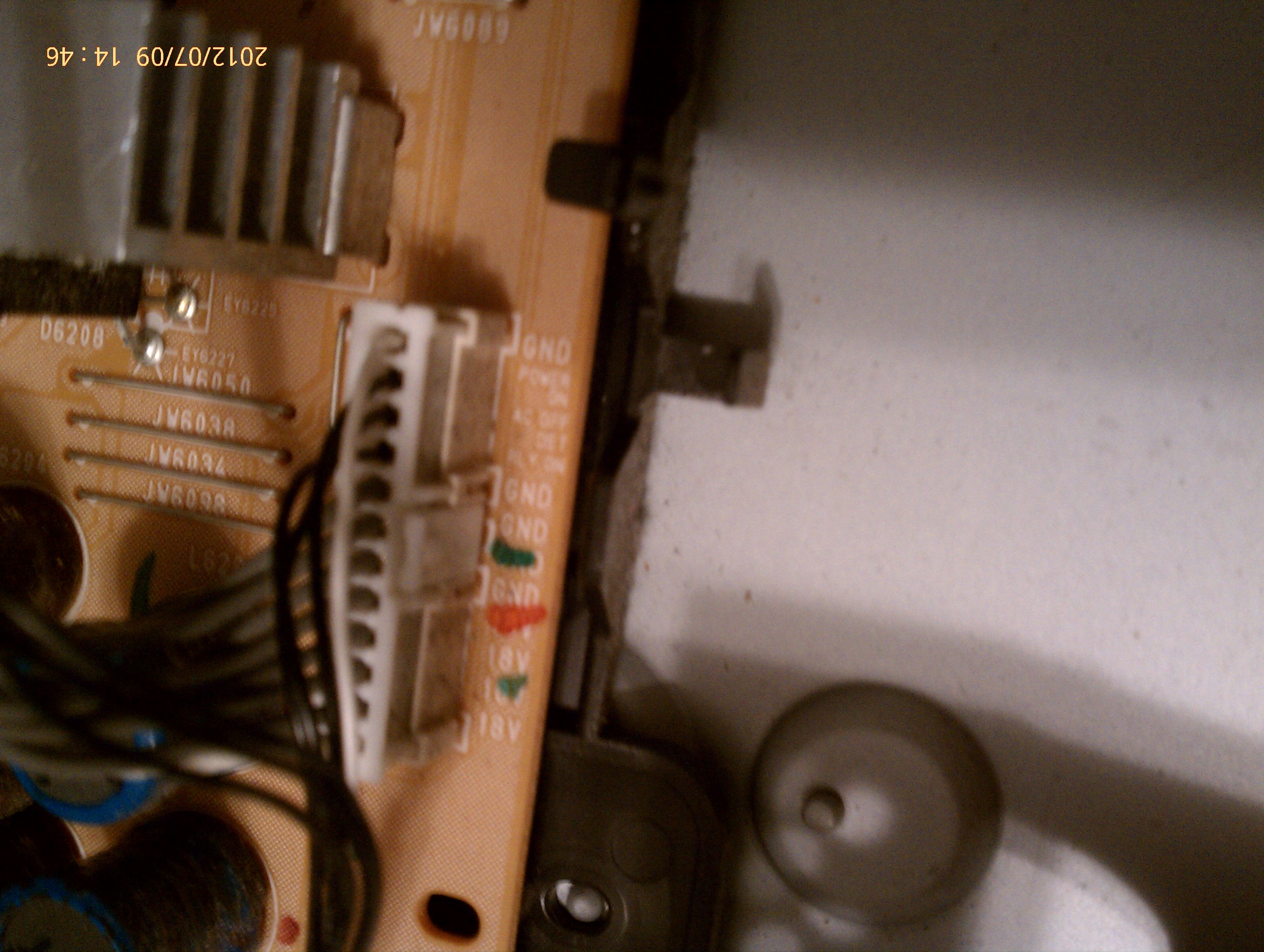

OK so in this model you can see the 8 thicker wires from PS, 4 are 18v+ and and 4 are ground, the smaller 3 black wires go to the main board. Pin 12 has 3.2v on it when powered on until clicks off.Attached Filesif you find these attachements useful please consider making a small donation to the site

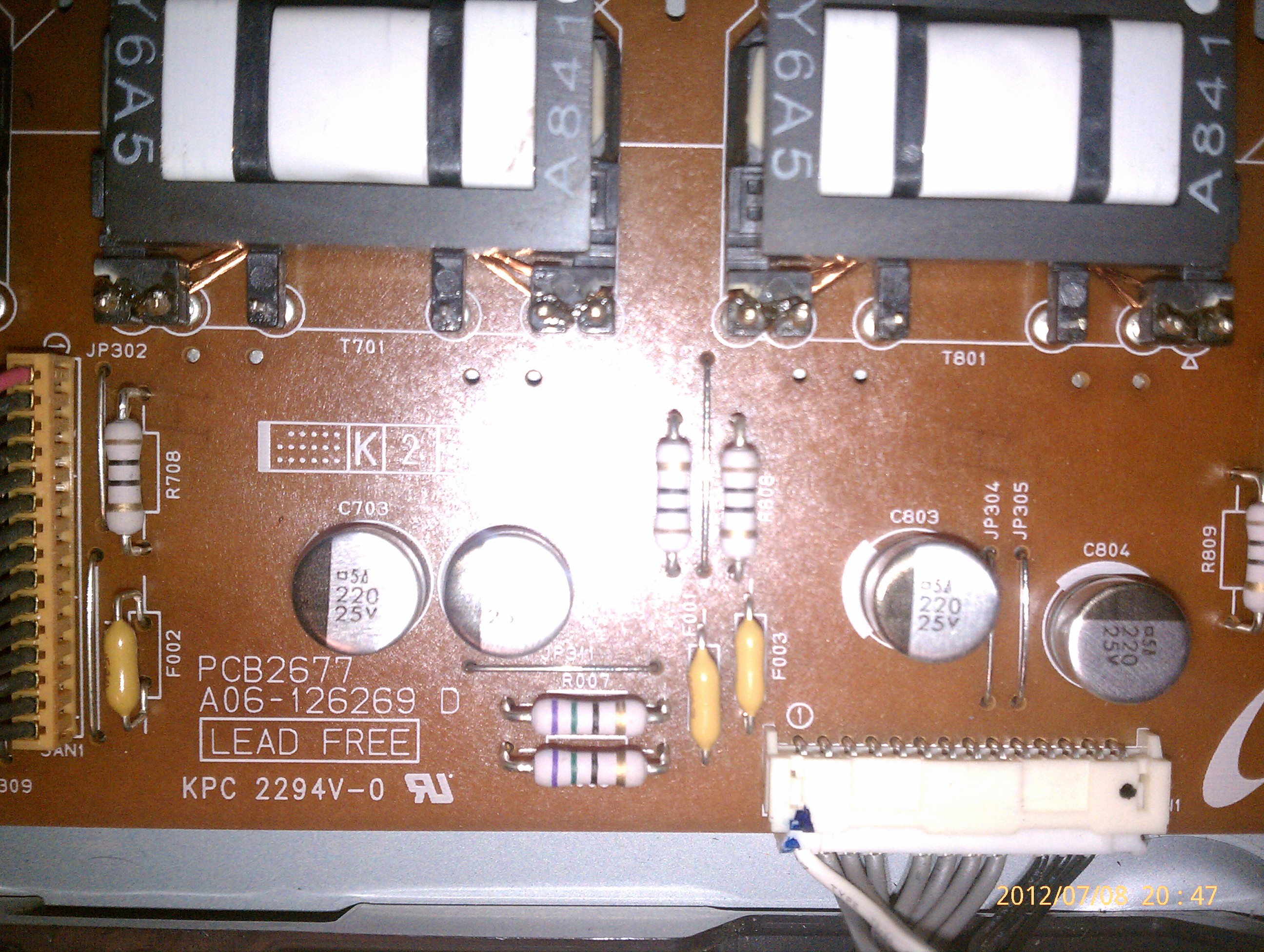

Can we see the pictures of all the boards so we see how they are connected together? I can see at least 3 fuses on that picture, F001, 002, 003, are they OK?Never stop learning

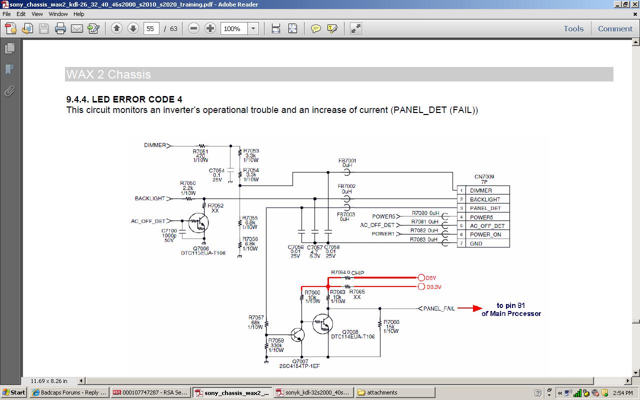

So it does use the Inverter failed detection.Never stop learning

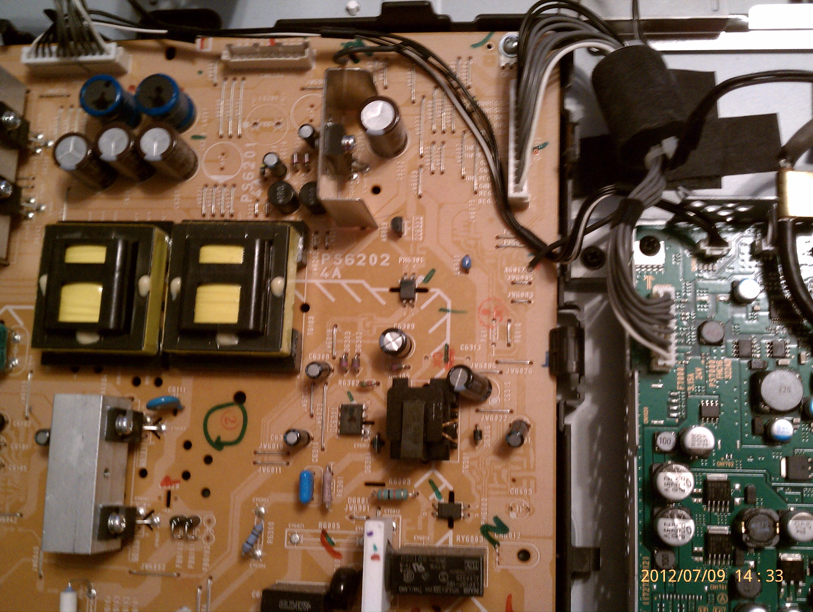

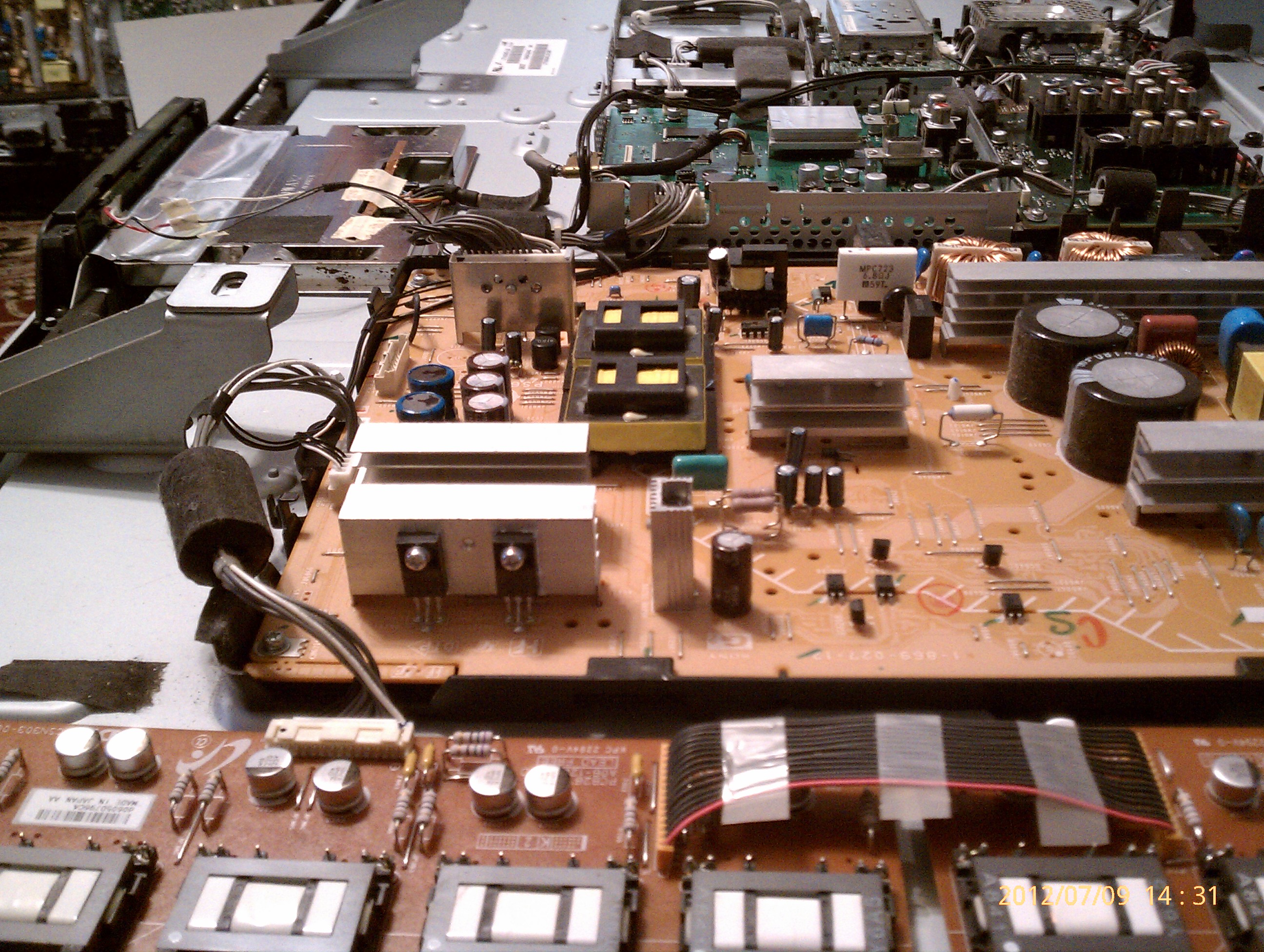

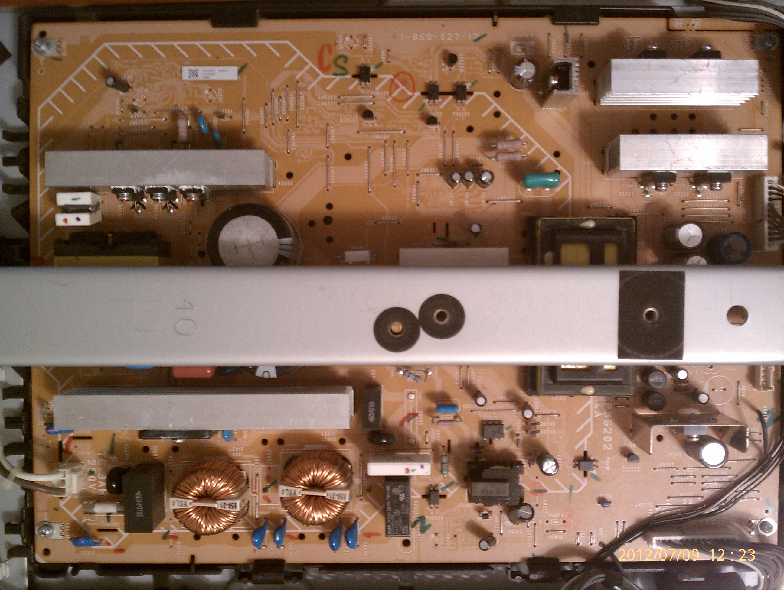

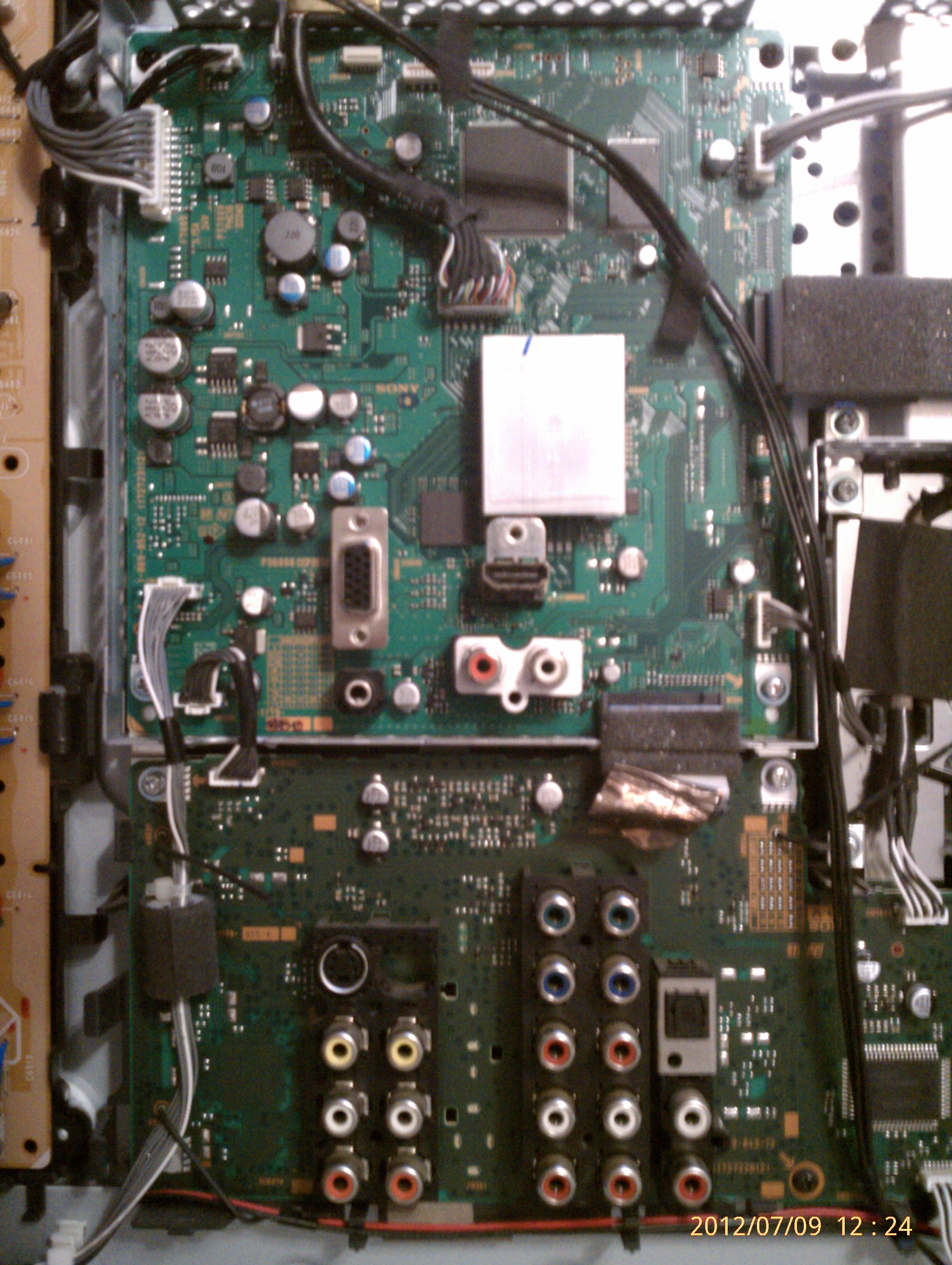

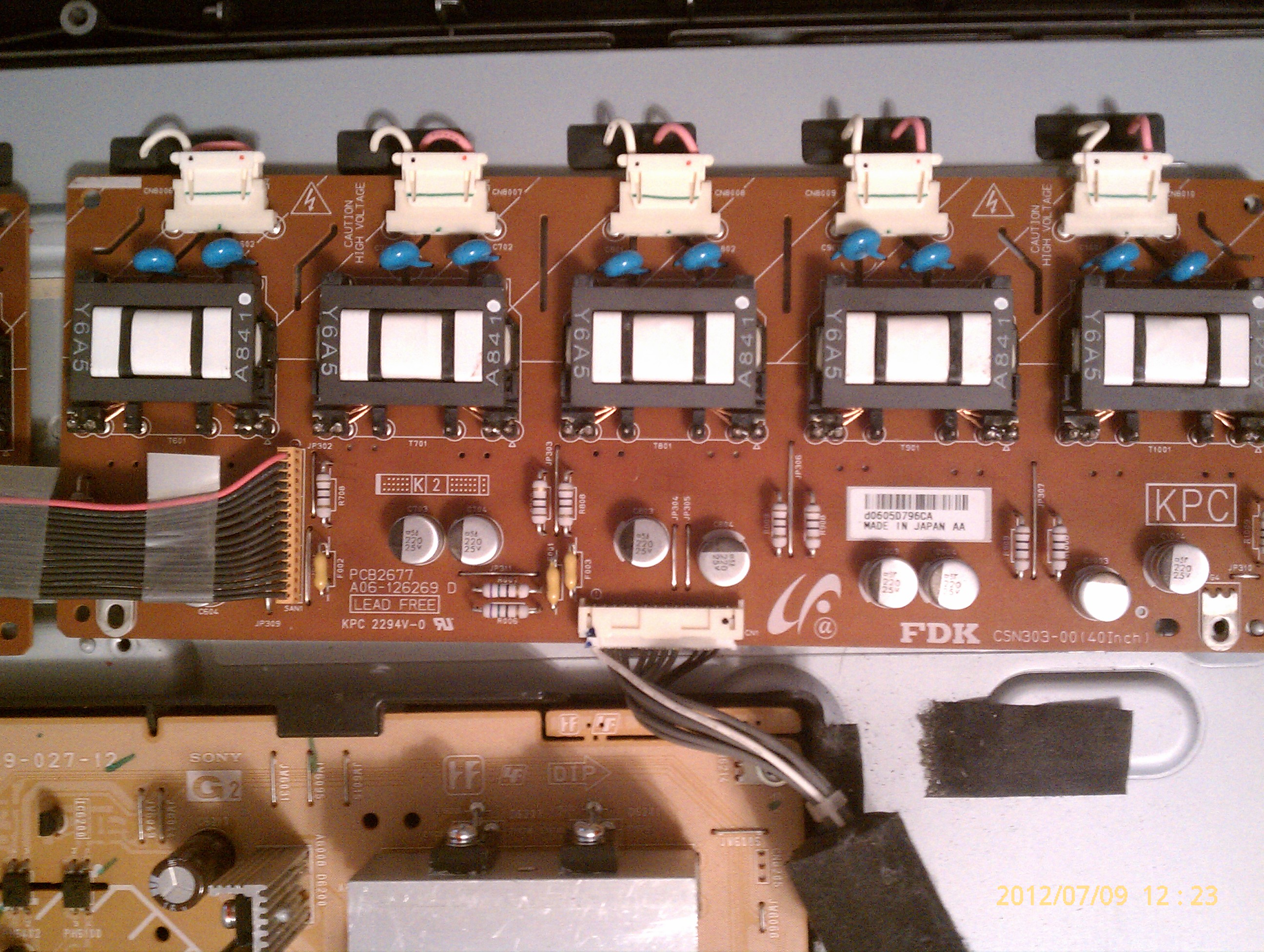

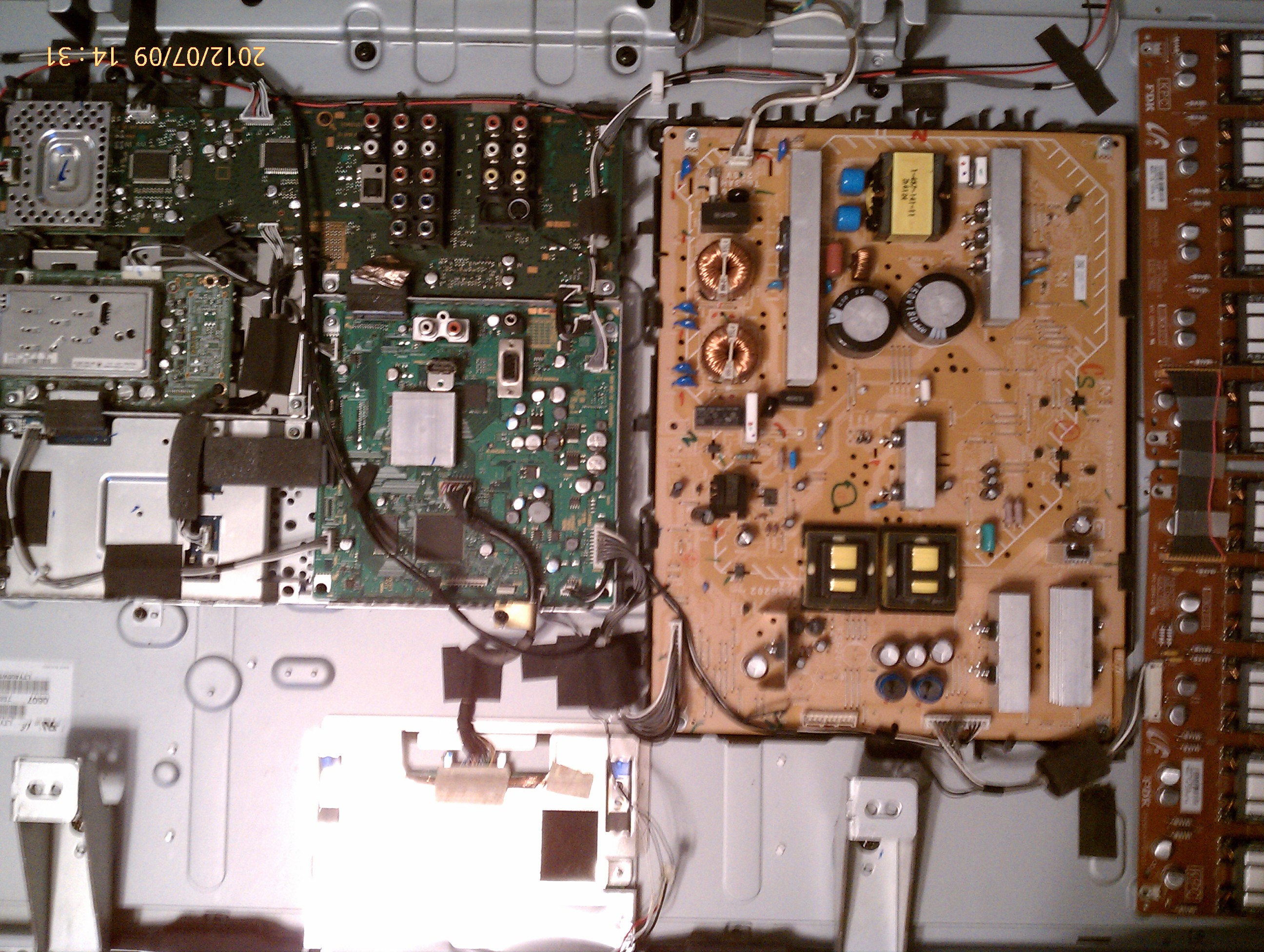

Fuses are good, here are some pics, sorry for the quality I only have my phone to take pics, let me know if you want some close ups of certain areas.Attached Filesif you find these attachements useful please consider making a small donation to the site
It looks like you have two inverter boards linking together, I do not see CN7009 in you pictures, what are the connectors with Red/black wires and another connector with white/gray wires?
That is a reason why we ask to show the whole set up so we can see how many boards it has and how they are link together.
Please remeber one thing, since we do not have the TV or the boards in front of us to take good details inspection, good pictures are very important when trying to troubleshoot complicated electonics equipment from afar.Last edited by budm; 07-09-2012, 12:20 PM.Never stop learning

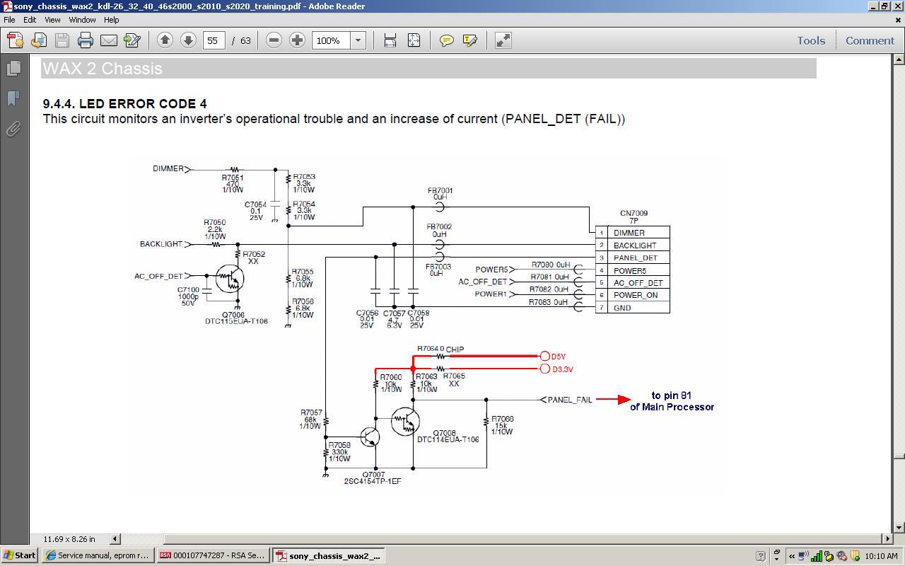

Really trying Bud, appreciate your patience.
CN7009 is on the main board, and the connector referenced in the inverter power failure circuit posted earlier. There are 7 wires, 4 go to PS board (Gnd, Power_On, Ac_Off_Det, Power5) as shown in the last pic, and 3 go to inverter board (Dimmer, Backlight, Panel_Det)
Do you know based on the schematic what Panel_Det should be?Attached Filesif you find these attachements useful please consider making a small donation to the site
OK, to fool the main board to make it thinks the inverter is OK, we need to find out the DC voltage at the Collector of Q7008 and the chassis, it should be close to 0V right now if the inverter circuit is bad, please verify that then I can tell you what to do next.
Yes I did that's where I got the power failure info. Let me try to find Q7008 now not much labeled on the board
Or R7066? which is in parallel with Q7008 E-CNever stop learning
