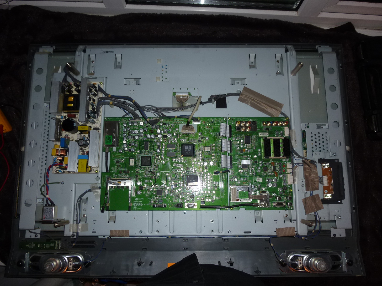

        Re: LG 32LC2D-EC - NO SOUND (and other issues)
        Hmm, I was hoping for better news!
        Which main board is it? - I'm assuming the sound board is where the P202 connector and wires run to on the right?
        TV picture seems to be fine so it would be a bit of a disappointment if I can't fix it!
          If I'm right about this TV it has a board with scart and audio on it and one with HDMI on it? I have a spare board for it, but I'm away from home right now.

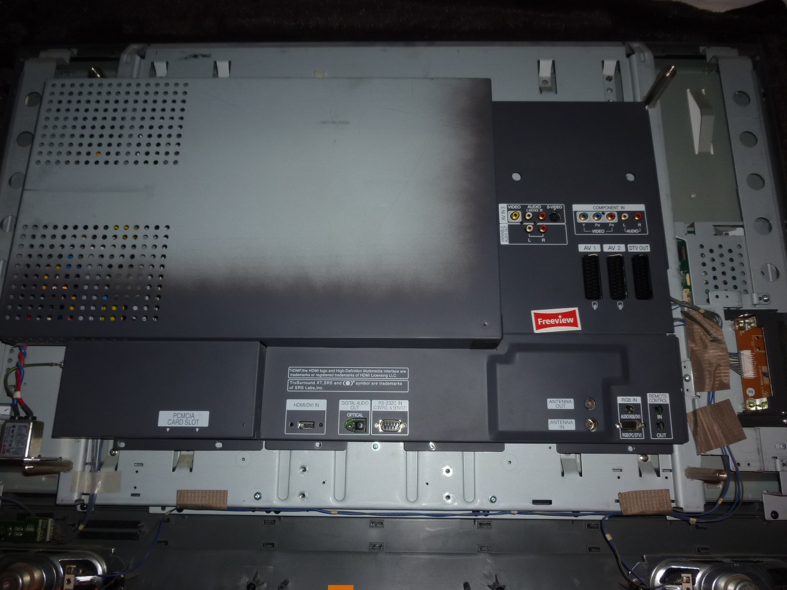

            Hi
            Yes sounds about right, I've snapped a pic of it for you with the boards and the back panel on. It also has PC - serial and optical on it along with PCMCIA.
            Which board do you have and how much do you want for it?
            Shame when TVs like this go wrong, it seems pretty nice but people don't seem interested in repairing them anymore. I got given this by someone who didn't want it due to the sound distortion - he has a TV repair shop just round the corner!
