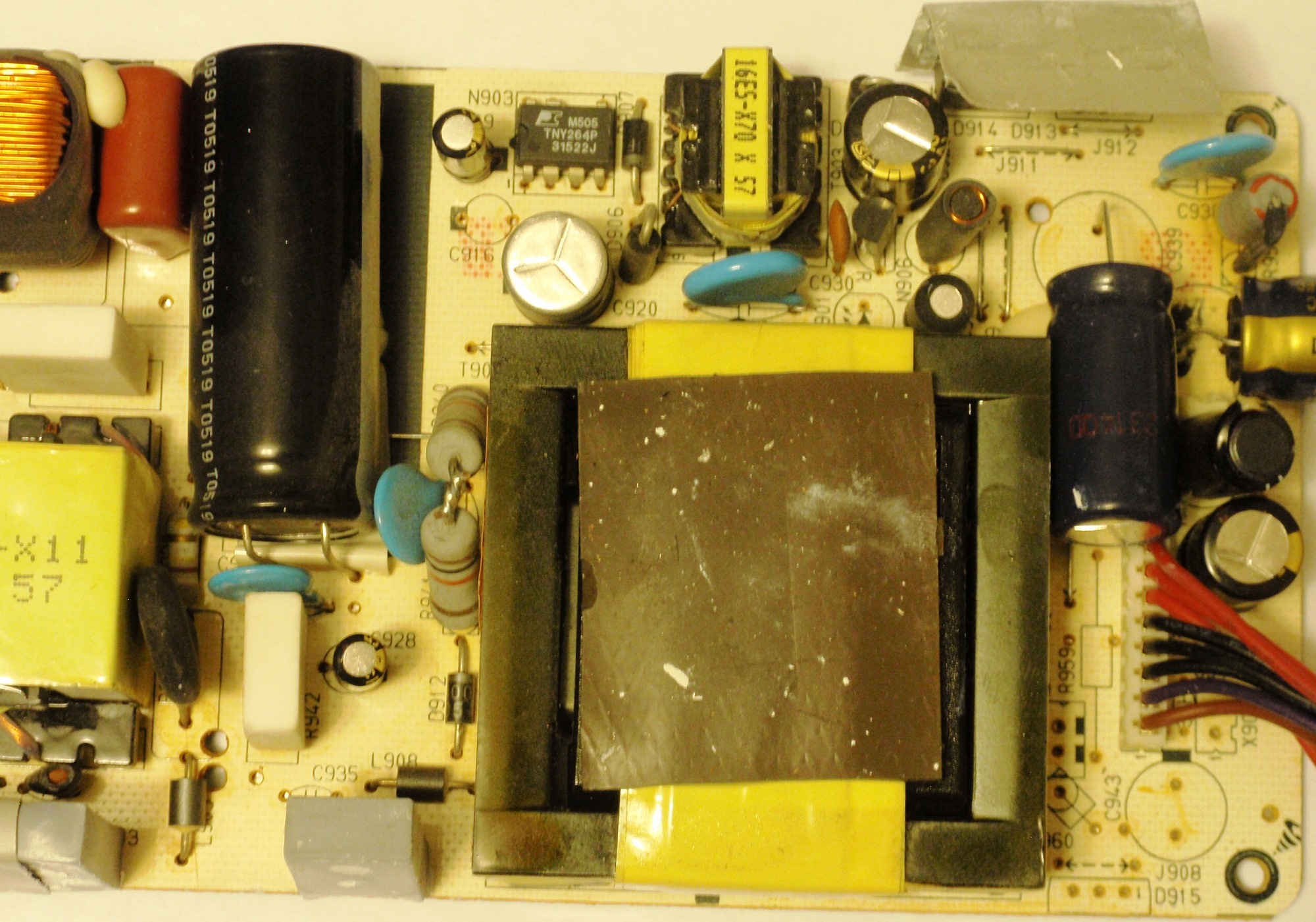

    Polaroid FLM-2601 no power
    Here is another one with different issue.

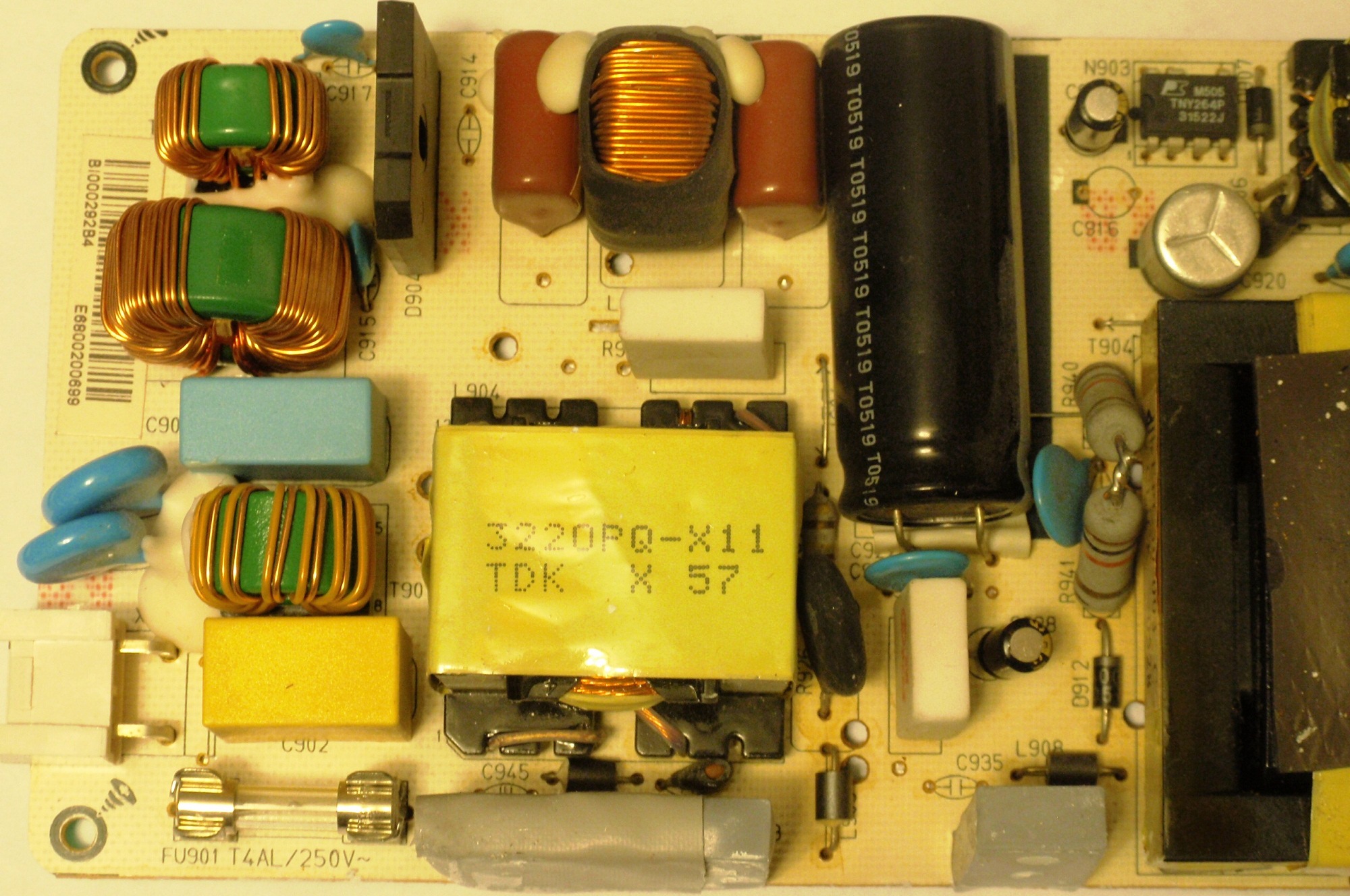

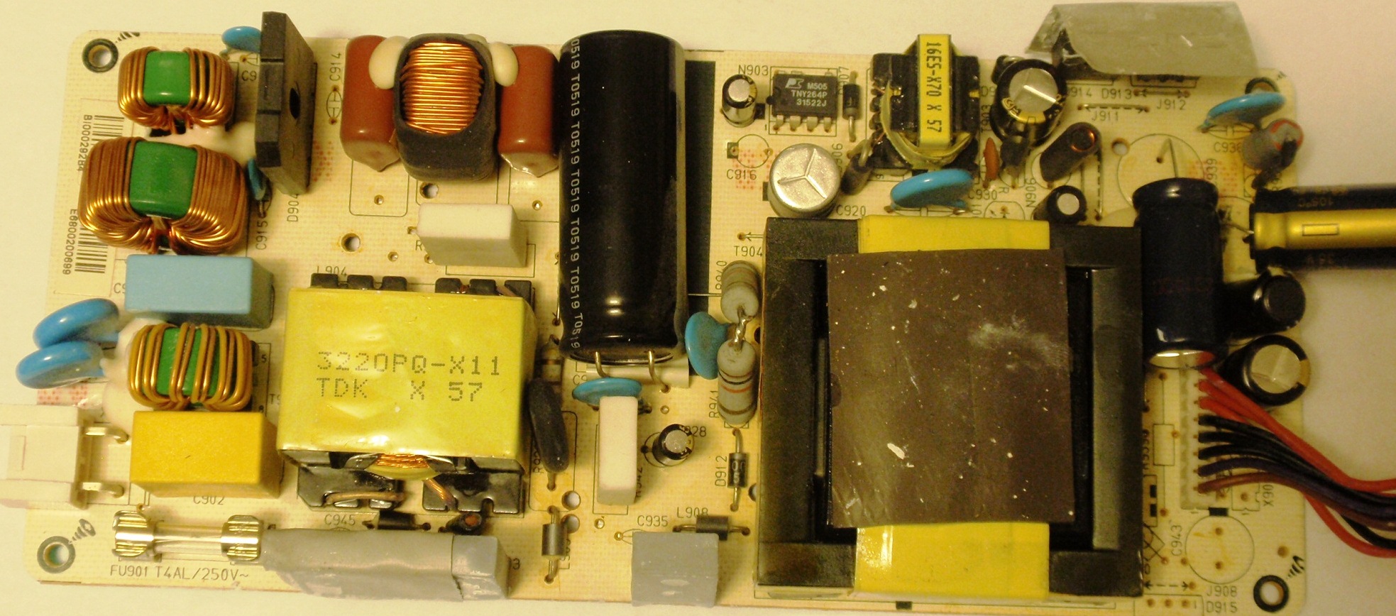

    It seems dead, no standby voltage, PFC it's way to low at 3.46V.
    Replaced all the capacitors(except the one which has heatshrink on it), two of the 1000uF were bulging.
    There are no voltages at the output connector.
    I know that the two 1000uF look weird, but I couldn't find 22MM high capacitors at Digikey.
    The soldering it seems that it was done by a beginner. The worst that I have seen yet.
    Any help would be appreciated.
    I will start following/studying the PS diagram in the other post also.

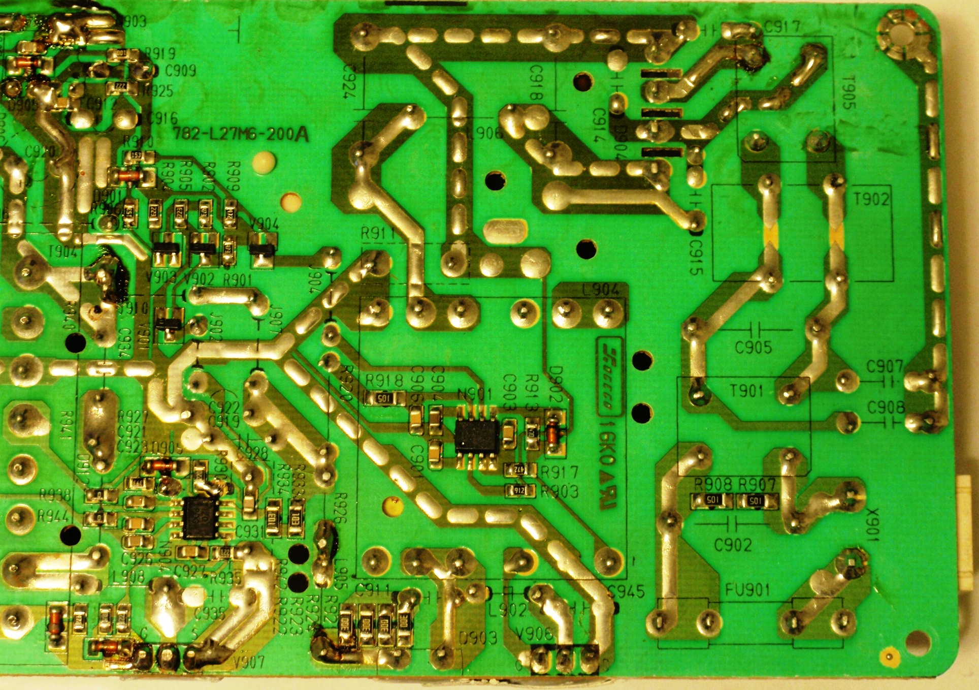

                        Repairing live.

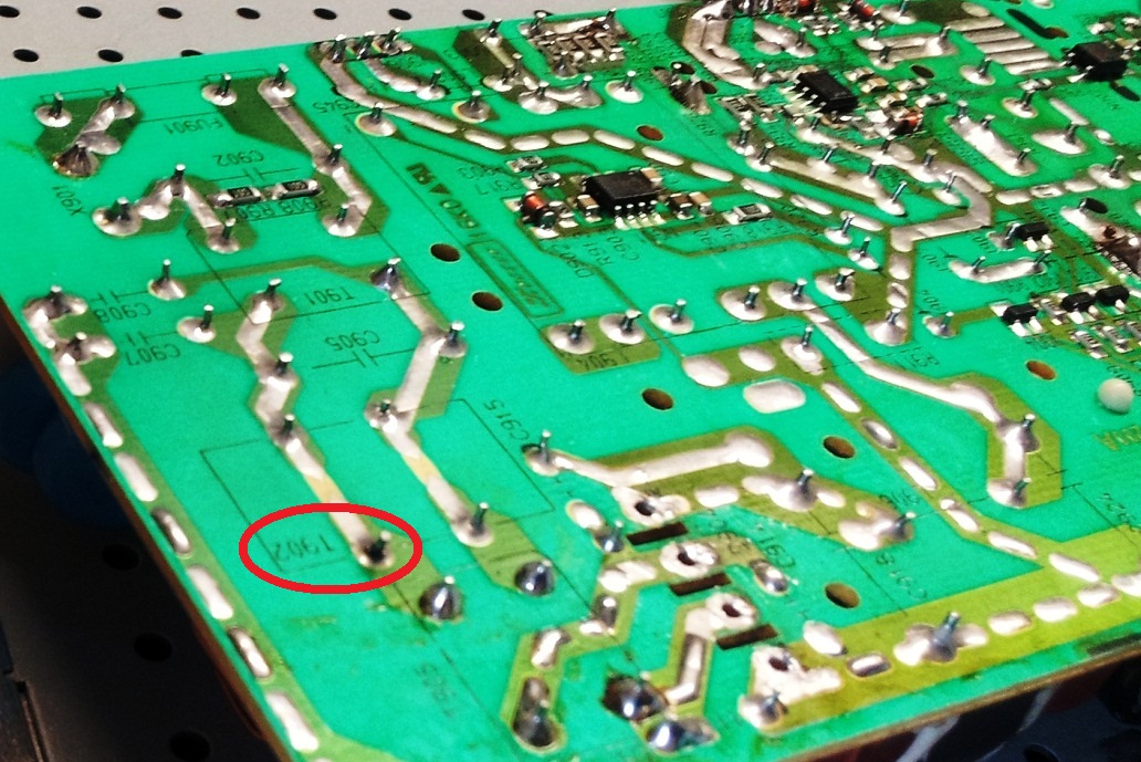

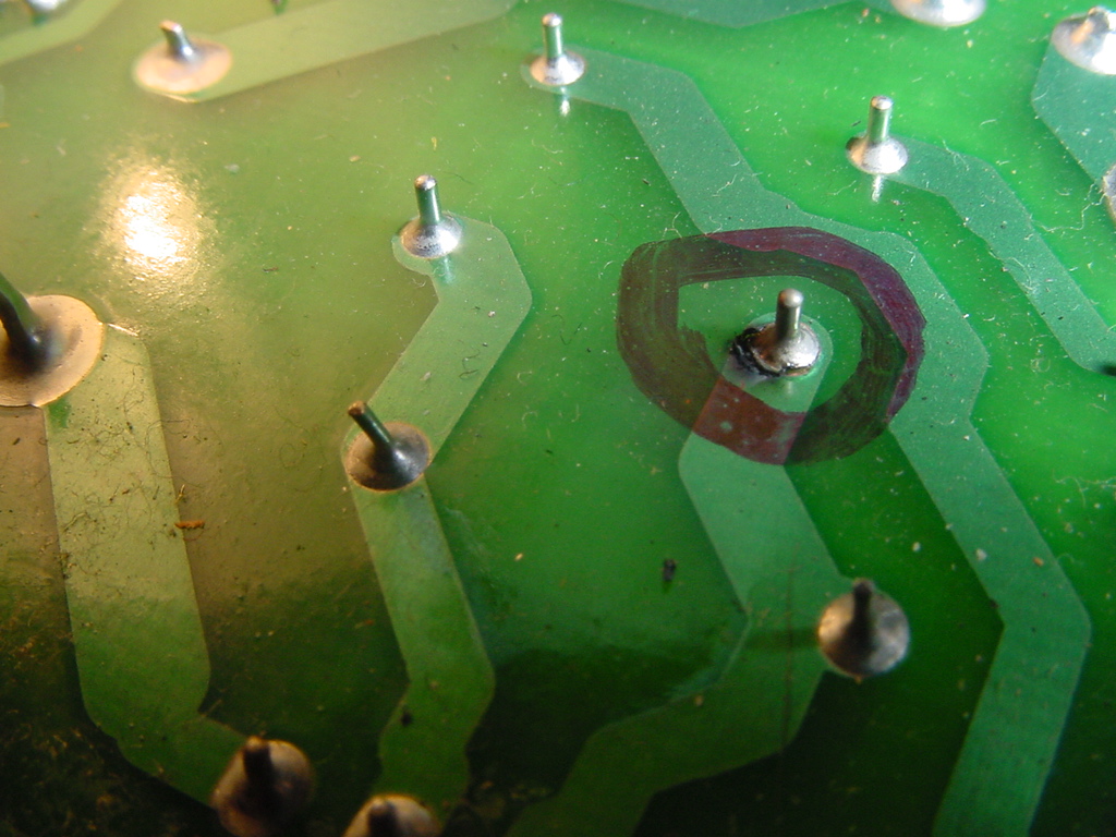

                        I have just found the problem! It was T902, one of the pins wasn't soldered.
                        It was pretty black that pin.
                        So capacitors replaced(2x1000uf bulging, replaced almost all) and resoldered T902's pin.

                          Re: Polaroid FLM-2601 no power
                          Here is the picture with the bad solder joint:
                                Interesting that the solder joint on the EMI filter inductor.
                                Muh-soggy-knee
                                  That is not uncommon failure at all. Poor soldering works.
                                  When you see big components, Power semiconductor, power resistor mounted on the PCB, you will always inspect and resolder the leads. You will see small ring (crack, but not completely broken) around the joints.
