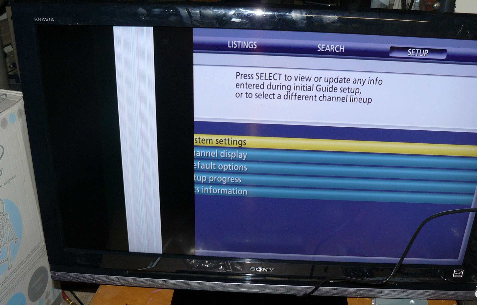

    Looks like a bad panel. Here is a picture of a sony bravia kdl that had a bad panel. Does twisting or flexing the panel make any difference. You might find better search results if you pull the back off the tv and get the panel make/model off the sticker.

      Hmm. That Sony sure looks exactly the same. I tried twisting/flexing, but it's pretty tough to do without taking the back off the TV. In any case, no amount of tapping, pushing, squeezing, twisting or flexing (again, TV in one piece) has affected the issue one bit. Tomorrow's the weekend, I should have plenty of time to take the back off and mess around a little more.

        It does look like bad tab bonding problem.

            unfortunately the only "repair" that could be done is applying pressure on the tab bonds to see if the image comes back. But as you stated last night that twisting or flexing makes no difference then you might be "peeing in the wind"
            The sony picture i posted couldn't be fixed by applying pressure to the tab bonds so i had to strip the tv and part it out.

              More likely with random lines or no image at all, it is a complete failure of the driver IC on the tab bond.
