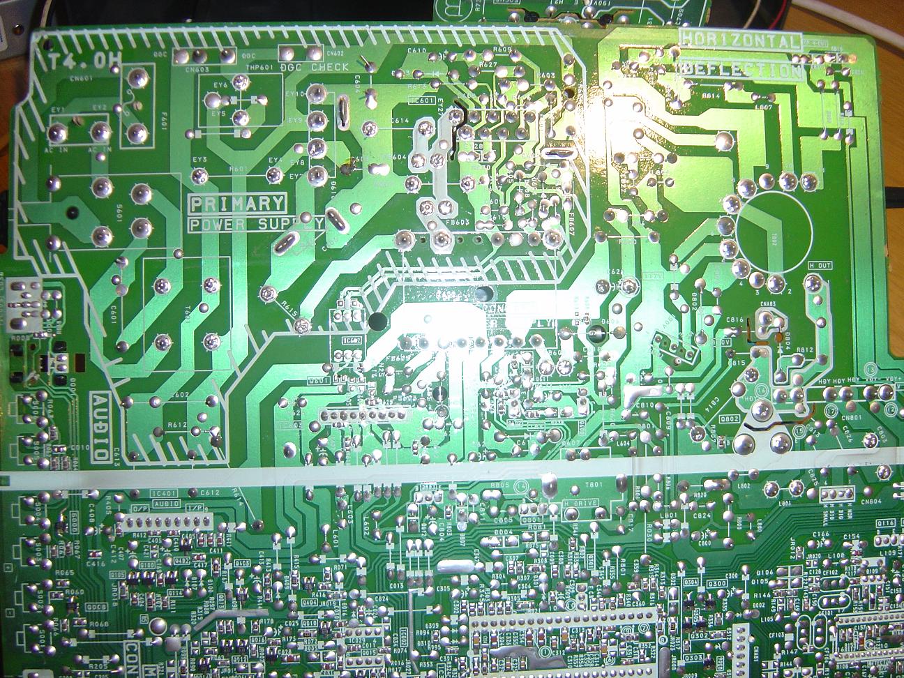

    When I switch it on, I can hear what I presume is the degausser. Fuses in the plug and on the board are both ok. I noticed that quite a few of the solder joints on the solder-side were looking a bit skimpy on the solder, so I reflowed and added another bit to get a nice mound on them (picture is from before I did this).
    Nothing visibly burnt or fried (there is solder point near where "Primary Power Supply" is written that looked burnt, but I believe it's just excess flux).

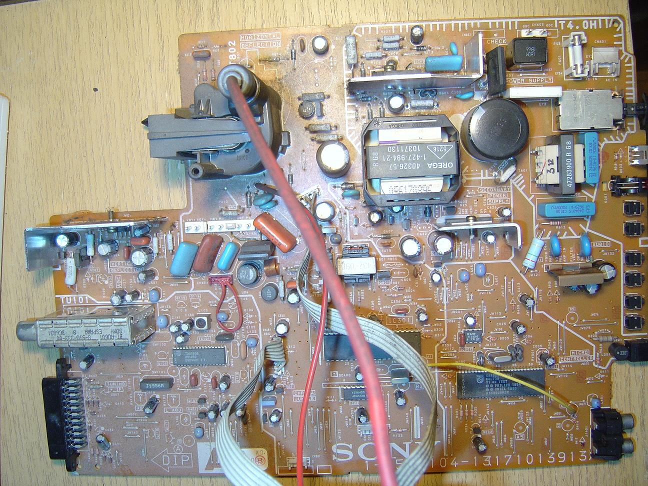

    Chassis seems to be a BE4. I've attached a photos of both sides of the chassis. Has anyone worked on this chassis before, and where is the best place to start and approach this safely?
    EDIT: Found this page http://www.eserviceinfo.com/repair_t...earch_rt=KV14T which says that the chassis is a BE4, and after looking at the schematic document closer, I can see BE4 mentioned on the top of a few of the pages.

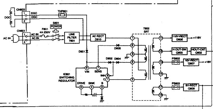

      So I suppose I should start with the power input area, but unsure as to how to properly (and safely) measure the voltages in this area, so have a few questions, and have attached that portion of the schematics.
      1. When measuring voltages, are the voltages in the area after "T602 SRT" AC volatges? (Or are these now DC since they come after the "AC RECT" D610?)
      2. Where do I measure between? For instance, on the point (11) on the T602 SRT where it says it should be +118V-RECT, I put one lead on point 11, but where do I put the other lead?
      3. Similarly, if I'm measuring voltages between the "T602 SRT" and the AC in, where should I put the black lead?
        Re: Sony - KV14T1U - CRT
        OK, this is switching power supply, it does not run at 50 0r 60Hz, the transformer is being fed by AC voltage generated by the U801, the frequency is about 70~100KHz, your meter will not be able to read AC at that frequency, you will need scope.
        The most important thing is that, any thing in the left side of the transformer are part of the AC primary circuit, so do not TOUCH anything with your body, the ground of the primary is not tied to ground of the secondary side of the transformer.
        The diagram is basic block diagram drawing, you should look at the detail schematic instead, but you can still check the DC out put of the rectifier diode that is connected to pin 11 of the transformer, since you are checking the secondary side of the circuit, you can put you black probe of your meter to any metal part of the chassis which is tied to the secondary ground.

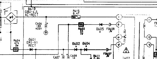

          On that +118V line, I took off the bridge rectifier (D610), and it's ok. The next component R615, I tried measuring it's resistance, but it's reading open. But I notice that it's symbol isn't a usual resistor like on other places, the symbol looks half like a resistor, and half like an AC symbol. Can someone enlighten me on this? I've attached part of that area including the resistor.

            That is the 0.47 Ohm fusible flame-proof resistor for the B+, if that is open, then the IC may be shorted or the secondary side of the transformer is drawing too much current.
            Just Google "fusible resistor"
