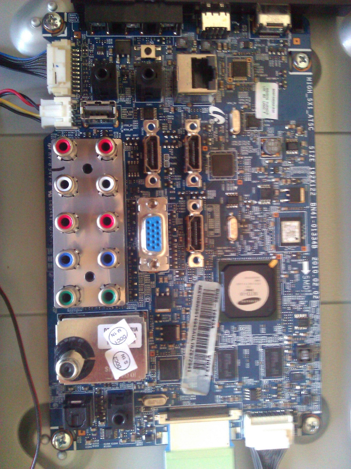

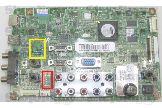

              Ok I might be able to get my hands on the main board CHEAP and semi-Local..The problem is, its out of a LN52C530F1F.. The board numbers match to my board #. But my board has an internet cat port and a USB port and the one I can get cheap does not.. Could I possibly remove those ports from my board and solder them to the new board . The first picture should be the same one that might be able to get local, the second picture is of my board... So do you all think this would work ??

                Re: Samsung LN40C550J1F No power
                Im sure that this could be possible, as long as the option bites are changed when installed. You will need a LG Service Remote to do this properly. I have done this before only to my knowledge that the possibility of the boards numbers matching.
                  There are two P/N on the board, one is the P/N of the blank PCB (not stuffed board), and then there is the P/N on the bar code sticker that indicated what the stuffed board with components. They do this so they can use the same blank board and stuff the board with different components for particular model/chassis/LCD panel of the TV. 52" Board may or may not work since the T-CON may use 5Vdc for power on your 40" screen, the 52" may use 12V for the T-CON. So make sure to read the DC voltage for the T-CON before you connect the boards together. The same TV model can have different brand of LCD panel installed.
                    I went ahead and ordered the correct mainboard.. Crossing fingers thats whats wrong
                    • lilmonk3
                      • Apr 2012
                      • 259
                      Jimmy.. Thank you for your guidance .. It was indeed the Main Board and all is up and running now.. Pretty nice TV for $140 total
