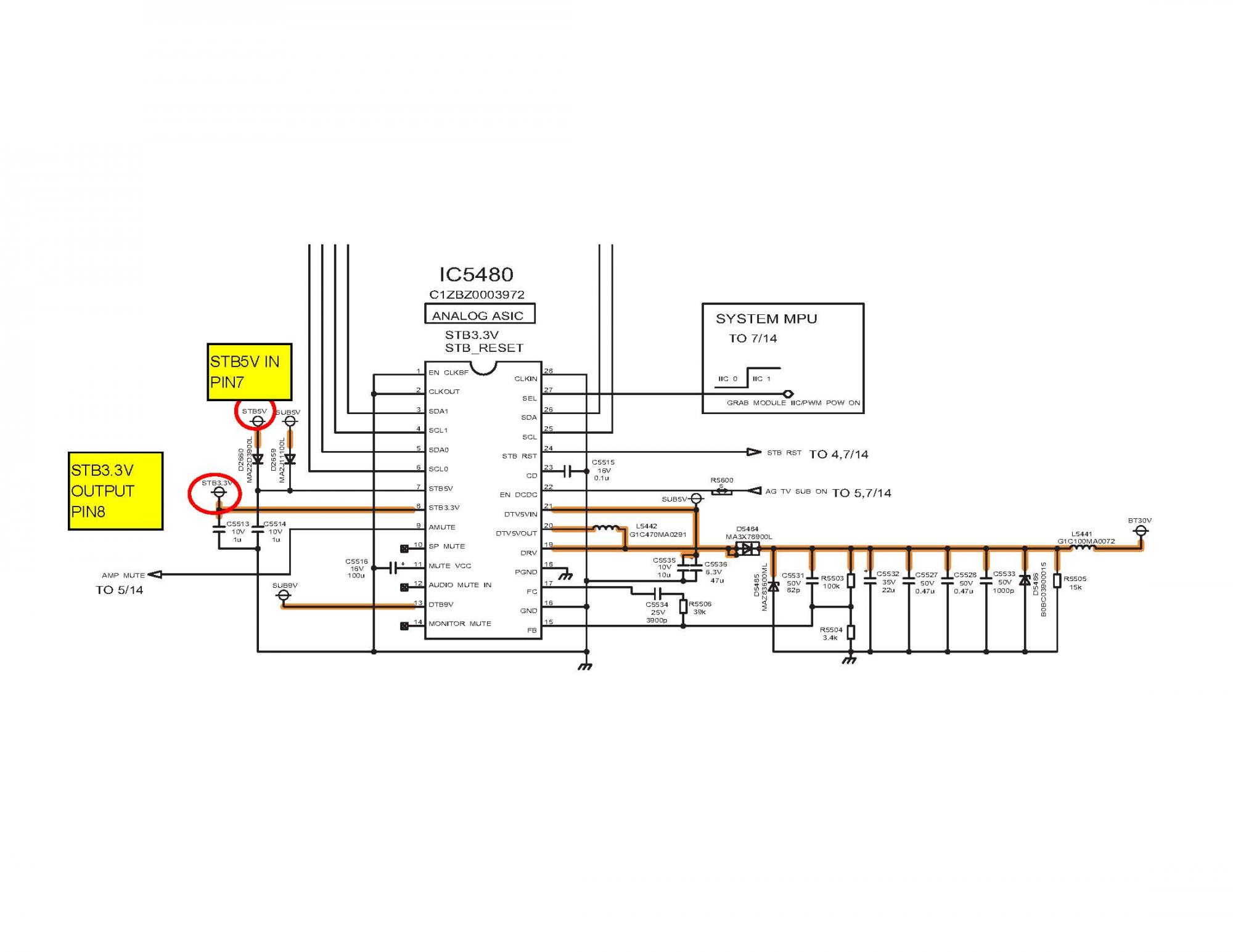

                        May be that is why you are not getting the signal output from MCU pin 28 to turn on the F15V.
                        Need to look through the diagrams to see who generates the STB3.3V.
                          #52
                          Re: Panasonic TC-42PX14 Zener Diode
                          OK, I found out where STB3.3V is coming from, (IC5480 PIN8), see PDF.
                          STB5V (Standby 5V) goes into pin7, an the output of 3.3V comes out on pin8 of IC5480.
                            #53
