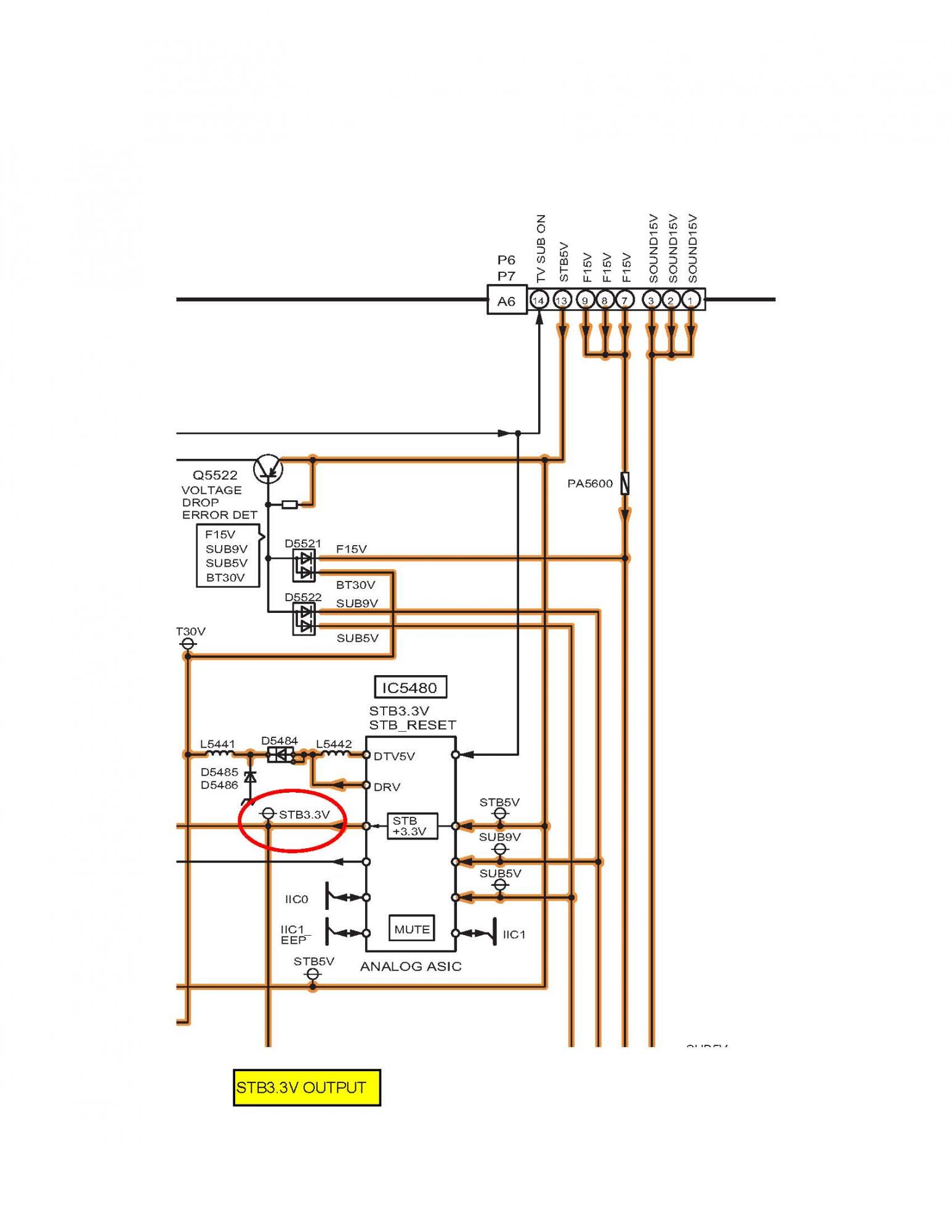

Panasonic TC-42PX14 Zener Diode
  • mr.sky
    replied
    Re: Panasonic TC-42PX14 Zener Diode
    budm, sorry for not getting back to you. Took a vacation down
    in southern Mexico, Morelia Michoacan. I got back a few days
    ago, and got frustrated with this tv, I just went and bought
    another A-board and tv worked fine. Sold tv on Craigslist.
    Not sure if I want to buy another fixer upper, especially
    Panasonic Plasma. You are one special guy, always here to
    help the community on this Forum.
    Leave a comment:
    replied
    Re: Panasonic TC-42PX14 Zener Diode
    OK, I found out where STB3.3V is coming from, (IC5480 PIN8), see PDF.
    STB5V (Standby 5V) goes into pin7, an the output of 3.3V comes out on pin8 of IC5480.
    Leave a comment:
    replied
    Re: Panasonic TC-42PX14 Zener Diode
    May be that is why you are not getting the signal output from MCU pin 28 to turn on the F15V.
    Need to look through the diagrams to see who generates the STB3.3V.
    Leave a comment:
  • mr.sky
    replied
    Re: Panasonic TC-42PX14 Zener Diode
    Originally posted by budm
    That out put on the Collector is for sending the SIGNAL (SOS) indicating that one or more of the 4 power supplies have gone out, it is not used for powering the circuits, there should be no output from this transistor if all 4 power supplies are working. So the error light is correct since the transistor is turn on due to failed power supply.
    If F15V is not present, then there will no sub1.8, sub1.3, sub5v, sub3.3v.So F15V is the key voltage source. as shown on page 46.
    On page 49, are you getting STB3.3V feeding the MCU IC1100?
    No, STB3.3v to MCU 1100. More trouble shooting ahead.
    Leave a comment:
  • mr.sky
    replied
    Re: Panasonic TC-42PX14 Zener Diode
    Originally posted by budm
    Main key right now is that the MCU IC1100 pin 28 is not sending the signal to turn on F15V, that is the bottom line, there is no output from MCU.
    Going to get some rest, been reading and listening to your advise.
    Will hack at again tomorrow. Thanks budm!
    Leave a comment:
    replied
    Re: Panasonic TC-42PX14 Zener Diode
    Main key right now is that the MCU IC1100 pin 28 is not sending the signal to turn on F15V, that is the bottom line, there is no output from MCU.
    Leave a comment:
  • mr.sky
    replied
    Re: Panasonic TC-42PX14 Zener Diode
    Originally posted by budm
    That out put on the Collector is for sending the SIGNAL (SOS) indicating that one or more of the 4 power supplies have gone out, it is not used for powering the circuits, there should be no output from this transistor if all 4 power supplies are working. So the error light is correct since the transistor is turn on due to failed power supply.
    If F15V is not present, then there will no sub1.8, sub1.3, sub5v, sub3.3v.So F15V is the key voltage source. as shown on page 46.
    On page 49, are you getting STB3.3V feeding the MCU IC1100?
    I will check it out.
    Leave a comment:
    replied
    Re: Panasonic TC-42PX14 Zener Diode
    Line 4 BUSS signal line:
    TVSUBON on line 4 is the output from MCU IC110 PIN28 to feed the power supply to turn on IC603, its output is then feed IC502 pin 1 as I have already traced out in the PDF.
    Last edited by budm; 06-26-2012, 09:51 PM.
    Leave a comment:
    replied
    Re: Panasonic TC-42PX14 Zener Diode
    That out put on the Collector is for sending the SIGNAL (SOS) indicating that one or more of the 4 power supplies have gone out, it is not used for powering the circuits, there should be no output from this transistor if all 4 power supplies are working. So the error light is correct since the transistor is turn on due to failed power supply.
    If F15V is not present, then there will no sub1.8, sub1.3, sub5v, sub3.3v.So F15V is the key voltage source. as shown on page 46.
    On page 49, are you getting STB3.3V feeding the MCU IC1100?
    Last edited by budm; 06-26-2012, 09:42 PM.
    Leave a comment:
  • mr.sky
    replied
    Re: Panasonic TC-42PX14 Zener Diode
    I just noticed if you follow line 4 from page 30 it goes to page 31
    which leads to MPU
    Leave a comment:
  • mr.sky
    replied
    Re: Panasonic TC-42PX14 Zener Diode
    Originally posted by budm
    More explanations: Page 46, Q5522 monitors 4 Voltages to make sure they are present, SUB5V, BT30V, SUB9V, and FV15V through 4 OR GATES (Dual) diodes D5521, D5522.
    That is why it is called VOLTAGE DROP ERROR DETECT since the MCU is not sending out the signal to turn on FV15 as I explained earlier.
    Something is locking out the the MCU.
    Yeah, I saw D5521 and 5522 on top of A board with the Q5522 in between.
    I really thought this was the problem as per panasonic Power Led Blinking
    Timing Chart, it gives 4 possible reasons that causes the 10 blinks on A board
    and Tuner Power SOS is one of them. As you can see, one end of the
    Transistor Q5522 goes to the Tuner on the A board. OK back to the
    drawing board. Thanks for your input.
    Leave a comment:
    replied
    Re: Panasonic TC-42PX14 Zener Diode
    More explanations: Page 46, Q5522 monitors 4 Voltages to make sure they are present, SUB5V, BT30V, SUB9V, and FV15V through 4 OR GATES (Dual) diodes D5521, D5522.
    That is why it is called VOLTAGE DROP ERROR DETECT since the MCU is not sending out the signal to turn on FV15 as I explained earlier.
    Something is locking out the the MCU.
    Last edited by budm; 06-26-2012, 08:45 PM.
    Leave a comment:
  • mr.sky
    replied
    Re: Panasonic TC-42PX14 Zener Diode
    Originally posted by budm
    What page this Q5522 is on?
    budm, it is on page 30, what do you think?
    Leave a comment:
    replied
    Re: Panasonic TC-42PX14 Zener Diode
    What page this Q5522 is on?
    OK, I found it, it is an PNP transistor.
    For that transistor to turn on, the bottom end of the resistor R5536 will have to go low to let 5VSTBY current to flow out of the Collector pin. When that transistor is turn on, it will send the signal indicating that there is power supply failure, it should be normally OFF.
    D5521 and D5522 are setup as an OR gate, if the Cathode side goes low due to missing power to make the Diode forward bias, then Q5522 will conduct which indicate one of the 4 power supplies had failed. Since you do not have F15, that means the top Diode of D5521 will be forward bias, so it turns on Q5522, so you will get error light.
    That is why we need to get the F15V to work.
    Last edited by budm; 06-26-2012, 07:12 PM.
    Leave a comment:
  • mr.sky
    replied
    Re: Panasonic TC-42PX14 Zener Diode
    Well, I am pretty sure my problem with the Blinking 10, at least in my
    unit is Q5522. It is a transistor, not sure if it is NPN. Schematics or
    part #B1ADCE000022 will identify what type of transistor it is. I did
    a google search and could not find info, other that it is out of stock.
    According to page #30 of Schematics it says TUNER SOS below the
    words it says LED:10 TIMES, I followed the black line and it goes to
    the Tuner of A board., it also goes to TV SUB ON via pin 14 Connector
    A6, that of course goes to Power Board.
    Leave a comment:
  • mr.sky
    replied
    Re: Panasonic TC-42PX14 Zener Diode
    Originally posted by budm
    "“TV_SUB_ON” Command (3.2V) and the PANEL_STB_ON” command (3.2V).
    The “TV_SUB_ON” command is provided to pin 6 of connector P7 of the power supply through pin 14 of
    connector A6 of the A board to develop the F_STB+15V. At this time the relays on the power supply are
    triggered and a “click” sound can be heard." and "This SOS Detect circuit is controlled by the TV_SUB_ON command from the Main
    CPU (IC1100)."
    So at this point the IC1100 is not putting out the TV_SUB_ON signal that I traced it back to IC1100 are due to? Who is controlling the TV_SUB_ON?
    budm, Yesterday I mentioned that my A-Board did not have IC9004
    well, I did find it on Page 31, it is next to IC 1100. I followed the sub 9v,5v and 3.3v from Page 30, the sub 3.3 and 5v, come from IC 5607 and the
    sub9 from IC 5401, from there they go to IC 1100
    IC 9004 is a 32 pin. I am hoping one of the components that go to IC 1100
    that are fed from IC 5607 or possible bad IC 5401.
    I also note after IC 9004, from there it goes to IC 9003 a pin there goes to
    Connector A25, that is Main Panel On. pin 11, which should have 3.2v. There
    is no reading there. Of course from there it goes to P board to turn on the F15v
    Last edited by mr.sky; 06-23-2012, 11:45 AM.
    Leave a comment:
    replied
    Re: Panasonic TC-42PX14 Zener Diode
    "“TV_SUB_ON” Command (3.2V) and the PANEL_STB_ON” command (3.2V).
    The “TV_SUB_ON” command is provided to pin 6 of connector P7 of the power supply through pin 14 of
    connector A6 of the A board to develop the F_STB+15V. At this time the relays on the power supply are
    triggered and a “click” sound can be heard." and "This SOS Detect circuit is controlled by the TV_SUB_ON command from the Main
    CPU (IC1100)."
    So at this point the IC1100 is not putting out the TV_SUB_ON signal that I traced it back to IC1100 are due to? Who is controlling the TV_SUB_ON?
    Leave a comment:
  • mr.sky
    replied
    Re: Panasonic TC-42PX14 Zener Diode
    Originally posted by budm
    OK, you can remove the jumper.
    I look deeper in the diagram and find that the F15V command comes from the IC603 PIN 16, the control signal to turn on pin 16 is fed into IC603 PIN9 (this signal is called by many names, F_STBY_ON or TV SUB ON or AG_TV_SUB_ON), this signal comes from SYSTEM MPU IC1100 PIN28. So some how this MPU is not sending out the signal to turn on this F15V REGULATOR IC.
    I do not have complete understanding on how this MPU works, it may be in the locked-out mode due the error detection some where, this is about as far as I can go for you,.
    The bad part about this service manual is that they keep changing the name of the signals, hard to trace them out.
    The power command from the power switch on the S board or the remote control receiver on the K board is
    provided to the Main CPU on the A board (IC1100) thru connector A1. The CPU on the A board outputs the
    “TV_SUB_ON” Command (3.2V) and the PANEL_STB_ON” command (3.2V).
    The “TV_SUB_ON” command is provided to pin 6 of connector P7 of the power supply through pin 14 of
    connector A6 of the A board to develop the F_STB+15V. At this time the relays on the power supply are
    triggered and a “click” sound can be heard.
    The F+15V from the P board is applied to several voltage regulator (IC5603, IC5401, and IC5607) on the A
    board.
    The voltage outputs from these ICs are called SUB5V, SUB9V, SUB3.3V, SUB1.8V, SUB1.3V, and BT30V.
    They used by various circuits on the A board.
    To avoid catastrophic failures, they are monitored by an SOS Detect circuit (IC5480) for over-voltage and
    over-current conditions. This SOS Detect circuit is controlled by the TV_SUB_ON command from the Main
    CPU (IC1100).
    Any abnormalities of the SUB5V, SUB9V, or BT30V triggers the SOS circuit. The TV shuts down and the
    power LED blinks 10 times.
    The “PANEL_STB_ON” is used to turn on the 3.3V regulator (IC9004) on the A board. The output voltage is
    applied to the “Panel” CPU on the A board (Formerly located in the D board).
    The Panel CPU on the A board outputs the “PANEL_MAIN_ON” Command (3.2V) to pin 11 of connector
    P25 on the P board.
    The PANEL MAIN ON command turns on the power supply circuit that outputs the Vsus, Vda, 15V, and 5V
    My A-board does not have IC9004, also I do not get the 3.2v on pin 11 of
    connector P25 on PB.
    I did find a 5pin voltage regulator on page 72 of A-Board
    This could be the reason pb will not turn on, I have to find why 3.2 is not
    reaching pin 11 on A25 connector and then feed it to P25.
    Thanks for all your help, please let me know if something pops up in
    your mind. I will now pay my attention to the A-board.
    Leave a comment:
    replied
    Re: Panasonic TC-42PX14 Zener Diode
    OK, you can remove the jumper.
    I look deeper in the diagram and find that the F15V command comes from the IC603 PIN 16, the control signal to turn on pin 16 is fed into IC603 PIN9 (this signal is called by many names, F_STBY_ON or TV SUB ON or AG_TV_SUB_ON), this signal comes from SYSTEM MPU IC1100 PIN28. So some how this MPU is not sending out the signal to turn on this F15V REGULATOR IC.
    I do not have complete understanding on how this MPU works, it may be in the locked-out mode due the error detection some where, this is about as far as I can go for you,.
    The bad part about this service manual is that they keep changing the name of the signals, hard to trace them out.
    Leave a comment:
  • mr.sky
    replied
    Re: Panasonic TC-42PX14 Zener Diode
    Originally posted by budm
    Solder pin 3 and 4 of the Opto IC600 together, then plug the TV in, then you should see IC603 pin16 and PIN1 of IC502 goes HI.
    I soldered the pins 3 and 4, and IC502 dc voltage reading is 00.03v pin 1
    Leave a comment:
  • unimatrix93
    TV backlight zener diode
    by unimatrix93
    Hello everyone, I'm repairing an LG TV backlight and I noticed some strange behavior when I touching the backlight strip with a missing Zener diode.
    So I replaced the leds on the strips and they seemingly working fine, but soon as I touch the strip which has a missing Zener diode the whole backlight turns off for a few seconds and then turns back on.
    Is this caused by the missing diode? If so what kind of zener diode should I use to replace it?.
    The led strips has 9 6V leds.
    02-10-2025, 12:13 PM
    NTE Electronics “NTE5251K” Zener Diode 9.1V @ 50W Do-5.5% Want to build a 9.1 output from a 9.6 lipo4 battery pack
    by sam_sam_sam
    I have bought this Zener Diode for this project what size and wattage resistor value do I need to use to get near 50 watt output
    I bought this from an eBay seller but unfortunately they only had one
    I bought three from Vetco Electronics these are Sylvania ECG5185A 9.1@10w A to Stud what size and watt resistor do I need to use to get near 10 watt output
    I bought three of from them to also make battery packs with this output power limit in mind
    I want to use this battery pack and turn it into a 9.1 output battery pack output to eliminate using 9 volt battery...
    04-23-2025, 05:50 AM
  • nev1001
    What zener diode might fix the sound on Maestro Mayhem gaming chair?
    by nev1001
    Hi, I'm looking for a bit of help trying to fix the audio unit from a Maestro Mayhem 4.1 gaming chair please.
    The chair has a few speakers and vibration motors. All was well, for a while, but now the sound is gone.
    It may be significant that I discovered my son was powering it with a 19V laptop charger when it should run on 12V - it did fully work, for bit.
    I think an issue could be a zener diode (or capacitor) which has shorted out.
    The board's bluetooth input still works, the vibration motors are working, so is the line out socket but not the...
    04-17-2025, 05:09 PM
  • Vincenzo2
    Element 32 inches tv (ELEFW328B) Unknown component: Diode or zener?
    by Vincenzo2
    My Element 32 inches tv (ELEFW328B) lost it's backlight (confirmed with a flashlight test) and the connector on the PCB (it has one board that has a processor chip, switch mode power supply, and backlight circuit) that has the two wires that go to the backlight LED strips has a very low voltage (28-29 volts) when turned ON, in my opinion.
    Started testing components and found an SMD diode or zener that is shorted (even zero fusing resistors read a few tens of milliohms, while this thing reads zero).
    I put some pictures here to show that it is labeled "M7"....
    09-07-2023, 07:43 PM
  • hobostove
    Corsair RM1000e - Help identify 5VSB Zener diode
    by hobostove
    Hey there guys. I've got a Corsair power supply that's come across my bench dead. I usually don't mess with power supplies, but it's a slow week so I'm giving it a whirl.
    Taking it apart I heard a screw rattling around inside, and when I got it apart I found a couple blown components near what I think is the 5VSB area.
    There's a 22ohm resistor that's melted and open, but it still has the bands.
    The other part is a zener diode and it's top went to jesus, so I can't read the marking.
    It looks like the diode connects the source and drain of a TNY284...
    03-27-2025, 02:25 PM
