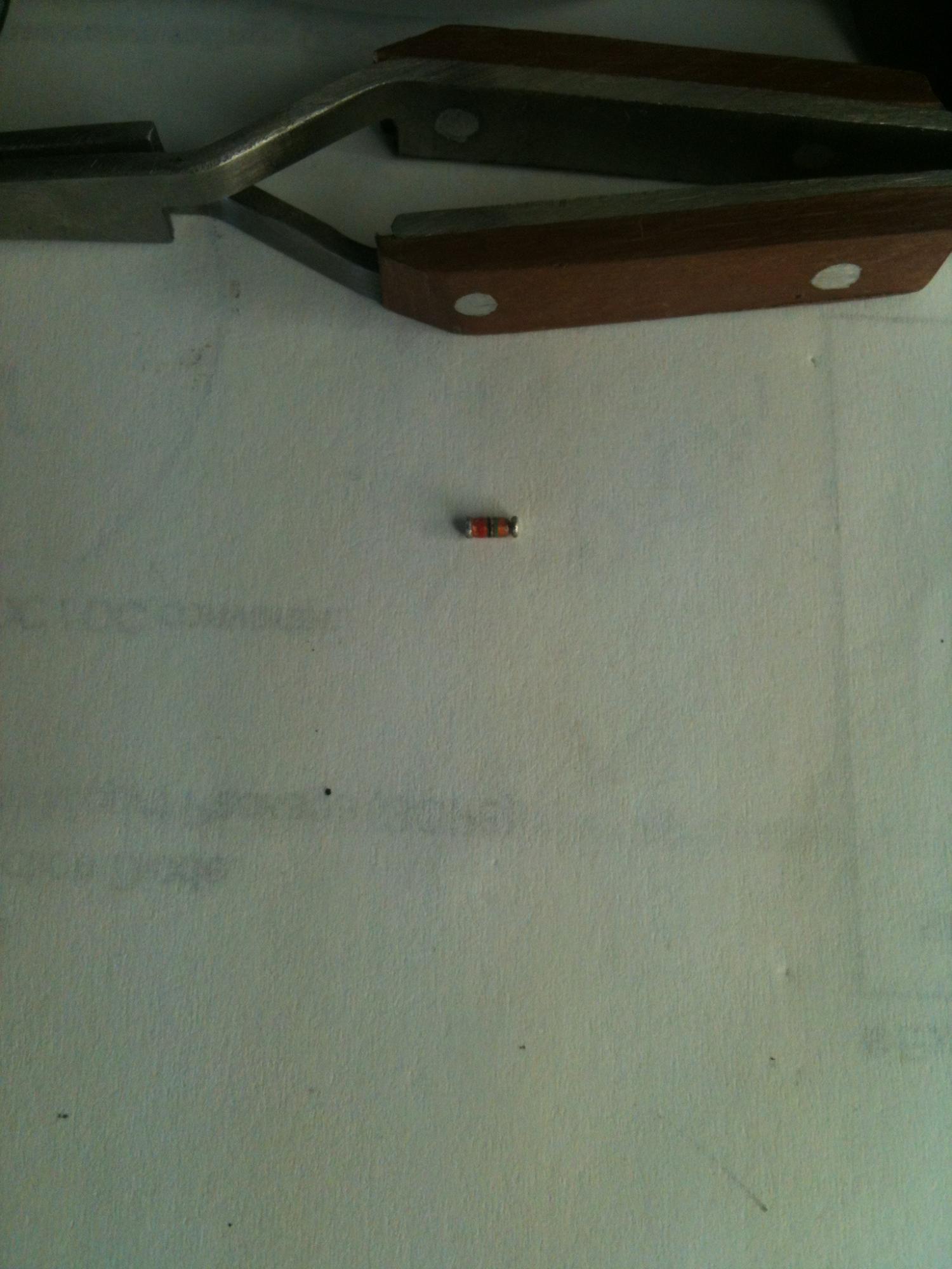

    Hello, this Zener Diode is on the A-board, it is part of
    the 15v rail that leads to IC5608 and 5607. In an earlier
    post I have attached the Schematics.
    Can someone identify how many volts this Zener Diode is.
    Panasonic parts does not identify the Diode. Suppose they
    want you to buy from them. Unfortunately they do not
    stock it.
    Thanks!

    Do you have the diode location number Dxxxx?
    • mr.sky
      • Sep 2011
      • 54
      Re: Panasonic TC-42PX14 Zener Diode
      D5573 It is near the 9v regulator IC5401
        I must be blind, read me the colors off the diode.
        If it is a red, Black, Green. Then it is a RLZ12

                  yes, the color is red, black green.
                  I am not getting 15v to the diode or to IC5401, reading is
                  5.4v to both components.

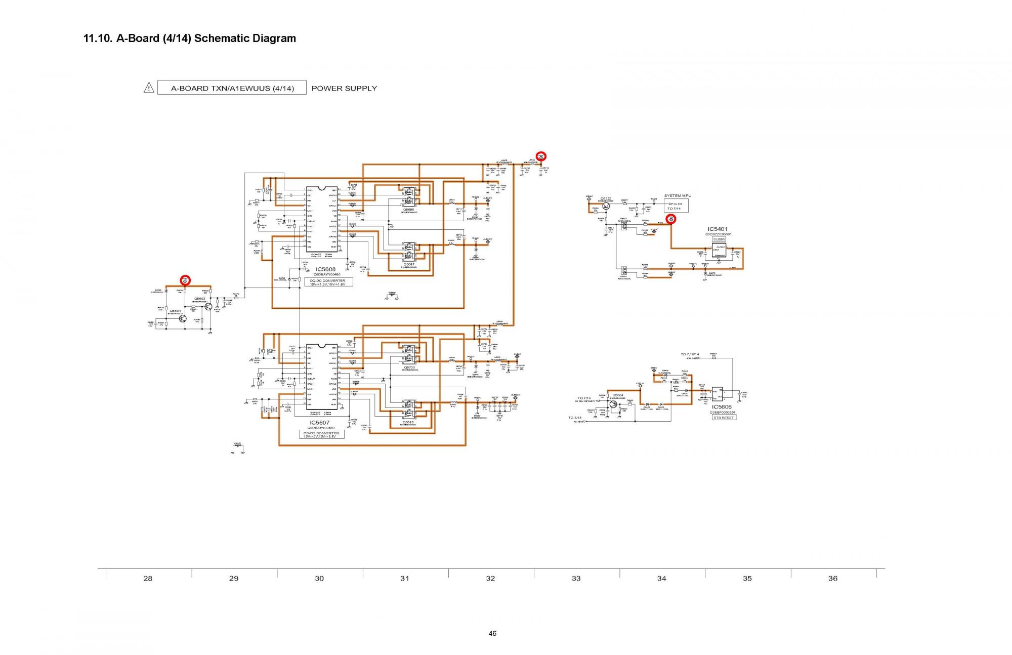

                    Originally posted by budm
                    Can you please give me the link to that schematic?
                    budm: here is the link to Schematic
                    http://www.mediafire.com/file/pgdrdbmc2ynu9km
                      It is big download file, downloading it, can you please point to which page this circuit is on?
                      • mr.sky
                        • Sep 2011
                        • 54
                        Page 30 and 46
                          Ok, the IC5401 is a 9V voltage regulator, so the Zener Diode may be 12V Zener.
                          So next thing for me is to find out what generates the F15V source.

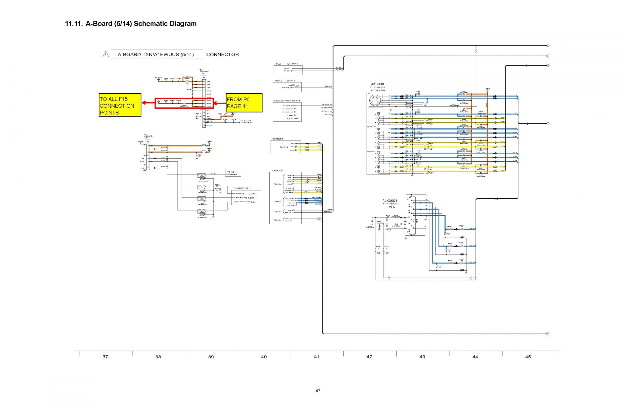

                            budm, read Slide #28 the last paragraph. I think this is why
                            I am not getting F-15v from outpins from power supply board.
                            There is a 3.3v 6pin voltage regulator on the component side of
                            the A board, maybe this is the one that triggers the command to
                            to acitivate the The PANEL MAIN ON command turns on the power supply circuit that outputs the Vsus, Vda, 15V, and 5V.
                            Let me note my A-board does not have IC 9004

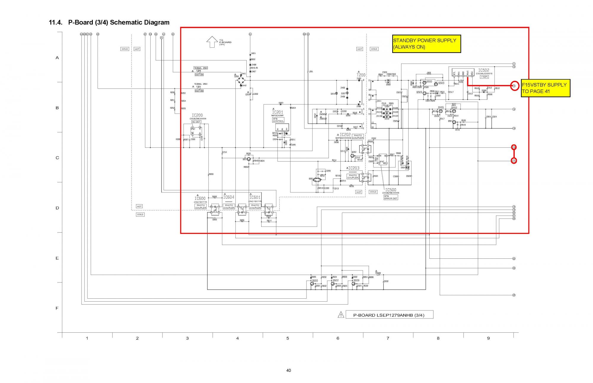

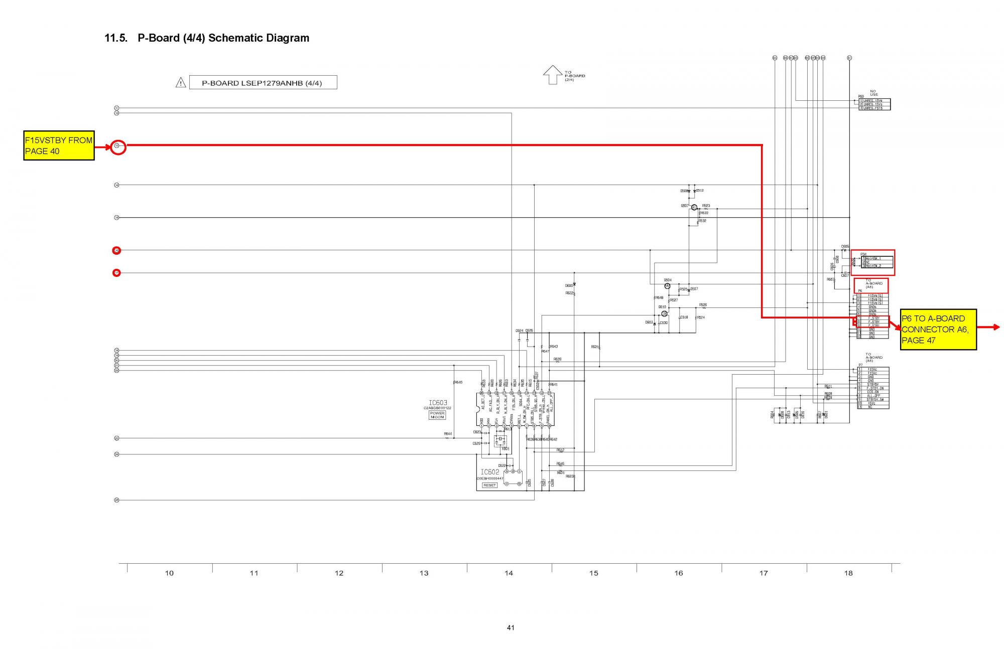

                              OK, I figure out where the F15V is generated from, see PDF/JPG attached.
                              This F15V is called F15V_STBY which is the always on standby power supply.
                              So you need to check the voltage at the IC502 which generated the regulated F15V voltages for a lot of circuits as I redlined.

                                On first diagram where IC502, I am not getting 15v at all.
                                Before I press the power button, reading is at 3.0v. Once
                                I power up unit it goes to 5.4v, same reading I get at the
                                A Board at IC 5401 and IC5608.
                                Also, Pins 7,8,9 same voltages at connector P6.
                                The unit is only come on for a few seconds, enough to take
                                a reading then shuts down within 5 seconds.
                                Note, I took the reading from pin 4 of IC502
                                  IC502 is the standby power supply (15V) which should be always running. The other power supply circuits is right below it is also always on, do you get any voltage there? There should be voltage at Q505, that section is for the standby 5V power supply.
                                  Basically, transformer T200 is for standby 5V and standby 15V power supply, so you MUST have these voltages.
