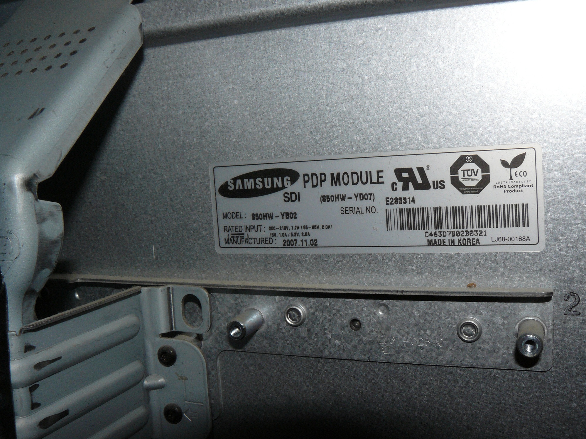

        What is the panel Model? Looks exactly like my 50" philips in my basement that has a samsung S50HW pdp panel

            Re: VISIO Model VP50 HDTV 20A (screen dead)
            There will be a sticker on the back of the plasma panel. Here is a pic of my 50" philips

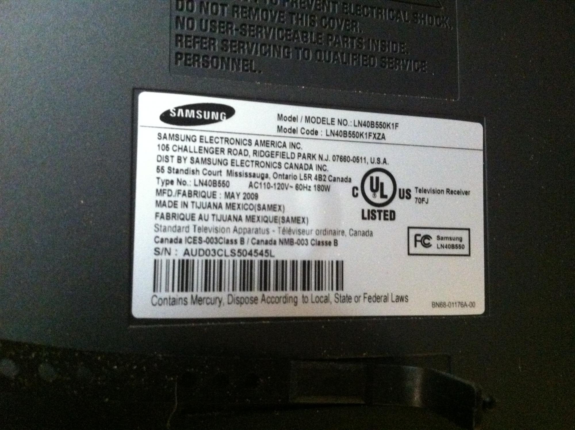

              OK, here are the labels on the back and inside the unit.
              http://www.use.com/a4fa12d6d9c7501304bf
              • Mr Bill
                • Nov 2011
                • 648
                I upload the wrong picuture , guess the old age bug is starting to bite. The sticker is actually on the back of the plasma panel inside the tv. It may be somewhere in the upper left or right corner. How long does the tv run before the speakers give a pop noise? Have you attempted to check voltages? Is there a table on the power supply showing what led #1 would be. It seems the power supply is going into protection mode.
                  There are two photos that I sent , one is the one your talking about.
                  The speakers make a slight pop like the audio amp is going on and the when the logic board LEDs go off the slight pop goes off again like the power amp is going off. I think that's all it's doing, the audio amp going on and off.
                  The screen never comes on at any time. I can't get to checking the voltage, the power amp is turning off to fast.
