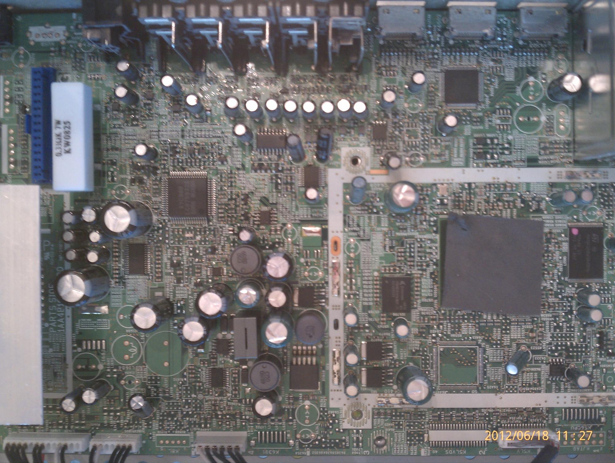

    Sanyo DP50747-04 (Chassis 04)
    This is my next project, I had found a service manual before I bought it but apparently there are several chassiss designs, could not find the IC's listed to troubleshoot guess the main board is different. Anyone have this?

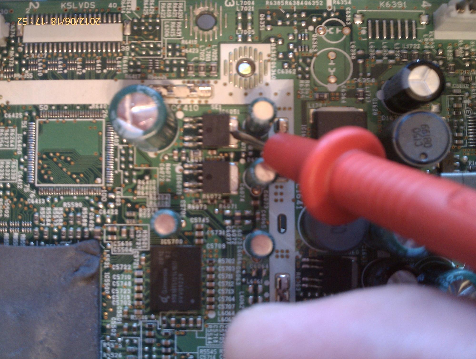

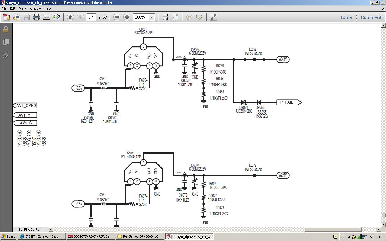

              Re: Sanyo DP50747-04 (Chassis 04)
              OK checked voltages in PF circuits, appears everything seems to be good except IC6051. I have 5v in pins 1 and 2, 0.6 on where I have my test lead (Supposed to be 3.3v). The same regulator below that one has 2.6v out. Am I checking the correct pin for output?
              Datasheet for that IC:
                It looks faulty to me. High on pin 2 means regulator is switched ON, and there is a sufficient input voltage. What is the voltage between pins 3 (tab) and 4?
                  Not sure what you're asking me to check?? I have 0.6v on pin3 and 0.2v on pin 4.
                    So replaced IC6051 with same result. I guess I should have isolated pin 6 first to check it. When I remove pin 6 from circuit I have 5v on pin 6. So it seems there is something else wrong in that circuit. Can someone look at the s/m I posted a link for and tell me what this circuit is for?
                      Pin 6 is the output. So something on the board is shorted to ground.

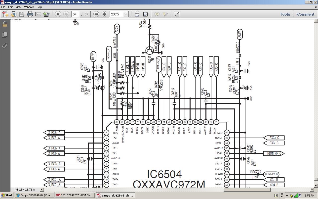

                        Would I be correct that this regulator is feeding this IC6504?
                        Im trying to isolate whatever chip IC6051 is feeding voltage to, I see IC6051 outputs A3.3v, and IC6504 shows A3.3v coming in. In the photo below, where the 3.3v is coming into IC6504 it shows a capacitor C6518 inline before. I removed that cap and still have the short. Am I going about this correct or am I way off?
                          on page 30 of your service manual of block diagram it will show you all the connections of where your (a3.3) will connect.then using your schematic on page 57 and lift componets which are tied to the (a3.3) line until short goes away then you can better isolate to defective componet. the most common problem i've seen with this when the (a3.3) line has short on it is where the HDMI switch ic6504 has been damaged,seen also cases where the top of ic blown off
                            Thank you. So by looking at page 57 would removing C6518 isolate IC6504? I see pins 23 and 55 getting the A3.3v I was trying to avoid cutting the traces on the board. I didn't see any other places on page 30 getting a3.3.
                              no removing c6518 will not isolate ic6504 but desoldering one side of the coil L6516 or L6515 would
                              also if short still present after lifting coils L6516 or L6515 also find coil L6518 which also feeds (a3.3)to ic6504
                              next if ic6504 is confirmed OK lift coil L5541 this connects to ic5500 then see if short has gone
