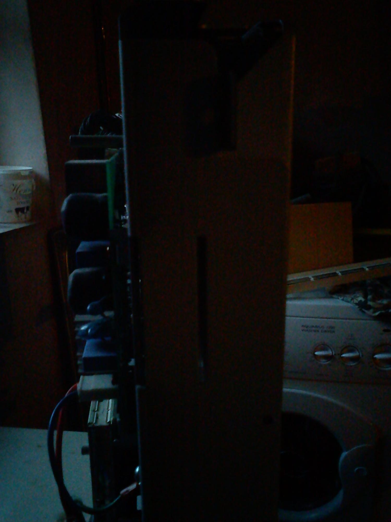

                Re: Baier 27" lcd screen keeps turning on and off

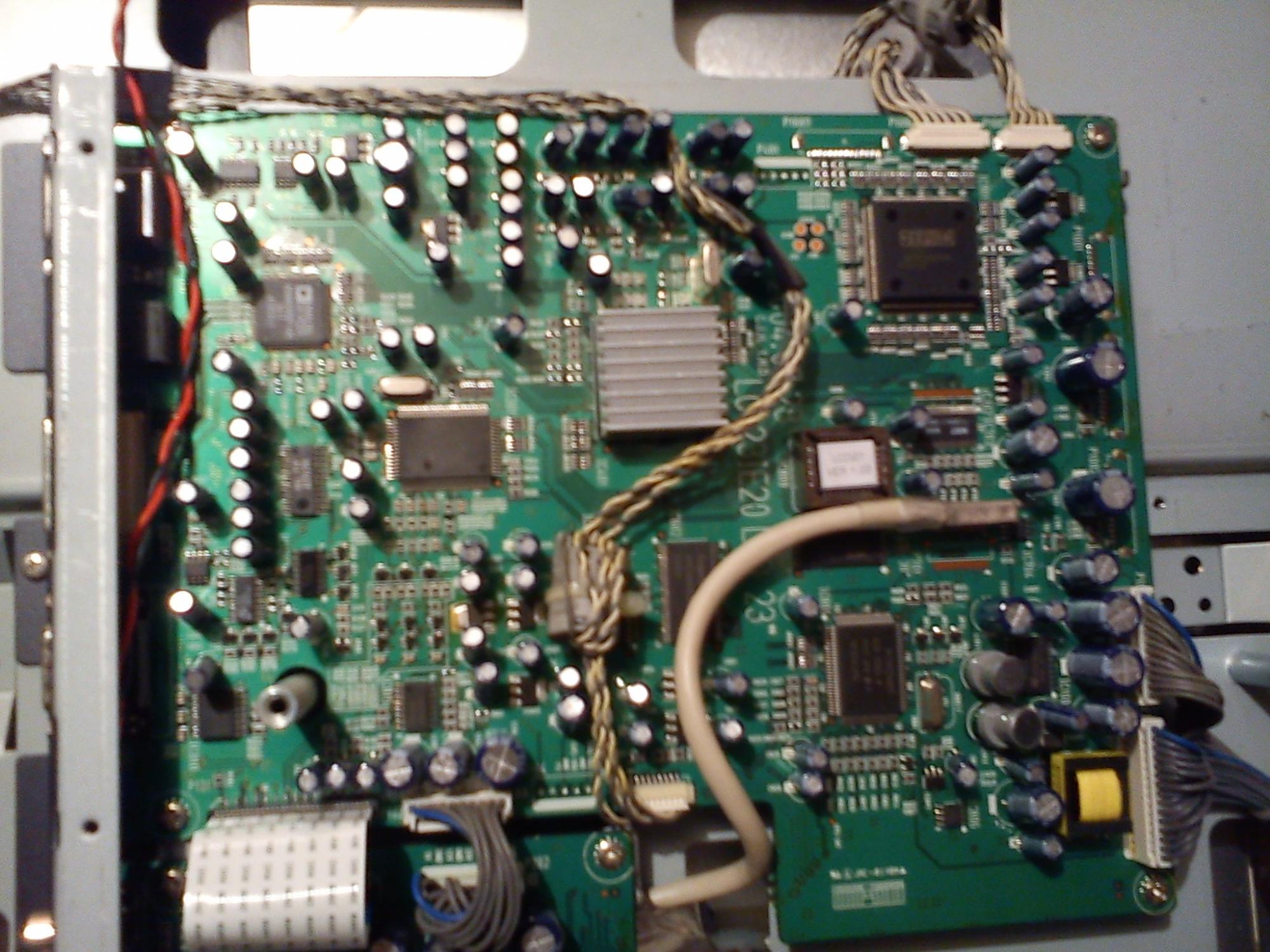

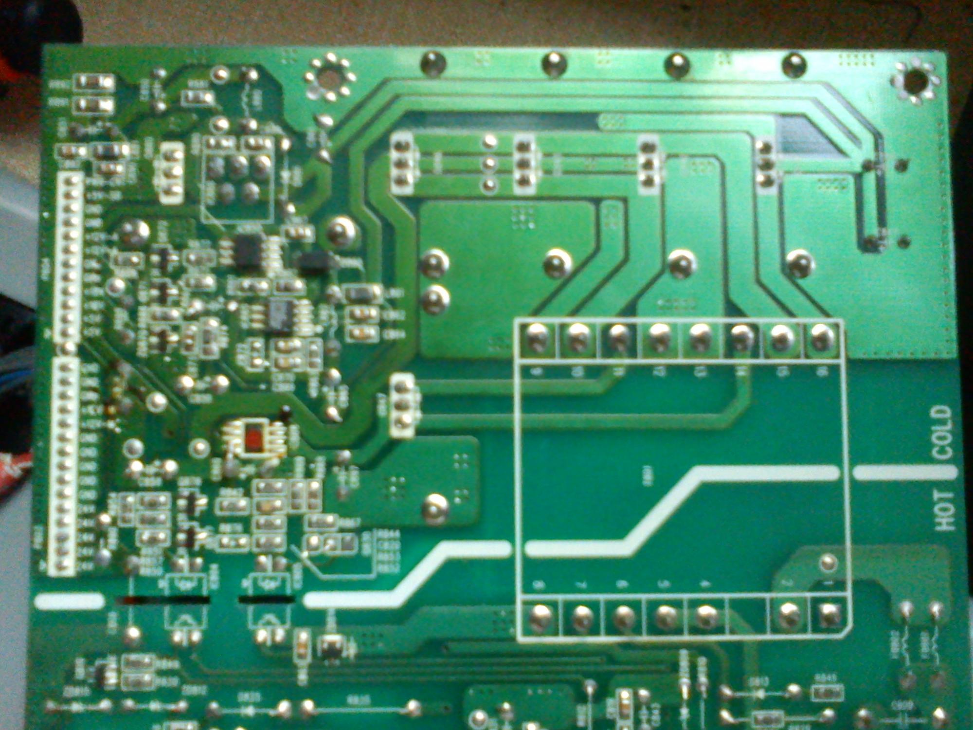

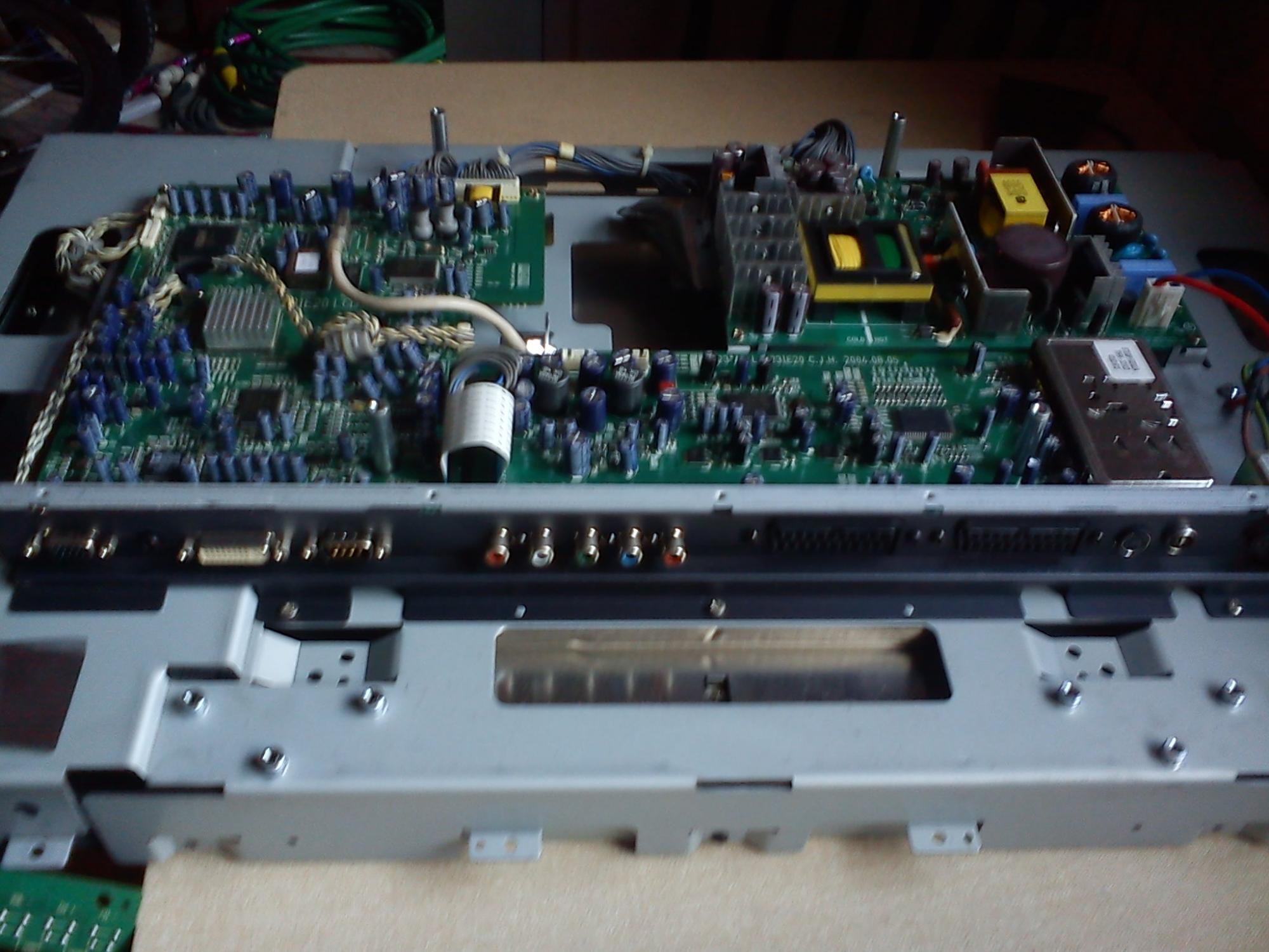

                Hi Tom and Selldoor,

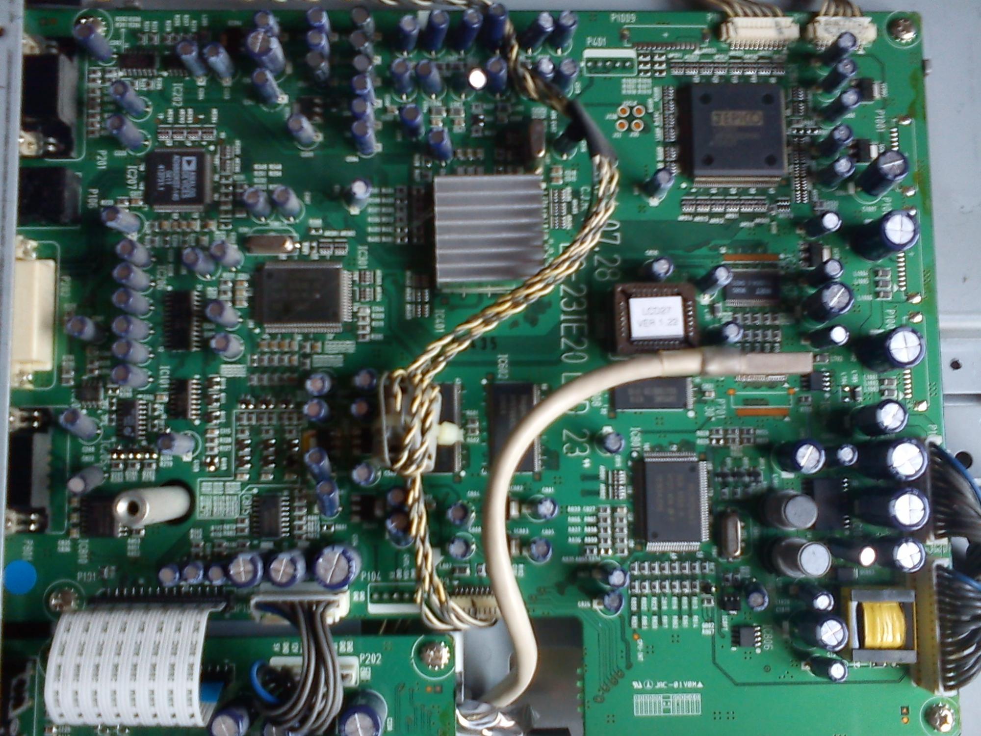

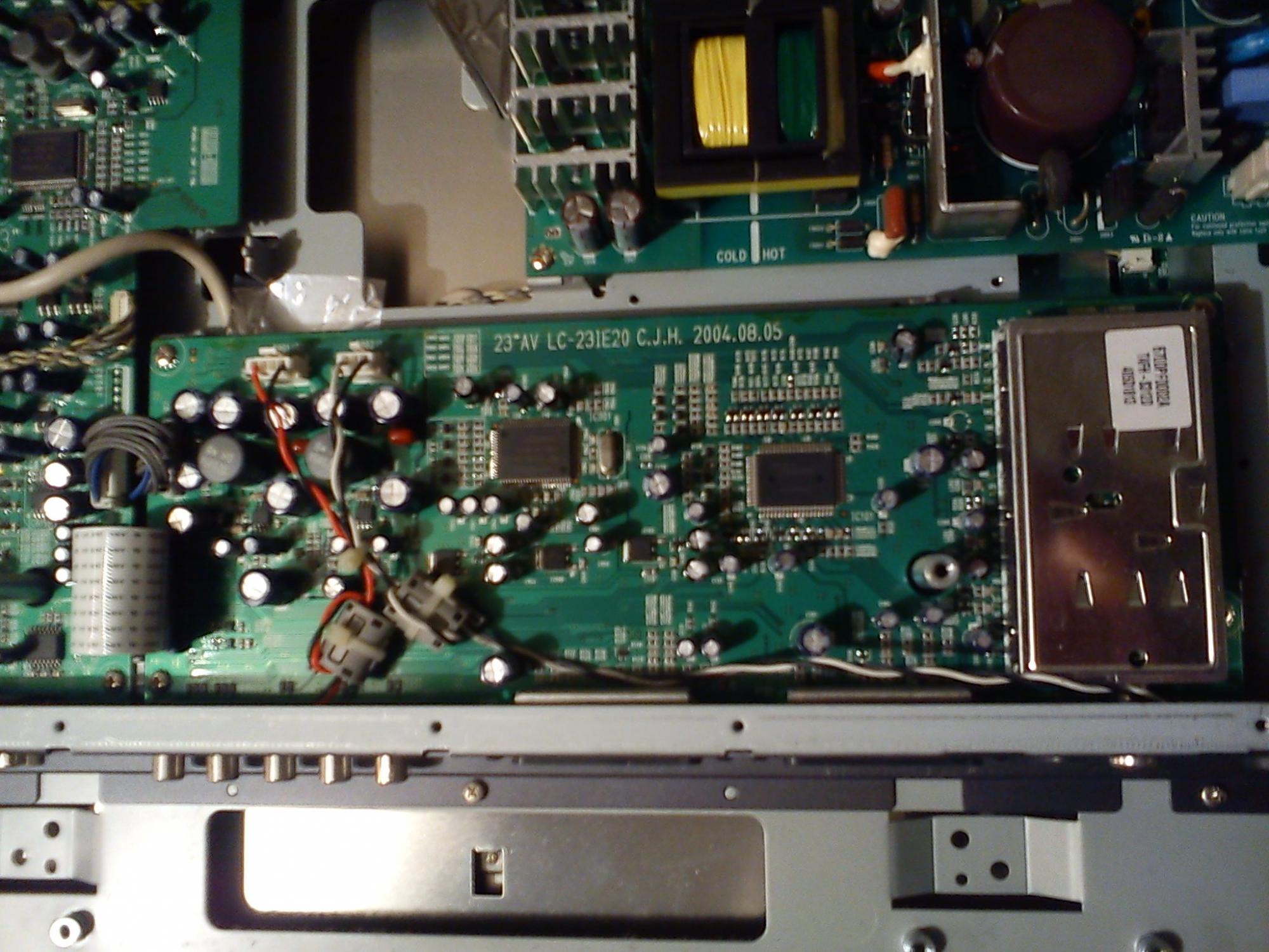

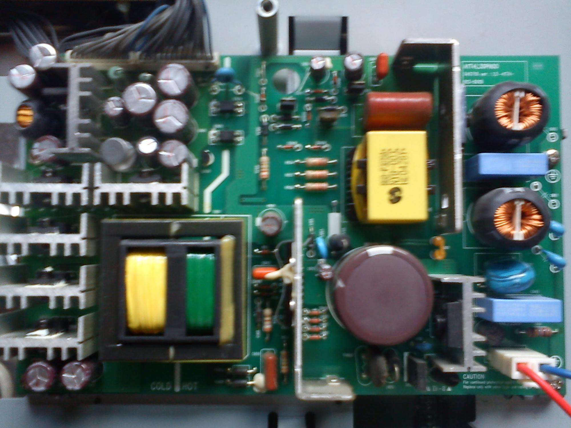

                i have attached three pictures. the invertor board in between these board and lcd i will try to get the picture of that in the good light.
                  Pictures are not really clear enough for troubleshooting - we need to be able to read the small numbers on the boards. Have you checked the caps for swollen/leaky. The two on the bottom left hand corner of your pic 1 appear to look a bit swollen in Pic 2. Having said that Tom may recognize the boards. If you can do his glow in a dark room test and give us the tv model number off the label on the case back and also the part numbers off the boards- in the last pic the No is like L0*231E20 *

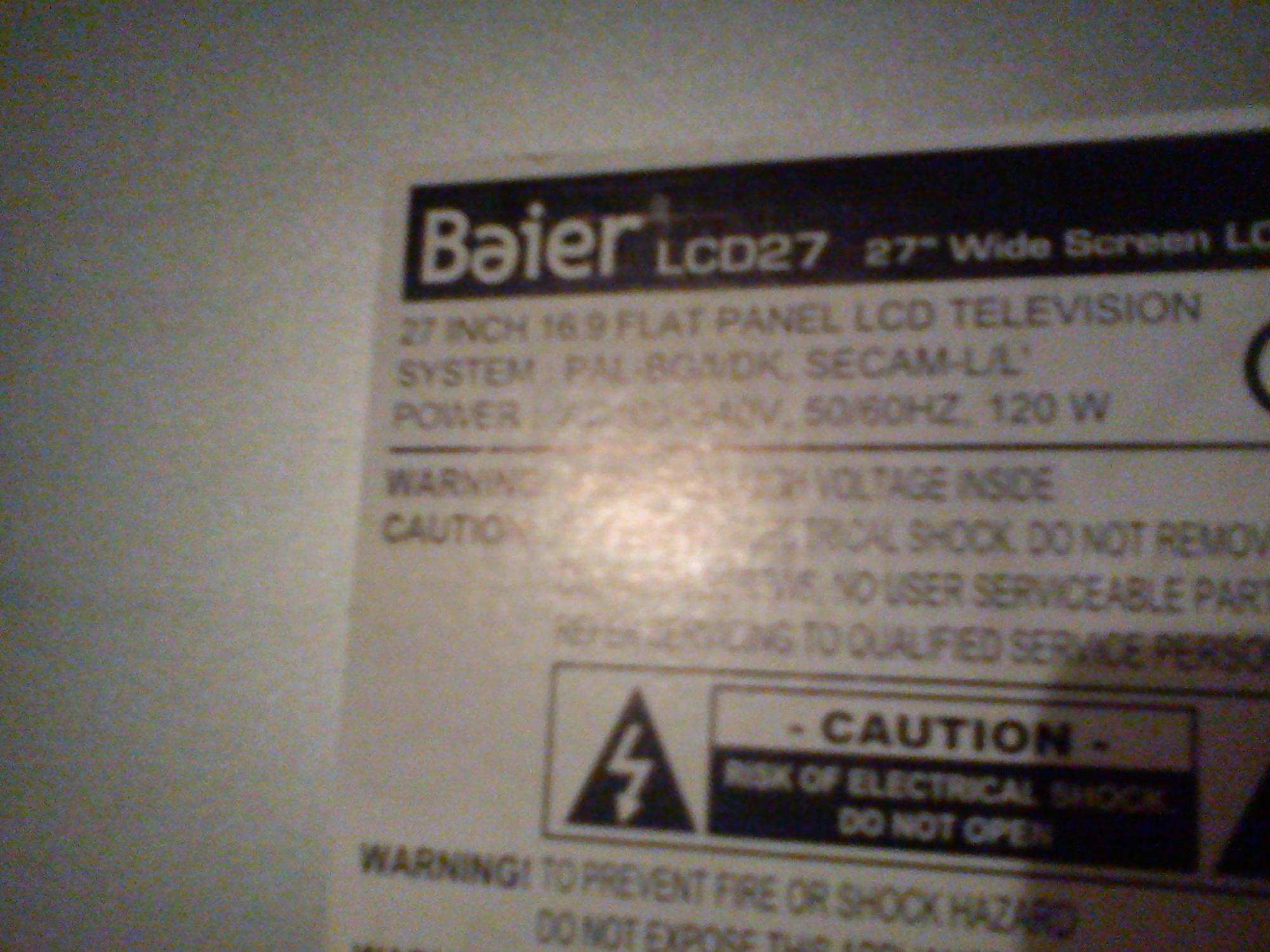

                    I think model no is Baier LCD27, plase look at the attached picture. i will try to get more clear picture.

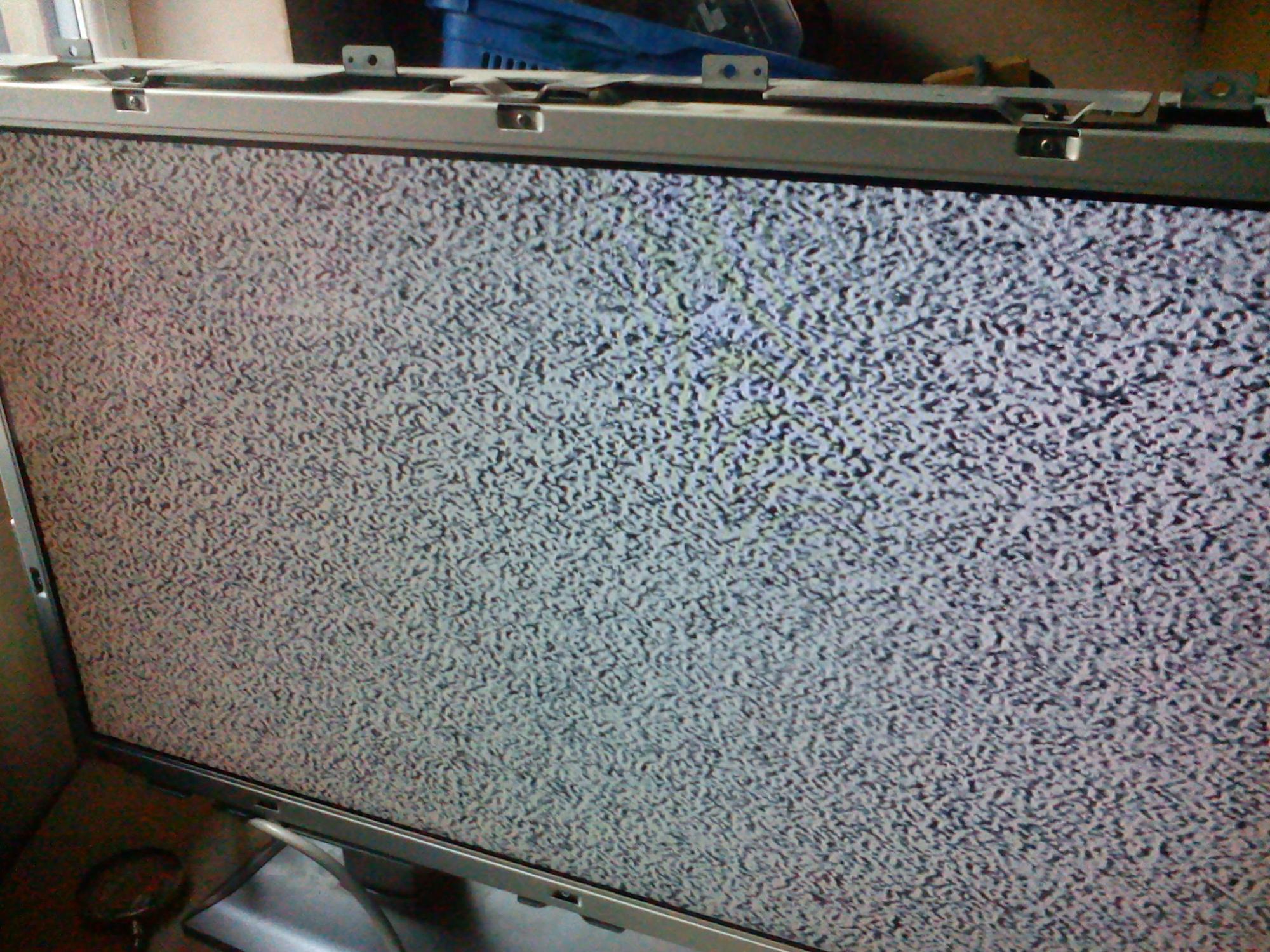

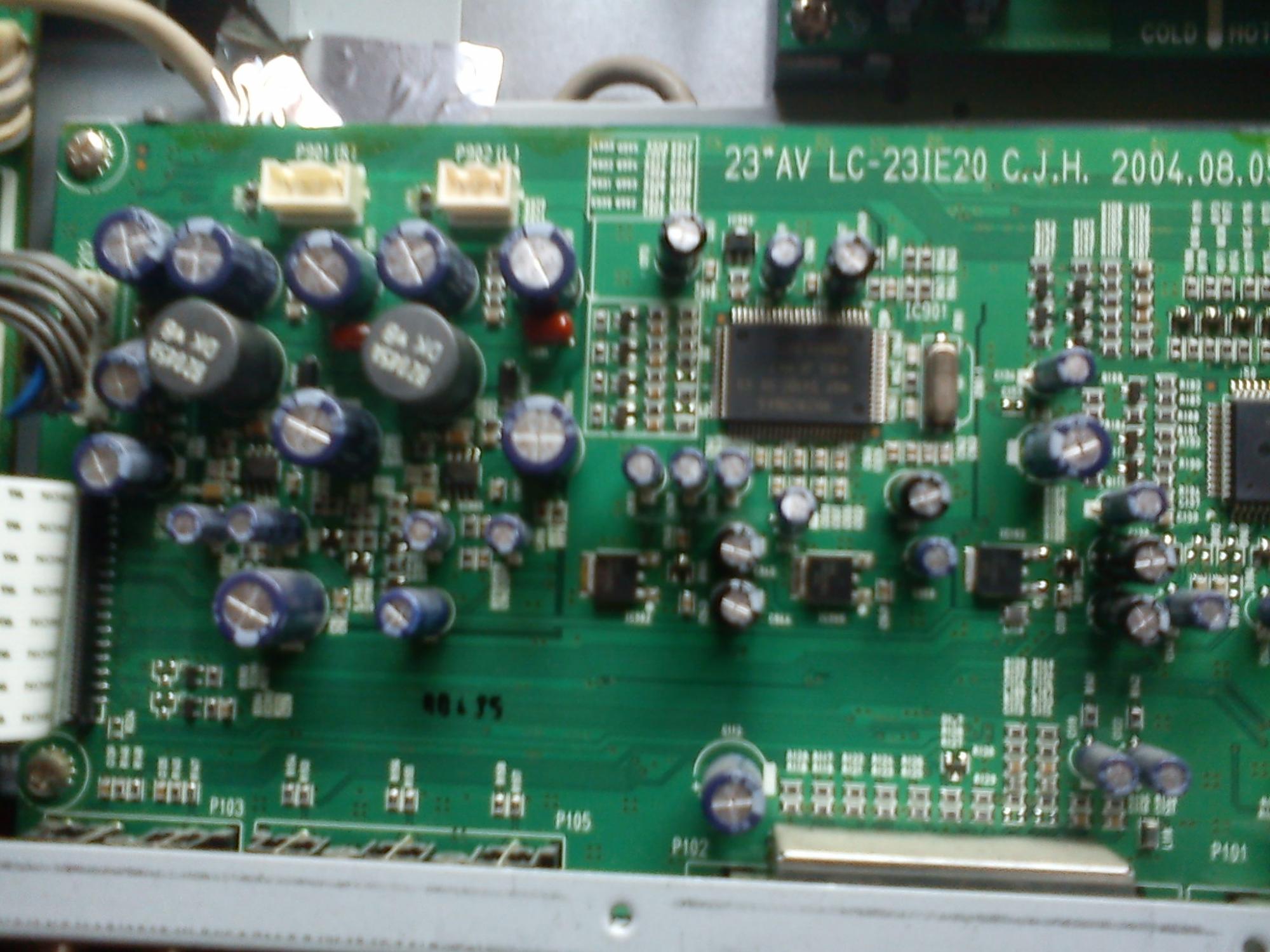

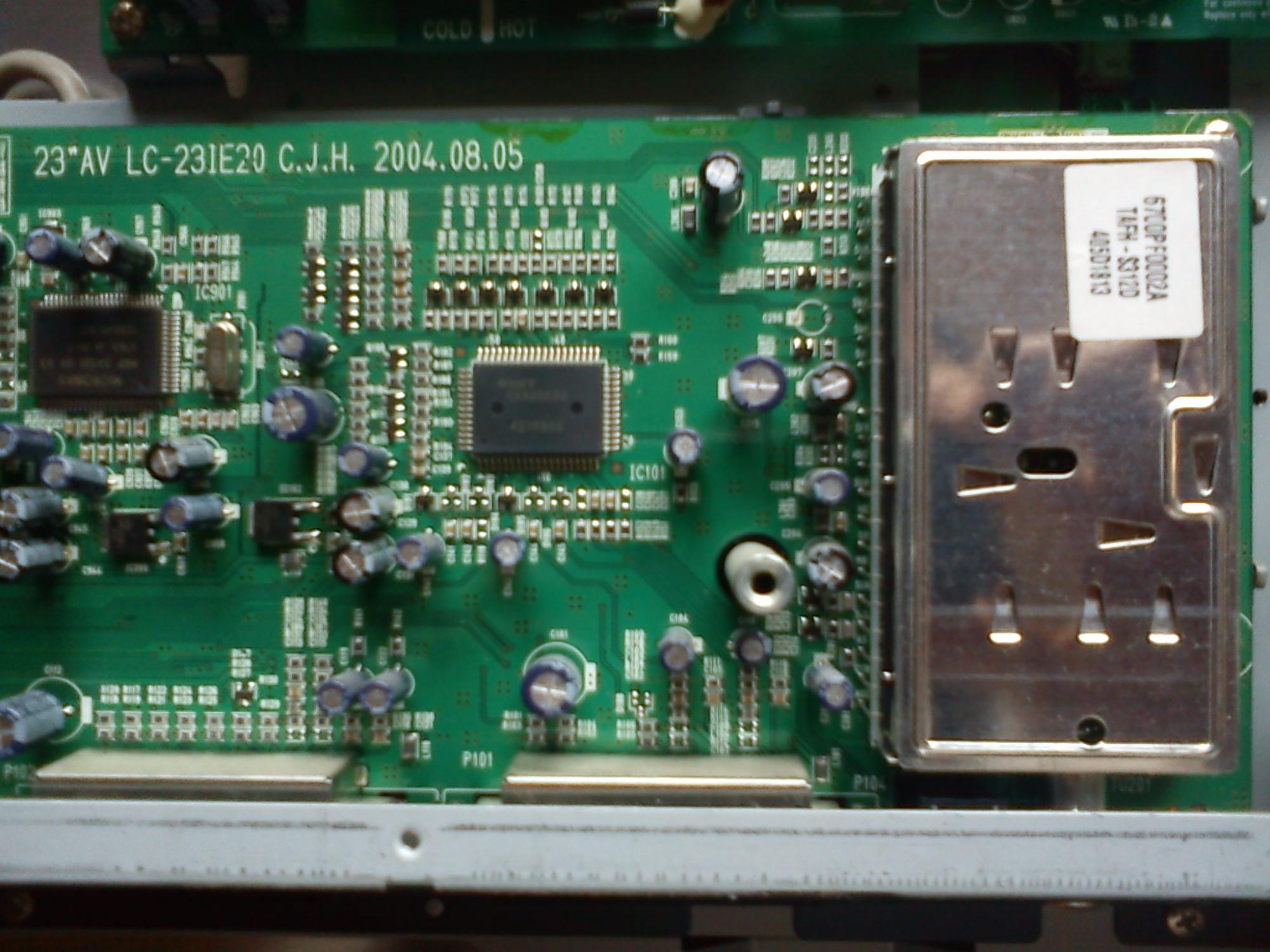

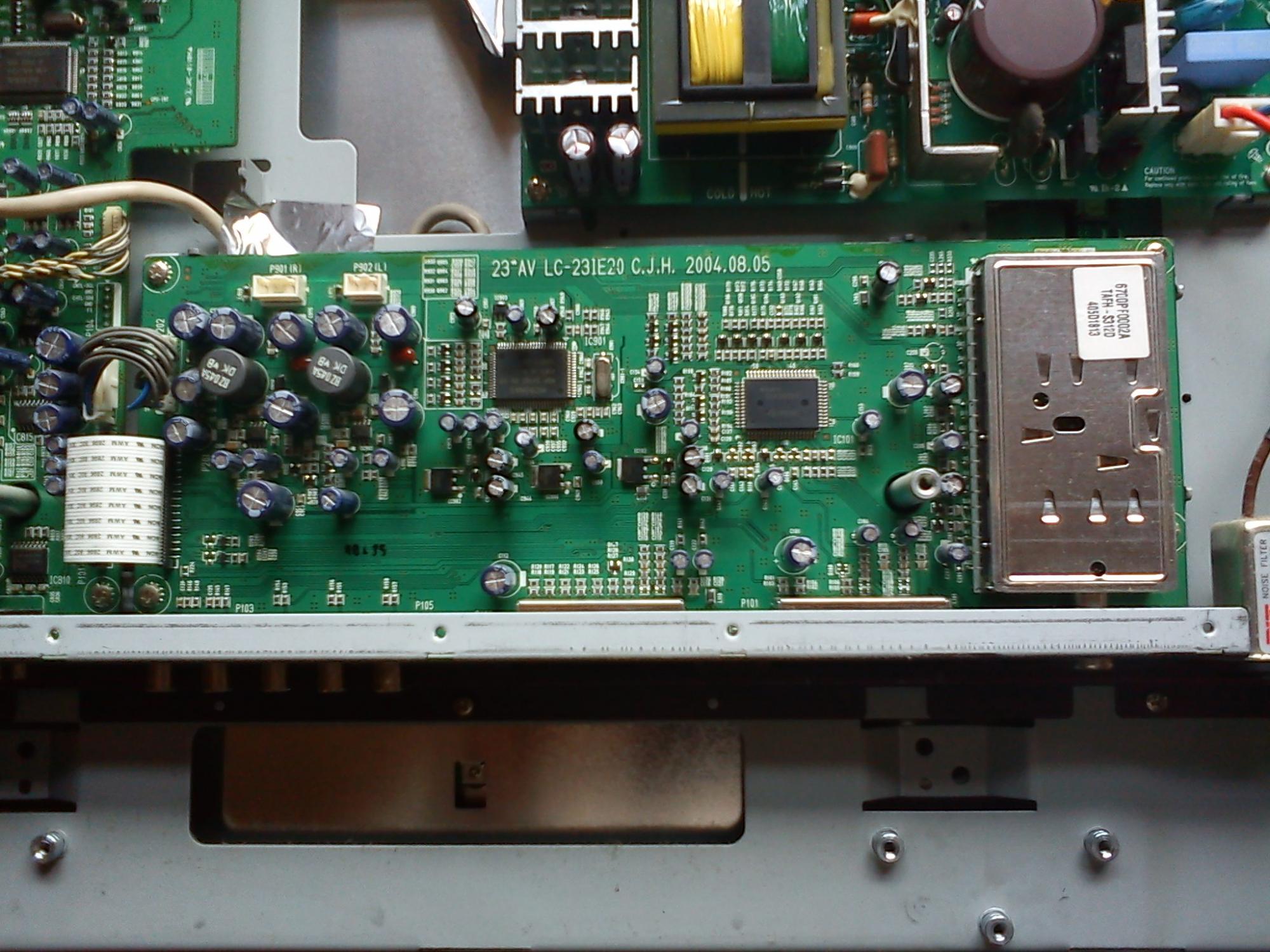

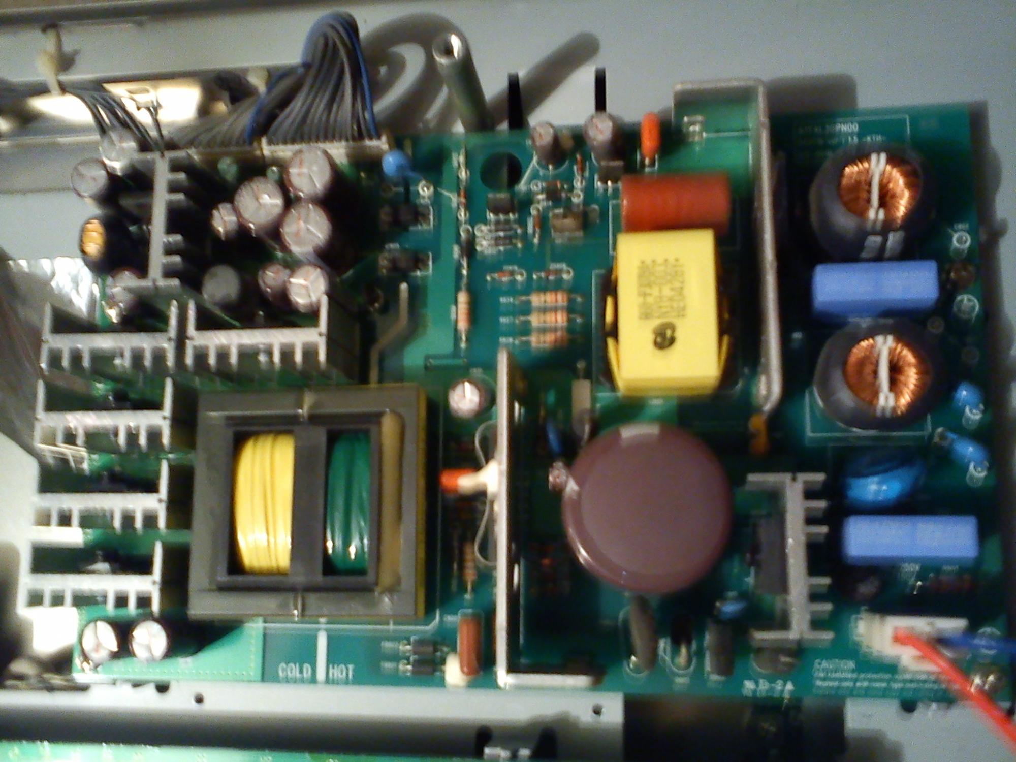

                          Taken some more pictures they might help, the screen comes on by changing the channel + - button and goes off after few seconds used hair dryer and it stayed on for more longer time and did not switch.
                            Have you got a source connected -A dvd is best if you have one then you can just leave it running to provide a picture and sound source. When its on is there an actual picture
                            and is there sound. How long does it stay on.
                            When it turns itself off what does the power light do.
                            Does it come back on by itself? how long is it off for?
                            What did you use the hair dryer on?
                            Pictures are doing my head in!! Pic 5 Right hand corner a row of little caps 2 and 4 look to have something on the end - Do they? can you do an infocus pic of the row of5
