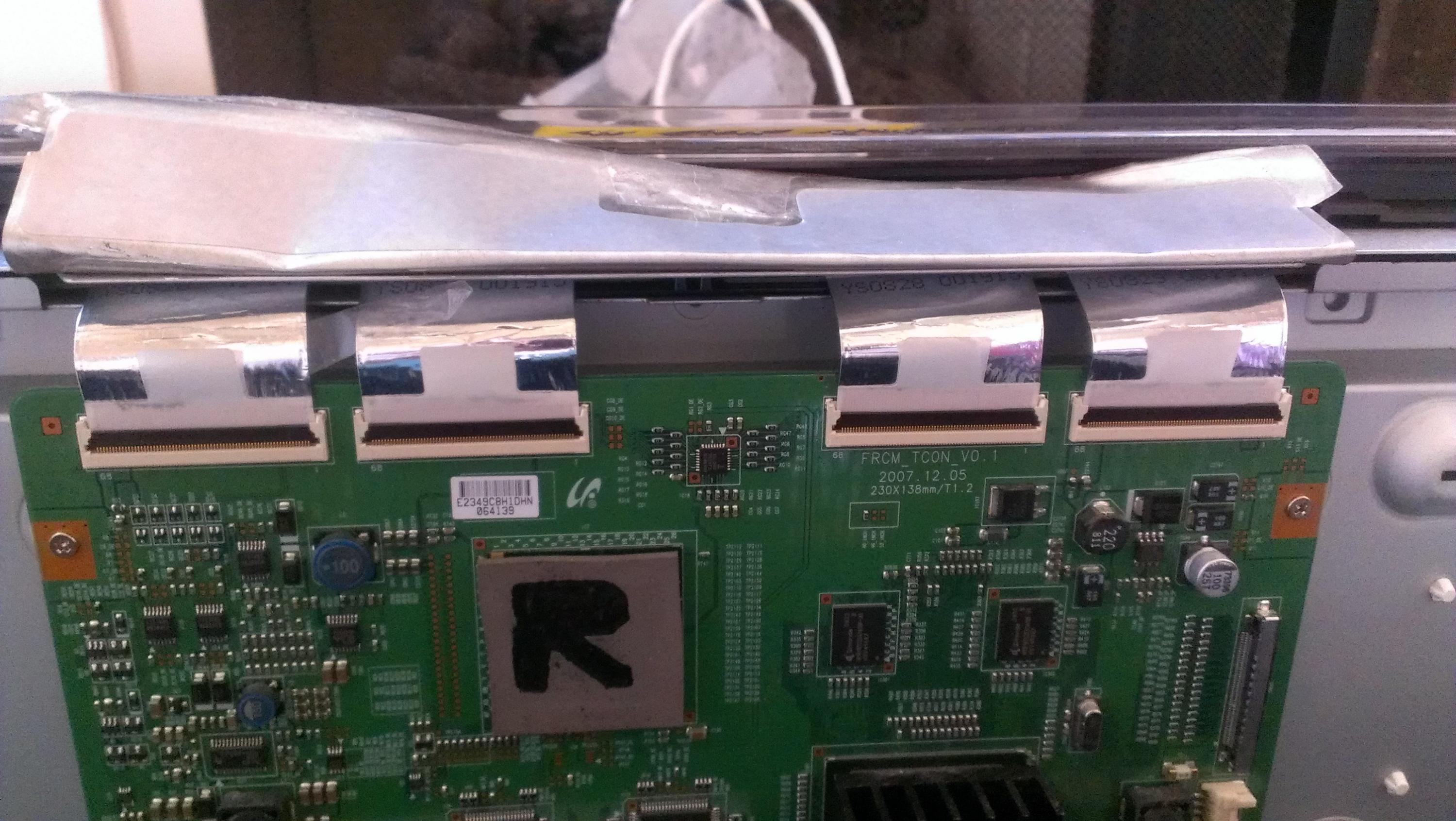

        Re: Samsung LN40A630 display question?
        i have a question, what are the small silver ribbon cables going from the tcon board to the driver boards and where can i get them? there are 4 of them.
          Ribbon cables. Probably you can buy them from Samsung, or from someone who has broken up this TV.
                  this is a picture from the back of the tv, i can take one out if you need and post it.
                  • BoJaXz
                    • May 2013
                    • 19
                    ys0828 1915 is the number on it. i can get some from the netherlands off ebay. but that would cost me almost $30 for one freakin cable
