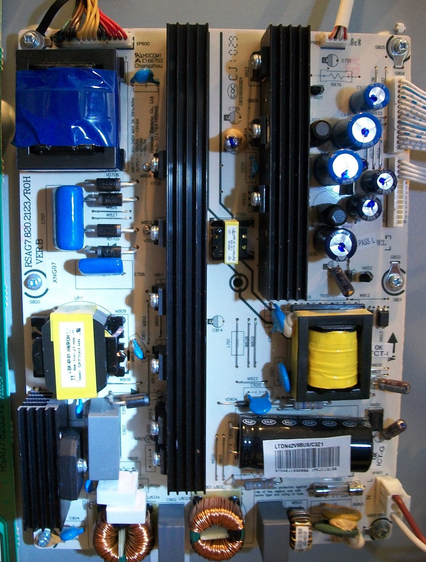

Emerson ltdn42v68us, 42" LCD, picture goes out, has sound. Set's about a year old.
Press on, power light goes from red (standby) to blue (on). Picture and sound come on. After a short time (now about 10 seconds, and getting shorter) the picture flashes a couple times and goes black. Sound stays on, blue light stays on. Indifferent to channels of input (AV, HDMI, etc) and no menu... the screen's just black.
The whole thing reminds me of an old computer with a CPU in thermal runaway... I'm guessing something's getting hot and shutting down.
I'm planning to open it up this weekend to see what's going on. What are the usual suspects here? Any help appreciated.
