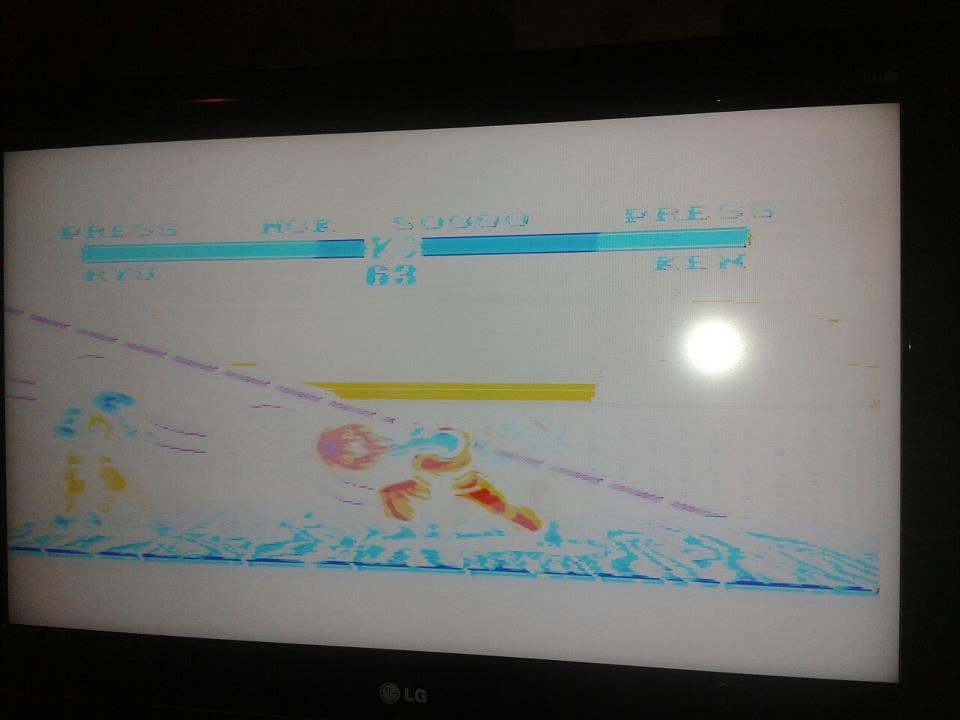

    I got a 32" LG LCD which has a colour problem.
    The image is mostly white, but if brightness is maxed you can make out some of the image. Parts of the image persistently stay on the screen. There are some green and pink tints in some of the images. There are no borders, double images, vertical or horizontal lines. The image just has whacked colour.

    Re: LG 32" 32LG50FD whitish picture
    This is a photo of the colour problem.

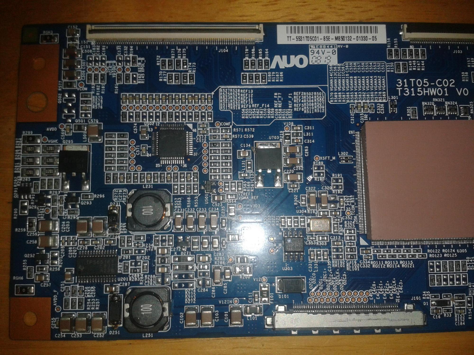

        It's an AU Optronics T315HW01 screen, with a T315HW01 V0 T-Con board.

          Hi tom66, i did a voltage measurement of VGH and VGL pads on the tcon board, VGH=27V, VGL=-6.0V

            VGH seems way too high... it's usually around 10-15V. Not sure about VGL. Right now I would suggest you see if the T-con is available cheap somewhere, as AUO are in lots of cheap TVs.

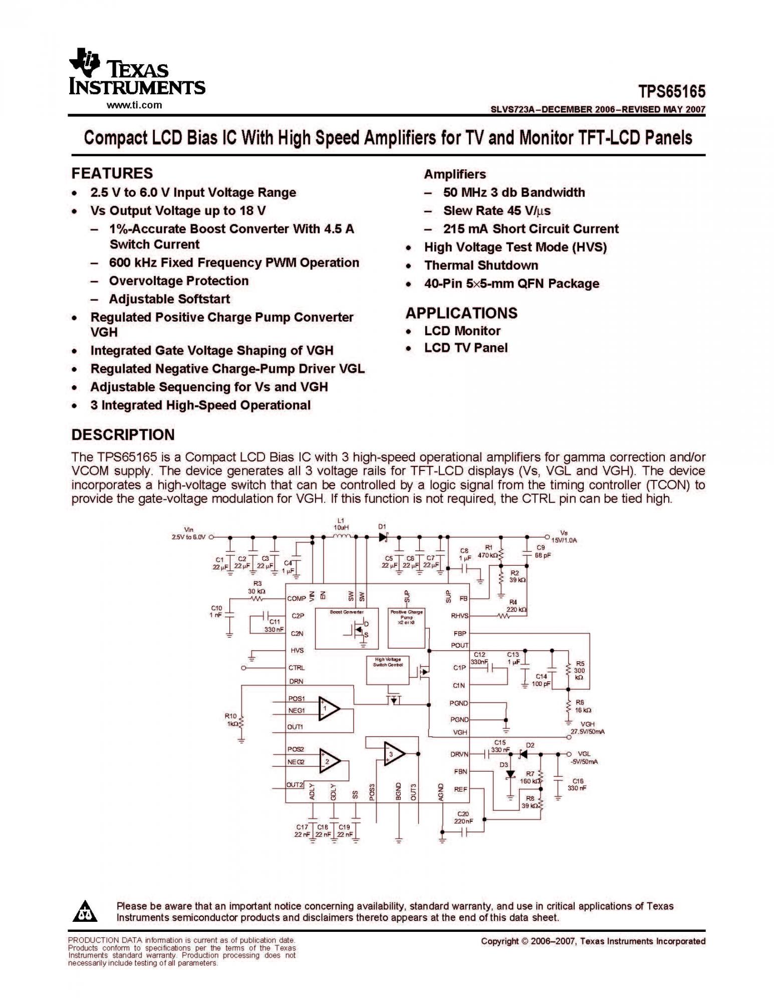

                I did see 27v Vgh on some panels that use TI chip.

                  Ah i see, thanks for that budm. This T-con board uses the TI 65161. By examining the feedback resistor values I imagine the correct voltages can be ascertained. Say the voltages went too high, would it damage the panel itself? One of the application notes in the 65161 datasheet has a VGH of 27.5V, VGL of -6V and a VS of 16V, which matches the readings on the T-con board. If the voltages are within spec, is there another thing to check on the T-con board or could the panel be damaged? Cheers
                    The Vgh, Vgl, Vs are fed to the ICs on the side Tabs on the flexible circuit board which will drive the Gate of the TFTs on the LCD panel. I cannot tell you for sure if it is still T-CON or the panel itself.

                          Re: LG 32" 32LG50FD whitish picture FIXED
                          OK, great news on the 32LG50FD LCD set which had a white picture. It has been fixed with a replacement of the T-con board. I would like to thank all those who posted here giving me advice on where to start. A picture is shown with the replacement T-con board fitted and running a test source on the screen. This was a 2nd hand part from an internet vendor.
                          So for those running AUO screens which have gone white, it is due to a bad T-con board. I am lead to beleive the problem is in the LCD bias voltage generation circuitry. It had become hot on my previous board and had made scorch marks on the rear of the T-con board.
                          Before removing the old T-Con board I made notes of voltages on every test point. I will now re-test the voltages on this good working board and publish the results here shortly.
                              Hello All,
                              The voltage readings from the good T-Con board have been measured. A picture is attached of the board's voltage generation circuitry. It's a AUO T315HW01 V0. Different voltages in bold.

                              What can be seen here is U502 is bad. On my bad board it has been so hot that the chip ID is burned off the face of the chip. It looks like it's a multiple output linear regulator IC.
                              The VGAMA references are totally different, which I beleive are derived from U502. The main regulator, U201 which seems to feed U502 seems to have survived with the main VGL, VGH and AVDD voltages intact, though it's running a little hot evidenced by the hot marks on the rear of the board.
                              The conclusion is thus, U502 is faulty and should be replaced. Since this is a chip made by AUO itself, maybe it will be difficult to source. Can anyone else chime in here? Anyone know the part number of this chip?
                              According to the LG 37LK450 service manual, a similar IC on the T-Con board, IC U601 is a “DC-to-DC converter which enerates the voltages necessary for the panel to operate." It is however a 32 pin beast as compared to the 48 pin chip on this T-Con board. It has a similar style of voltages on the test pads according to the manual. I posted a link to this manual further up.
                              Thank you all for your input and hope this post helps someone else out. Also welcome for discussion.

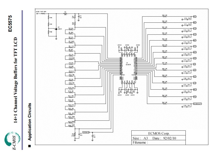

                                U502 is a gamma voltage generator, something like this part: http://www.maxim-ic.com/datasheet/index.mvp/id/5757
                                It shouldn't get hot, I'd guess they are using cheaper chips or running them above spec.
