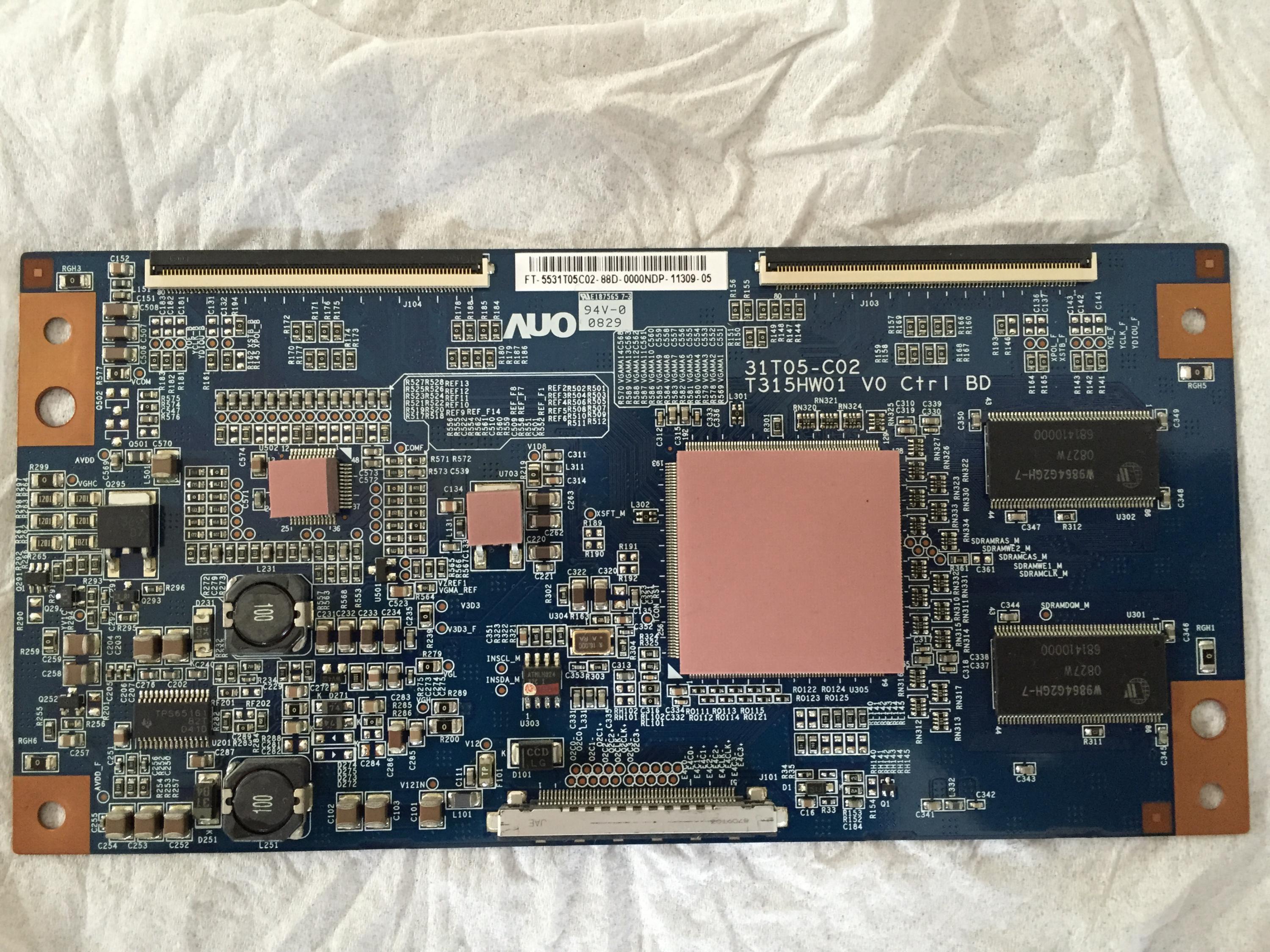

LG 32" 32LG50FD whitish picture

    Hi There
    Thanks for your reply. I managed to take out the respective TCon and have attached the pic for the same. Kindly advise where can I purchase similar / substitute for the same.
    Cheers
    PK

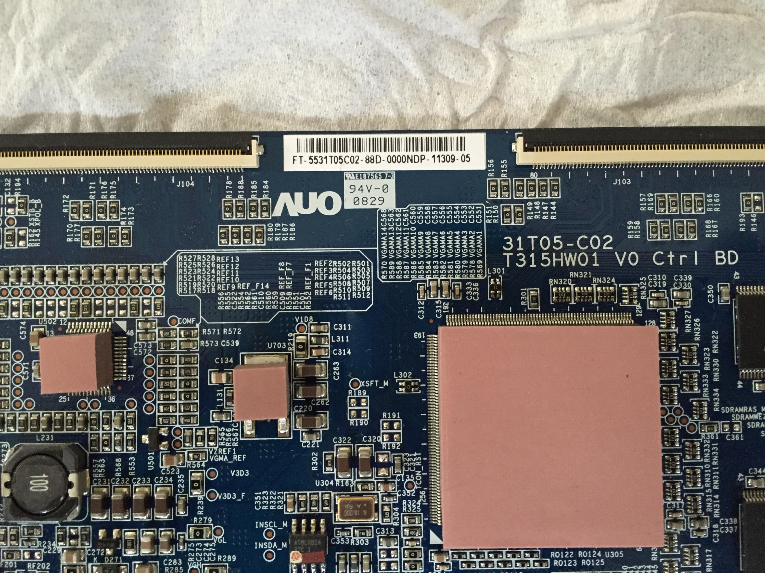

    Originally posted by budm
    Please provide the pictures of the T-CON board, you need the P/N as printed on the barcode and then go to shopjimmy.com to see what they have and any sub you can use.
    Same model TV can use more than one supplier of the LCD panel so you need to get the correct one for what you have.
      Re: LG 32" 32LG50FD whitish picture
      http://www.shopjimmy.com/auo-55-31t0...-con-board.htm
      As you can see the # on the barcode:5531T05C02
      There are subs as shown on that page.
