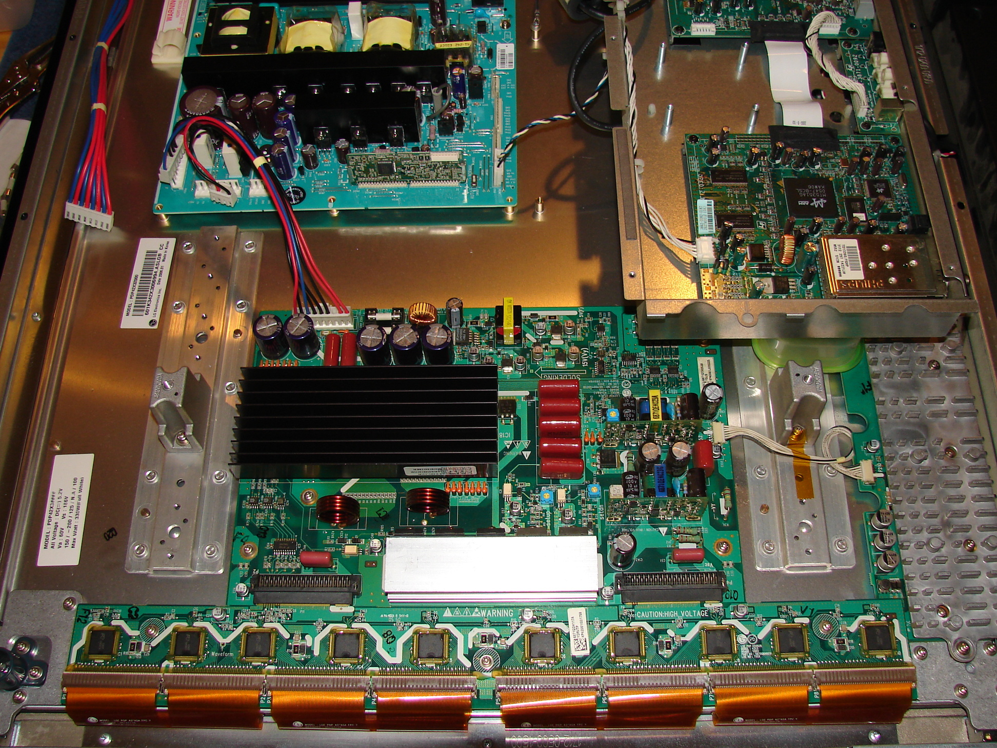

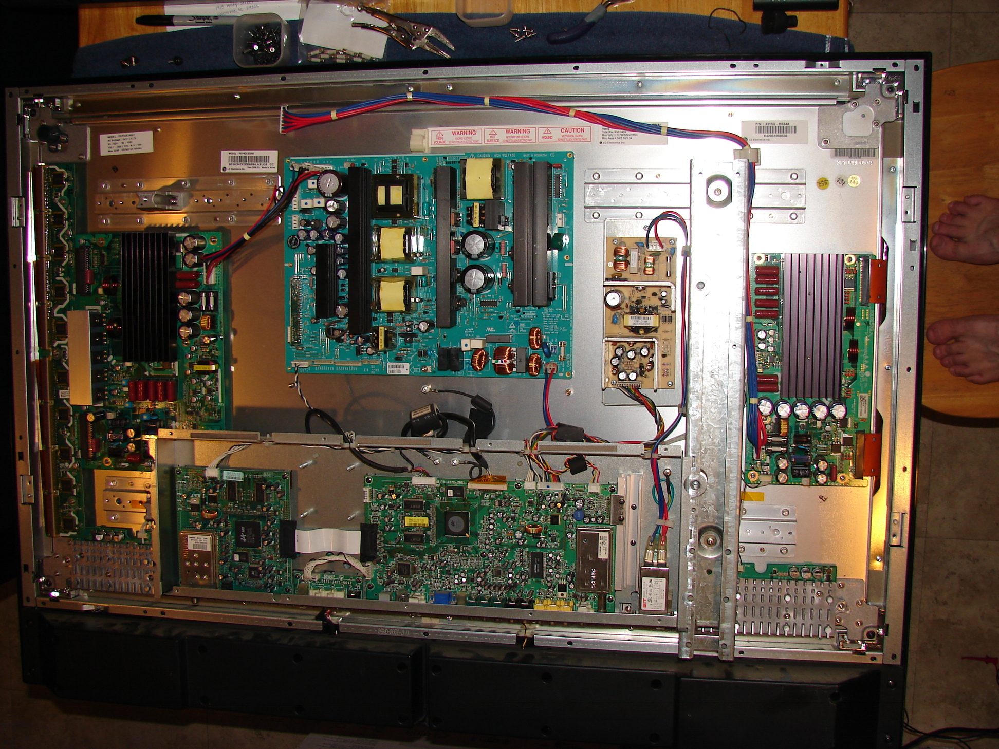

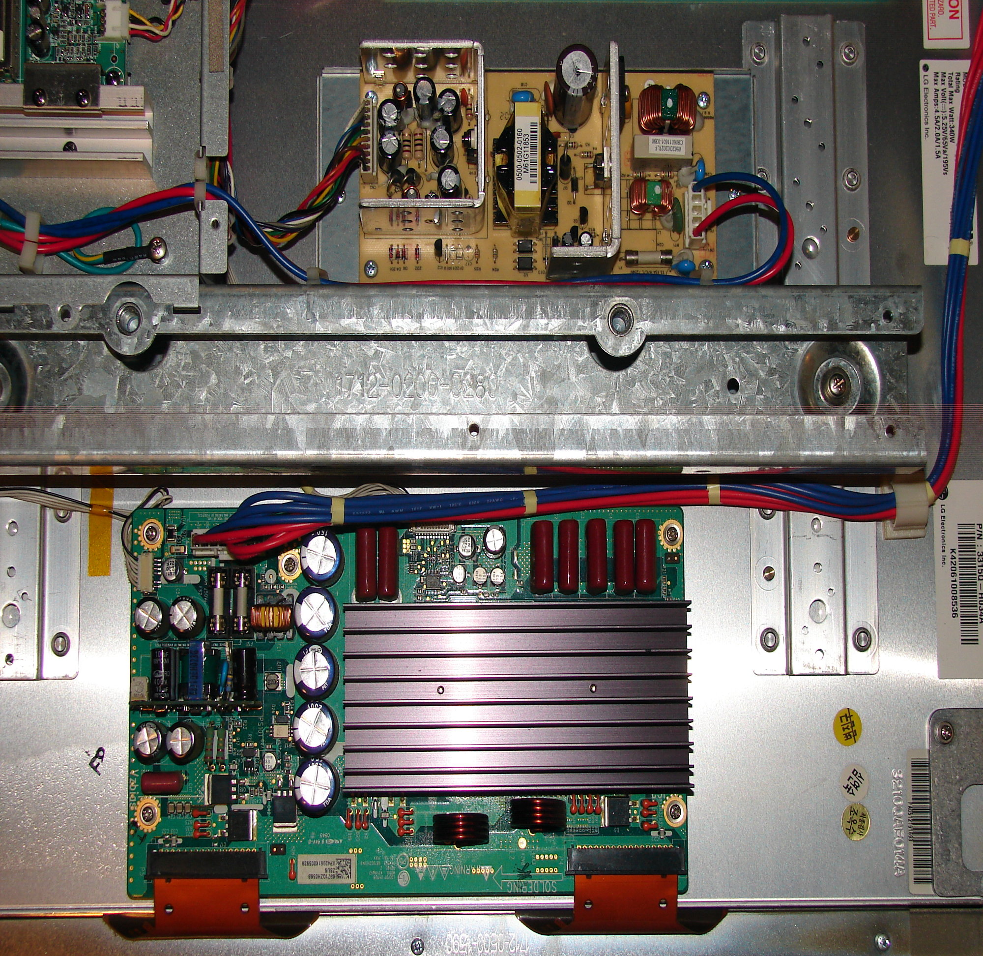

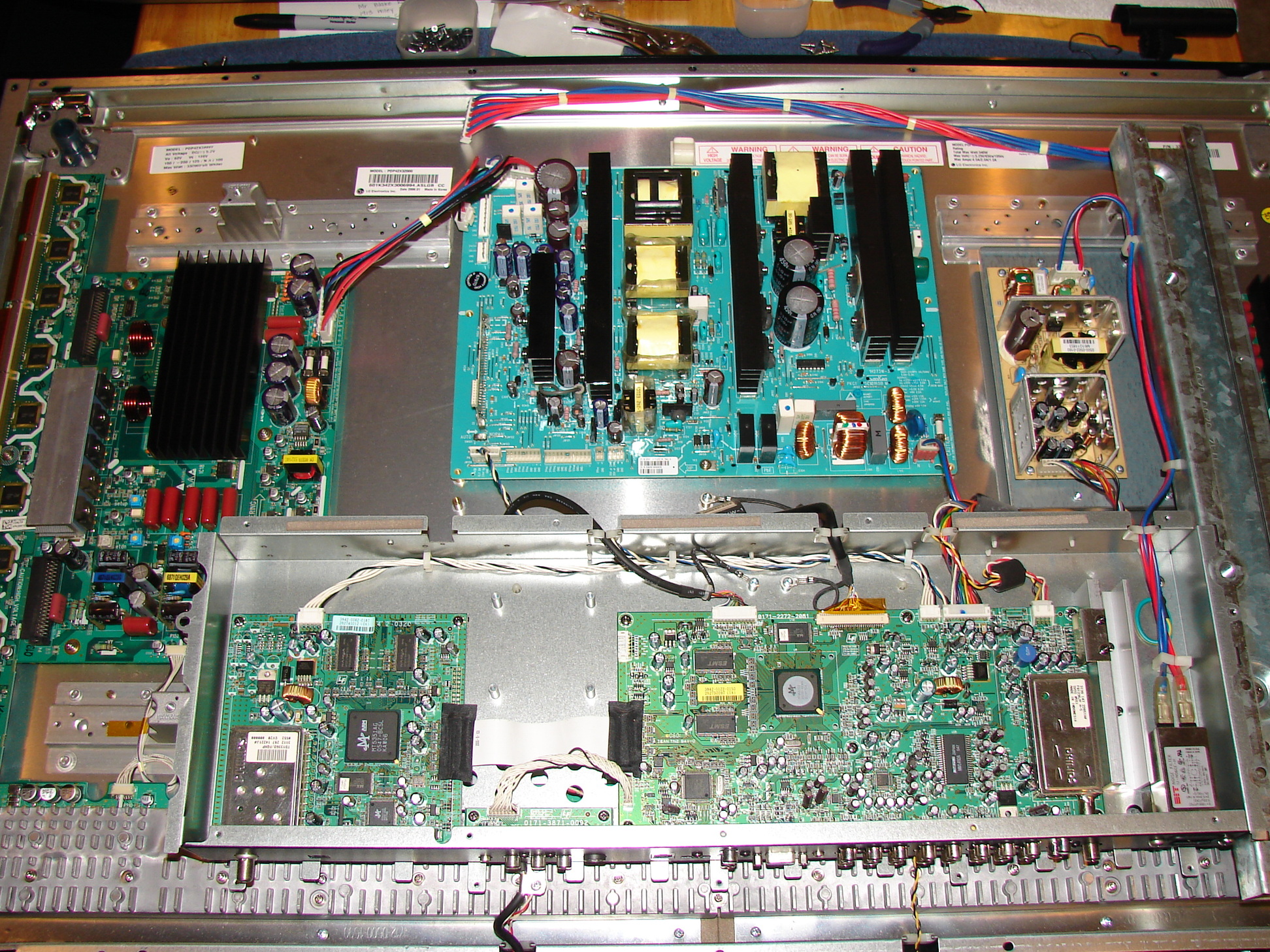

    Here are some pics.

      I've seen this caused by a bad ac detect, but that was on a bad PSU... Still, check the ACD pin on your PSU. It should stay at 5V dead.

        "Also, one of the fuses was blown on the Z-SUS board. That was replaced with no difference in result." are you replaced new fuse or replaced new Z-SUS board?
        I had Vizio P42HDTV10A same problem, find out Z-SUS board is bad, Mainboard tell Power Supply board to turn on ( you can hear click is relay turn on & off) but not pass testing and shut the TV off

          hoadle, I have replaced the fuse within the Z-SUS board.
          Luckily I am working on another tv, an LG plasma (42PC3D), and since both tv's are based off of an LG panel I believe both Z-SUS boards can be swopped.
          The Z-SUS was bad on the LG (by cutting on for about 10 min and seeing which board was warm or not (for there was no picture but sound)) so I am going to see if it is bad for the Vizio as well.
          And tom66, I will definitely check that as well.
          Thanks for the replies and I will definitely get back with my findings.

            Please check the parts # on both board if same you can swopped, if not you will blowed some thing
            • drpj23
              • May 2012
              • 528
              Re: Vizio P42HDTV10A Plasma - No sound, picture, or voltages
              The part numbers are different but shopjimmy offers both to be interchangeable.
              Yes, I normally too would not do this, but I felt there was enough reason for it so I tried it.
              So the LG PSU relays clicked on and off just like the Vizio, so faulty Z-SUS for both.
              I looked at the ACD pin and nothing connects to it nor is there a voltage showing on the meter but when ACD and RLY ON is connected together the relay clicks on.
              I guess I'll know more once the Z-SUS boards come in.
                ACD to GND? (Case?)
                It should measure 5V if it is good. On mine it was dropping between 5V and 0V randomly.
                  ACD does show a voltage (4.4v)....ya that was bugging me why it tripped w/o a voltage lol. Had a bad ground, sorry
                    Ok, so although board has not come in yet, I have unhooked everything but the main board (and little sub power supply since that is what give that power) and am still having power issues or relay issues lol. But when I jumper the ACD and RLYON pin together it double clicked and when I let off, it clicked again like I would figure it should.
                    So main A/V board and Z sus (since it had no luck in the LG plasma)?
