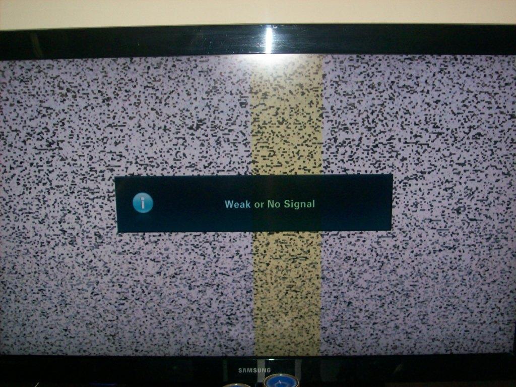

    UGH! Ripped the whole thing apart. Inspected tab bonds all look okay...took the tcon/lcd cables off cleaned male/female ends with rubbing alcohol and compressed air. Put the 1000 screws back together and still the same result.
    Next step I will try will be to rip the whole thing apart again and with the lcd plugged in try pressing on the LCD/tcon cables and see if something is just wrong there and replacing the caps on the power supply when they arrive. I want to give up but I don't
    tibimakai is there something I missed or should try?

        You say that you have a solid black line? On your picture I don't see a solid black line.
        It looks like this, but the colors are always changing.

            As in the ribbons you took pictures of that had the little pokes in them? I did take apart the entire LCD including those little long black screws. However as far as ribbons that can disconnect from the LCD all I found were the tcon to lcd ribbons. Sorry semi n00b at this Thanks for the help though.
            Yes my problem is a solid vertical line which is greenish around 6" width running down the right side of the LCD. Picture below...

                Did you try pushing down on those tabs above the problematic area?
                Anything happens?

                      No luck. I managed to fix it temporarily, but lasted only for a couple of hours.
                      I have noticed yesterday that my issue is the first tab from the center toward the right side.
                      I have installed some .030 thick aluminum sheet metal, long as permitted by the plastic parts, but if I push down on that bad tab, the lines come back.
                      I'm thinking that must be some rupture in the tab traces, due to excessive heat. I guess that the tab becomes brittle from all that heat and by moving it around the traces get broken. Now to find that it's very hard. It could be at the chip itself.
                      I may end up just selling it for parts (the whole TV) or sell the boards on Ebay. I think I'm done with TVs with lines on the screen or tab issues.
                      Two TVs like this in a month, that is to much. One it was a VW46 Vizio and now this Samsung. I will stay away from Sony too with screen issues.
