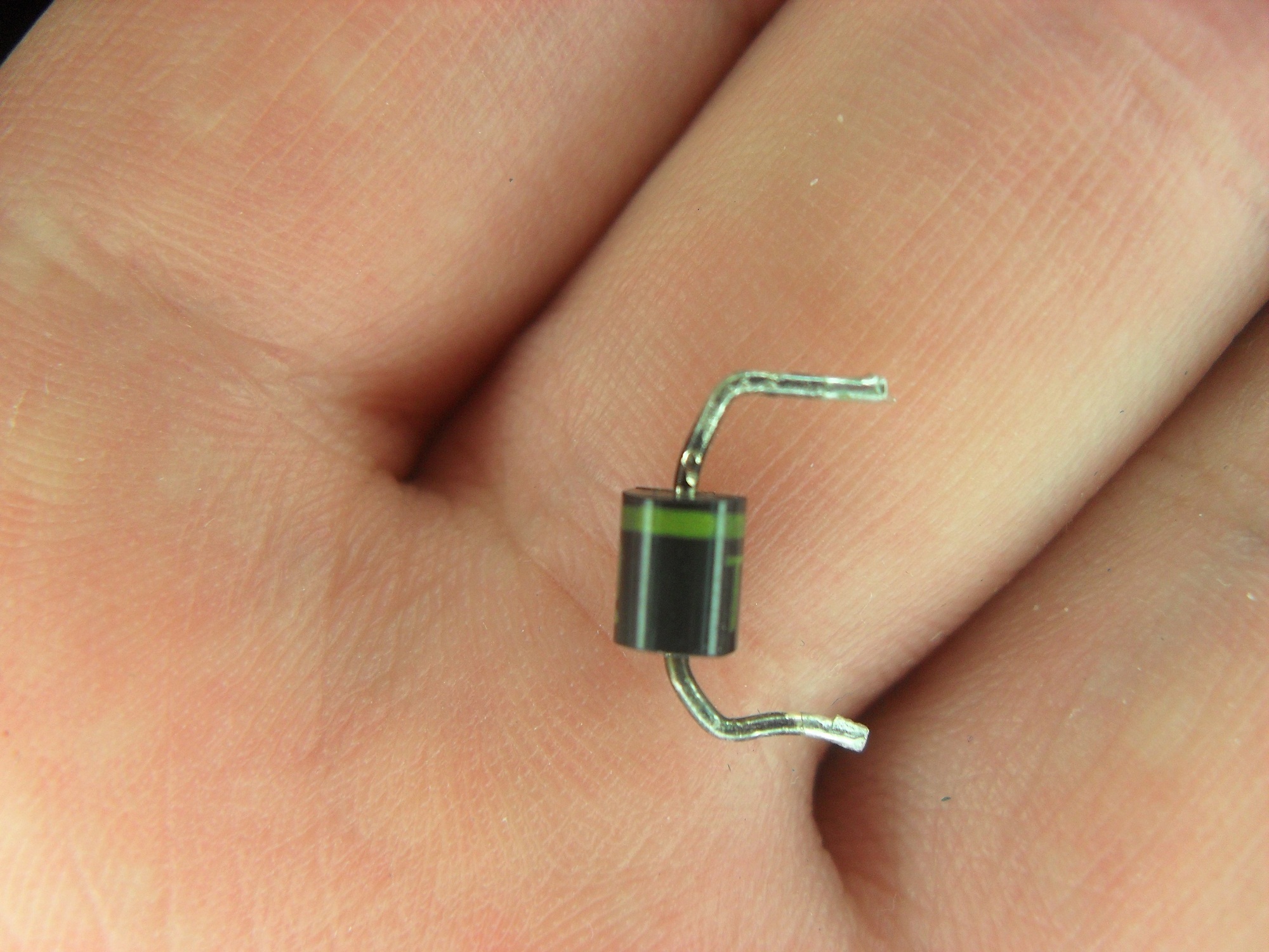

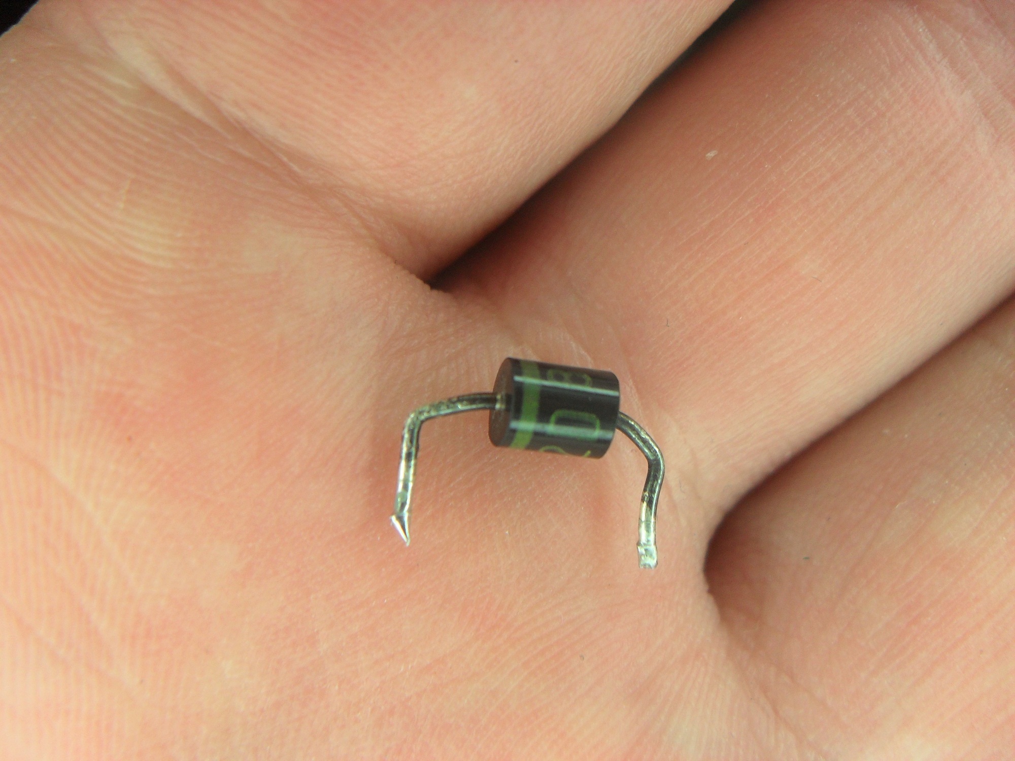

      D203 is T2D80 some reason i read the wrong one. lol also looks like its open.
      D201 is PS!010R Pec 9019

          It isnt one of those either! did you see post 22 - gave the details of the wrong diode.
          Any ideas on a T2D 80 It gets mentioned here and there but no data sheet

              You can get one of them at Farnells
              http://uk.farnell.com/fairchild-semi...201/dp/1467533
              The other one the T2D 80 I cant find but wonder if a sb580 diode would work.That is available at farmells also.

                      D203 appears to be a standard Ultra fast schottky diode ..3A should do it.
                      D201 ,202 look identical from the schem and are back to back
                      Ultra fast diode packs..
                      Are you sure all those diodes are dead ??
                      Seems unlikely to me...should be a charred mess if so !

                        D203 - T2D80 is the only bad one outta the 3.
                          #32
                          Re: Toshiba 32AV502R
                          Why do you say it is bad - doesnt look burnt-can you do the standard diode test and post the results.
                            #33
                            reads 1. both ways and doesn't budge.

                                  Ok but I am still not convinced - did you read what Toasty said in this thread
                                  https://www.badcaps.net/forum/showthread.php?t=18237.
                                  Anyway, we have still not got a replacement identified - someone mentioned 3A so you could try a sb380?
