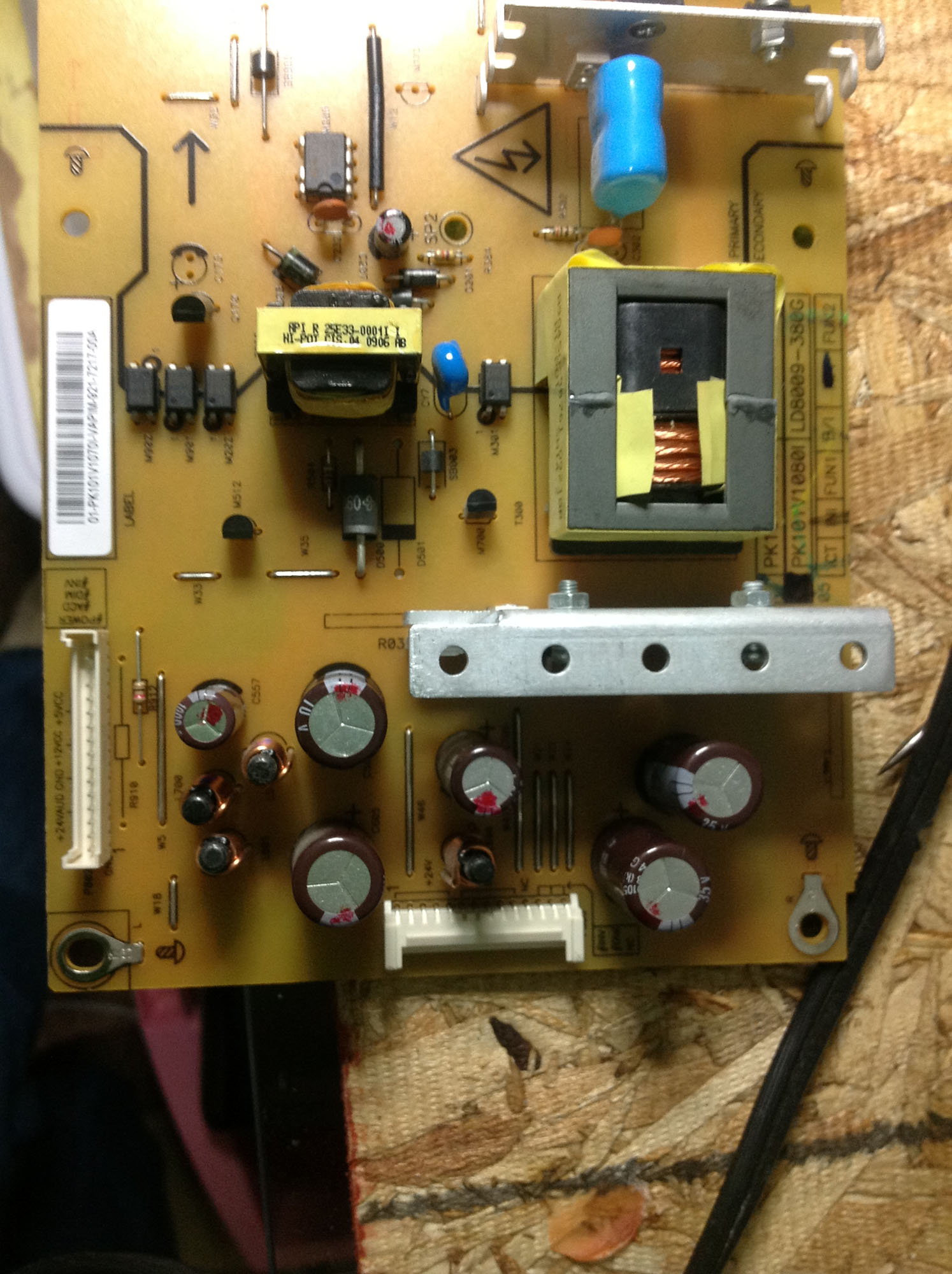

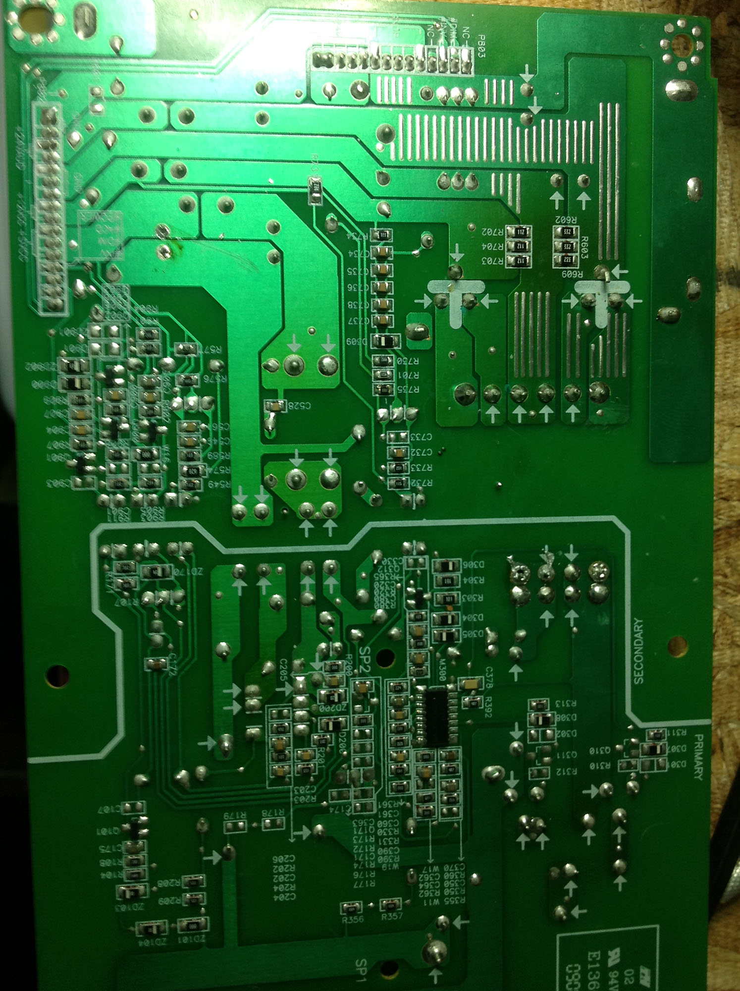

    Issue: Picked this tv up for 15$ worked one day and next didn't or so i was told
    Symptoms: When Fully Powered down and turned back on Power comes on, very top of the screen tries to light up very very very quick and dim green light is flashing on the TV and doesn't stop flashing.
    All voltages are outta whack hear noises coming from the power board here where i have a video to help.
    163.8 coming off the main cap when powered on however.
    http://www.youtube.com/watch?v=KU6opm7Tdd0

    1) What is the DC voltage across the startup cap, C207 (right by the SP2)? Is it steady or fluctuating?
    2) What is the SMPS IC part number right by the startup cap?
      Voltages all over the place unstable.
      CHN
      Viper27L
      KV3848

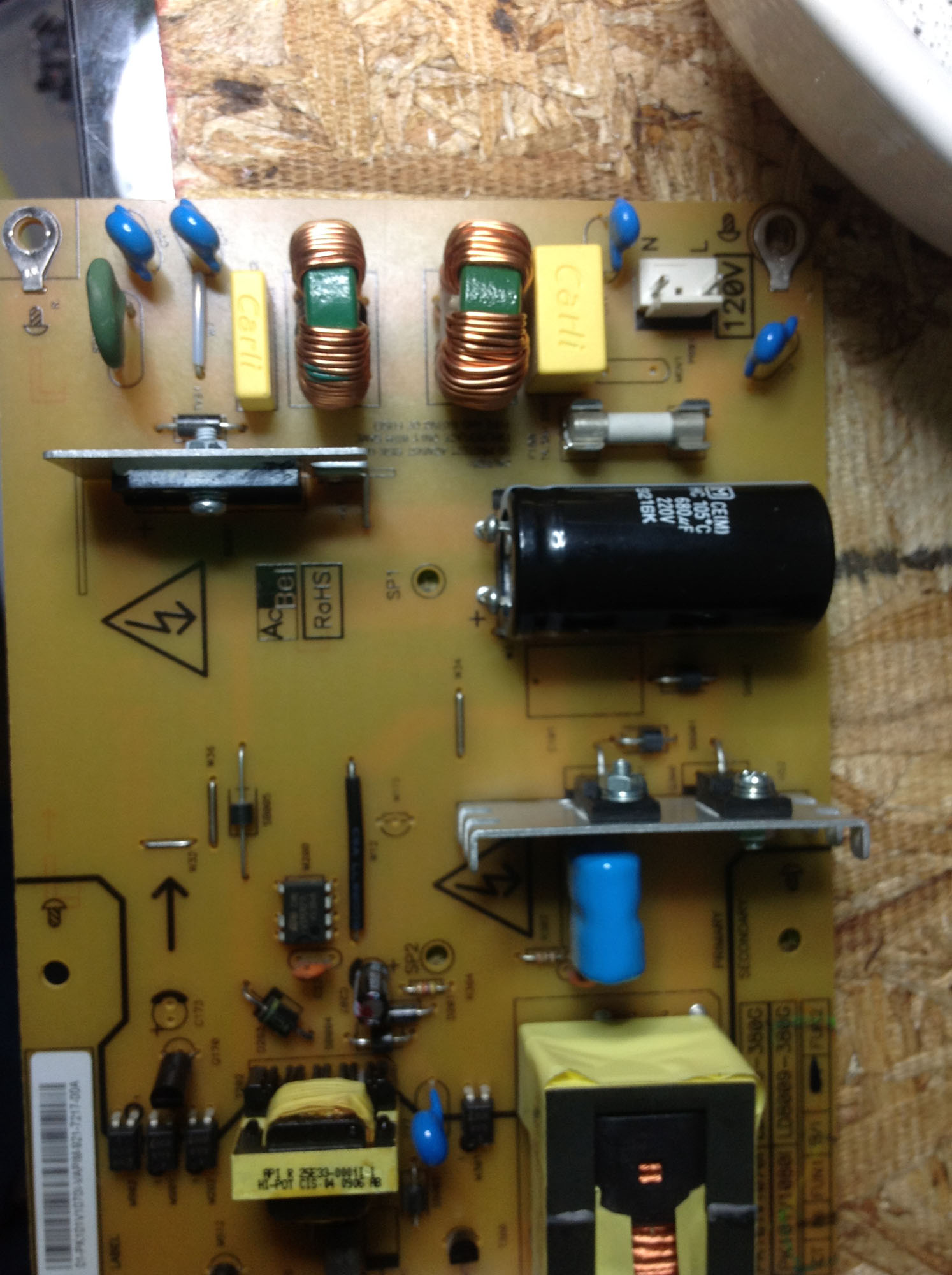

              Replaced C207 and no change. the blueish thing next to the transformer is the biggest noise i hear PHSl04J 800VHoB

                      On page 6 of the pdf, the VDDon is 14V DC typical. The minimum is 13V and max is 15V. So it looks like the SMPS IC is trying to start if the max is 13.46V DC. This is why the actual readings are critical.
                      Since you changed the startup cap, this means that there is probably a shorted diode on the board causing the SMPS to startup, shutdown, startup, shutdown, etc.
                      I see at least two diodes right by the startup cap, possibly 3. There is also another underneath the big yellow transformer. Test them all and others that you find with your diode test function. If one is shorted, it will give the same reading in both directions.

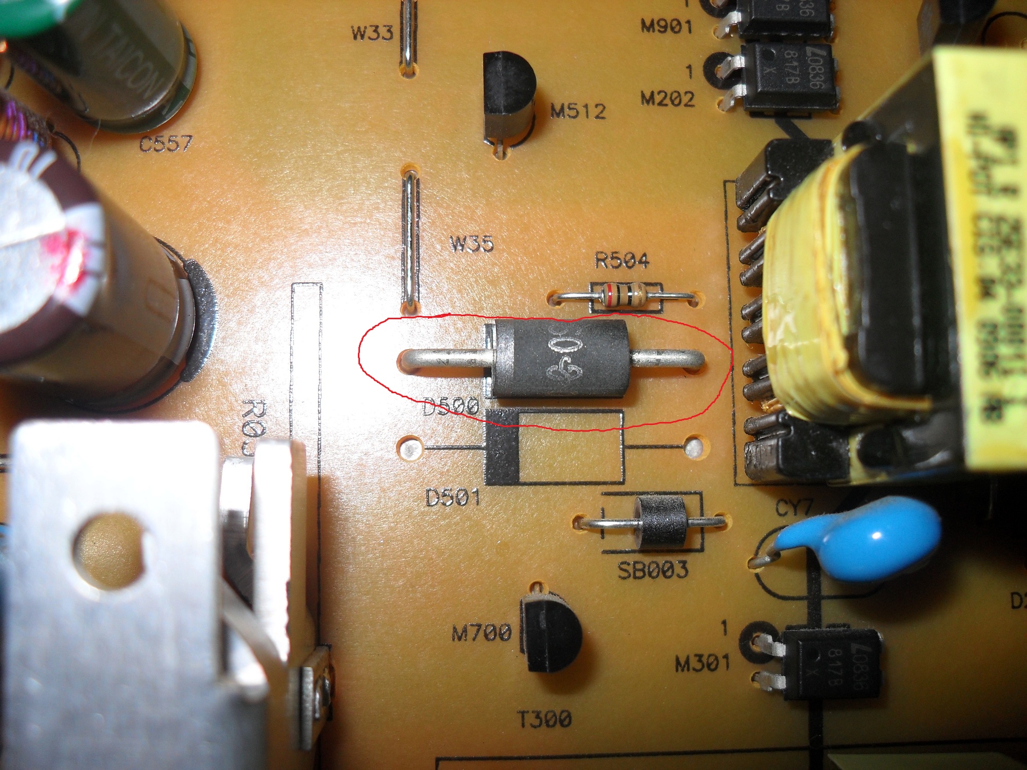

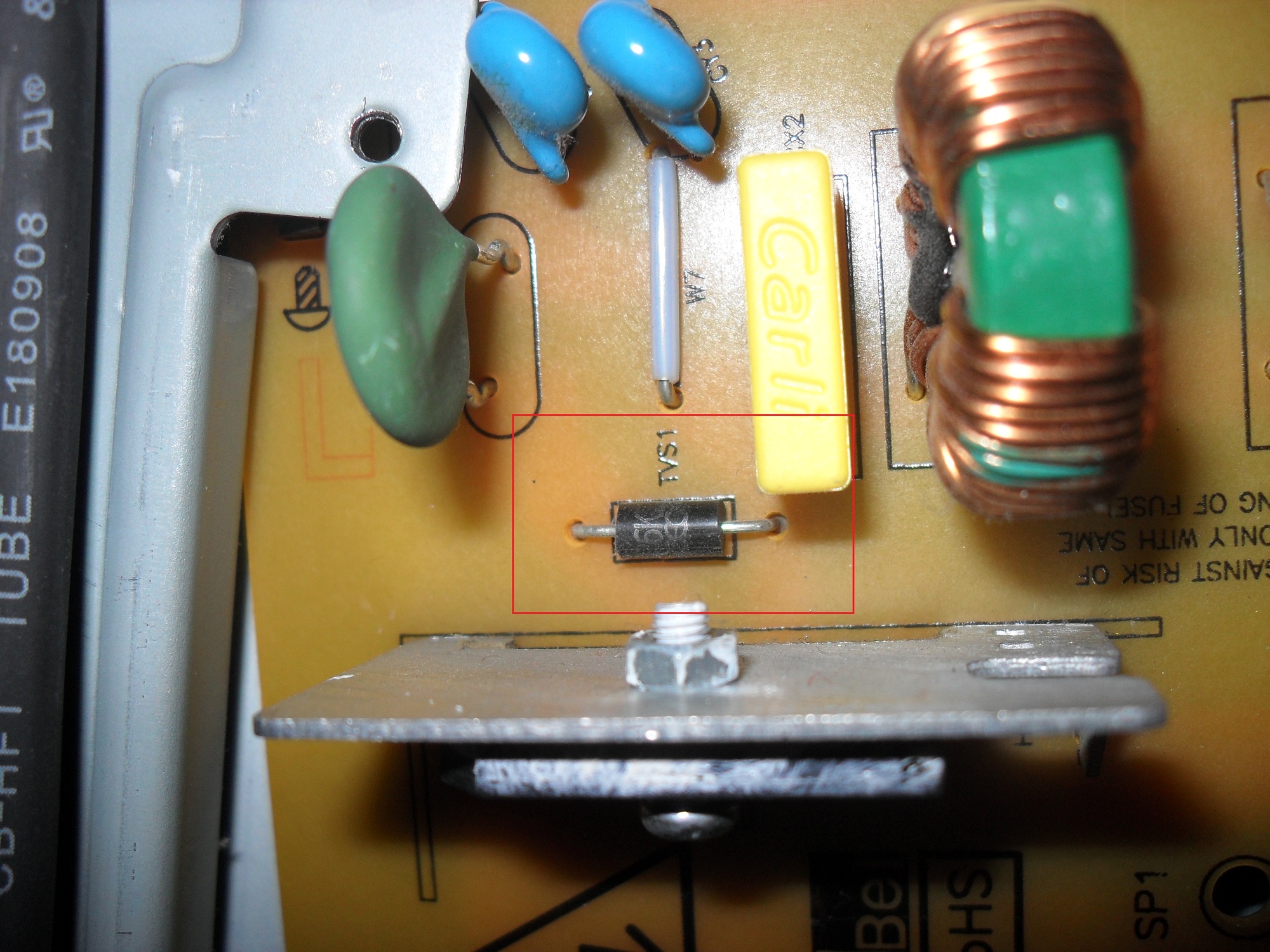

                        TVS1 Dead/Zero nothing.
                        • Vizor
                          • Nov 2011
                          • 215
                          Re: Toshiba 32AV502R

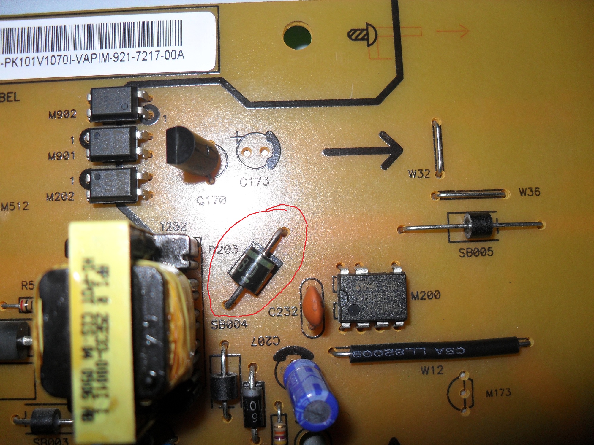

                          D500 is Bad and D203 is Open
                            TVS1 is a surge protection device - it is normal for it to appear open circuit on a typical test.
                            However D500 is probably the fault if it appears short circuited. Does it?
                            D203 -> could be faulty, but please remove it and read off the part # so we can tell if it is a TVS or otherwise.

                              Small one: PS!010R Dec 9019
                              Big one: 09016 SB540
                                        That D203 may be the Snubber diode (about 200V rating) which in parallel with the primary winding of the transformer, it will read low Ohm due to the low DC resistance of the winding. Verify if the Diode is in parallel with the transformer winding.
