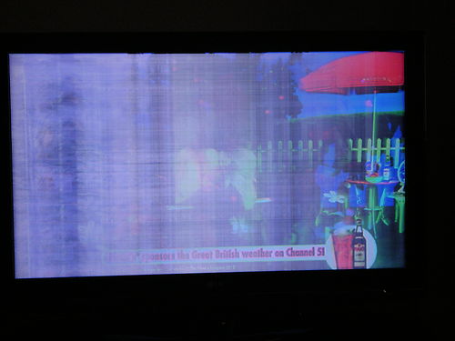

    guys might be looking at this next this is the pic i have been sent any idea what issues may be before i offer a price
    Re: Lg5010 42" lcd
    Hmm, could be bad panel. But probably T-con. Can't be certain.

      Re: Lg5010 42" lcd
      flex the TV before handing out the money.

        Re: Lg5010 42" lcd
        my money is on the panel,most t con faults give bold symetrical bands,stripes etc,this is more uneven frosting ,could be dodgy ribbon cables but i doubt it

          Re: Lg5010 42" lcd
          cheers guys for your input i will see if he has any more pics of it in use as hes saying its getting worse the longer its on some times it ok sometimes its bad as in the pic hes also said some images are on the screen 3 times above each other? from top to bottom of screen.
